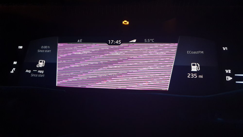

I retrofitted the virtual cockpit and had it coded remotely a few weeks back, all fine. I wasn't able to fit the fibre optic at the time because I have the Canton sound system so needed to buy/make a fibre optic splitter.

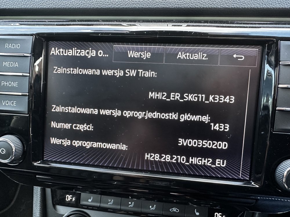

I installed the fibre optic and splitter yesterday but am having trouble with the maps displaying all messed up. Sound is working fine and the map display is changing as I move so I'm happy the physical installation is OK.
I spoke to the guy who coded the cluster in and followed instructions to disconnect cluster power attach fibre to MIB and then cluster and reapply power. All combinations of connections result in the same output on the clusters
MIB firmware is v1440, cluster firmware is 1710
Has anyone any ideas what to do here??

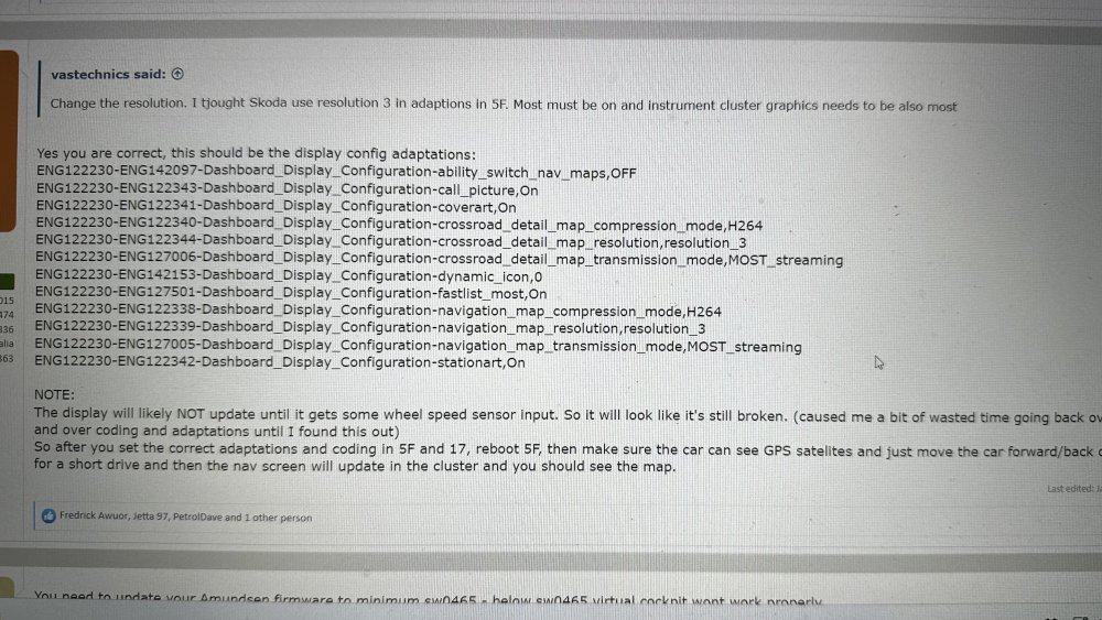

  • this should be the display config adaptations 5F ENG122230-ENG142097-Dashboard_Display_Configuration-ability_switch_nav_maps,OFF ENG122230-ENG122343-Dashboard_Display_Configuration-call_picture,On

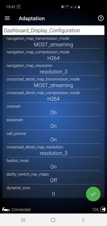

ENG122230-ENG122341-Dashboard_Display_Configuration-coverart,On
ENG122230-ENG122340-Dashboard_Display_Configuration-crossroad_detail_map_compression_mode,H264
ENG122230-ENG122344-Dashboard_Display_Configuration-crossroad_detail_map_resolution,resolution_3
ENG122230-ENG127006-Dashboard_Display_Configuration-crossroad_detail_map_transmission_mode,MOST_streaming
ENG122230-ENG142153-Dashboard_Display_Configuration-dynamic_icon,0
ENG122230-ENG127501-Dashboard_Display_Configuration-fastlist_most,On
ENG122230-ENG122338-Dashboard_Display_Configuration-navigation_map_compression_mode,H264
ENG122230-ENG122339-Dashboard_Display_Configuration-navigation_map_resolution,resolution_3
ENG122230-ENG127005-Dashboard_Display_Configuration-navigation_map_transmission_mode,MOST_streaming
ENG122230-ENG122342-Dashboard_Display_Configuration-stationart,On
Have you got an autoscan from VCDS and the adaptation map from 5F you can post?

navigation_map_resolution was set to resolution_1 but changed to 3 and hard reset the MIB but no change

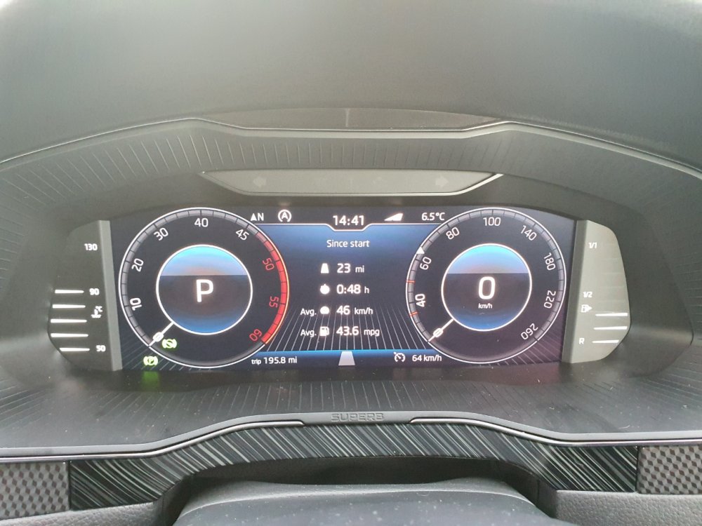

@RomanB I left the resolution setting as you had advised above and parked up. When I started it after a few hours it was working. I had reset both the dash and mib via obdeleven but something about leaving it powered off has done the trick.
Thank you!

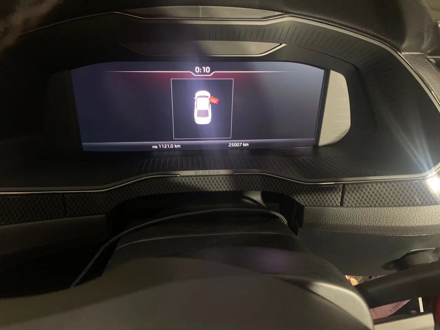

Hello everyone,
Today i tried to retrofit a virtual cockpit. After coding 17-Instruments everything seems to work. So after that i went for the above coding.(thank you romanB). After resetting the mib and leaving the car powered off i still don’t get any display of a map or coverart. Am i missing something? I have the canton so I installed the  MOST splitter.  Audio is working fine and i saw the red lights coming from the fiber when I connected it to the cluster.
If you have any idea, please tell....

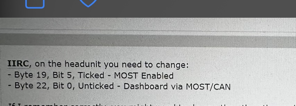

I found the issue. 5F → coding→ byte 22 → Bit 0

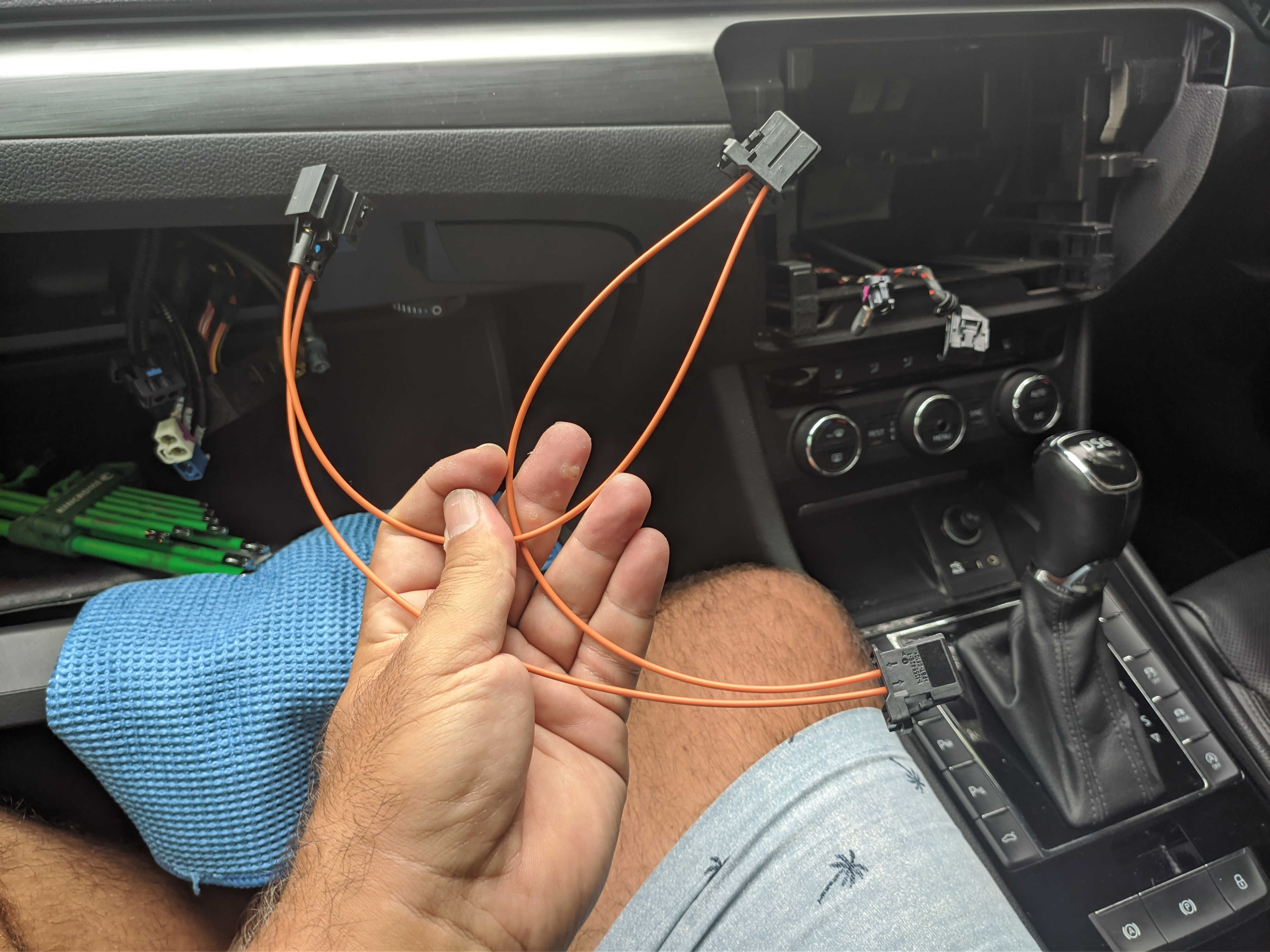

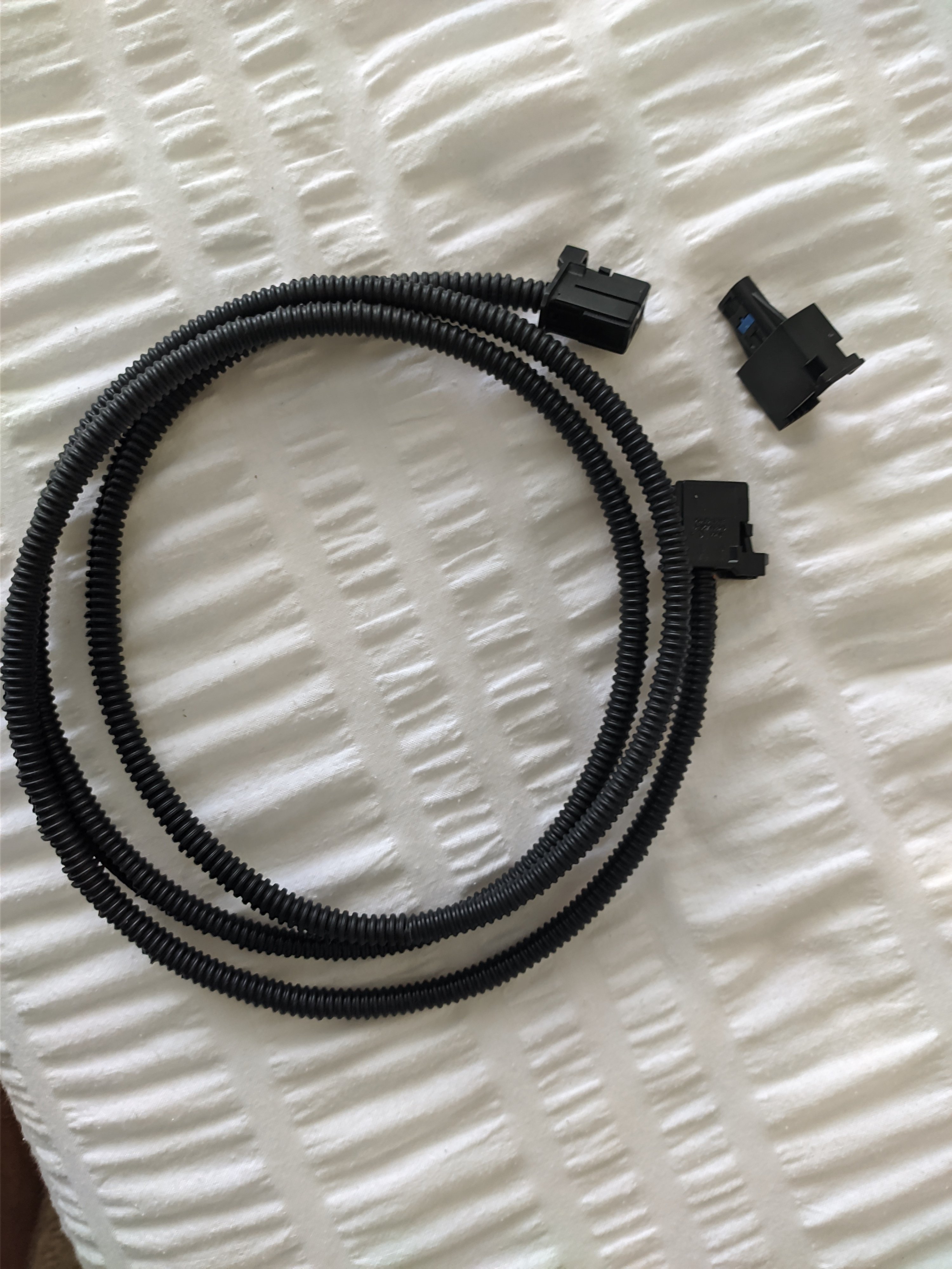

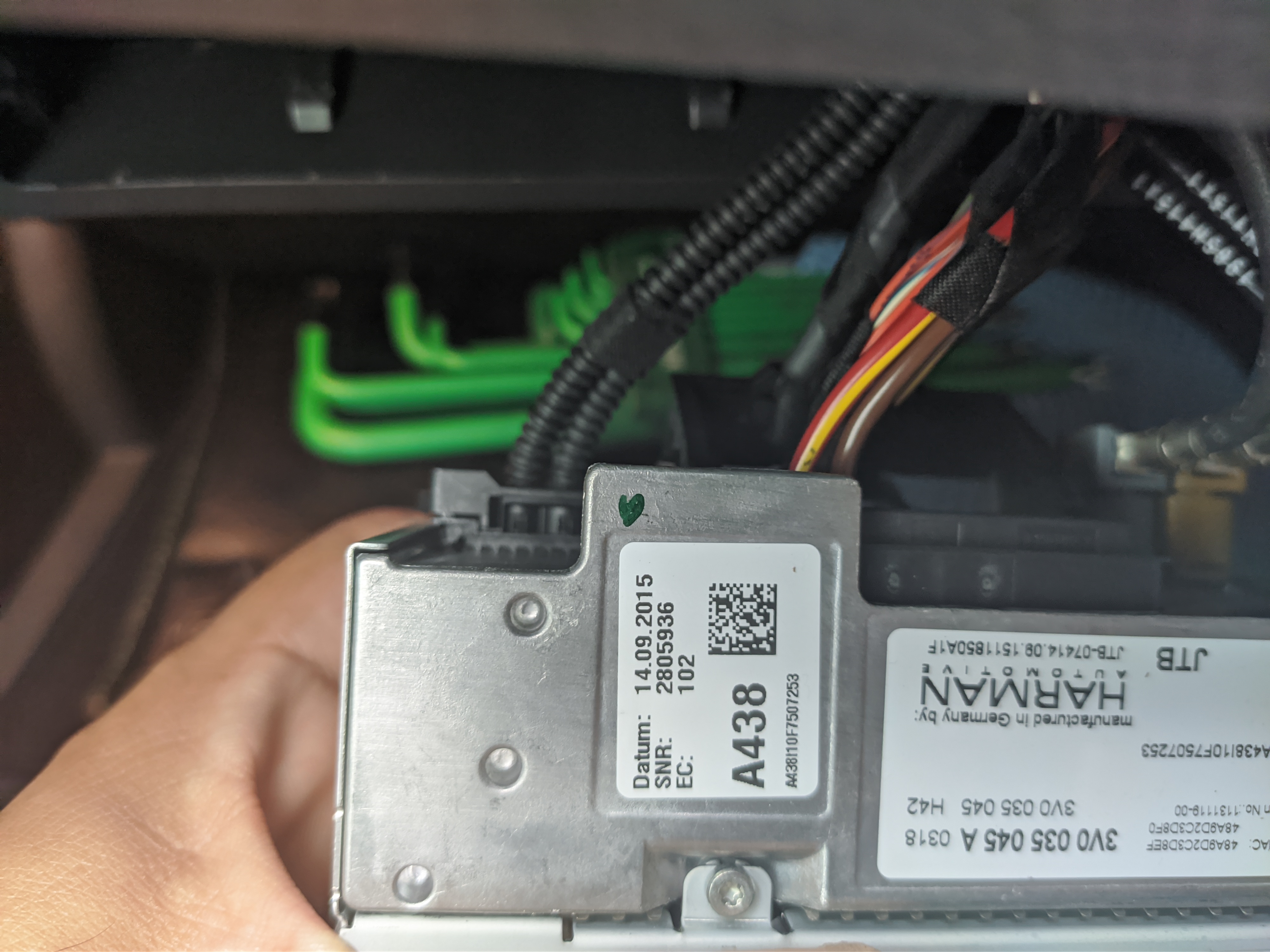

Does anybody know how to connect the MOST cable to both the VC and CANTON?
i have the orange MOST as per below. If i connect it to the MIB2.5 it leaves 1 female and 1 male connection.
Problem is that both the CANTON and VC MOST cable will only accept male.
I'm sure I'm doing something wrong
You can change over your spare female most connector i see in you last picture with a male connector on your splitter. I had to do this also. There are arrow on the connectors for the data stream. Make sure you put the correct fibre in the correct position.
Adaper is worng it should be 2 female 1 male.

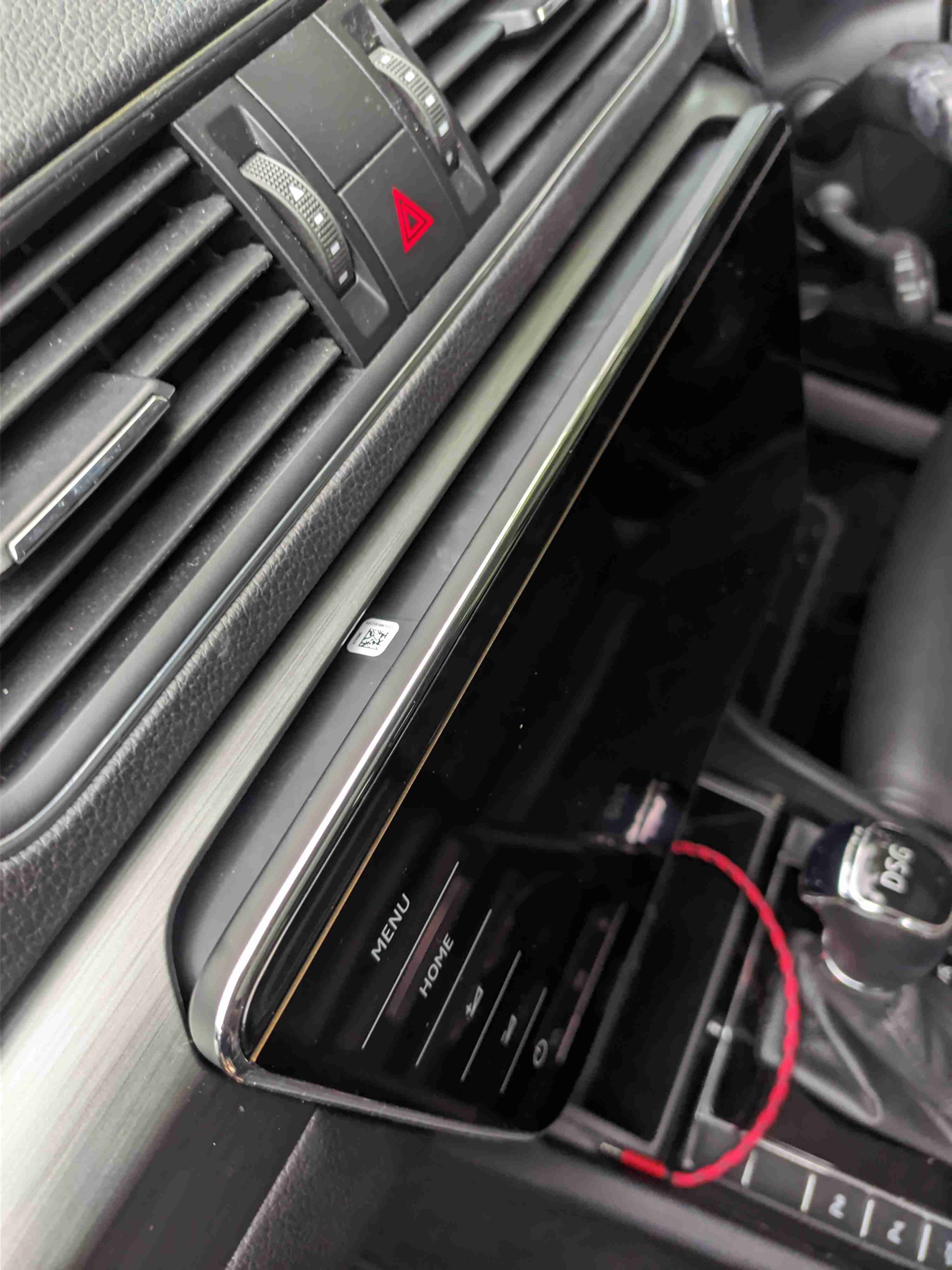

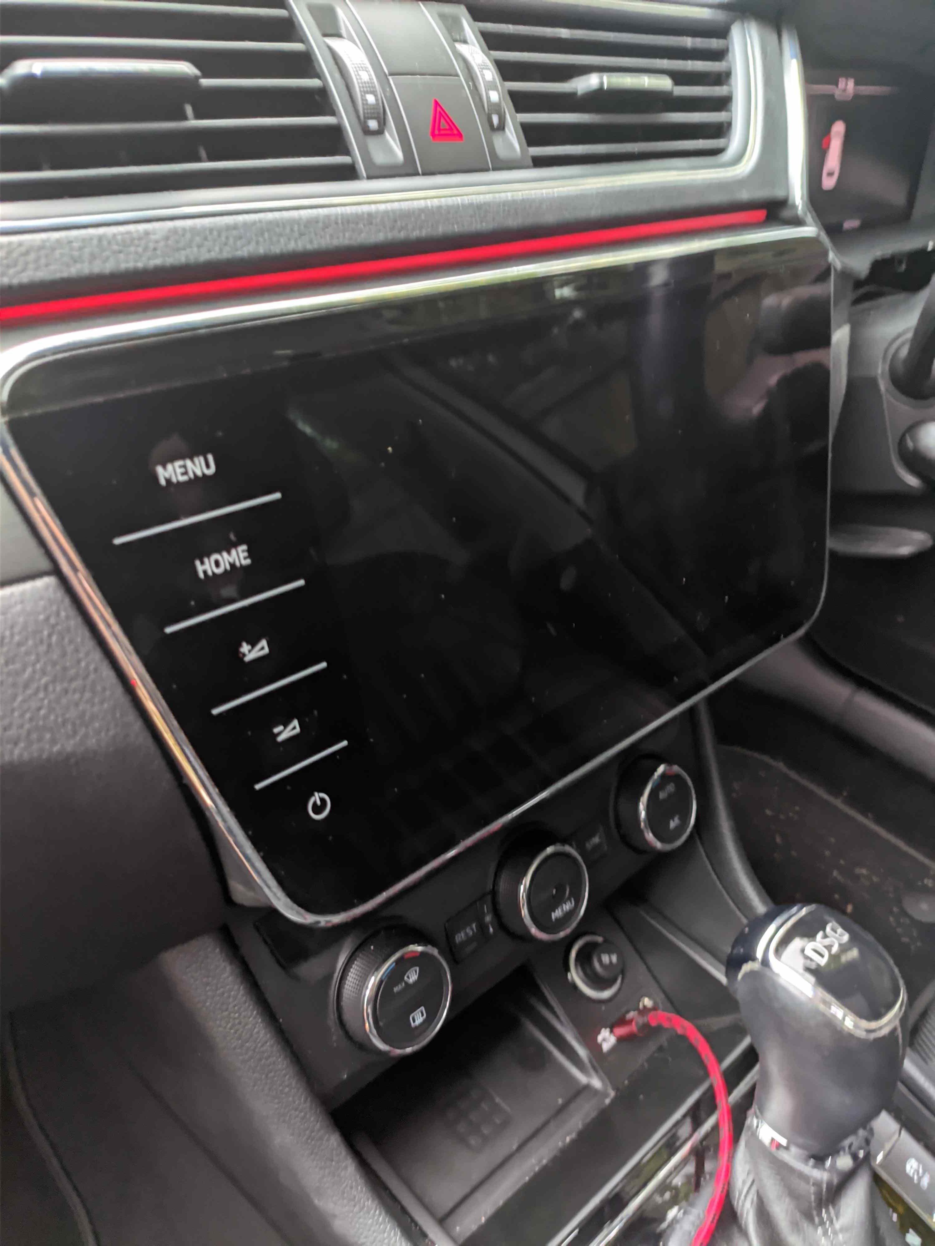

Ok managed to get my mib2.5, 9.2 screen and VC retrofitted. Pretty happy but a couple of questions for those that did theirs
1) i cannot see a setting on my infotainment unit where i can personalise the screens. I just have the defaults via the steering wheel. Is their some coding or adaption that needs to occur here to enable?
2) Is there meant to be such a large gap in the trim above the infotainment unit and the trim? Or do i need another part?
