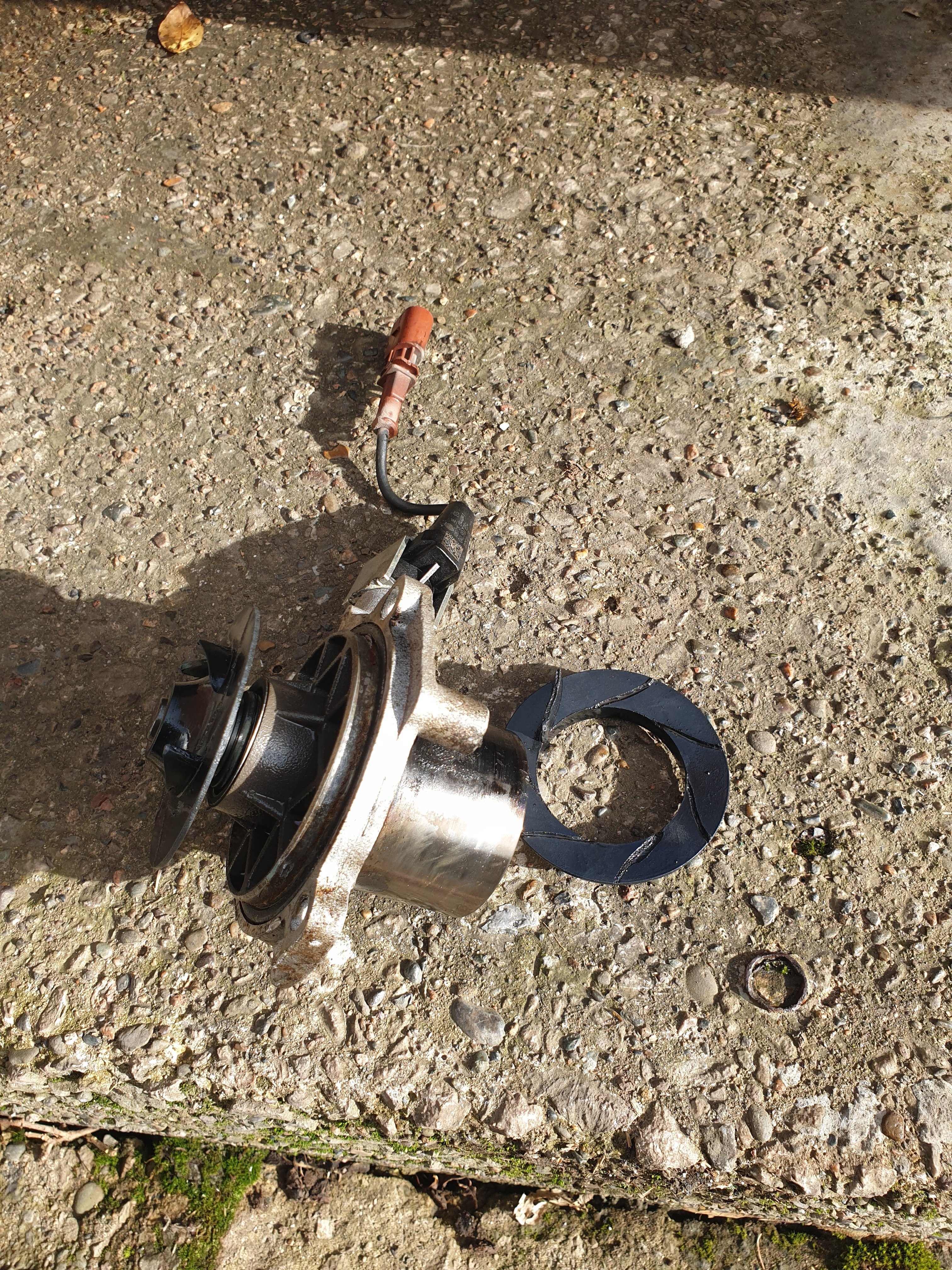

  2. 2015 2l TDI about 97000 miles. Garage said the timing belt had been swapped when I got it about 3 years ago so I assumed that was everything. It was a potential summer job last year that I never got round too. Just stopped at the lights outside work and the engine tone changed, sounding like the exhaust had blown, accompanied by what I thought was steam. Limped into the carpark and turned out the steam was smoke with a strong smell of burning plastic and now a squealing noise. Other than that zero symptoms at all. Tensioner is a Gates one but the water pump is VW so I guess that wasnt swapped after all.

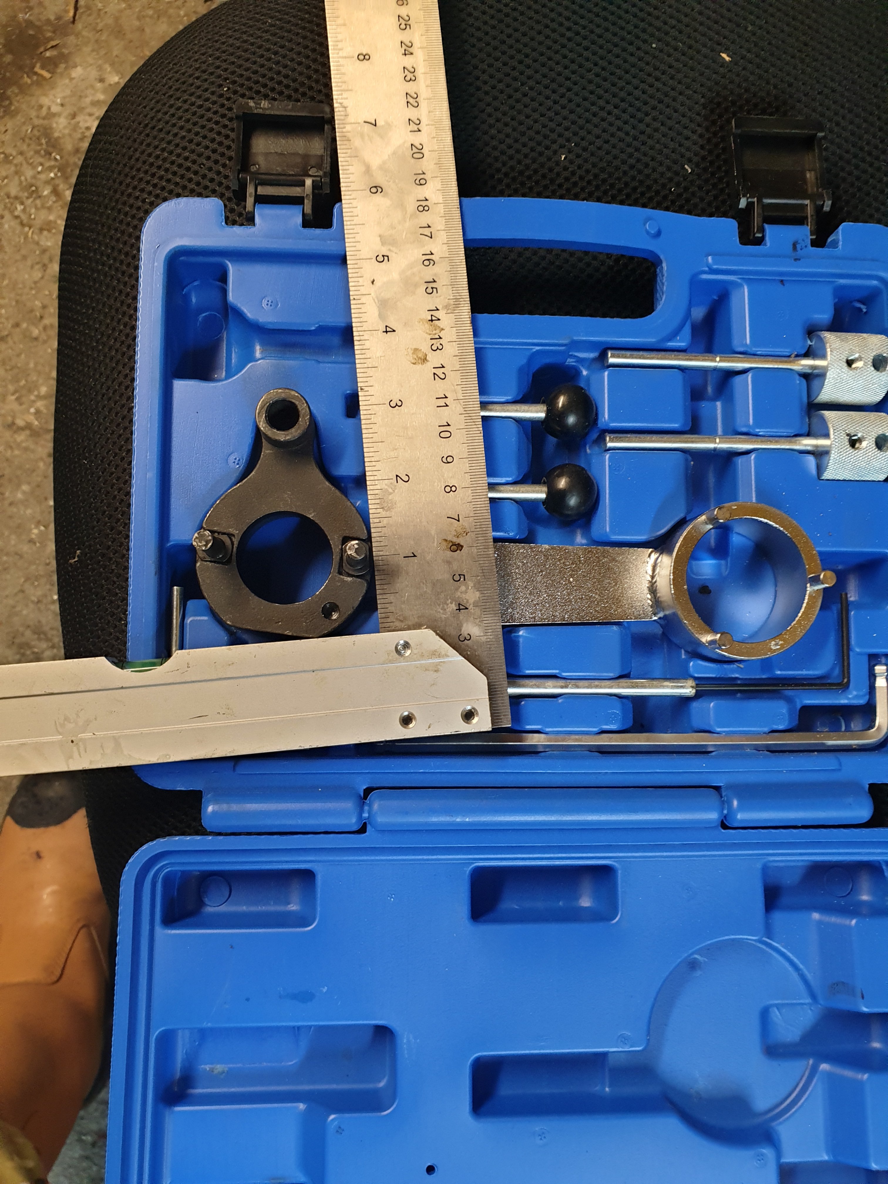

  3. I'm just getting round to fixing my smoking, throaty/squealing 2l diesel after having it laid up for a couple of months. I've pulled the top cover and I'm easonably happy it hasnt stripped a tooth, also fairly sure that the waterpump pulley really shouldnt be at a slight angle and that was the cause of the issue. So I've got new timing & serpentine kits ordered and crankshaft oil seal as thats leaking a little too. Then I come to examine my finest Chineseium crankshaft locking tool which has raised this question: How much crank should a crankshaft locking tool have if a crankshaft locking tool has a crank - to the left? It seems a little excessive and pics of other tools dont seem to confirm or deny my suspicions.
