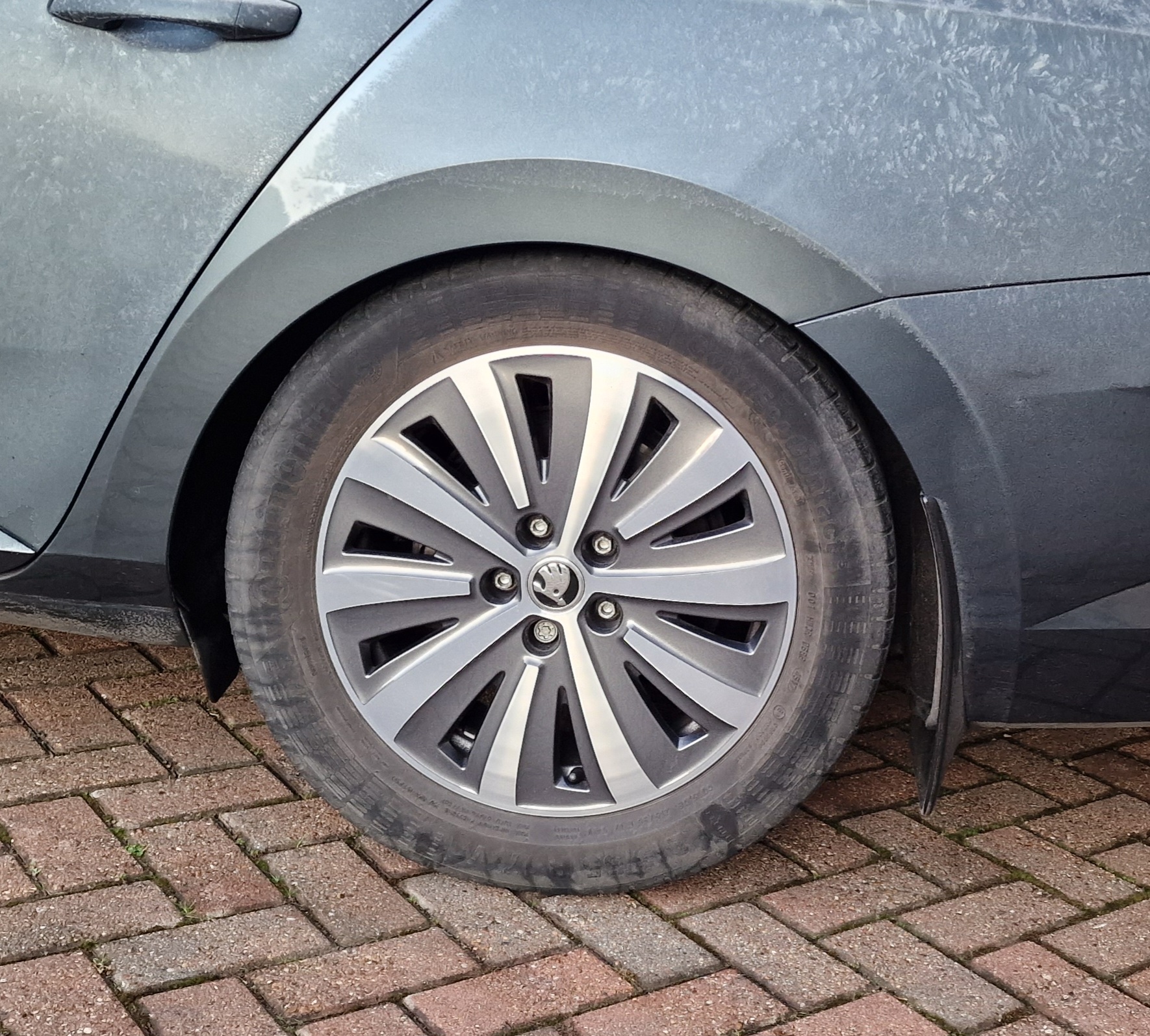

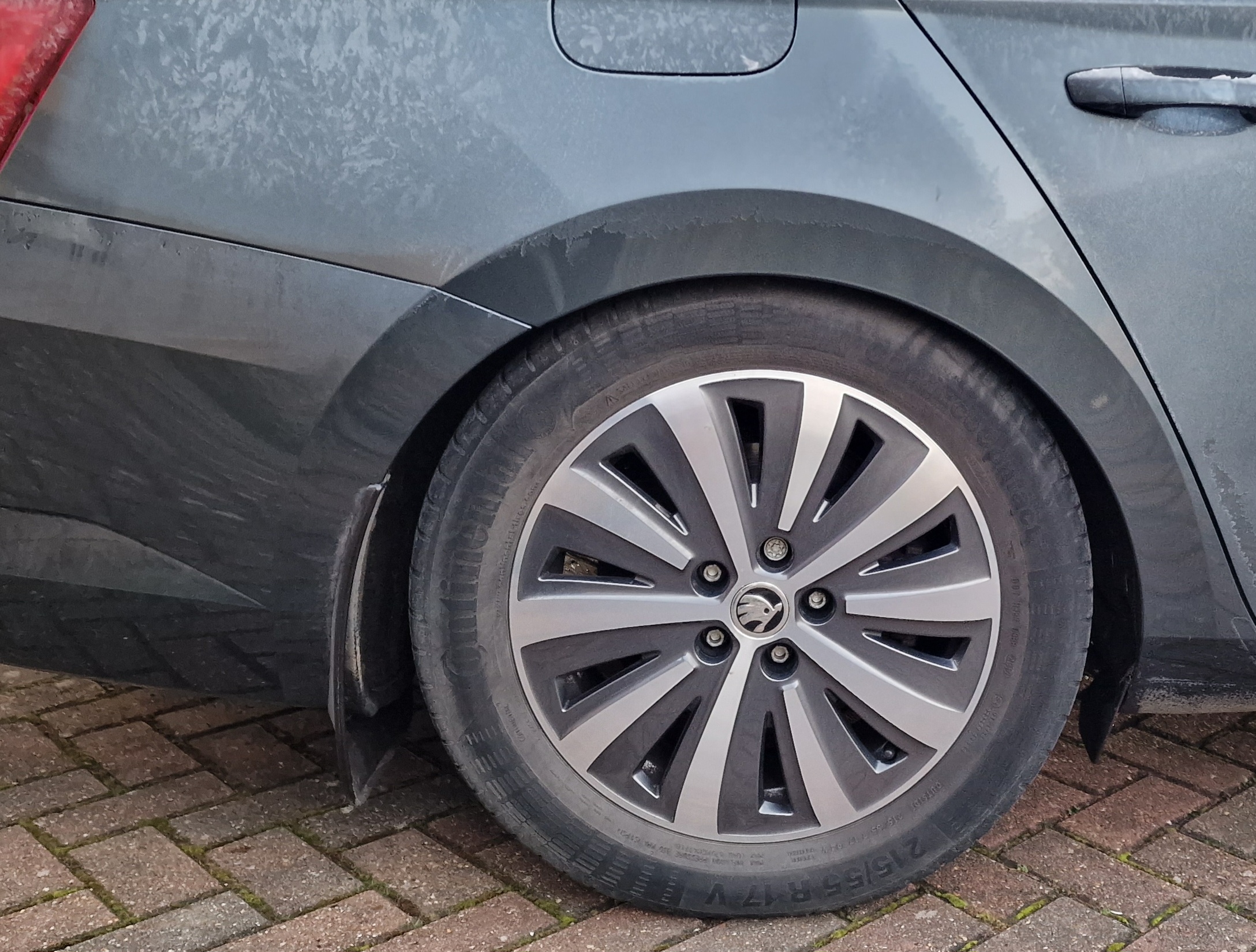

  7. May seem obvious to some but I'm wondering if this seems to be fixing low on the rear? The front is as expected but rear seems lower compared to any other superb I see. The level seems the same on both sides so it's throwing me off the "something" is broken route Anyone else seen anything like this or is it pretty normal?
