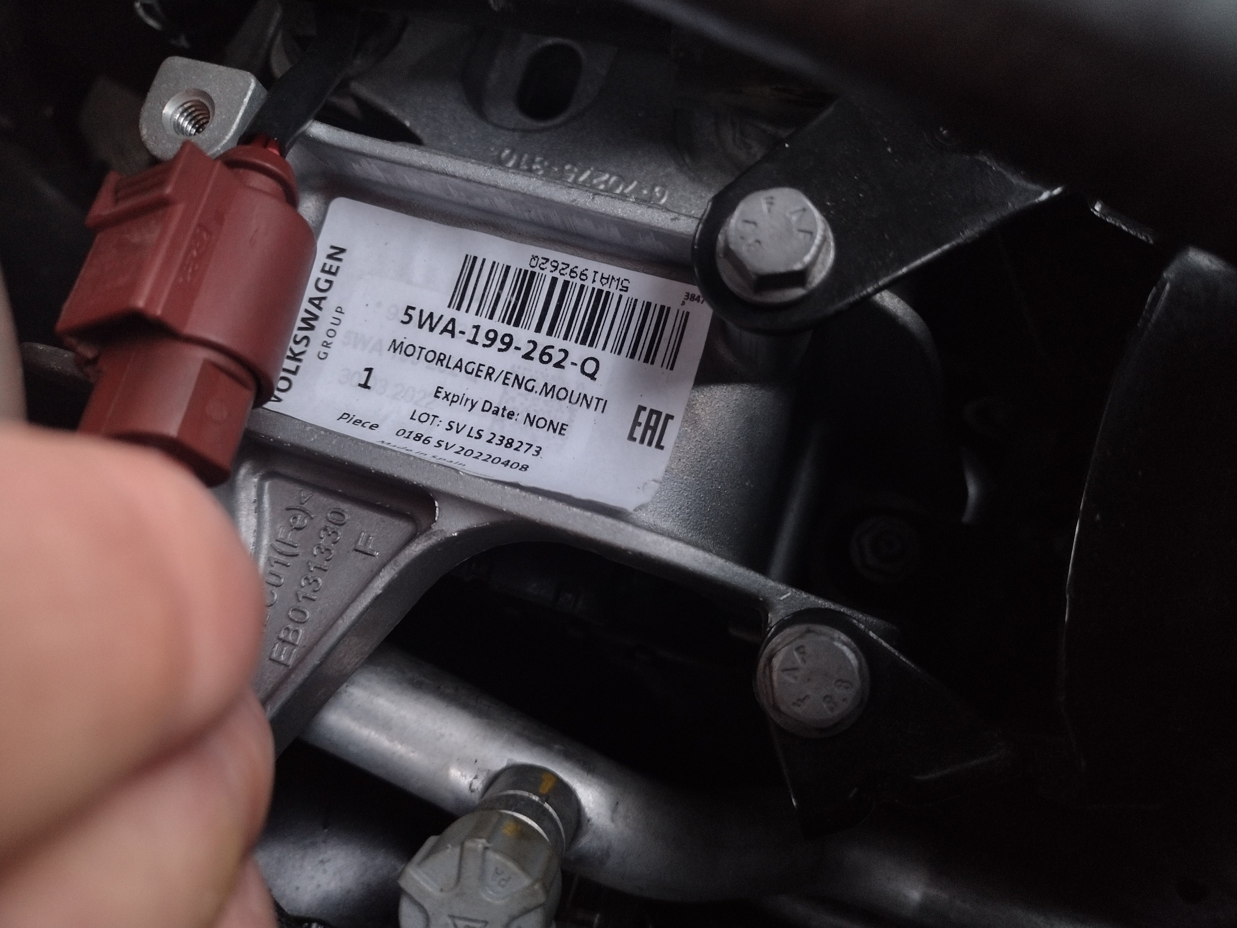

  2. Hi APR, Did you change the mount on the left side (driversview) below the Battery, or the mount on the right side? also greetings from NL!
  3. Unfortunately i don't know that. The cars was for several weeks at the garage as they tried many things (which solved 30% of the noise) Replacing this mount was their last action and it removed the remaining 70%.
  4. @Doombar I still don't know the details of that TPI but i do know that the replacement of the motormount did remove the noises on my Kodiaq.
  5. @ppejic They have replaced the mount on my 2018 2.0TDI FWD Kodiaq last week and it (finally) was the solution for the grinding noise! See the picture with the new mount. I don't have a picture with the old mount nr.
  6. Have they changed it?
