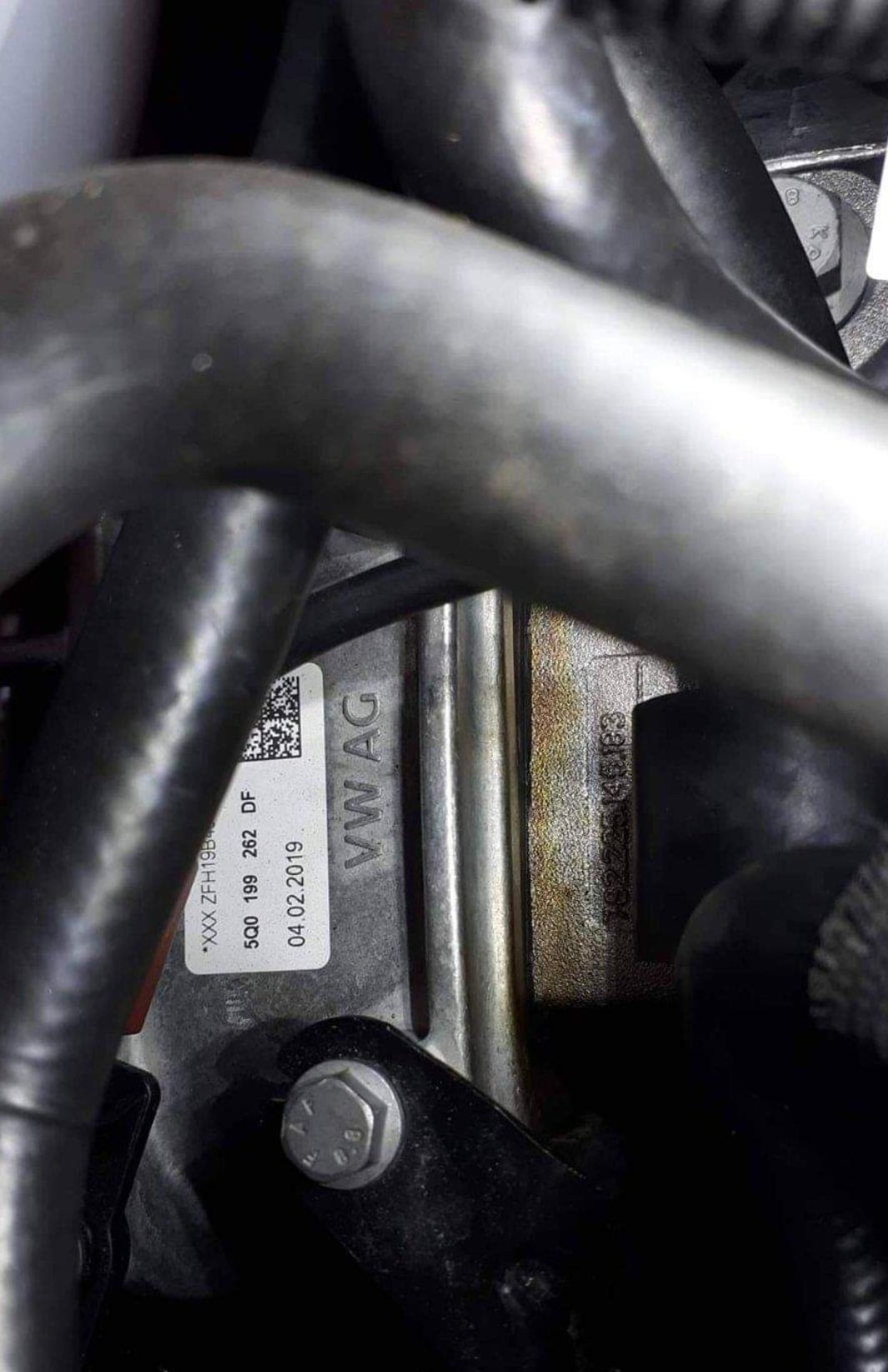

  3. I am fighting Skoda to change it FOC, but it seems that I am losing the battle. If no success, I'll change it on my cost during next regular service appointment in February
  4. Battle continues it seams that they have understood that wrong part was installed by workshop But never the less, they have confirmed that part is wrong. Now I just need to battle them to exchange it FOC.
  5. Just confirmed from Skoda factory, the part is intended for 1.5 TSI
  6. ....yeap, I have made mistake it is DF not BF.... but it is a factory mistake anyway.

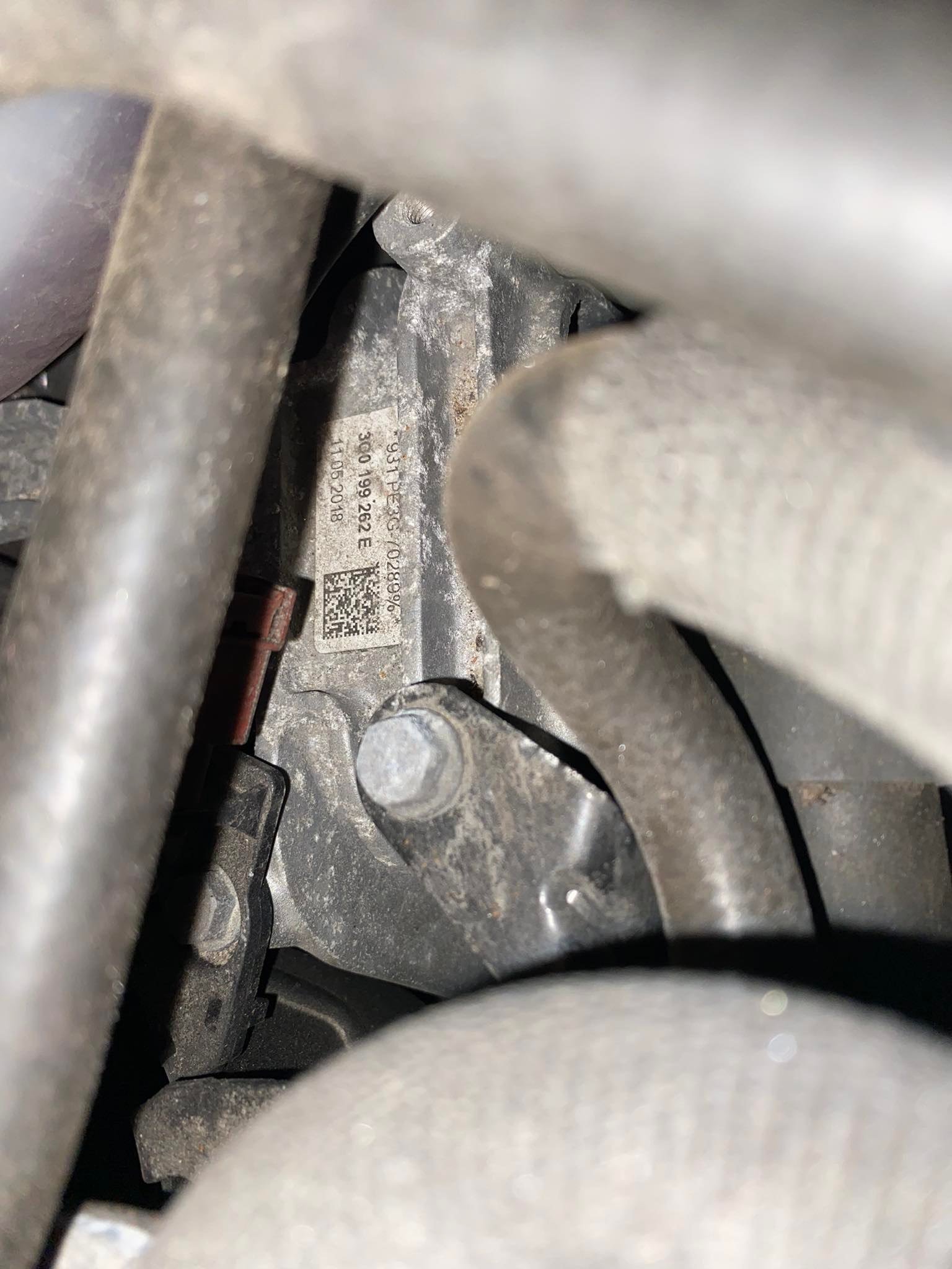

  7. @varooom Rumbling is heard and plastic inside the cabin resonates @1500-2000 rpm. It is much more pronounced when outside is hot or when the engine compartment is warmed up. In the same time unpleasant vibrations can be felt in gas-power pedal. In the winter, the first 15 km are perfectly quiet. In the summer is total disaster. Since there is a brown stain I thought that mount has leaked.... but it seams that the mount is wrong one and that rubber properties of the mount are not intended for the type of diesel engine vibrations. At following picture is the motor mount of friends Kodiaq 2.0 DSG TDI 4x4 150 HP 3Q0 199 262 E
  8. Hi friends, I am owner of Skoda Kodiaq 2019 2.0 TDI DSG FWD. Due to the stain at the motor mount I have addressed to Skoda official garage. In that moment Skoda garage has identified that the original part (which was installed by Skoda factory ) is not the part which is found in catalog for Kodiaq that I have. I have placed change/repair on hold until I solve this doubt. The originally installed part is 5Q0 199 262 BF (see attached picture). Could someone confirm the claim that this part ( 5Q0 199 262 BF ) is not intended for my Kodiaq? Could someone take a look under the hood and check the part number? I have found that Kodiaq 2.0 TDI DSG FWD 150hp should have motor mount with part number: 3Q0 199 262 E Any thoughts?

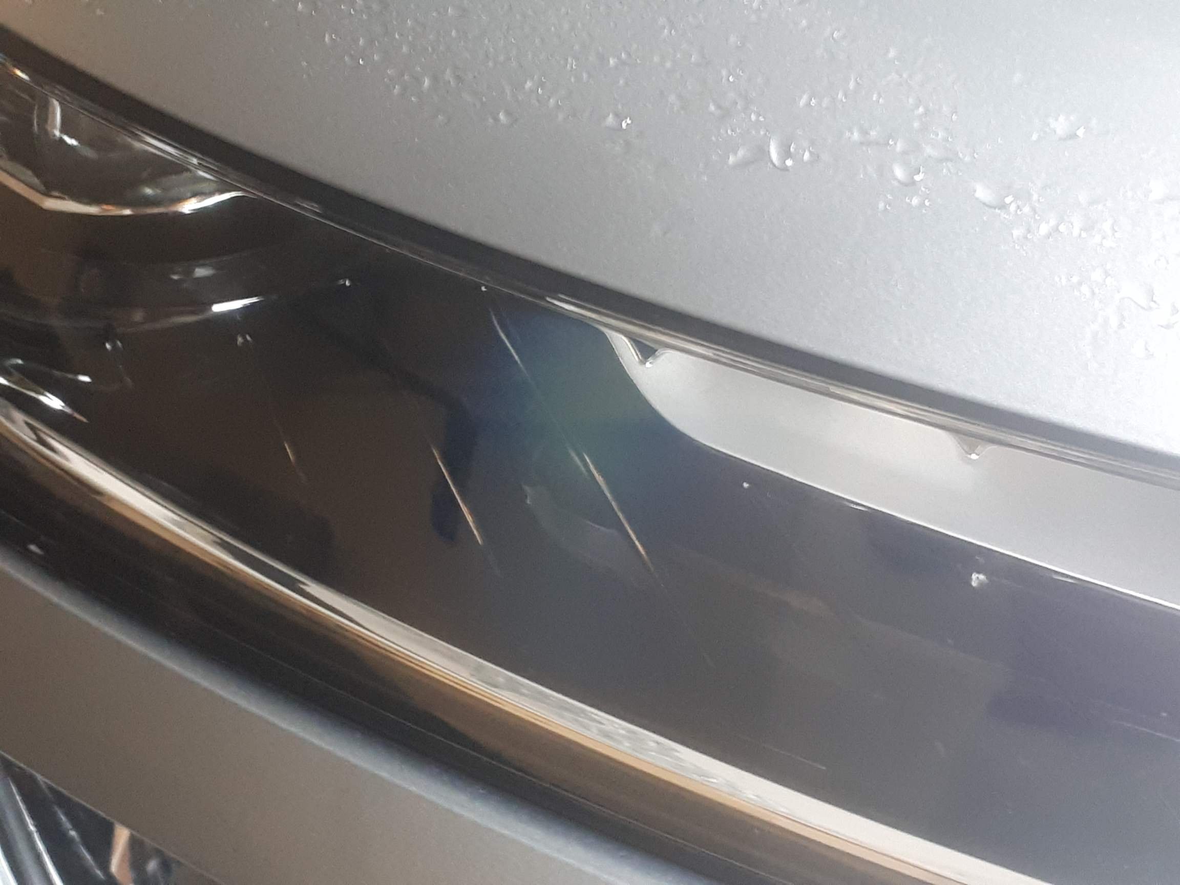

  11. Kodiaq MY2019, LED headlights. Headlight at right side has some colored spot in the area where LED beam is going through. Headlight at left side has become a bit blurry wherever the ED beam has shining through. My warranty has expired last year. Can I get replacement of the affected parts? is there a claim like "the ife expectancy of the part should be much longer"... or so?
