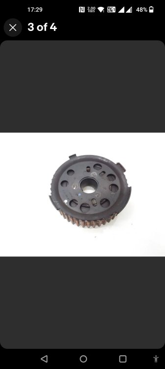

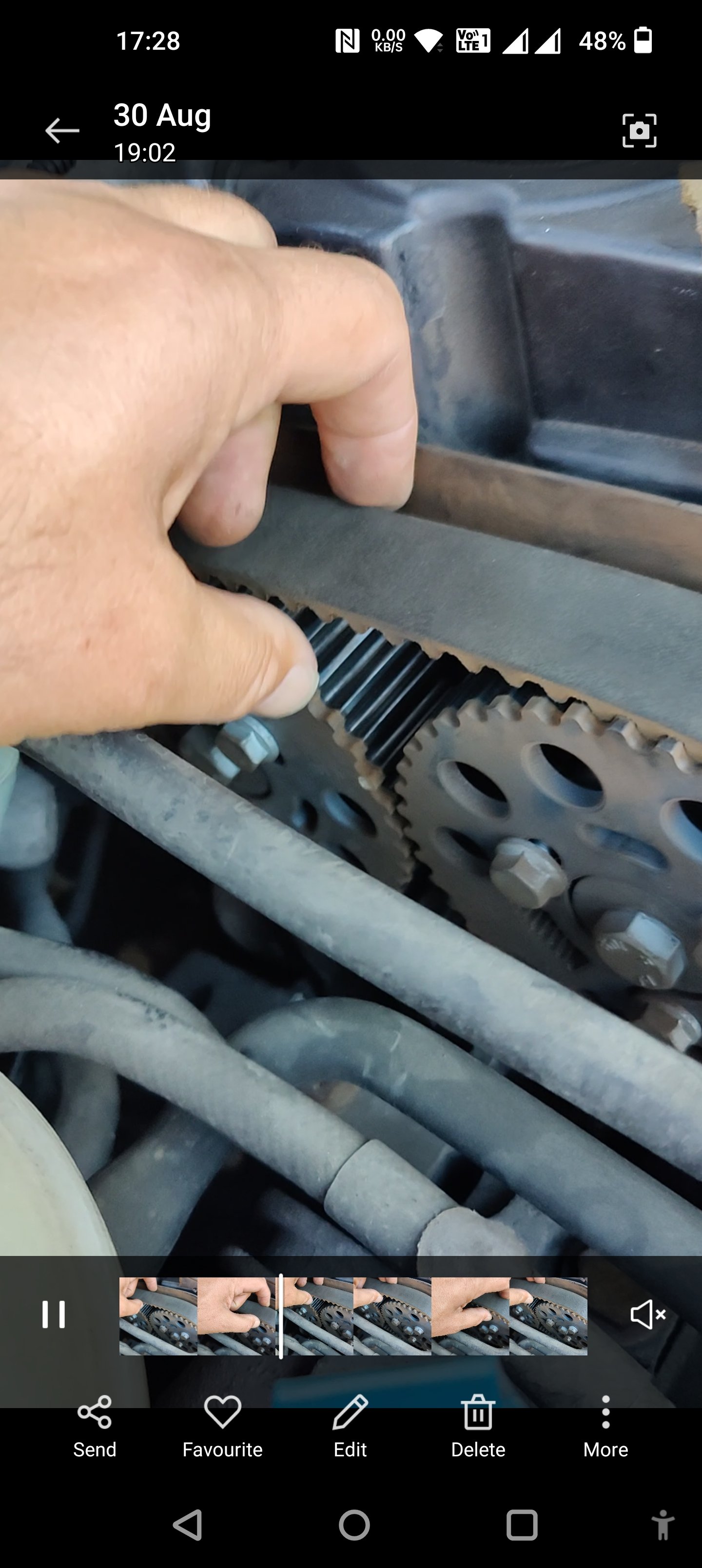

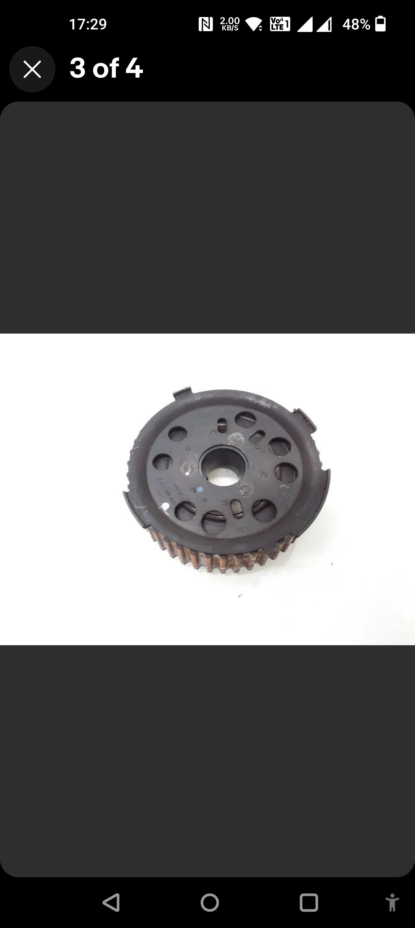

So i have a 2007 vrs Octavia Diesel and what's happend it was a pig to start so called AA out fault on the scan was cam sensor and crank sensor... So after they went i whipped the cambelt cover off an the cambelt is quite loose.. Also on the right tooth wheel (cam wheel) the silver plate that's fixed to the cog itself has come loose..  What can I do now? Obviously car is parked up now.. I will try an attach a picture to this post so show the prob and the part ive found on net
Hello D Master, welcome to the forum. Almost certainly your cam belt tensioner has failed. Warning, do not rotate the engine any further until you can get it checked.
Are you also saying that one of the cam gear wheels appears to be loose on the camshaft?
Or the tensioner stud has failed
Either way, the cambelt tensioner is not operating correctly, and it is only great good fortune that has had this detected whilst the engine is stopped. Has it failed whist you were driving, a fortunate result would have been one broken camshaft.
Worse results might include 2 broken camshafts, one or more chipped pistons and a rod through the block.

Its always been a pig to start so at first i thought ahh. Must be glow plugs.. But defo not them..  the cae cranks ok but won't start easily( it will eventually) but until i can get it looked at I won't bother now.. This is the plate on the back of This wheel that has come loose.. See pic.. This is rear of the cog
I rather suspect a broken camshaft as well as the tensioner!

Where is that drive sprocket from - is it the injection sprocket?
3 hours ago, DervMaster said:
What makes you  suggest that?
It actually happened to me, but I was driving at the time when the camshaft stopped and the crankshaft didn't!
Yes
