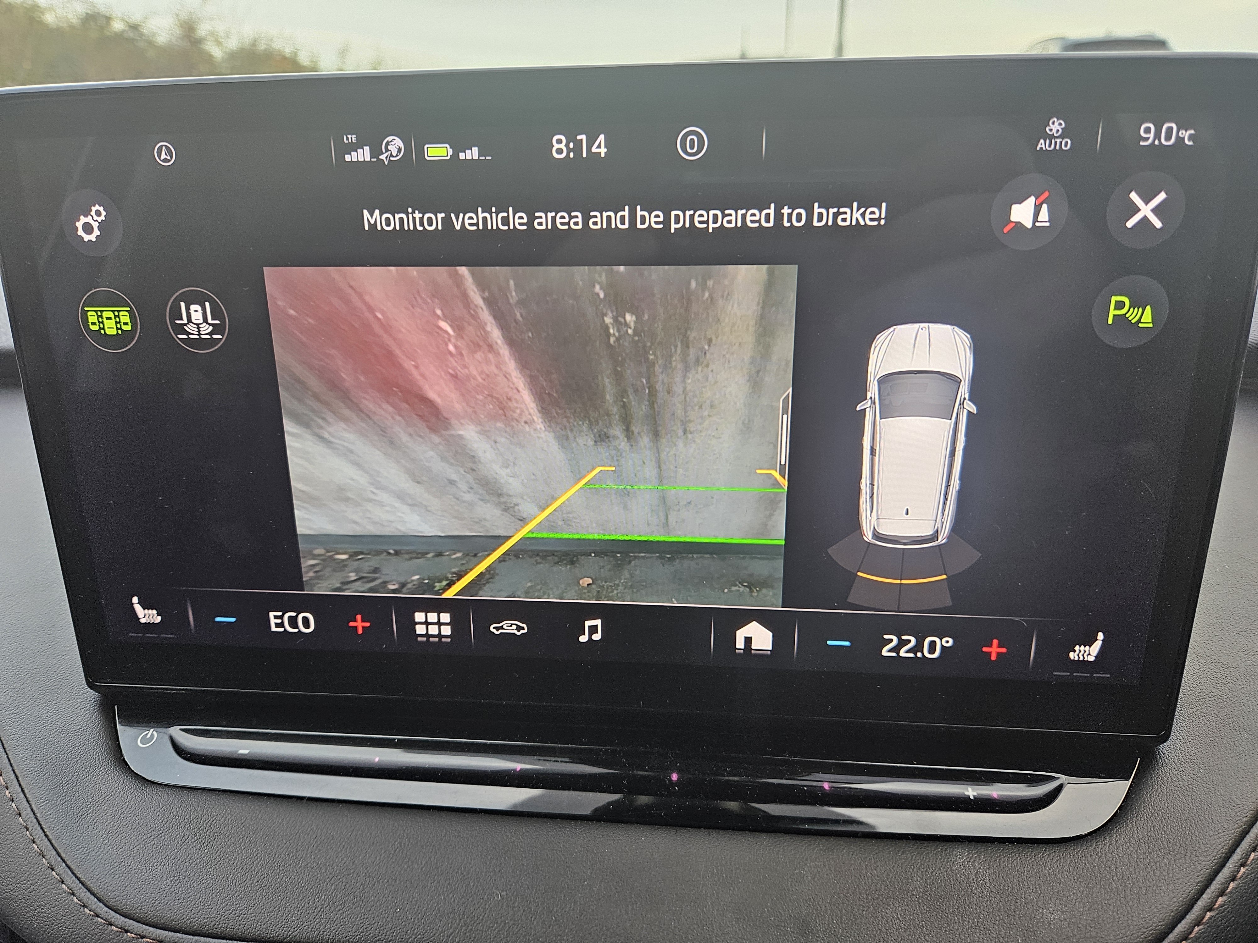

  1. Hello! I was just wondering if anyone had done this retrofit and if they had any issues coding? I have just finished installing it and have everything up and running but my camera video feed is off to one side. Anyone know if this is a coding issue or just needs recalibrating? Any help much appreciated as I am completely stuck!

  3. Cheers for the help @ApertureS I did wonder if it might be a bit old. I do have some codes show up in VCDS mainly relating to the rear vents that don't show up with the original unit: Chassis Type: NP-SK48 (3Q0) Scan: 01 02 03 05 08 09 10 13 15 16 17 19 2B 36 42 44 4B 52 5F 6C 75 BB BC VIN: TMBBJ7NP1J7570828 Mileage: 102997km-63999miles 01-Engine -- Status: Malfunction 0010 02-Auto Trans -- Status: OK 0000 03-ABS Brakes -- Status: OK 0000 05-Acc/Start Auth. -- Status: OK 0000 08-Auto HVAC -- Status: Malfunction 0010 09-Cent. Elect. -- Status: OK 0000 10-Park/Steer Assist -- Status: OK 0000 13-Auto Dist. Reg -- Status: OK 0000 15-Airbags -- Status: OK 0000 16-Steering wheel -- Status: OK 0000 17-Instruments -- Status: OK 0000 19-CAN Gateway -- Status: OK 0000 2B-Steer. Col. Lock -- Status: OK 0000 36-Seat Mem. Drvr -- Status: OK 0000 42-Door Elect, Driver -- Status: OK 0000 44-Steering Assist -- Status: OK 0000 4B-Multifunc. Module -- Status: OK 0000 52-Door Elect, Pass. -- Status: OK 0000 5F-Information Electr. -- Status: OK 0000 6C-Back-up Cam. -- Status: Malfunction 0010 75-Telematics -- Status: OK 0000 BB-Door Rear Drv -- Status: OK 0000 BC-Door Rear Pass -- Status: OK 0000 ------------------------------------------------------------------------------- Address 01: Engine (J623-DFHA) Labels:. 04L-907-309-V1.clb Part No SW: 04L 906 026 TM HW: 04L 907 309 P Component: R4 2.0l TDI X25 6312 Revision: B4X25--- CVN: 6369B71DB866C2AD00000000 Coding: 01250412036405083000 Shop #: WSC 00000 000 00000 ASAM Dataset: EV_ECM20TDI01104L906026TM 005001 ROD: EV_ECM20TDI01104L906026TM_SK48.rod VCID: 0849976C22B4A17A673-805C VINID: 91D4926877A005A1C51C020220FCC39D2A 1 Fault Found: 28992 - No Communications with NOX Sensor 2 U029E 00 [00100111] - - Not Confirmed - Tested Since Memory Clear Freeze Frame: Fault Priority: 2 Fault Frequency: 1 Mileage: 102997 km Date: 2024.04.29 Time: 08:28:35 Engine RPM: 0.00 /min Normed load value: 0.0 % Vehicle speed: 0 km/h Coolant temperature: 85 C Intake air temperature: 78 C Ambient air pressure: 990 mbar Voltage terminal 30: 12.220 V Unlearning counter according OBD: 40 Limitation: accelerator pedal: 0.0 Nm CAN status - engine control module-Bits 0-7: 0 Cruise Control System (CCS): status-Bits 0-7: 0 CAN status - transmission control module-Bits 0-7: 0 CAN status - brake control module 1-Bits 0-7: 0 CAN status - brake control module 2-Bits 0-7: 0 selected gear-Bits 0-7: 0 Readiness: 0 0 0 0 1 ------------------------------------------------------------------------------- Address 02: Auto Trans (J743) Labels:. 0BH-927-711.clb Part No SW: 0GC 300 042 H HW: 0GC 927 711 G Component: GSG DQ381 H06 1403 Revision: 00H06V07 CVN: FC60F4E0 Coding: 0014 Shop #: WSC 00000 000 00000 ASAM Dataset: EV_TCMDQ381061 001 ROD: EV_TCMDQ381061.rod VCID: 2B0308E0D382AA62AA1-807E No subsystems: No fault code found. ------------------------------------------------------------------------------- Address 03: ABS Brakes (J104) Labels: 5Q0-907-379-IPB-V1.clb Part No SW: 5Q0 614 517 DA HW: 5Q0 614 517 AH Component: ESC H62 0753 Revision: 00000000 Serial number: 60338000000687 Coding: 1D07929C34270B6C477F060240CB49B8492CD0E2600292753861F078C209420B00000012121212B835351919323200 Shop #: WSC 00046 000 00000 ASAM Dataset: EV_Brake1UDSContiMK100IPB 037009 ROD: EV_Brake1UDSContiMK100IPB_037_VW37.rod VCID: 73B3D0804B32B2A2221-8026 No fault code found. ------------------------------------------------------------------------------- Address 05: Acc/Start Auth. (J518) Labels:| 5Q0-959-435.clb Part No SW: 3Q0 959 435 G HW: 3Q0 959 435 G Component: VWKESSYMQB 037 0907 Revision: 00037000 Serial number: 0468930754 Dataset Number: V03935254SK 0001 Coding: 032C0C070F Shop #: WSC 33361 790 00156 ASAM Dataset: EV_KessyHellaMQBAB 004041 ROD: EV_KessyHellaMQBAB.rod VCID: 3E2531B430F02FCA1DF-806A Rear lid opener control module: No fault code found. ------------------------------------------------------------------------------- Address 08: Auto HVAC (E87) Labels:| 3V0-907-044.clb Part No SW: 3V0 907 044 AJ HW: 3V0 907 044 AJ Component: AC Automat H32 3601 Revision: 20K04000 Serial number: 00000B00034578 Coding: 11110104002110011005004C0010102A Shop #: WSC 33361 790 00063 ASAM Dataset: EV_ACClimaPrehVW37X 002009 ROD: EV_ACClimaPrehVW37X_002_VW37.rod VCID: 7CA1FBBC666CFDDA73B-8028 2 Faults Found: 197634 - Temperature Sensor for Rear Vent B1089 15 [00001001] - Open or Short to Plus Confirmed - Tested Since Memory Clear Freeze Frame: Fault Priority: 3 Fault Frequency: 1 Reset counter: 58 Mileage: 102997 km Date: 2024.04.29 Time: 08:28:33 Outside temperature: 15.5 C Vehicle speed: 0 km/h Voltage terminal 30: 12.1 V 328455 - Position Sensor for Rear Temperature Flap Motor B1096 15 [00001001] - Open or Short to Plus Confirmed - Tested Since Memory Clear Freeze Frame: Fault Priority: 2 Fault Frequency: 1 Reset counter: 58 Mileage: 102997 km Date: 2024.04.29 Time: 08:28:33 Voltage terminal 30: 12.1 V Inside temperature: 12.5 C Outside temperature: 15.5 C Rear temperature flap: actual value: 0.0 % Rear temperature flap: actual value: 512 Rear temperature flap: specified value: 414 ------------------------------------------------------------------------------- Address 09: Cent. Elect. (J519) Labels:. 5Q0-937-08X-V2.clb Part No SW: 5Q0 937 084 CQ HW: 5Q0 937 084 CG Component: BCM MQBAB H H36 0253 Serial number: 01001803300303 Dataset Number: V03935274XW 0001 Coding: 000000000000000000000000000000000000000000000000000000000000 Shop #: WSC 33361 790 00156 ASAM Dataset: EV_BCMMQB 018001 ROD: EV_BCMBOSCH_018.rod VCID: 094F926839BED87278D-805C Wiper motor control module: Subsystem 1 - Part No SW: 3V2 955 119 HW: 3V1 955 119 Labels: 5QX-955-119-V1.CLB Component: 48x RL 150304 032 0121 Serial number: 00000001503020600254 Coding: 165DDD Rain/Light Recognition Sensor: Subsystem 2 - Part No SW: 5Q0 955 547 B HW: 5Q0 955 547 B Labels: 5Q0-955-547.CLB Component: RLHS 047 0105 Serial number: S5Y18M02D06H07M57S53 Coding: 00084D Anti-theft alarm system sensor: Subsystem 3 - Part No SW: 5Q0 951 172 HW: 5Q0 951 172 Component: Sensor, DWA 005 0316 Serial number: 000000000ZY1734116T7 Alarm horn: Subsystem 4 - Part No SW: 5QD 951 605 HW: 5QD 951 605 Component: Sirene, DWA 005 0314 Serial number: 00002856223972902210 No fault code found. ------------------------------------------------------------------------------- Address 10: Park/Steer Assist (J791) Labels:| 5Q0-919-298.clb Part No SW: 5QA 919 298 D HW: 5QA 919 298 A Component: PLA 3.0 12KH07 0050 Serial number: 000308417320181 Dataset Number: V03935278BG 0001 Coding: 0431151851 Shop #: WSC 12345 123 12345 ASAM Dataset: EV_EPHVA2CAU3700000 009041 ROD: EV_EPHVA2CAU3700000_VW41.rod VCID: 51FF7A08916EA0B2F0D-8004 No fault code found. ------------------------------------------------------------------------------- Address 13: Auto Dist. Reg (J428) Labels:| 3Q0-907-572.clb Part No SW: 3Q0 907 572 C HW: 3Q0 907 572 C Component: ACC BOSCH MQB H04 0195 Dataset Number: V03935249LS 0001 Coding: 3200678151FFC428949C8045 Shop #: WSC 33361 790 00156 ASAM Dataset: EV_ACCBOSCHVW48X 001009 ROD: EV_ACCBOSCHVW48X.rod VCID: 35372E9805C6EC92CC5-8060 No fault code found. ------------------------------------------------------------------------------- Address 15: Airbags (J234) Labels:| 5Q0-959-655.clb Part No SW: 5Q0 959 655 BH HW: 5Q0 959 655 BH Component: AirbagVW21 005 0336 Serial number: 003VVR3V9FP3 Dataset Number: V03935255BE 0001 Coding: 98CCC0C0000000005C5400CF00C800000065 Shop #: WSC 33361 790 00156 ASAM Dataset: EV_AirbaVW20SMEVW37X 002158 ROD: EV_AirbaVW20SMEVW37X_VW37.rod VCID: 074B94502FAAAE026E9-8052 Crash sensor for side airbag: driver side: Subsystem 1 - Part No SW: ----------- HW: 480 003 001 18 Component: SideSensor_Df 001 0887 Serial number: 357000000006E8D42B2W Coding: 2D2D2D Front Passenger's Side Airbag Crash Sensor: Subsystem 2 - Part No SW: ----------- HW: 480 003 001 18 Component: SideSensor_Pf 001 0887 Serial number: 358000000001E8D42B2S Coding: 2D2D2D Rear Side Airbag Crash Sensor (on driver's side): Subsystem 3 - Part No SW: ----------- HW: 480 403 101 18 Component: SideSensor_Dr 000 6149 Serial number: 3510001BB28D6142761$ Coding: 2D2D2D Passenger side rear thorax airbag crash sensor: Subsystem 4 - Part No SW: ----------- HW: 480 402 901 18 Component: SideSensor_Pr 000 6149 Serial number: 3520001AD28A2CC366DM Coding: 2D2D2D Crash sensor for front airbag: driver side: Subsystem 5 - Part No SW: ----------- HW: 480 403 101 18 Component: FrontSensor_D 000 6149 Serial number: 3550001A328C22E512E3 Coding: 2D2D2D No fault code found. ------------------------------------------------------------------------------- Address 16: Steering wheel (J524) Labels:| 5Q0-953-549.clb Part No SW: 5Q0 953 569 C HW: 5Q0 953 569 C Component: Lenks.Modul 100 0265 Revision: -------- Serial number: 20230505500383 Coding: 6014 Shop #: WSC 01286 386 08256 ASAM Dataset: EV_SMLSVALEOMQBLRH 001009 ROD: EV_SMLSVALEOMQBLRH.rod VCID: 3E2531B430F02FCA1DF-806A No fault code found. ------------------------------------------------------------------------------- Address 17: Instruments (J285) Labels:| 5G0-920-XXX-17.clb-SRI3 Part No SW: 3VD 920 790 HW: 3VD 920 790 Component: KOMBI 505 1710 Coding: 25A5011A2F80A600018863011001000800000000 Shop #: WSC 00046 000 00000 ASAM Dataset: EV_DashBoardVDDMQBA0 001031 ROD: EV_DashBoardVDDMQBA0_001_VW37.rod VCID: 0849976C22B4A17A673-805C No fault code found. ------------------------------------------------------------------------------- Address 19: CAN Gateway (J533) Labels:| 3Q0-907-530-V1.clb Part No SW: 3Q0 907 530 L HW: 3Q0 907 530 C Component: GW MQB High 518 5323 Serial number: 29011810520042 Dataset Number: V03935276GC 0001 Coding: 030100045F087300EB00025A1C0F00010001070000000000000000000000 Shop #: WSC 33361 790 00160 GVL: 01563C0000000600401C80008002C80000000000000200000000000000000000 ASAM Dataset: EV_GatewNF 013023 ROD: EV_GatewNF_VW37.rod VCID: 382927AC12D411FAD73-806C Generator: Multifunction steering wheel control module: Subsystem 2 - Part No SW: 3V0 919 719 H HW: 3V0 919 719 H Component: E221__MFL-PR6 H03 0180 Serial number: 000000000A2948240919 Battery Monitoring Control Module: Subsystem 3 - Part No SW: 5Q0 915 181 K HW: 5Q0 915 181 K Component: J367-BDMHella H10 9070 Serial number: 1108436404 No fault code found. ------------------------------------------------------------------------------- Address 2B: Steer. Col. Lock (J764) Labels:| 1EA-905-861.clb Part No SW: 3Q0 905 861 B HW: 3Q0 905 861 B Component: ELV-MQBB H05 0020 Serial number: 18000007836006 Coding: 0800000000000000 Shop #: WSC 33361 790 00156 ASAM Dataset: EV_ELVMarqMQBA0 002002 ROD: EV_ELVMarqMQBA0_SK48.rod VCID: 333310800BB2F2A2E21-8066 No fault code found. ------------------------------------------------------------------------------- Address 36: Seat Mem. Drvr (J810) Labels:* None Part No SW: 5Q0 959 760 C HW: 5Q0 959 760 C Component: Sitzmemory H09 0024 Serial number: Y0006RB426277 Dataset Number: V03935281EC 0001 Coding: 0014000000000500018280808080000000008181000000D400 Shop #: WSC 33361 790 00156 ASAM Dataset: EV_SeatMemorDriveSide 002022 ROD: EV_SeatMemorDriveSide.rod VCID: 3D2736B83DF634D2045-8068 No fault code found. ------------------------------------------------------------------------------- Address 42: Door Elect, Driver (J386) Labels:| 5QX-959-X93-42.clb Part No SW: 5Q4 959 593 E HW: 5Q4 959 593 B Component: TSG FS 011 0032 Serial number: 0000302254915 Dataset Number: V03935256LT 0001 Coding: 001D8020DE01040000001100 Shop #: WSC 33361 790 00156 ASAM Dataset: EV_DCUDriveSideEWMAXCONT 006001 ROD: EV_DCUDriveSideEWMAXCONT.rod VCID: 47CB54506F2A6E02AE9-8012 No fault code found. ------------------------------------------------------------------------------- Address 44: Steering Assist (J500) Labels:| 5Q0-909-144.clb Part No SW: 5Q0 909 144 AA HW: 5Q0 909 144 AA Component: EPS_MQB_ZFLS 130 1081 Dataset Number: V03935273KF 0001 Coding: 81170000 Shop #: WSC 33361 790 00156 ASAM Dataset: EV_SteerAssisMQB 015157 ROD: EV_SteerAssisMQB_015.rod VCID: 73B3D0804B32B2A2221-8026 No fault code found. ------------------------------------------------------------------------------- Address 4B: Multifunc. Module (J745) Labels:| 3Q0-907-338-V1.clb Part No SW: 3Q0 907 338 HW: 3Q0 907 338 Component: FCM MQB Low 002 0286 Serial number: 27011810524395 Dataset Number: V03935274LG 0001 Coding: 000000020100066E00003F01000000000000000000000000000000000000 Shop #: WSC 33361 790 00156 ASAM Dataset: EV_MultiModulContiVW48X 001010 ROD: EV_MultiModulContiVW48X_001.rod VCID: 72BDD5843428BBAA297-8026 Left Headlamp Power Output Stage: Subsystem 1 - Part No SW: 8U0 941 329 HW: 8U0 941 329 Component: Leimo links H01 0006 Coding: 000000 Right Headlamp Power Output Stage: Subsystem 2 - Part No SW: 8U0 941 329 HW: 8U0 941 329 Component: Leimo rechts H01 0006 Coding: 000000 No fault code found. ------------------------------------------------------------------------------- Address 52: Door Elect, Pass. (J387) Labels:| 5QX-959-X92-52.clb Part No SW: 5Q4 959 592 E HW: 5Q4 959 592 B Component: TSG BFS 011 0032 Serial number: 0000301991938 Dataset Number: V03935256LV 0001 Coding: 001D0220DE01040000001100 Shop #: WSC 33361 790 00156 ASAM Dataset: EV_DCUPasseSideEWMAXCONT 006001 ROD: EV_DCUPasseSideEWMAXCONT.rod VCID: 46D559546820770A55F-8012 No fault code found. ------------------------------------------------------------------------------- Address 5F: Information Electr. (J794) Labels:| 3V0-035-MIB-HGH2.clb Part No SW: 565 035 021 B HW: 565 035 021 Component: MU-H-LND-EU H54 1240 Serial number: A853A0JS025626 Dataset Number: V03935271AF 0001 Coding: 03840101FF00000041111201008808102F0100E601200400DE Shop #: WSC 33361 790 00156 ASAM Dataset: EV_MUHig4CGen2HBAS 001001 ROD: EV_MUHig4CGen2HBAS_AU37.rod VCID: 0D47A6784DD6C452545-8058 Display and control head 1 for information electronics: Subsystem 1 - Part No SW: 3V0 919 606 D HW: 3V0 919 606 D Component: ABT_High-2 H50 9130 Serial number: SKZ6ZHV0314019 Data carrier: Subsystem 2 - Part No SW: V03 959 810 C HW: ----------- Component: ECE 2022 --- 0195 Serial number: -------------------- Compact disc data bank: Subsystem 3 - Part No SW: V03 959 800 EG HW: ----------- Component: Gracenote2 --- 1017 Serial number: -------------------- No fault code found. ------------------------------------------------------------------------------- Address 6C: Back-up Cam. (J772) Labels:| 5Q0-980-556.clb Part No SW: 5Q0 980 556 B HW: 4M0 980 556 A Component: RVC Compact H18 0231 Dataset Number: V03935257YE 0001 Coding: 047300010600041F000040 Shop #: WSC 12345 123 12345 ASAM Dataset: EV_CamSysRVRVCPANAMQBAB 006009 ROD: EV_CamSysRVRVCPANAMQBAB.rod VCID: 392F22A829DE08F228D-806C 1 Fault Found: 10489856 - No Basic Setting B2010 00 [00001001] - - [RearView system not calibrated] Confirmed - Tested Since Memory Clear Freeze Frame: Fault Priority: 5 Fault Frequency: 1 Reset counter: 58 Mileage: 102997 km Date: 2024.04.29 Time: 08:28:33 passive ------------------------------------------------------------------------------- Address 75: Telematics (J949) Labels:| 5QE-035-285.clb Part No SW: 5NA 035 284 B HW: 5NA 035 284 B Component: OCULowMQBLGE H17 0718 Revision: -------- Dataset Number: V03935277FY 0001 Coding: 03840101EA421A0D3B1C9E000045400382E608 Shop #: WSC 33361 790 00156 ASAM Dataset: EV_OCULowMQBLGE 004044 ROD: EV_OCULowMQBLGE_004_VW37.rod VCID: 3C213BBC26EC3DDA33B-8068 No fault code found. ------------------------------------------------------------------------------- Address BB: Door Rear Drv (J388) Labels:* None Part No SW: 5Q4 959 595 E HW: 5Q4 959 595 B Component: TSG HFS 012 0032 Serial number: 0000302984496 Dataset Number: V03935256MF 0001 Coding: 001880208001040000001100 Shop #: WSC 33361 790 00156 ASAM Dataset: EV_DCURearDriveMAXCONT 006001 ROD: EV_DCURearDriveMAXCONT.rod VCID: 49CF5268793E9872B8D-801C No fault code found. ------------------------------------------------------------------------------- Address BC: Door Rear Pass (J389) Labels:* None Part No SW: 5Q4 959 595 E HW: 5Q4 959 595 B Component: TSG HBFS 012 0032 Serial number: 0000302153229 Dataset Number: V03935256ML 0001 Coding: 001880208001040000001100 Shop #: WSC 33361 790 00156 ASAM Dataset: EV_DCURearPasseMAXCONT 006001 ROD: EV_DCURearPasseMAXCONT.rod VCID: 49CF5268793E9872B8D-801C No fault code found. End----------(Elapsed Time: 01:36, VBatt start/end: 12.2V/12.2V)----------- I've spotted another version on ebay at the moment - 3V0 907 044 EG which is from a 2017 Superb. It's still a year earlier though and shows an earlier software version (i assume thats what the SW number is) of SW4101. Mine was a 2018 with SW4402. Don't suppose you know if thats likely to work?
