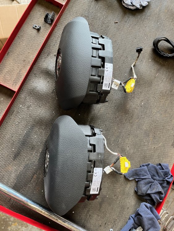

The airbag difference is a PITA. After 2020 i believe they kept the 'heated' airbag design for all cars with or without heated wheels.
On 06/08/2023 at 20:34, ApertureS said:
Always good to see people writing more guides!
Ah yes, thank you, that is something that rings a bell from the research I did before starting the job.
Definitely worth checking what airbag you’ve got before committing to the retrofit because you might already have the right one 👍🏻

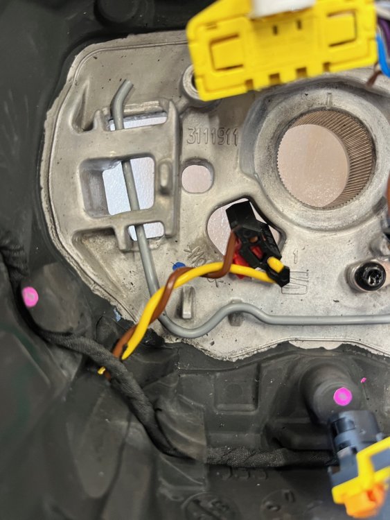

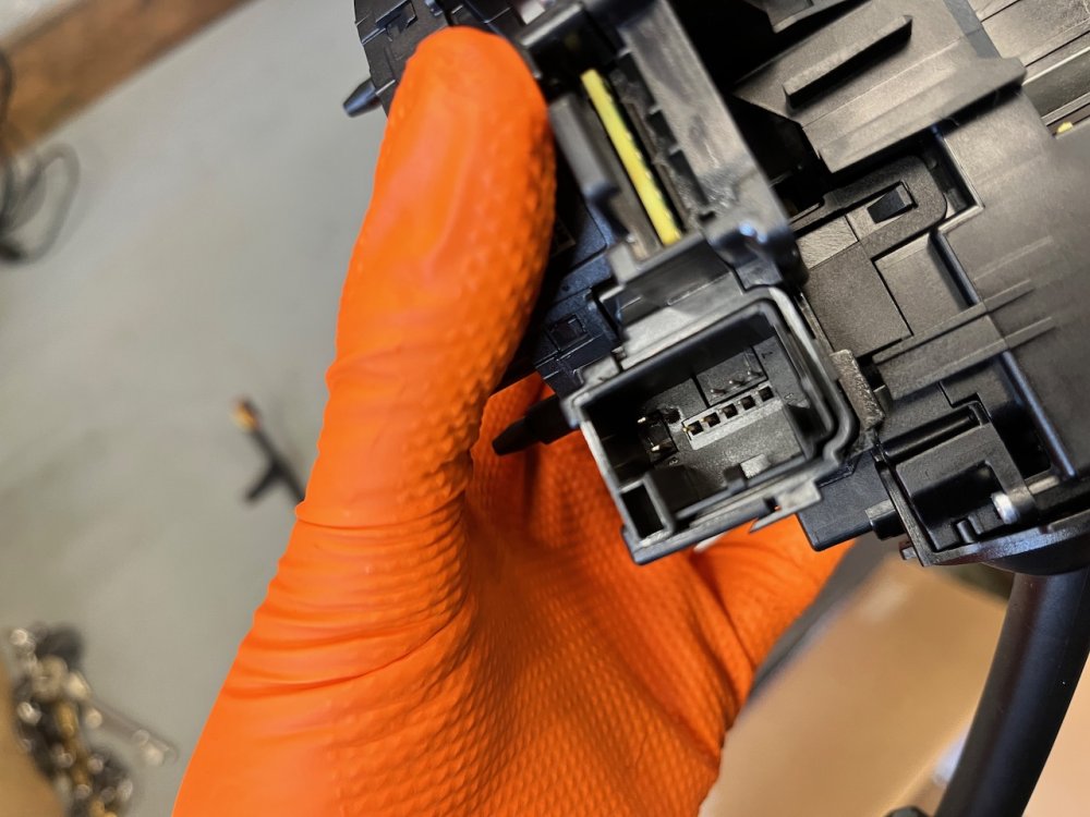

Nice work! I’ve just sorted this on a car but the car didn’t have a CAN Terminal 15 connection on the existing clock spring so there were only 8 pins in the 16 pin connection so the wheel buttons don’t work and there is an error in Module 19. Has anyone had this issue before? Thanks 🙏
Got a picture of the pins you did have? I’ll check it against a wiring diagram.
mine had only 7 pins and I’ve got no issues.
What we’re the specs of the car? And did the wheel buttons work before?
the wheel buttons go straight through on a LINbus pin to the gateway - pin 8 (new 14 pin connector) is a violet/white wire which is the one for the steering controls.

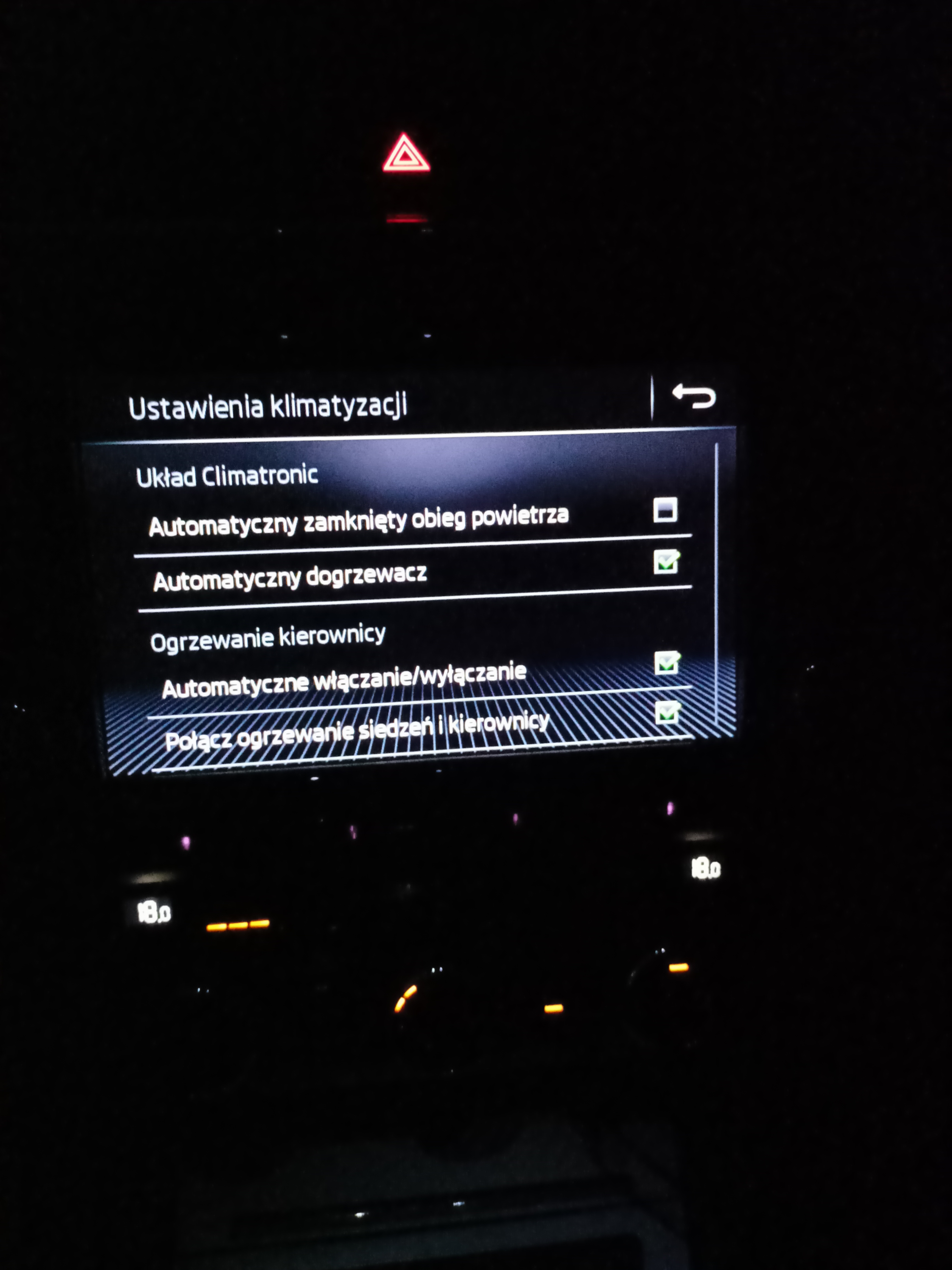

Hi to everyone, i'm from Poland, first of all sorry for my language, I tried to retrofit heated steering wheel on my octavia 3 2014, but without happy end. I changed clockspring to 5q0953549d, add wire connections, changed steering wheel with heating. I coded HVAC byte 2 and 3. After that  heating is not working and three is no errors on HVAC. The icon of heated steering wheel exist, but highlights Orange just one second and after that still is white. Thanks in advance for your help. Adam

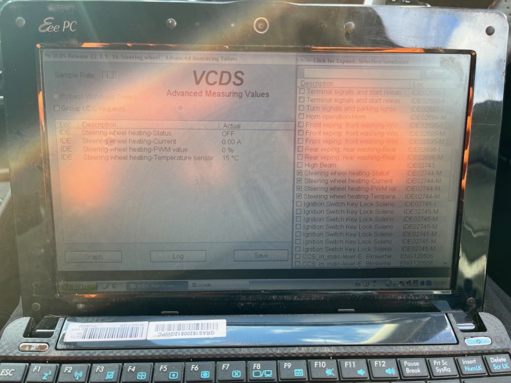

This is normally caused by a fault with the temperature sensor in the wheel.
Have you checked live data to see if you have an accurate temperature?

Heating is working! I upgrade can gateway and now everything is ok.

 - The HSW specific airbag for the steering wheel - part number is 6V0 880 201 T 1ZY.  God knows why but Skoda, in their wisdom, use a different airbag because the wheel is a different shape at the top. This picture shows the differences - the HSW specific airbag is at the bottom of the picture:

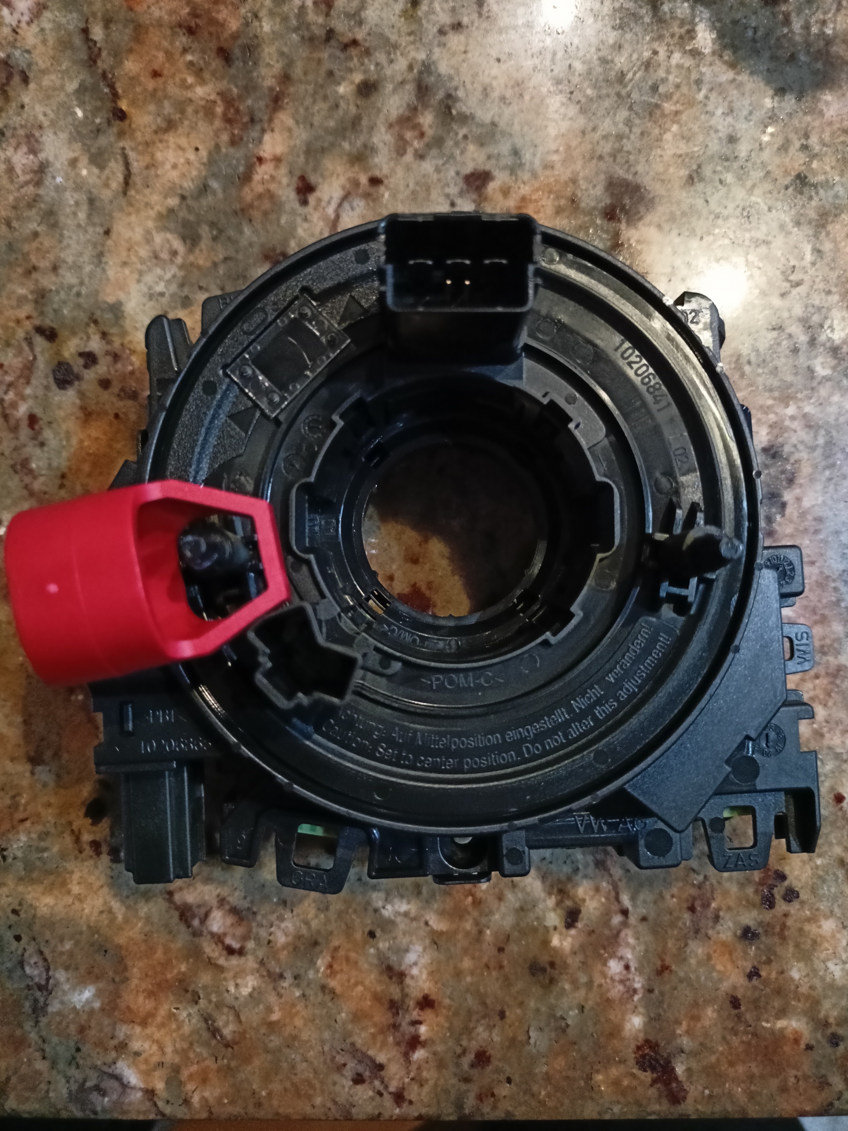

- Steering wheel control module (also known as clock spring or slip ring) - 5Q0 953 549 B or 5Q0 953 549 D. The 'D' suffix is the newest part number, supercedes the 'B' suffix and is available new on eBay for around £150. These control modules have a different type of plug (14-pin as opposed to 16-pin) which has larger power and earth pins for the HSW, pictured here:

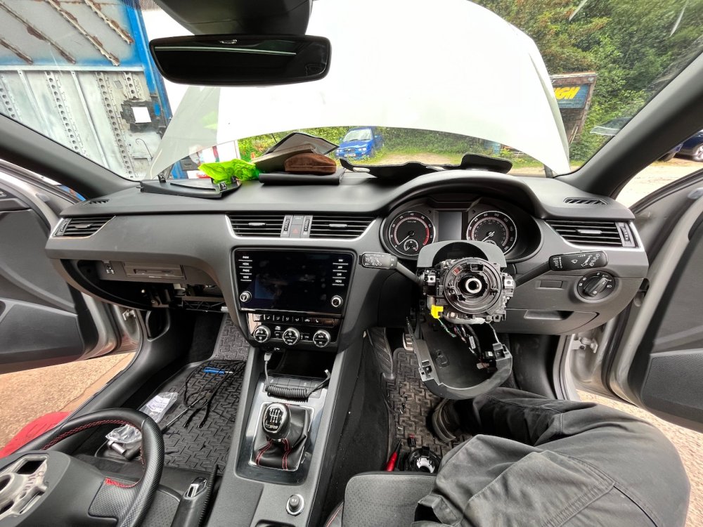

- Grab a quick VCDS snapshot of the long coding on your current steering wheel module in case you ever return the car to standard.
- Disconnect the battery
- Remove the airbag, steering wheel, column shroud trim, glovebox and centre console side trims, something like this:
 - Remove the steering wheel control module.
- Unclip and pull out the fusebox
- Run the Kufatec loom from column to the fusebox using an appropriate routing where it won't chafe on anything
- Fit the power feed and earth of the Kufatec loom to the fusebox and surrounding area according to their instructions
(if building your own loom, you can use fuse position SC24 or any along the same row - they are a terminal 30 feed)
Refit the fusebox
- Fit the new steering wheel control module
- Plug the Kufatec loom into the steering wheel control module
(if building your own loom, now is the time to re-pin the original column plug into the new 14-pin plug - this is well documented on other forums however the pin-out is as follows:

- Refit the centre console side trims and steering column shroud.
- Refit the glovebox.

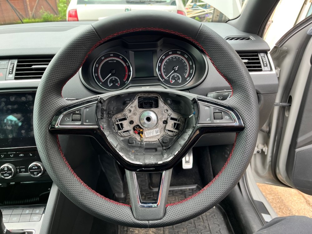

- Fit the heated steering wheel
- Fit the new airbag

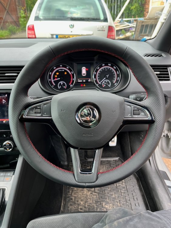

Double check you're happy with everything, then reconnect the battery. Should look something like this:
Fire up VCDS again, do the relevant coding.

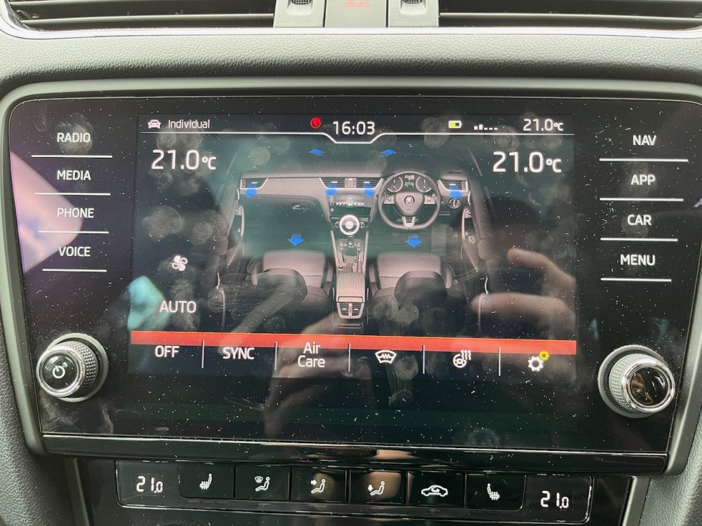

Module 08 (HVAC) - Coding - Long Coding Helper (and say "yes" to the "trying experimental features" to see more descriptions of bits)
- Byte 11: Add a tick to bit2 and bit3
- Byte 13: Choose whether you want the wheel to come on automatically with either outside temperature or wheel temperature or not at all.
Done!

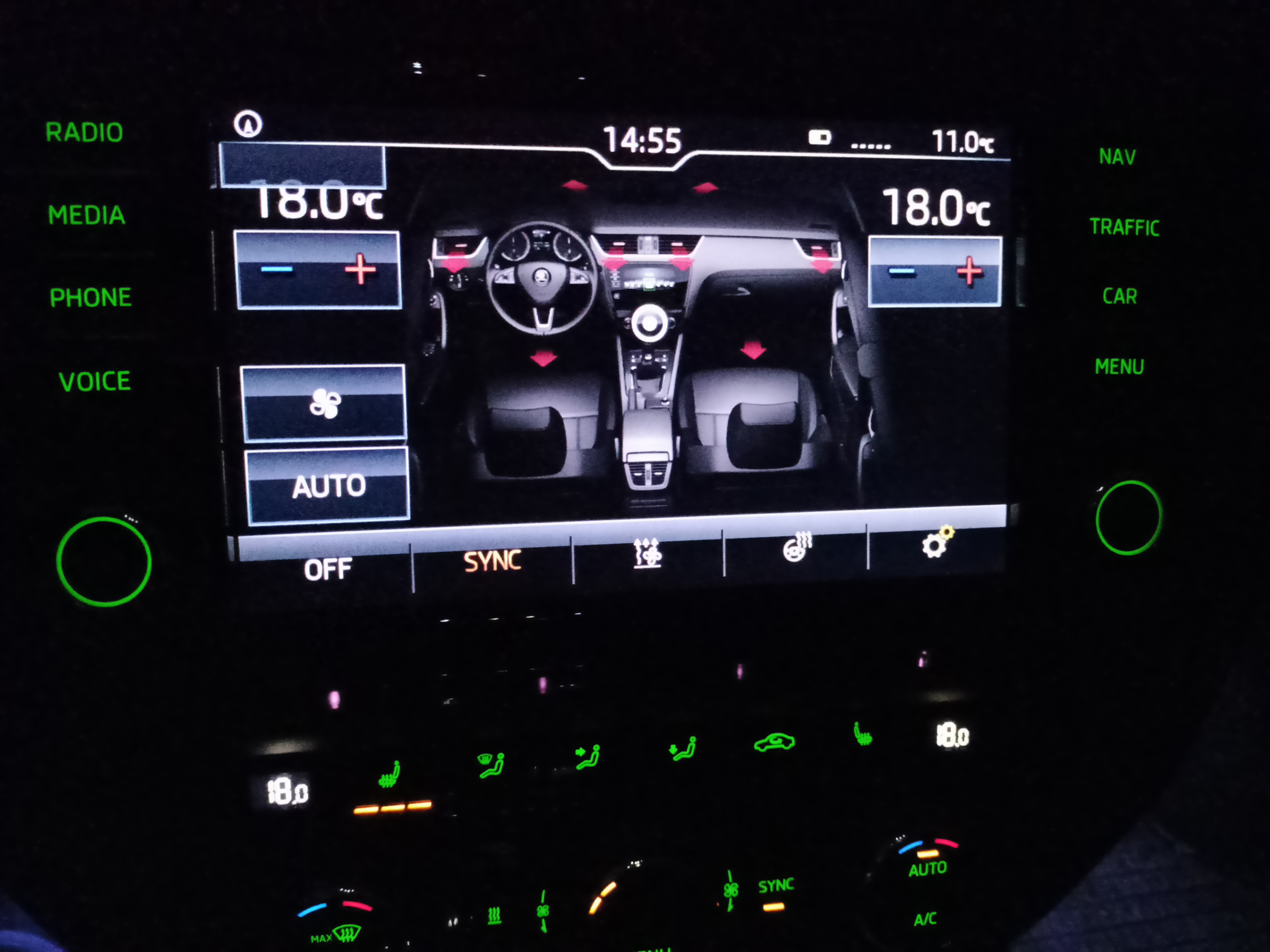

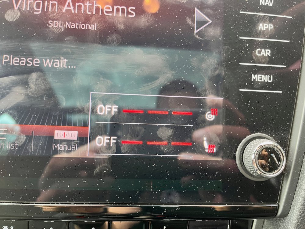

Enjoy a little HSW logo come up on your HVAC control screen (press the 'menu' button to access this screen) :

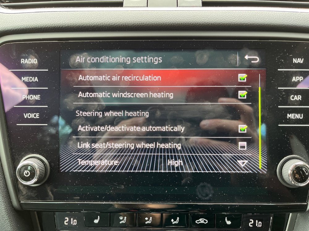

Enjoy the extra settings for the HVAC where you can alter the temperature of the HSW, decide whether you want the HSW to come on automatically (3 degrees C or below if I remember rightly) and choose if you want the HSW to come on automatically with the heated seats.
Also, if you do switch the drivers heated seat on then this option comes up where you can quickly choose the temperature of the HSW as well:
Sorry about the dust and fingerprints on the screen....it's due a clean inside.
Check on VCDS to see what's going on in the measuring blocks within Module 16 -Steering Wheel:

14 minutes ago, ApertureS said:
Am I right in thinking the heated steering button on the wheel does not work and you still need to go via the infotainment?
That’s right, albeit mine comes on automatically below 4 degrees and if I switch the heated seats on then the wheel comes on automatically and I can adjust the temperature on the screen along with the heated seats.
