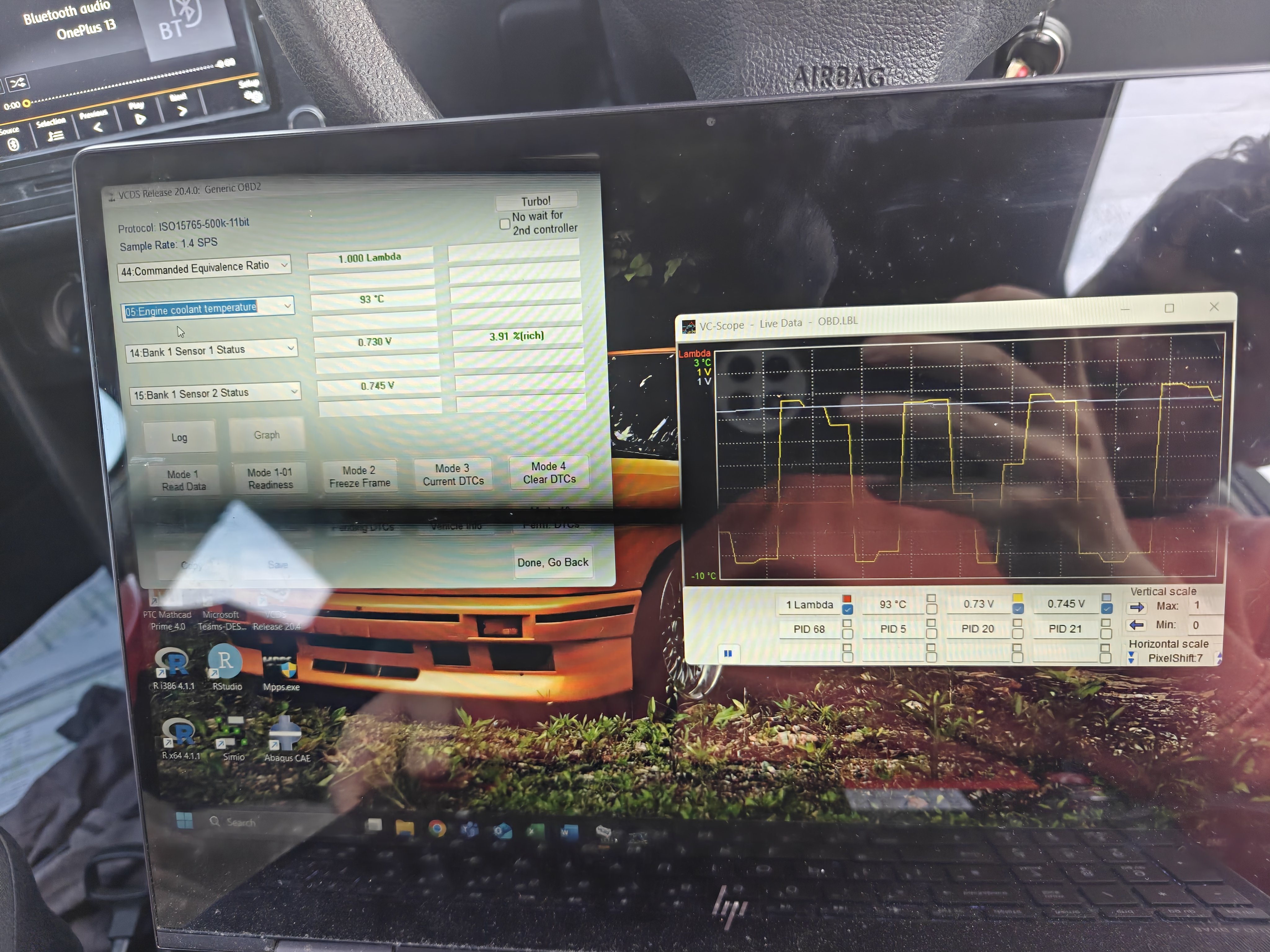

  1. Hi Pete, was reading the sensors and it seems that both sensors are working correctly, same with the coolant temp sensor, you can see from my live data that my lambda is rich at idle and at constant revs.

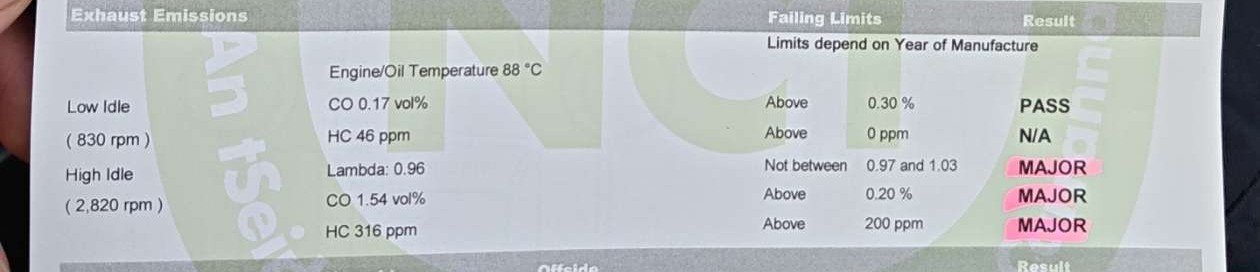

  3. I have a 2012 1.2htp. When i bought it it had a check engine light and i scanned the code it had a code for the bank 1 lambda sensor. I also noticed that it had a non genuine catalytic converter in it. I then failed on emissions (see the readings beside the pink highlighter) After i failed emissions i scanned codes again and catalytic converter inefficiency came up. I then bought a genuine second hand catalytic converter and bank 1 O2 sensor, i ran this for about 150 miles and the codes never came back. So I then put it through another NCT (MOT) As you can see from the picture with no highlighter, the Lambda has now got even worse, the CO has increased, and the HC has improved slightly. Where do I go from here. I obviously have some sort of rich fueling problem but with no fault codes I'm not really sure where to look?! Any help would be greatly appreciated.

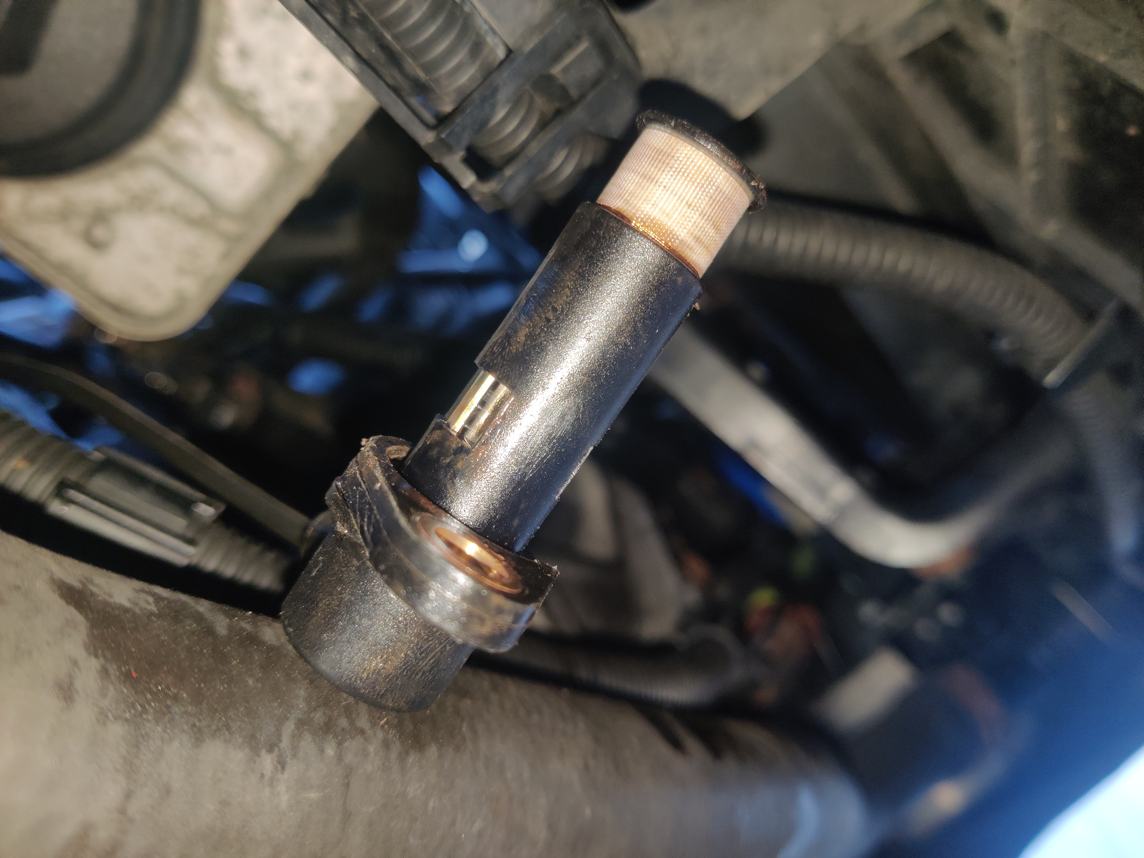

  10. I got the right part with the right part no. Its not an OEM brand though. I think that's the problem. What are the OEM brands so I can buy one thanks.

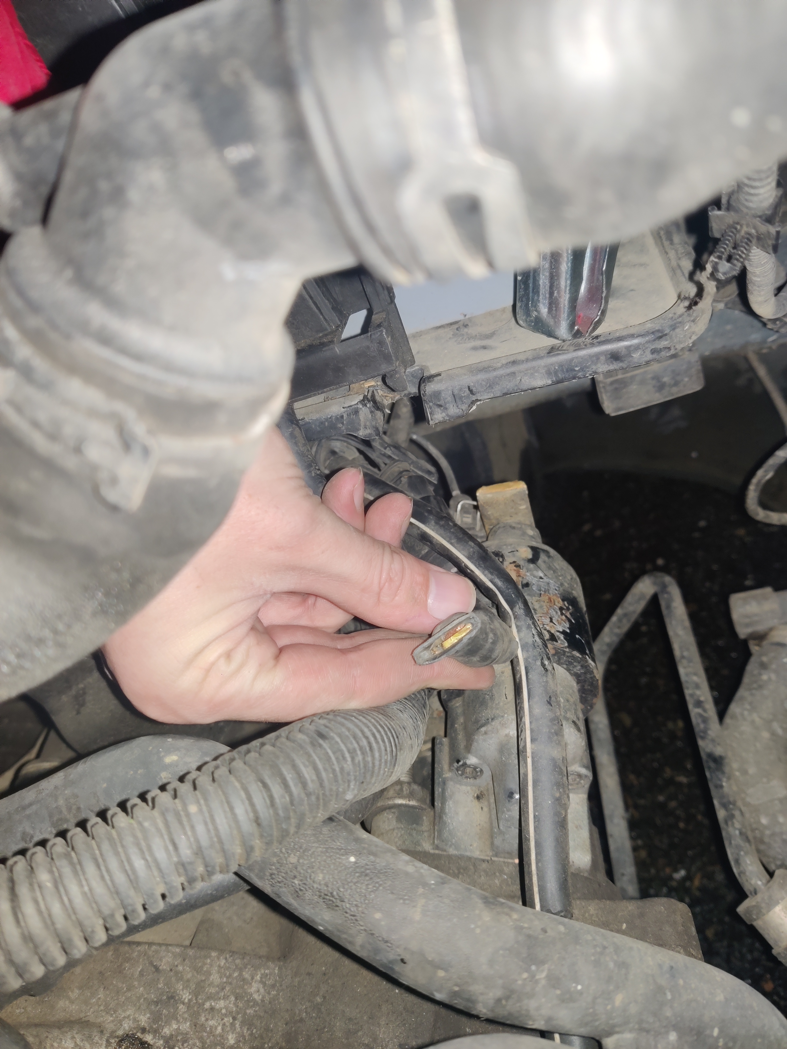

  11. UPDATE: I got the sleeve out. It was actually part of the sensor if anybody else is reading this forum in future. See the image attached. The rest of the sensor needed to be pulled out with needle nose pliers after lots of persuasion. The next problem for me is that the new sensor will not go in. It takes a lot of force to get back in. If anybody has any ideas how to get it back in it would be appreciated. Otherwise i will update when i find the solution
