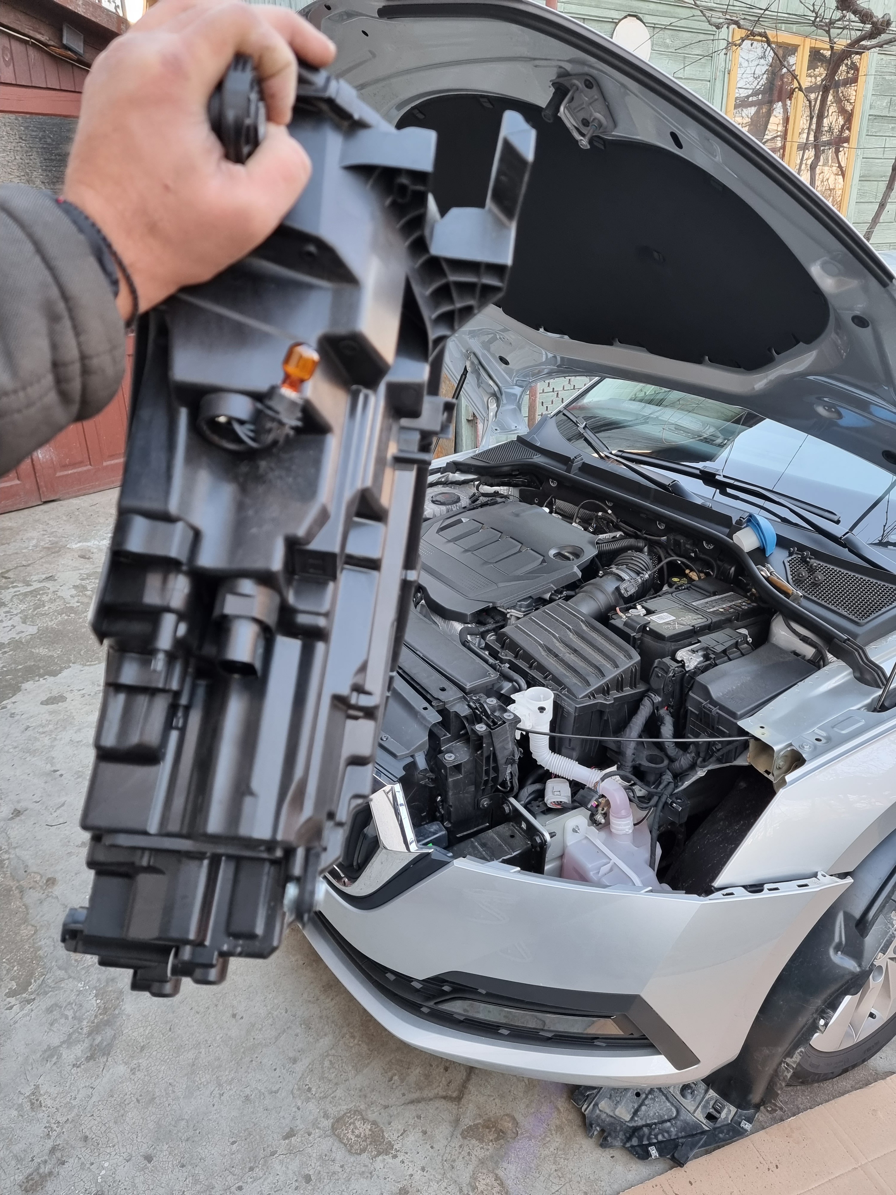

  1. You don't have space to remove the bulb without removing the whole headlight. I allready tried everything and the only solution was to remove the whole headlight...

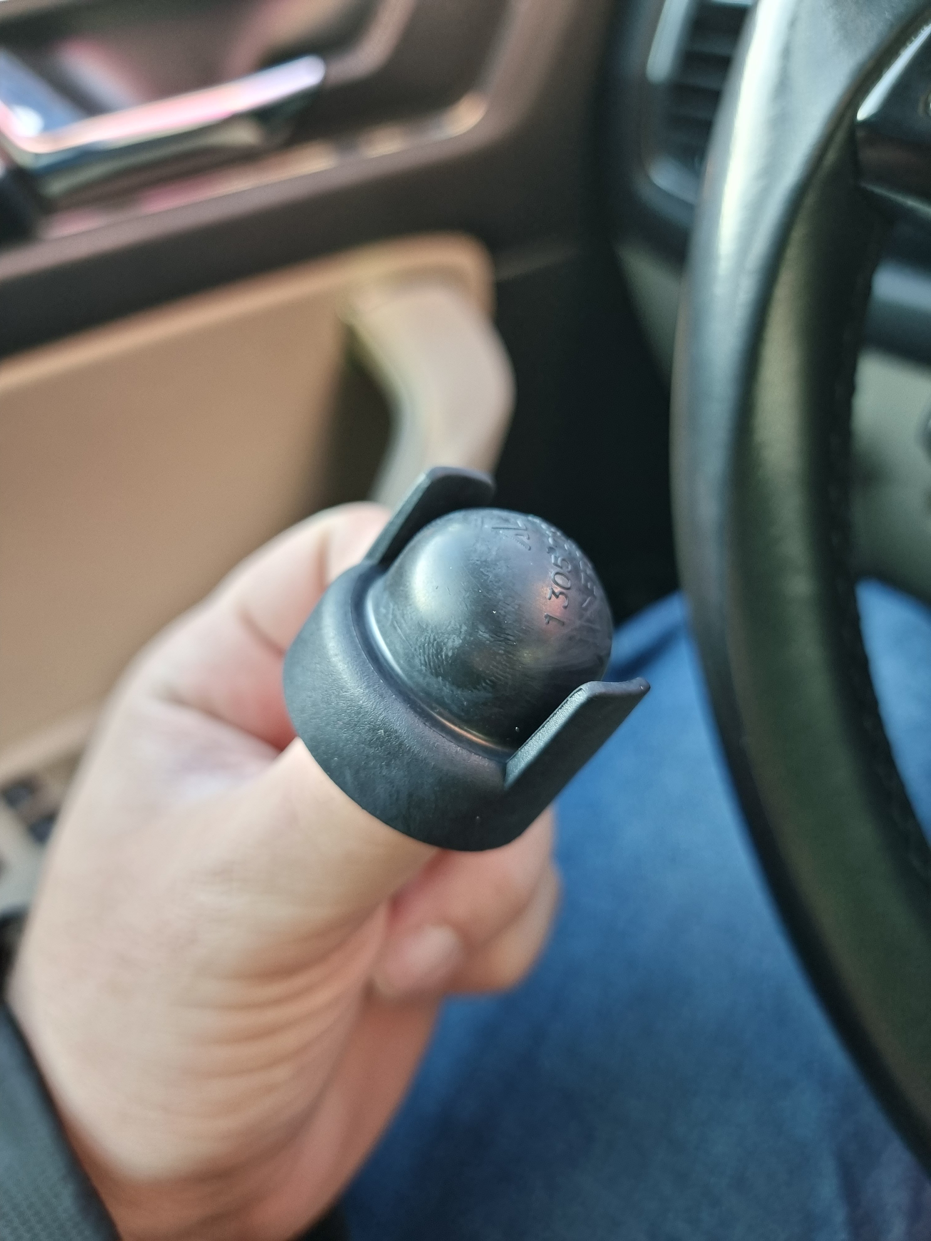

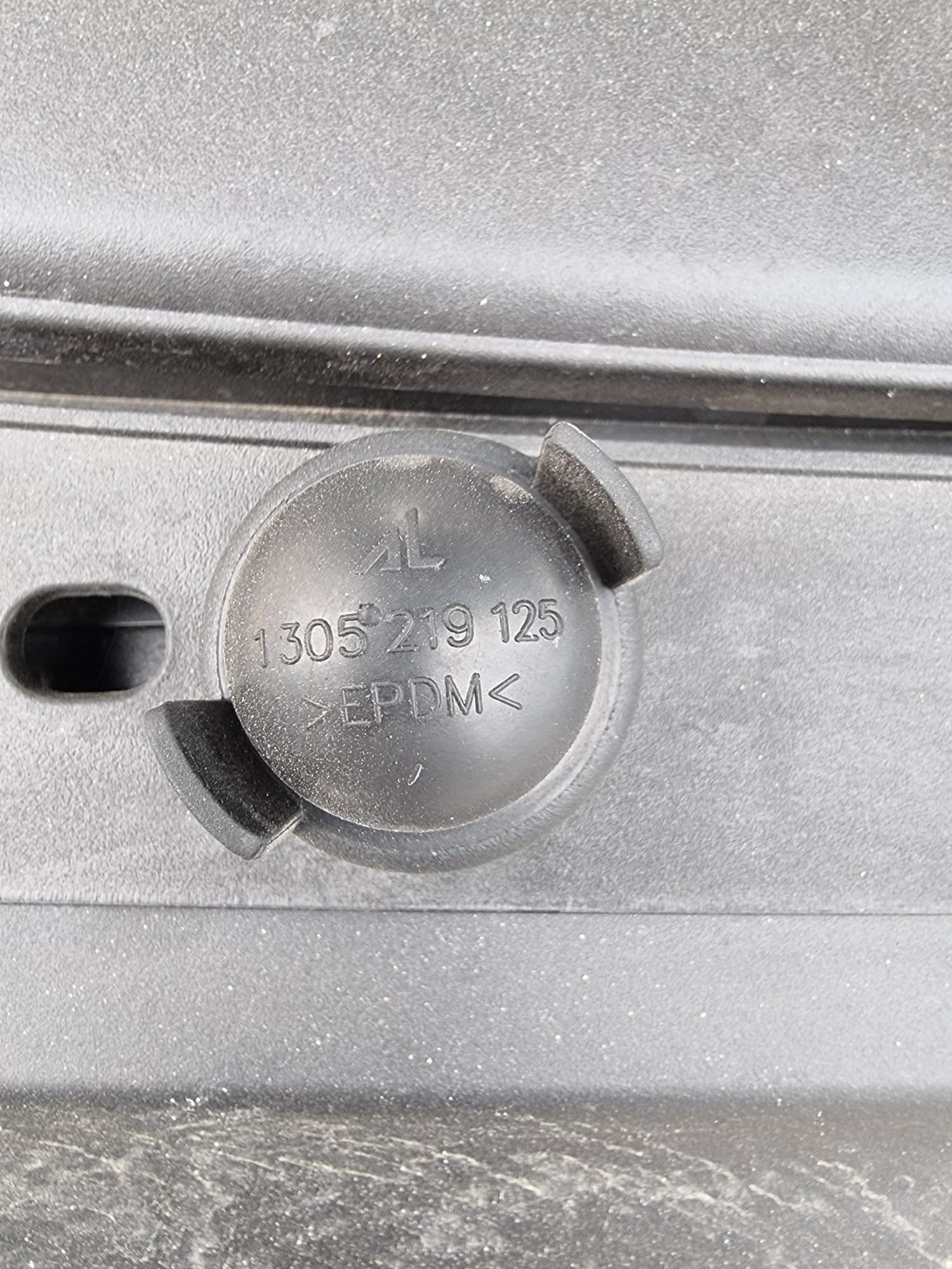

  2. Here it is the rubber cover with code on it. It's exactly the same as Opel Zafira B.

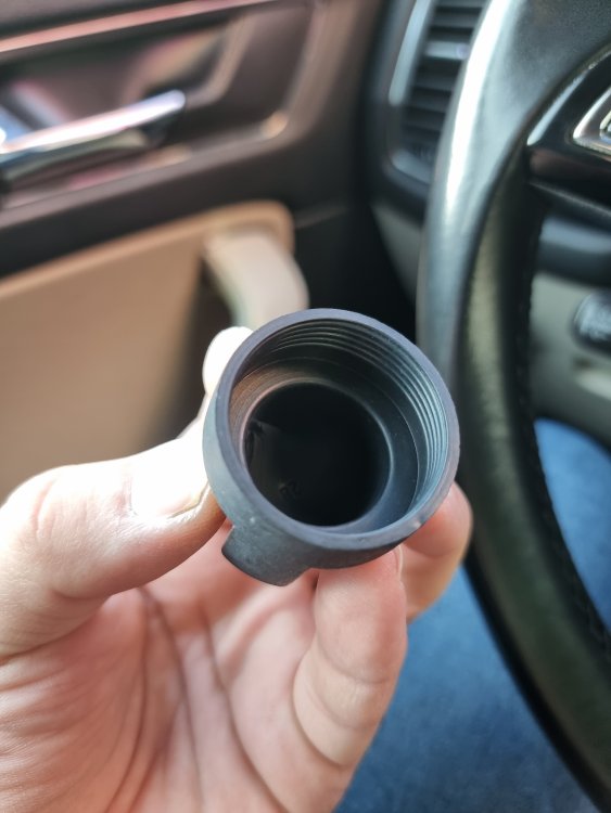

  3. Hello. The caps need to be cut to get to the bulbs.

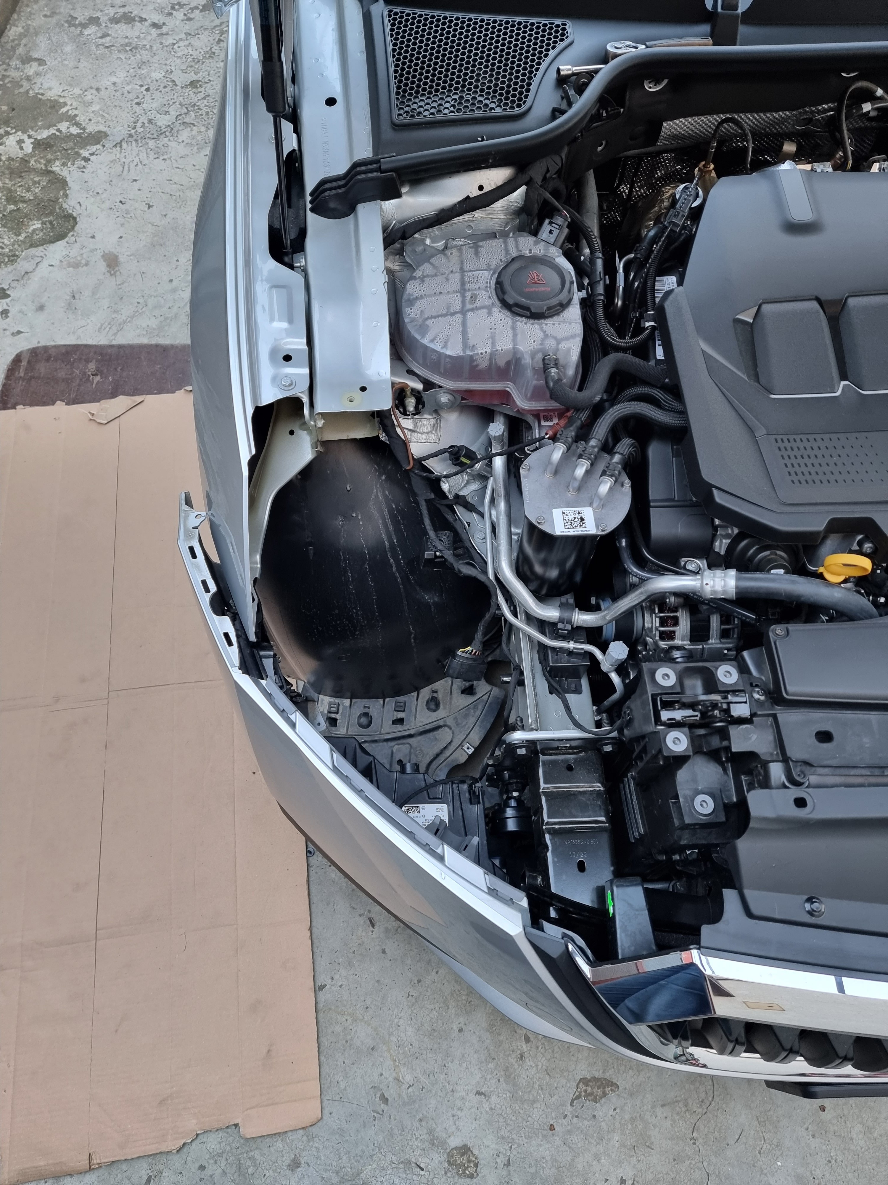

  5. Thanks a lot! The information in the service manual is a little wrong. The bulb socket must be rotated 45 degrees counterclockwise and then it can be removed with ease. I had to dismantle the inner fender mudguard only in the front part so that I could detach the bumper from the side clamps (I didn't take it off completely), only to have some space to detach the headlight and then I realized how it was the mechanism. Before I kept pulling the socket as the manual says without success.

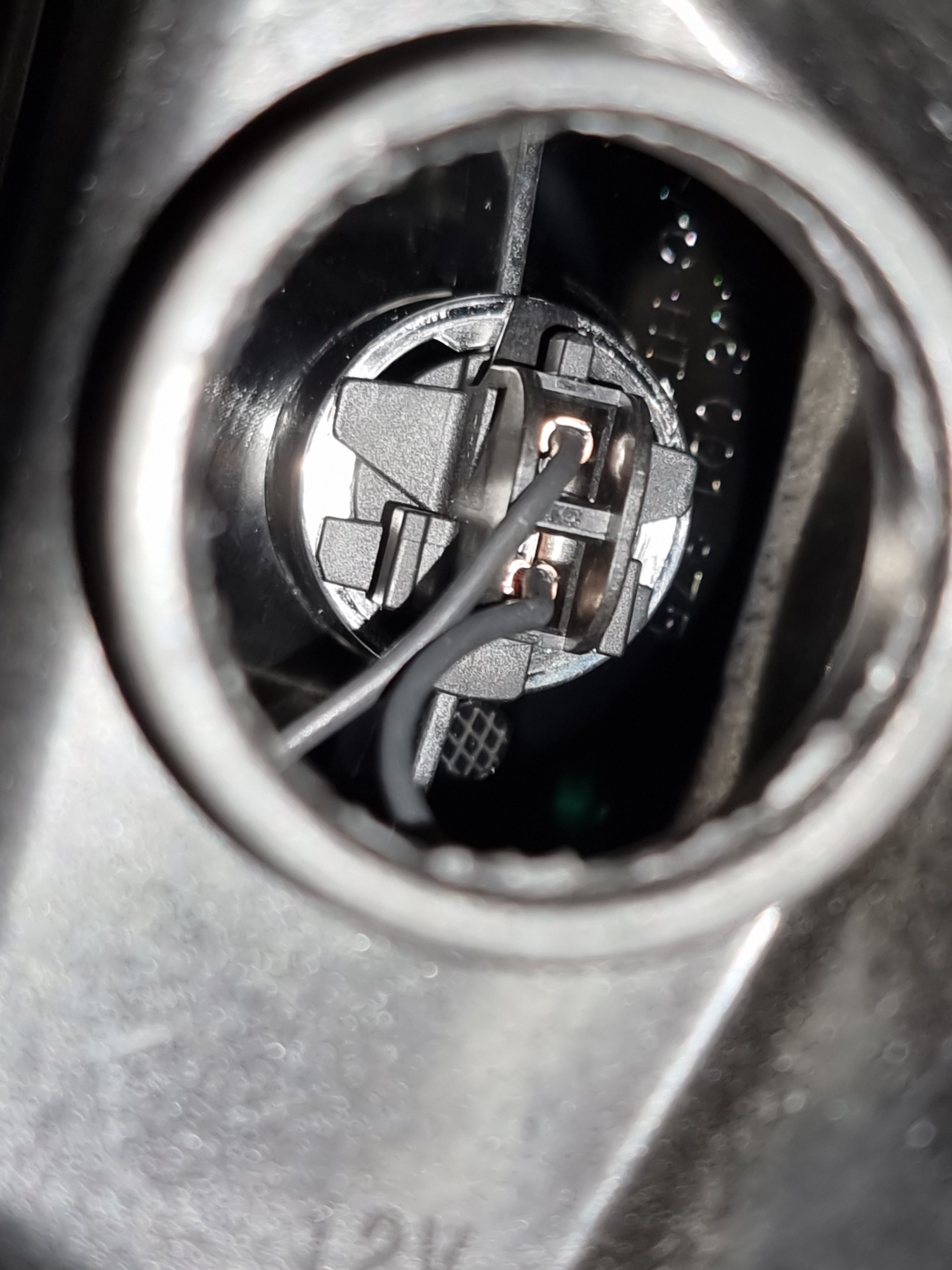

  6. I got the rubber caps for the headlight turn signal, after that I cut the cap and finally I see the light bulb.. But the space there is extremelly narrow and you cannot put more than one finger in there. I've failed to get out the bulb.... it has a strange socket. To be continued.....
