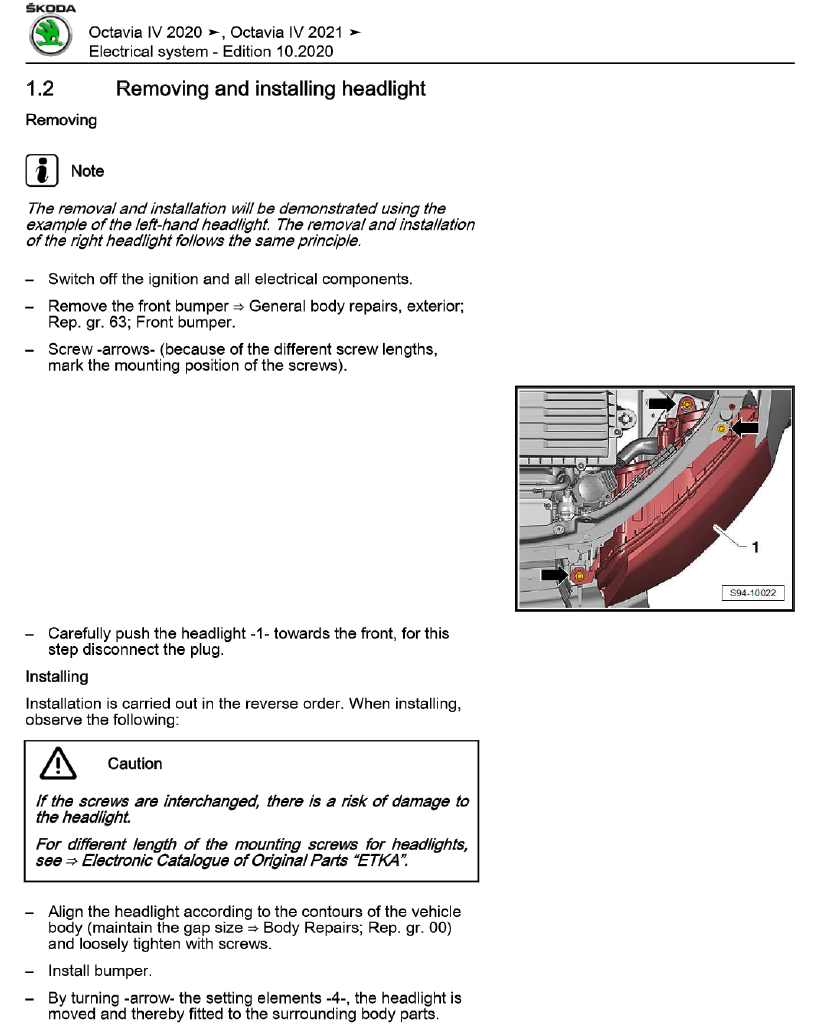

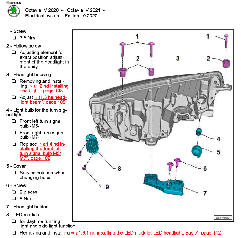

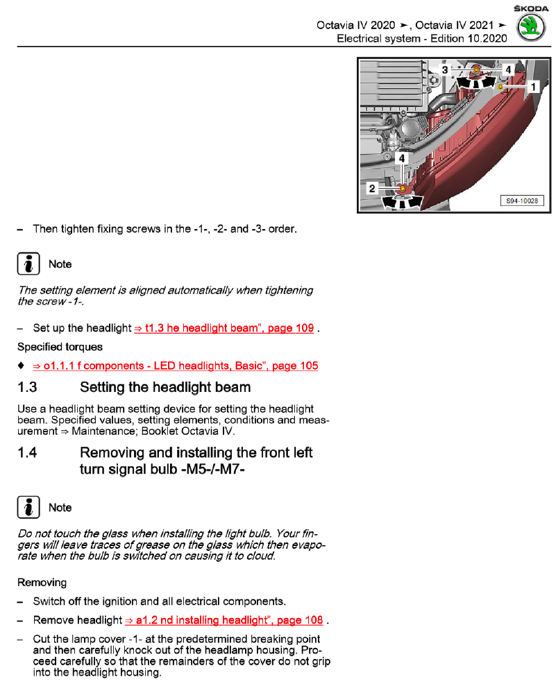

I suppose you already saw the Service Manual instructions for the turn-signal bulb replacement.
The official procedure is indeed a nightmare - one has to remove the front bumper, to extract the headlight in order to replace the light bulb.

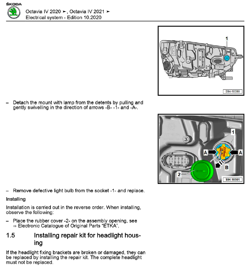

Have a look at the last screenshot - maybe it helps you understand how the bulb socket is fitted.
Good luck! (I hope you'll solve it without removing the front bumper!)

The information in the service manual is a little wrong.  The bulb socket must be rotated 45 degrees counterclockwise and then it can be removed with ease.  I had to dismantle the inner fender mudguard only in the front part so that I could detach the bumper from the side clamps (I didn't take it off completely), only to have some space to detach the headlight and then I realized how it was the mechanism.  Before I kept pulling the socket as the manual says without success.

Hello. The caps need to be cut to get to the bulbs.

You don't have space to remove the bulb  without removing the whole headlight. I allready tried everything and the only solution was to remove the whole headlight...
