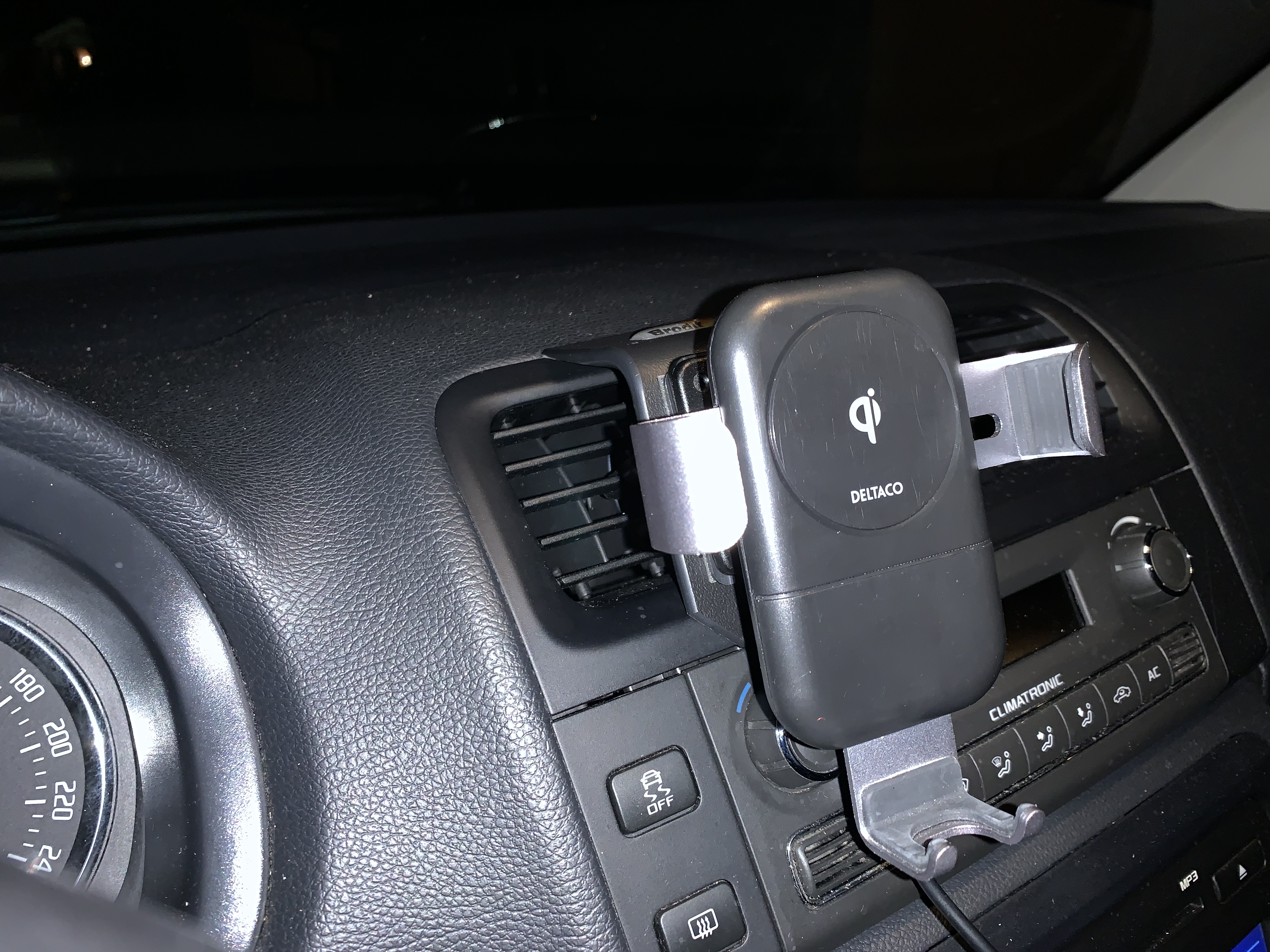

12V from other place than cig lighter + mic placement?
nikasp replied to nikasp's topic in Skoda Fabia Mk II (2007-2014)
A bit of googling gives that I may want to tap into a non-critical fuse such as the rear windshield wiper and hide a female USB connector to plug into. Will let you know what I come up with. -
I just installed a Brodit ProClip mount and a QI-charger from a previous car. Will install a hidden bluetooth dongle behind the stereo with a two meter cable for the mic. 1) Any good advice where to put the mic? I am thinking around/through the sunglass holder in the roof and route it inside the A-pillar. 2) This would look neat with QI and BT, i.e. no cables EXCEPT for a super ugly USB-A to USB-C cable from under the handbrake all the way to underneath the phone holder. Is there any place I could get “the juice” from inside the dash so I could have almost concealed power?

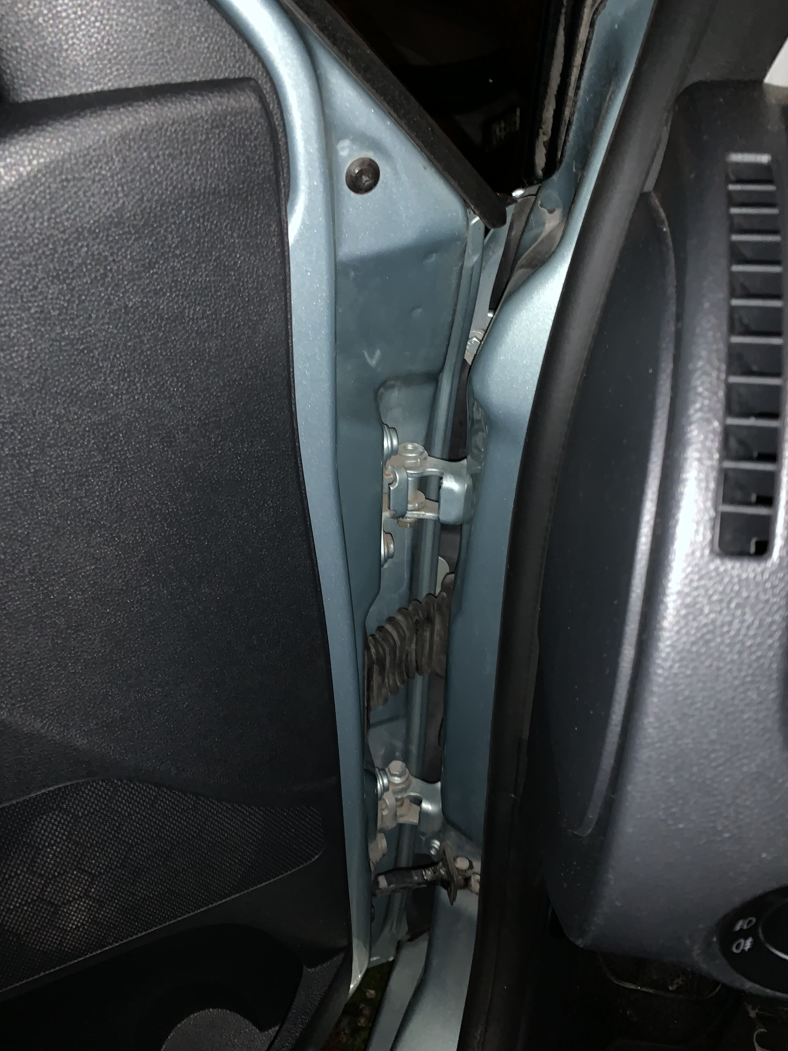

Drivers side door latch alignment issue
nikasp replied to Entertwainer's topic in Skoda Fabia Mk II (2007-2014)
Looks like like this so I’ll try to adjust when Spring is here in Stockholm. Not a big issue but I like to chase away all defects possible and that does not cost much. -
It’s not closing really bad but you can notice that the door have dropped a few millimeters by the A-pillar. When the door hits the catch it lifts those mm:s and aligns perfectly with the passenger door. Not super clear if it’s possible to adjust in a simple way net the hinges but hope so. -
