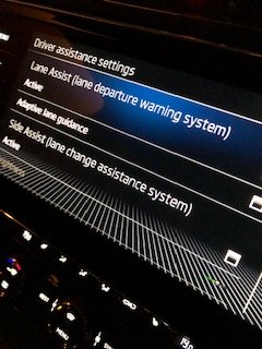

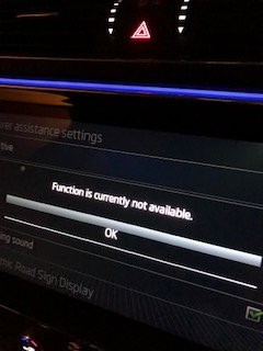

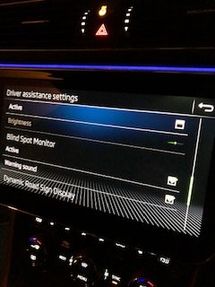

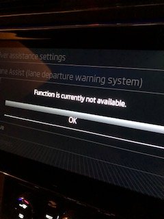

Here we go again this time not my windscreen but a new problem. Has anyone had this problem :- Blind spot not working but there is a tick in the box, when it try to activate it I get the message Function is currently not available, also same with Side Assist.   Yesterday I had taken car to main dealer and was told they have never came across this before and was unable to solve the problem.  I now have to take the car back again and told it will take a bout a week to solve connected to a computer.  Any thoughts I have tried the reset to factory settings but nothing.
