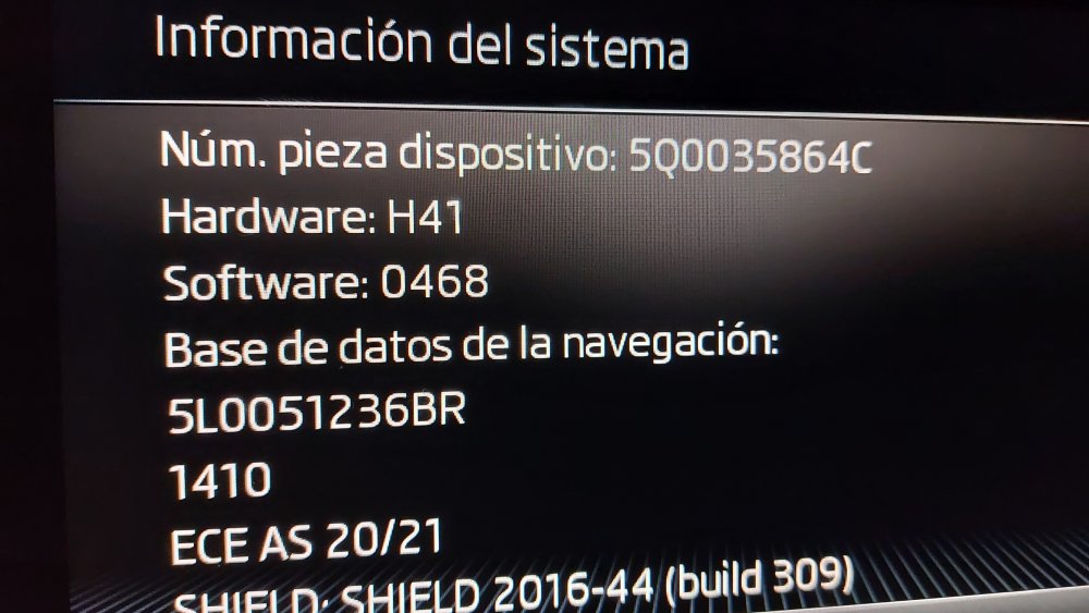

  21. Any idea, advice or guide about how can I test it? At least to discart alternatives... Thanks you fellows, thanks a lot!
