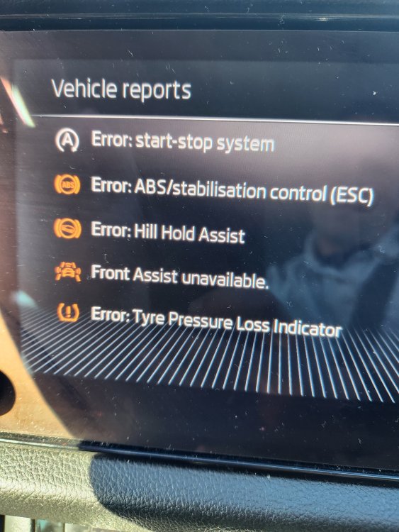

  2. Anyone have any ideas

  6. No settings change only coded battery Still the same loughts pop up... I'm assuming after a certain amount of miles that will go ? Ice dome 60 miles so far

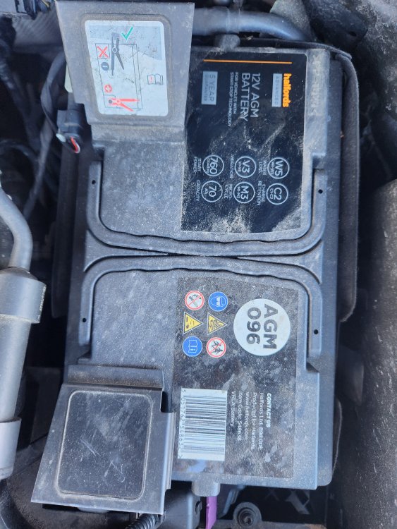

  10. Its a halfords own battery (pic attached). Swapped 'like for like'as its under warranty. Errors have gone from dash - but i fear they might come back not driven it yet Do i have to code it?
