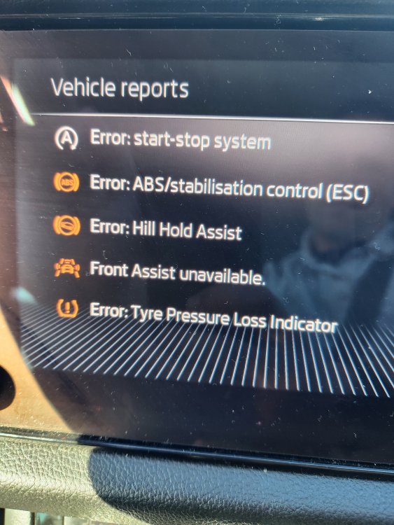

  1. Hi there Yes!! It was a faulty wheel bearing and some magnetic disc thing (no idea of name) around the bearing. All fixed under warranty by skoda. Bearing fixed on front right wheel and all fine codes went away!

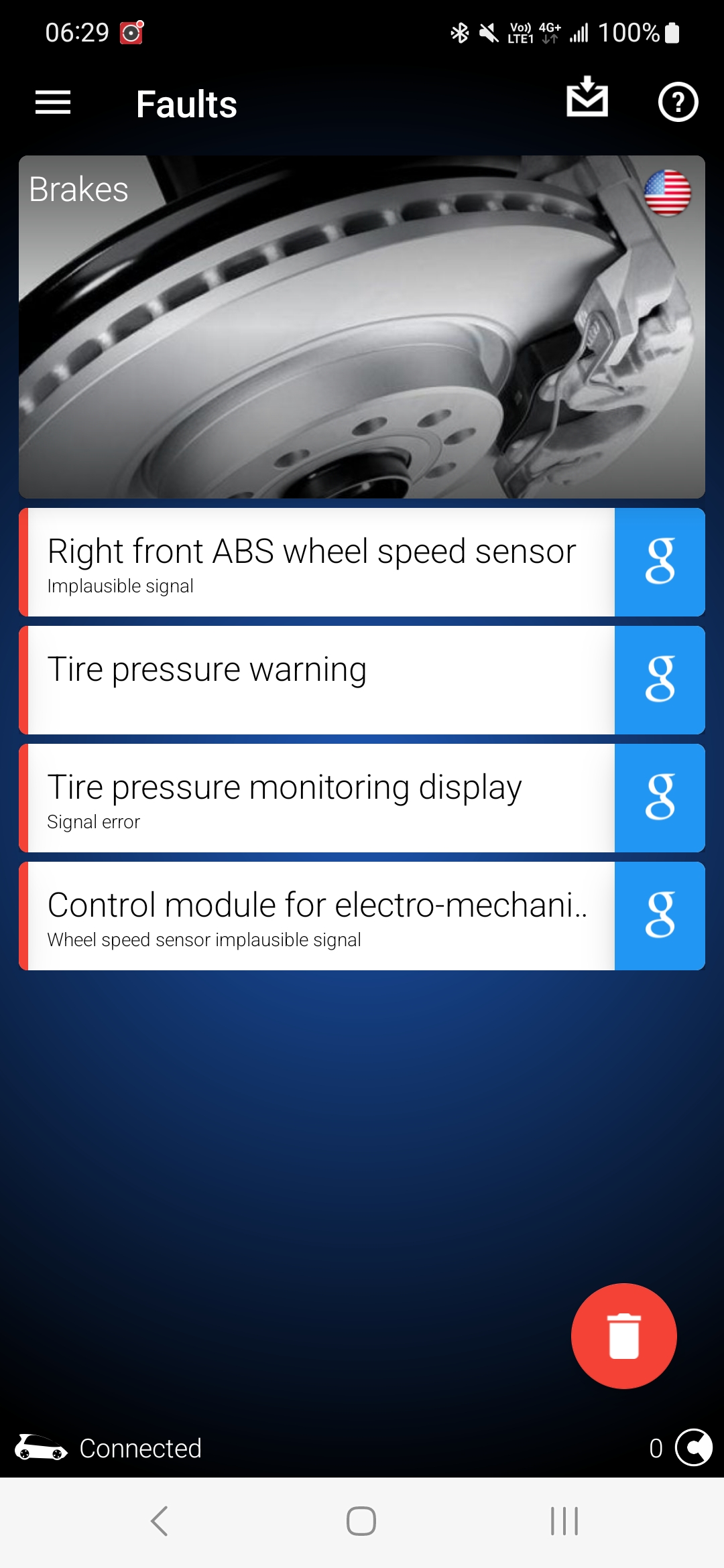

  15. im getting the same messages ? new battery fitted - still same problem
  16. Hi All, Recently alot of warnings popped up on dash (tpms, esp, parking pilot etc). Once I park the car and turn off the engine the light seem to vanish on each trip. What I have done so far: 1) Changed 12v battery to a new one/ New one now on with errors still coming up 2) Move the steering wheel right and left and the lights go out - then come back on after a short journey I have obbeleven and vcds so any coding etc could help? SKODA KODIAQ 4X4 2.0 2018 Ash
  17. Ive changed the sensor however the part number doesnt have a " B " at the end of the part number - would that matter or might sound silly
  18. Hi all. I'm not getting the same symptoms. Is it as simple as replacing the abs sensor and the car recognizes it itself?? My dash shows front right tyre pressure low. I've reset via radio etc My odbeleven shows this..
