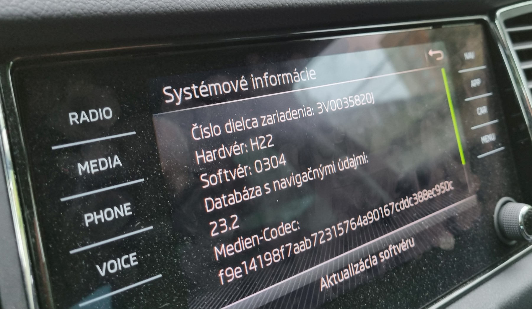

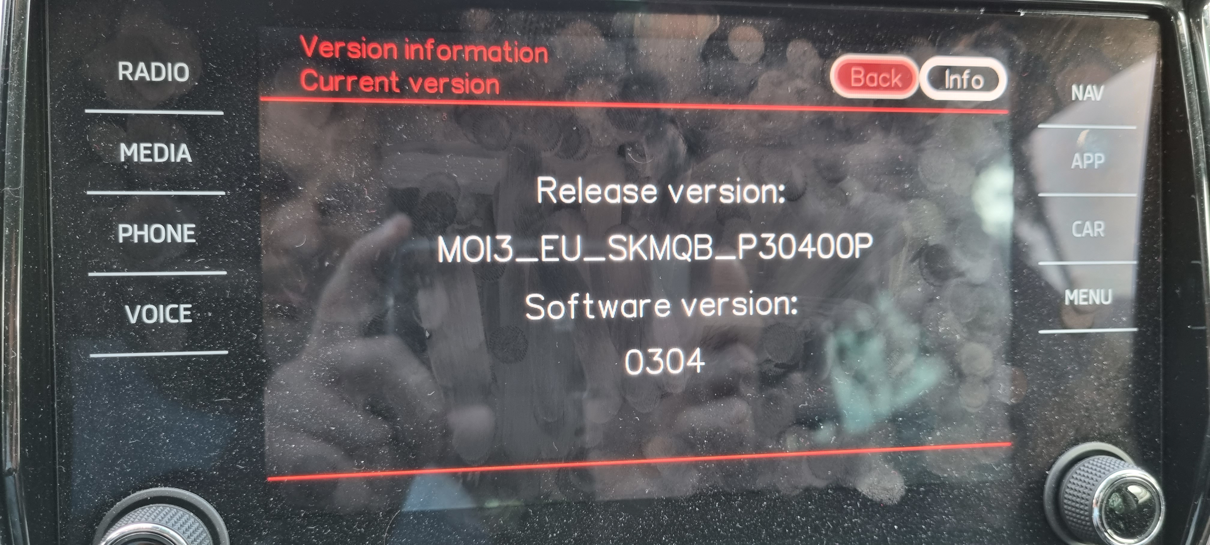

  5. hi, here is it, hope it is what you needs to know
  6. Hi, is there any update for this unit? Sometimes Android Auto doesnt connect... Kodiaq 2022 FL
