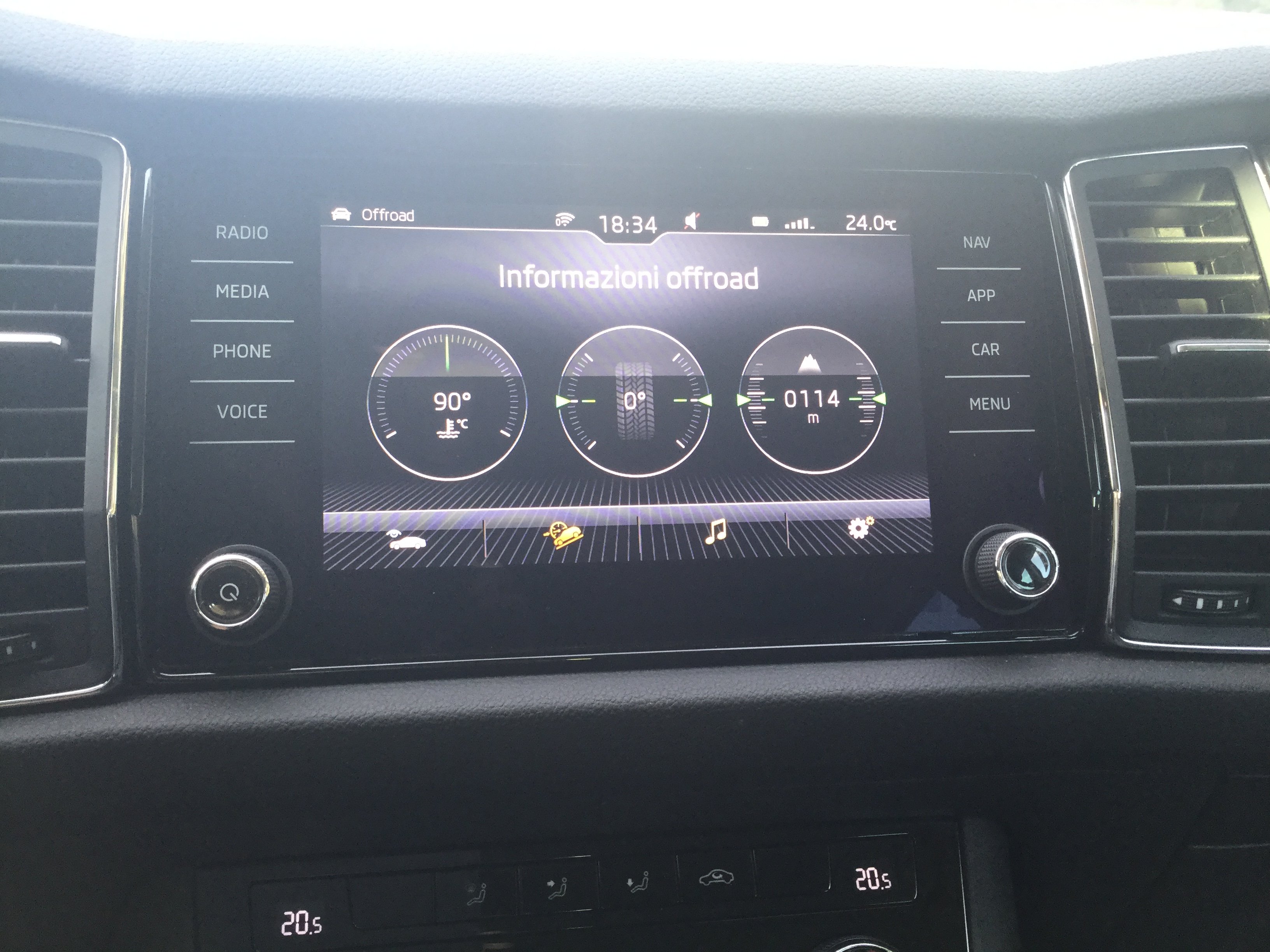

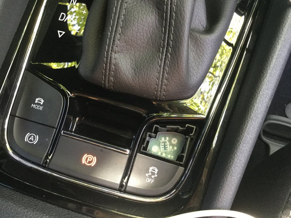

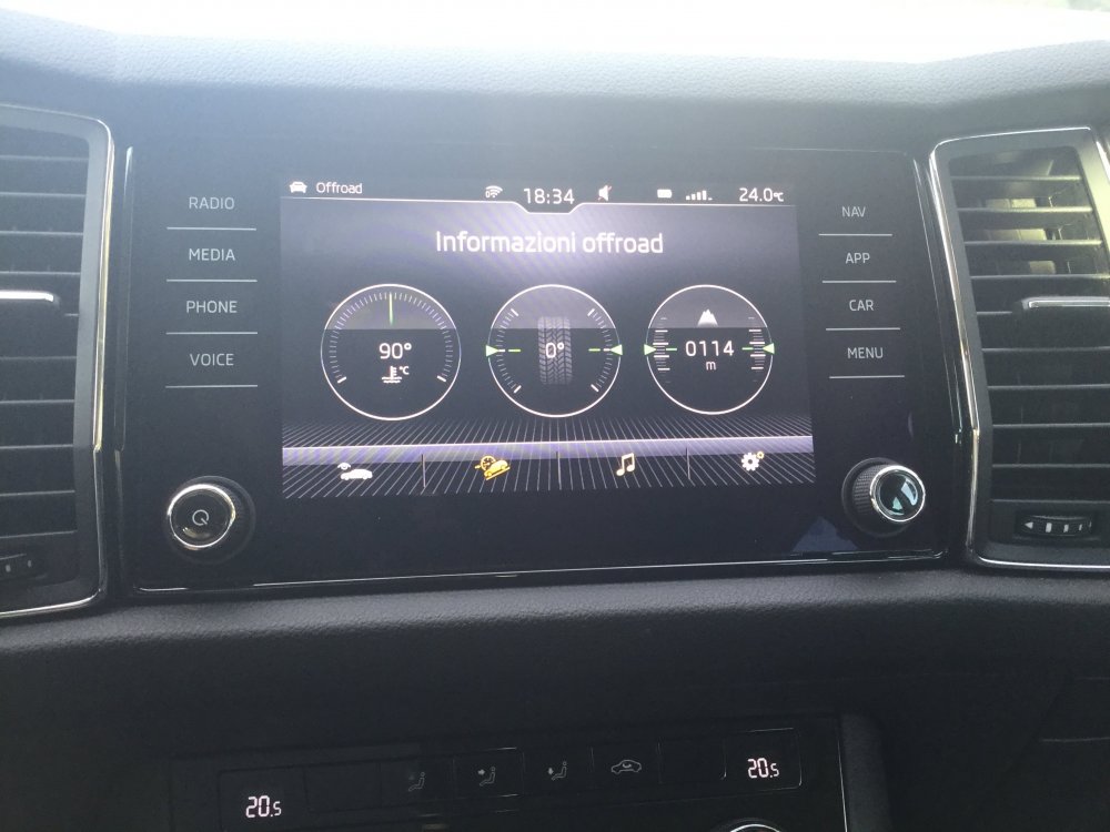

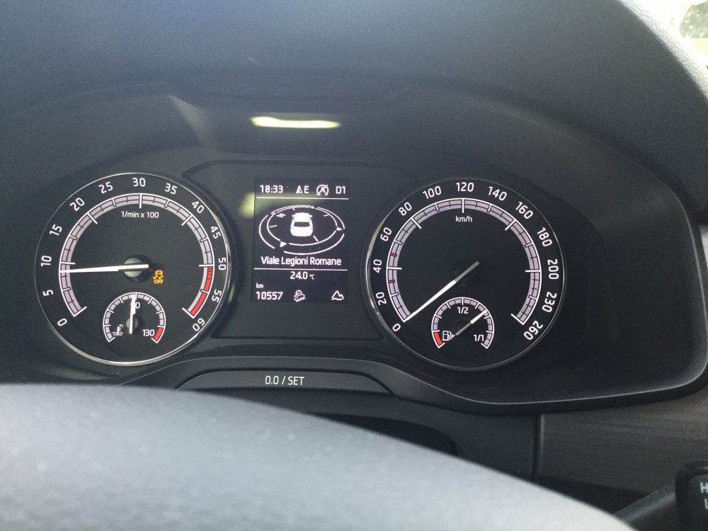

I made some progress, Following the forum instructions I enabled the off-road screen. Then looking at the kodiaq scans with off road function I made attempts on the abs code (3 vcds) and I managed to see the off road icon on the navigator display. I then went to the power plant (9vcds) and tried adapting to changing the function of the start stop switch to off-road mode, unfortunately it does not work. I tried then to unmount the fake key on the console, under the cap, there are the button contacts there is no led. Does anyone have any idea?
evviva !!!

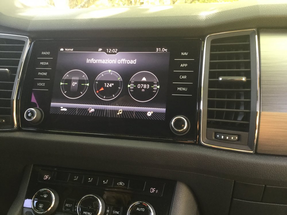

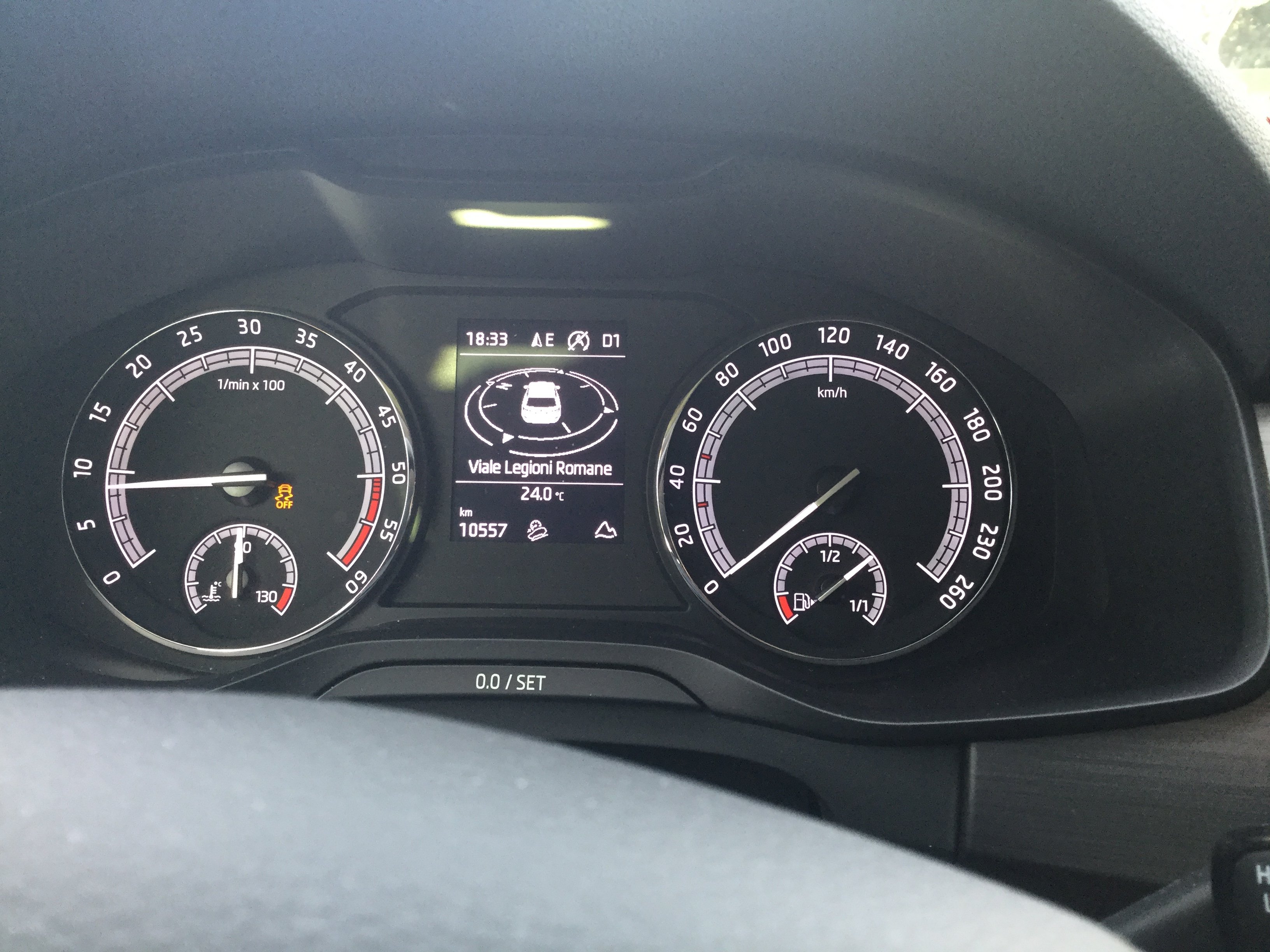

I was able to make retrofit off road mode on kodiak. as first thing I changed the long code of the 3 abs, bit 24, my car 75, modified in 7D. by magic it appeared on the display of the ship the symbol of the downhill control, but it was switched off ..... as a second operation, adaptation cent elect. 9, center console button 2, change function, enable off road. with this the vcds operations are terminated.

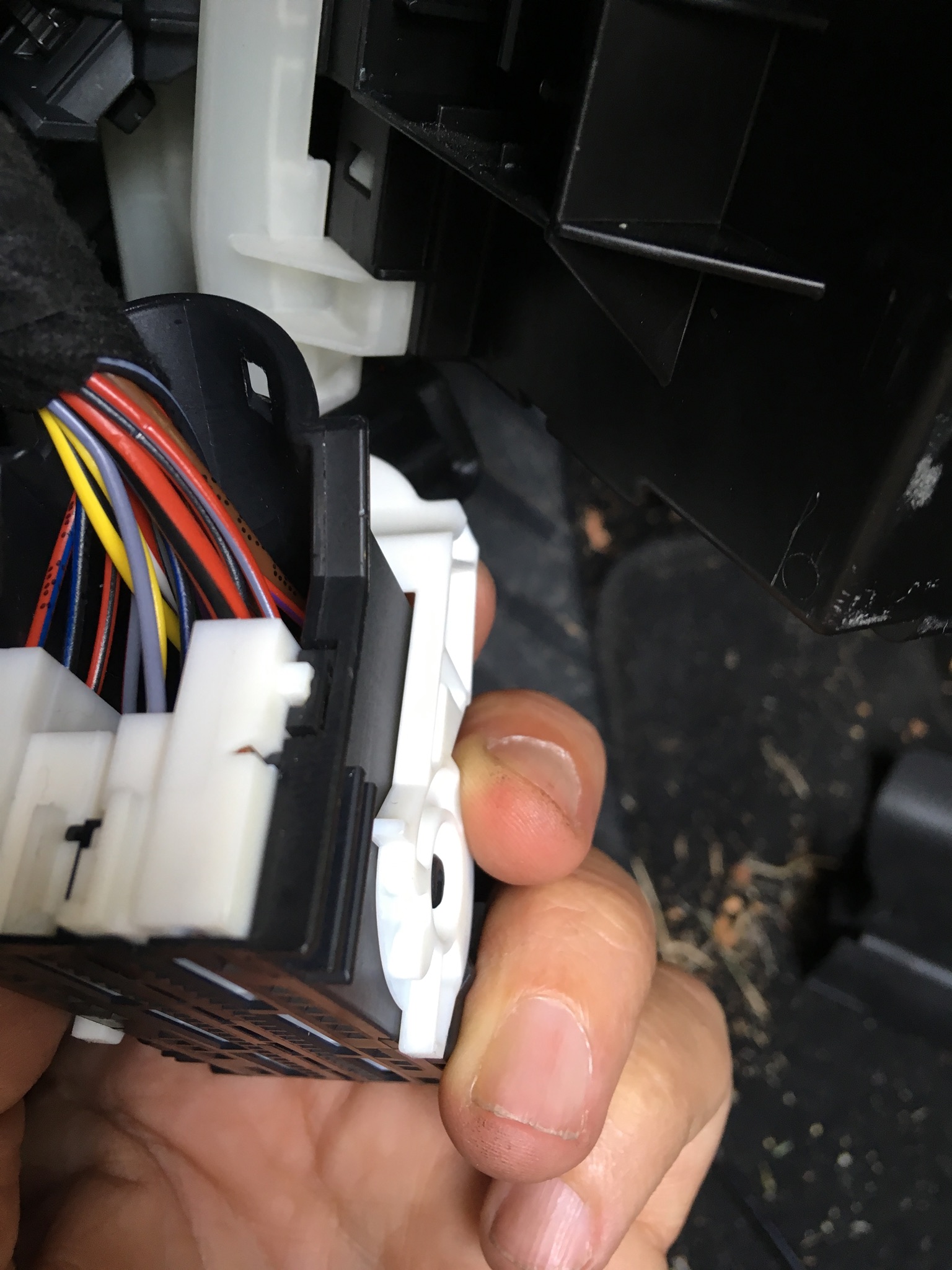

now we go to the operations on the electrical system, initially I thought the central console button was wired, unfortunately it is not wired ....... let's leave the connector under the button console near the gear lever, 16-pin connector, pin 16 connectors to pin 45 of BCM connector C73, pin 11 connects to pin 50 of the BCM connector C73. the bcm j519 is just above the engine hood release lever, before disconnecting the connector, disconnect the battery pole. we have to disassemble various plastic parts, slide the control unit down and disconnect the 73C connector, the one closest to us.
I forgot, the new console code with the off road 566927225B button
I hope this document will be useful to all users of the forum, I think this scheme can also work on last generation octavia scouts.
