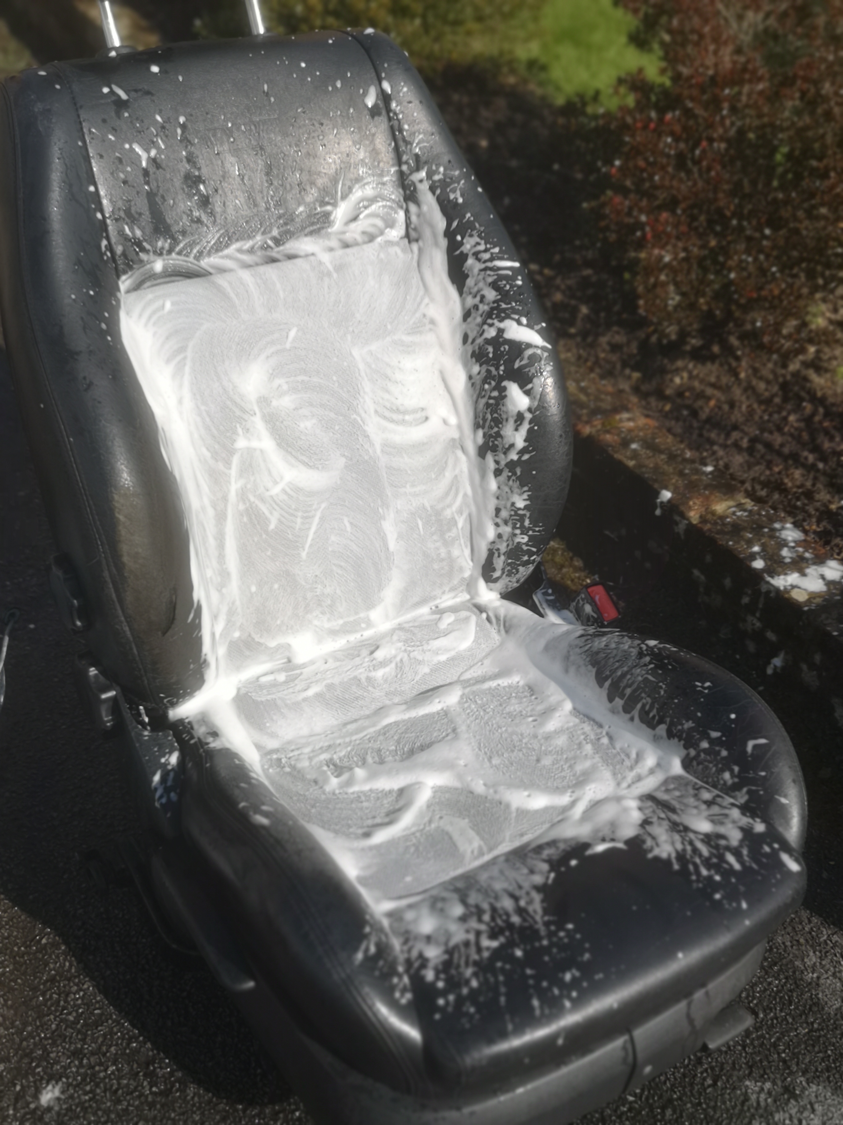

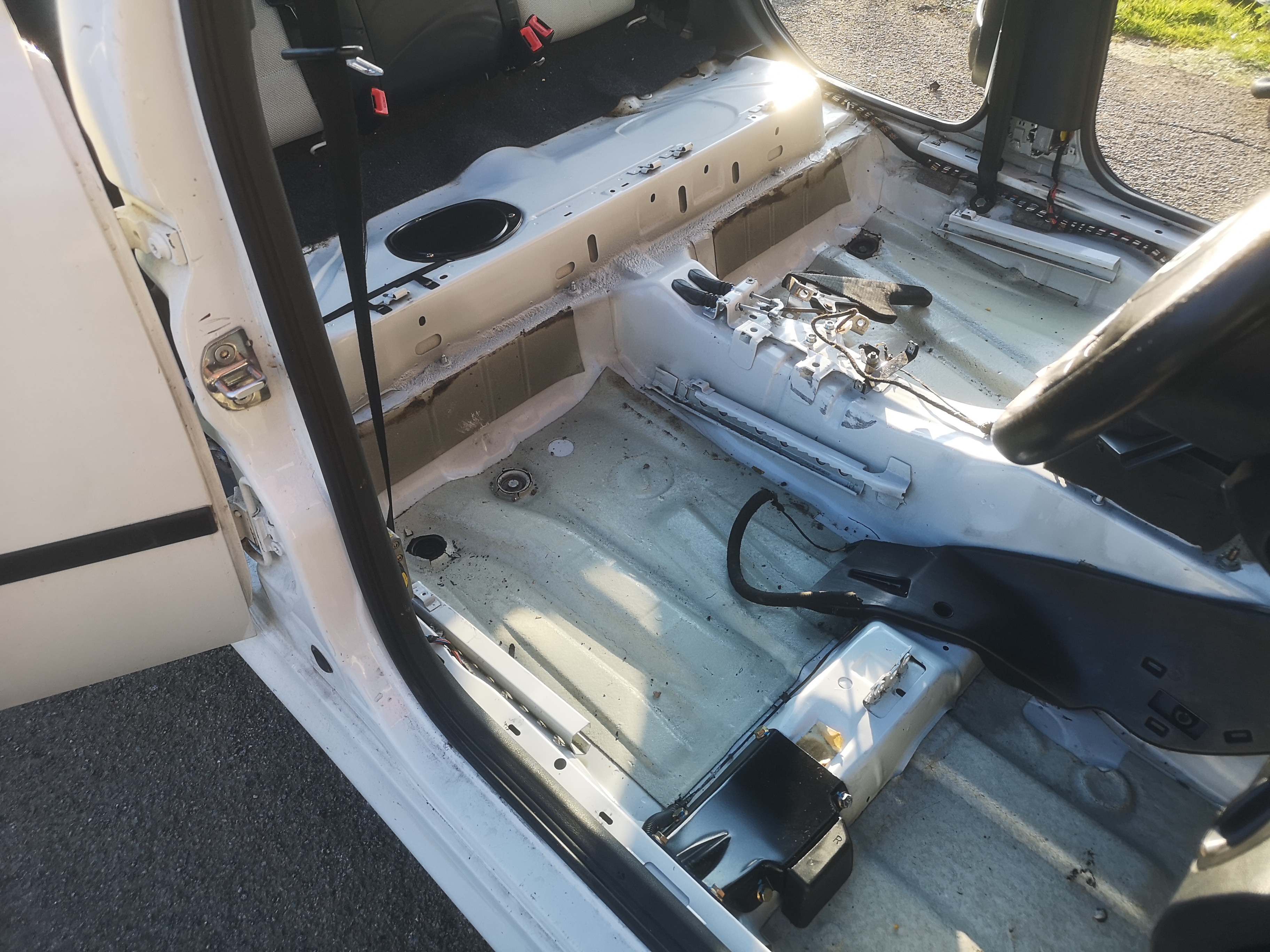

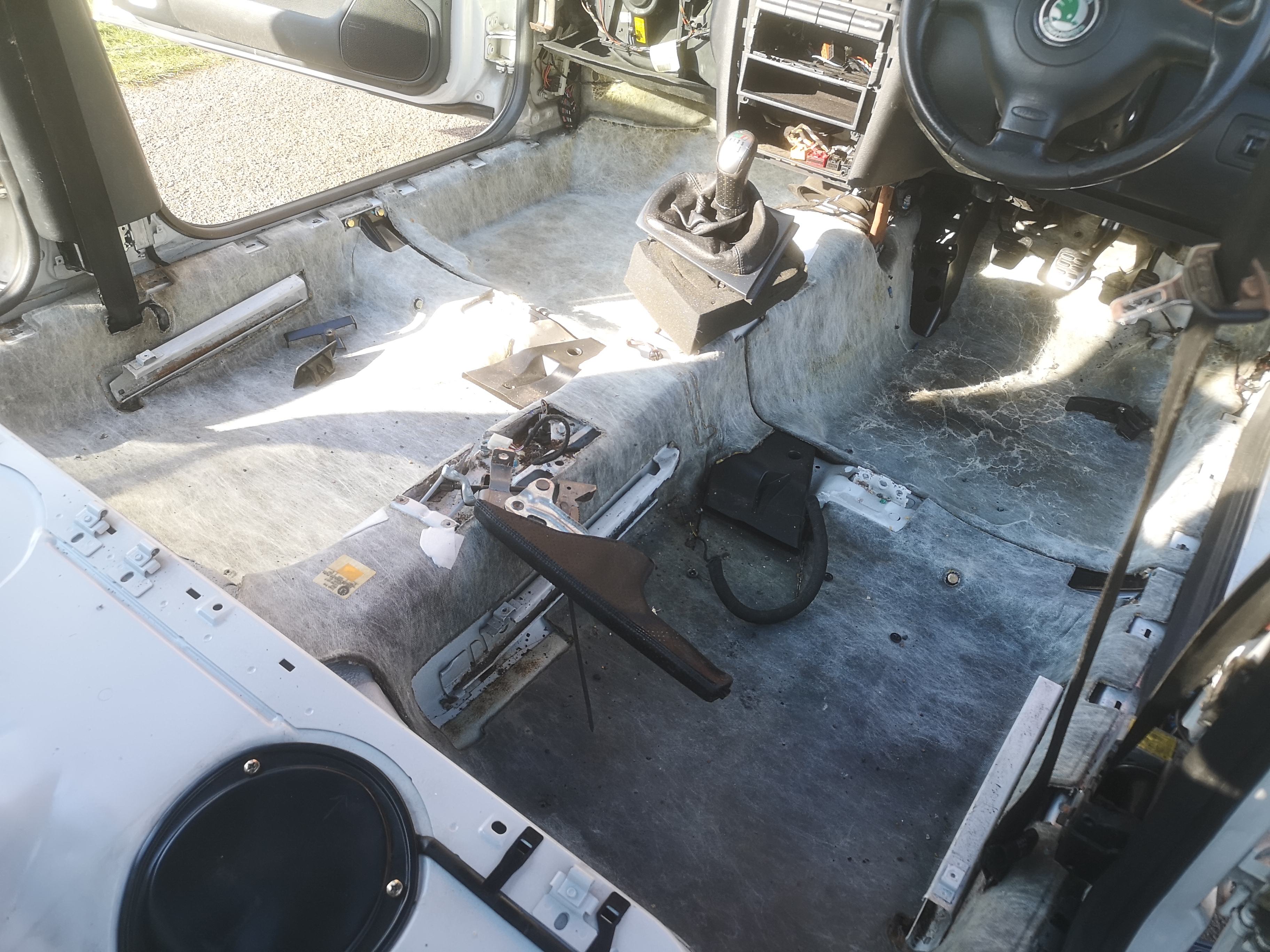

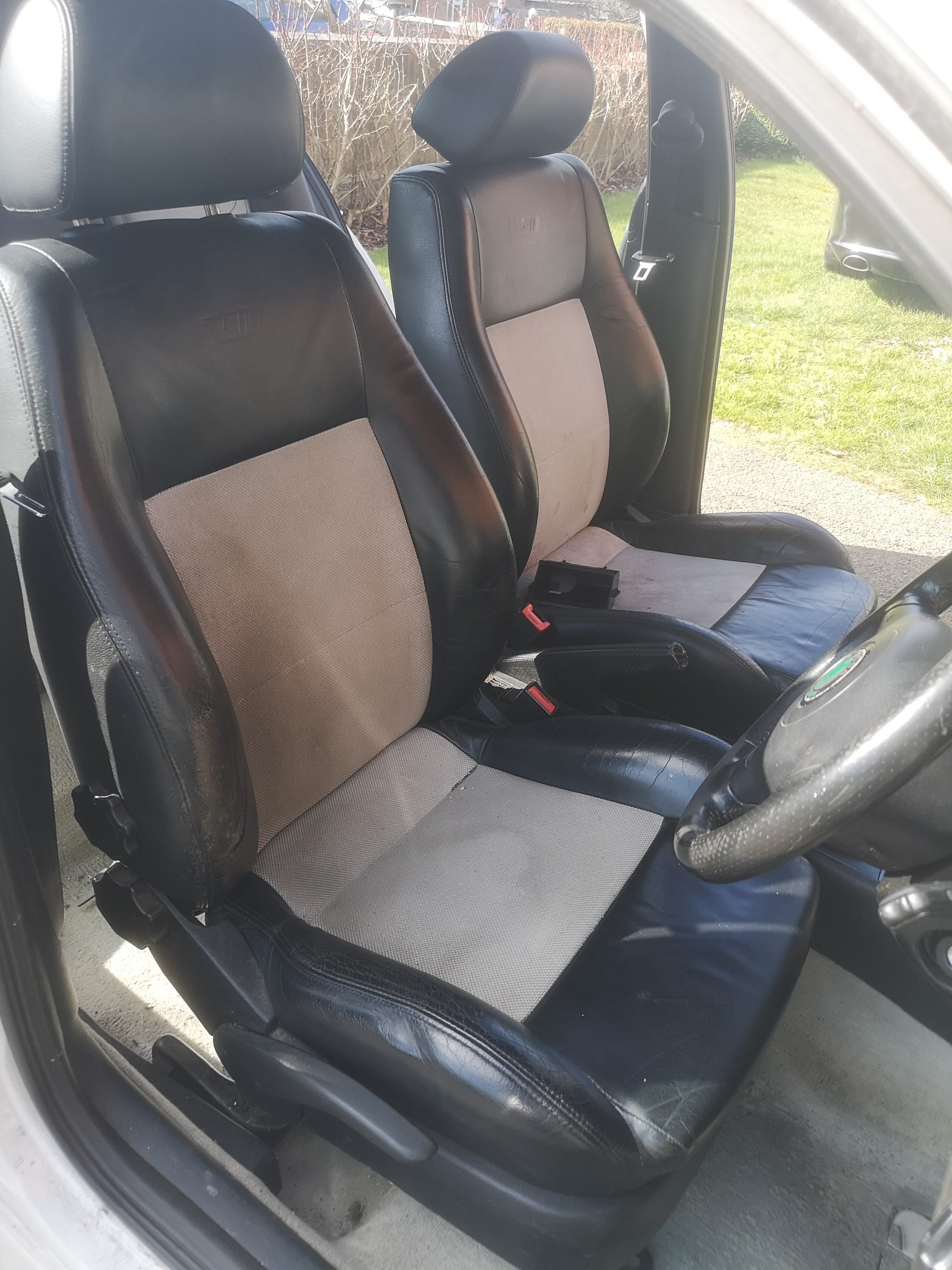

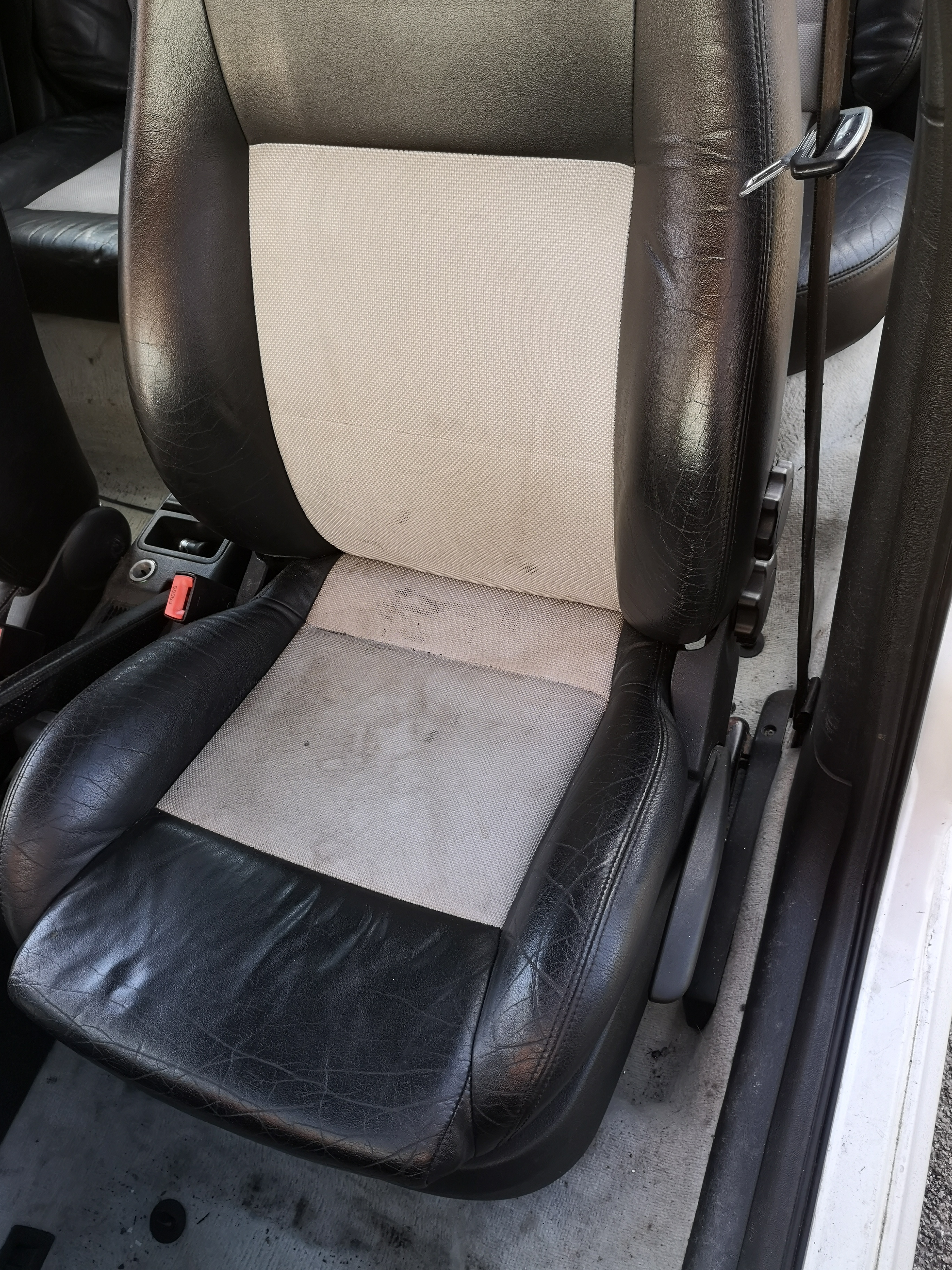

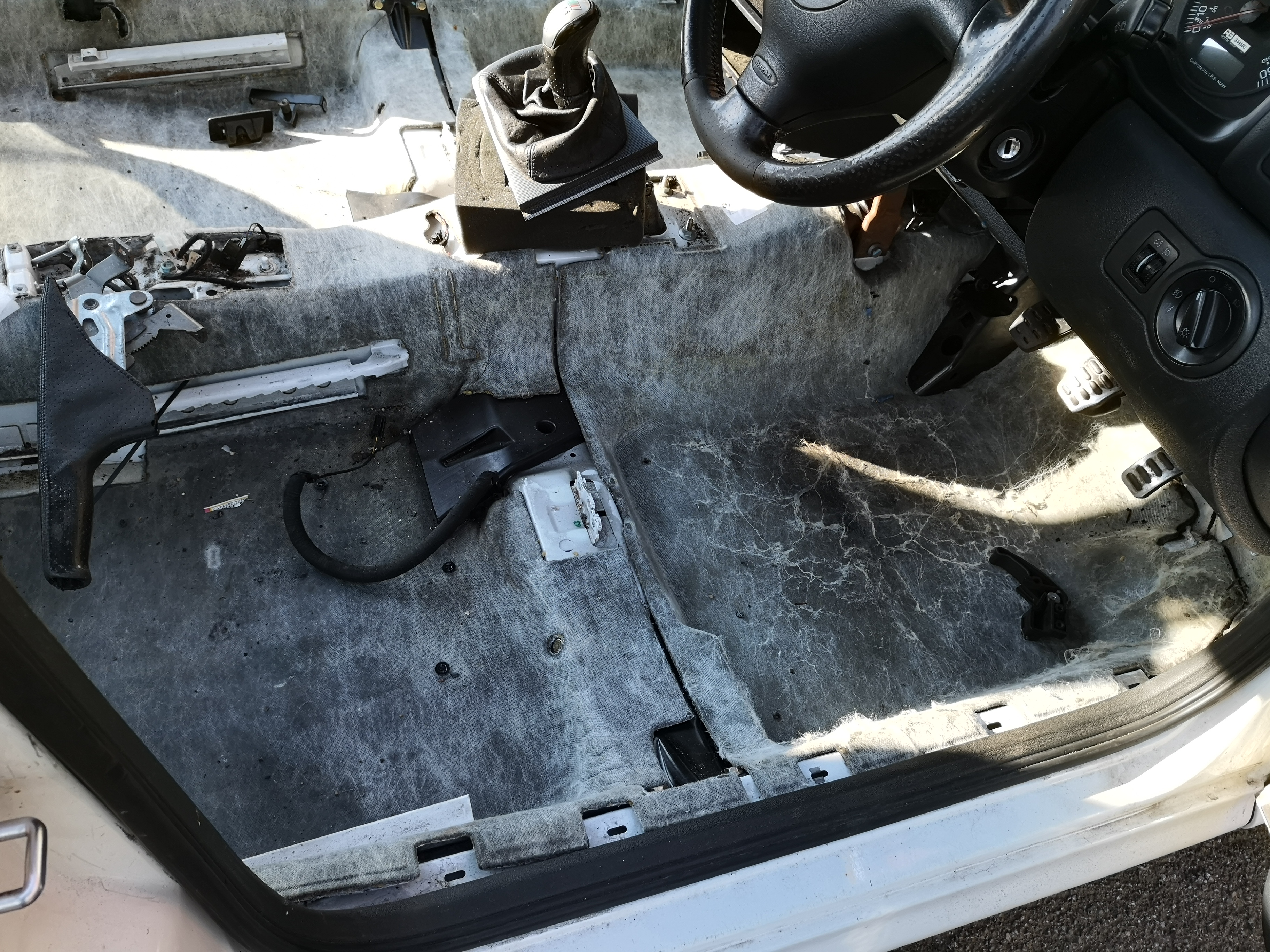

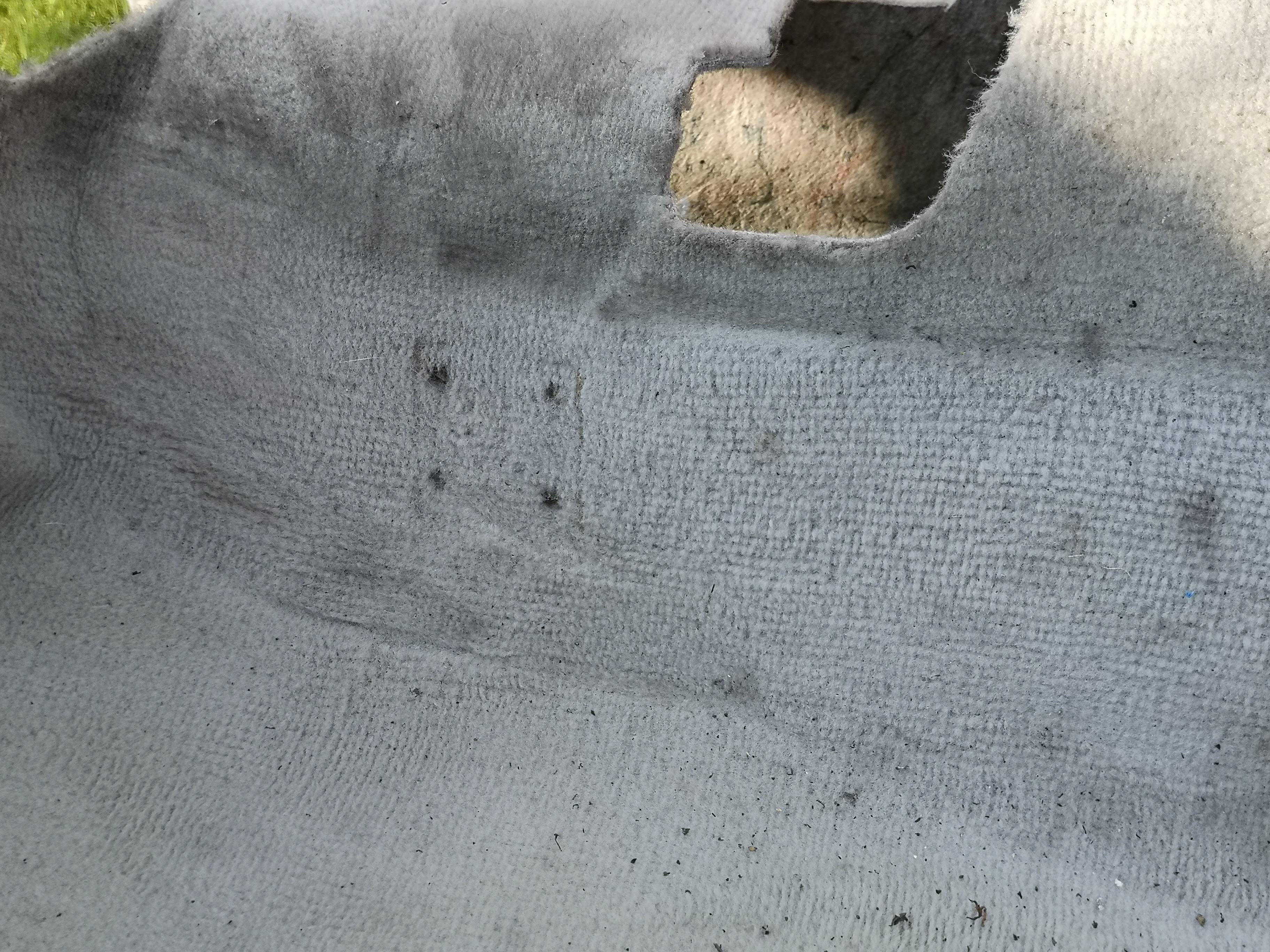

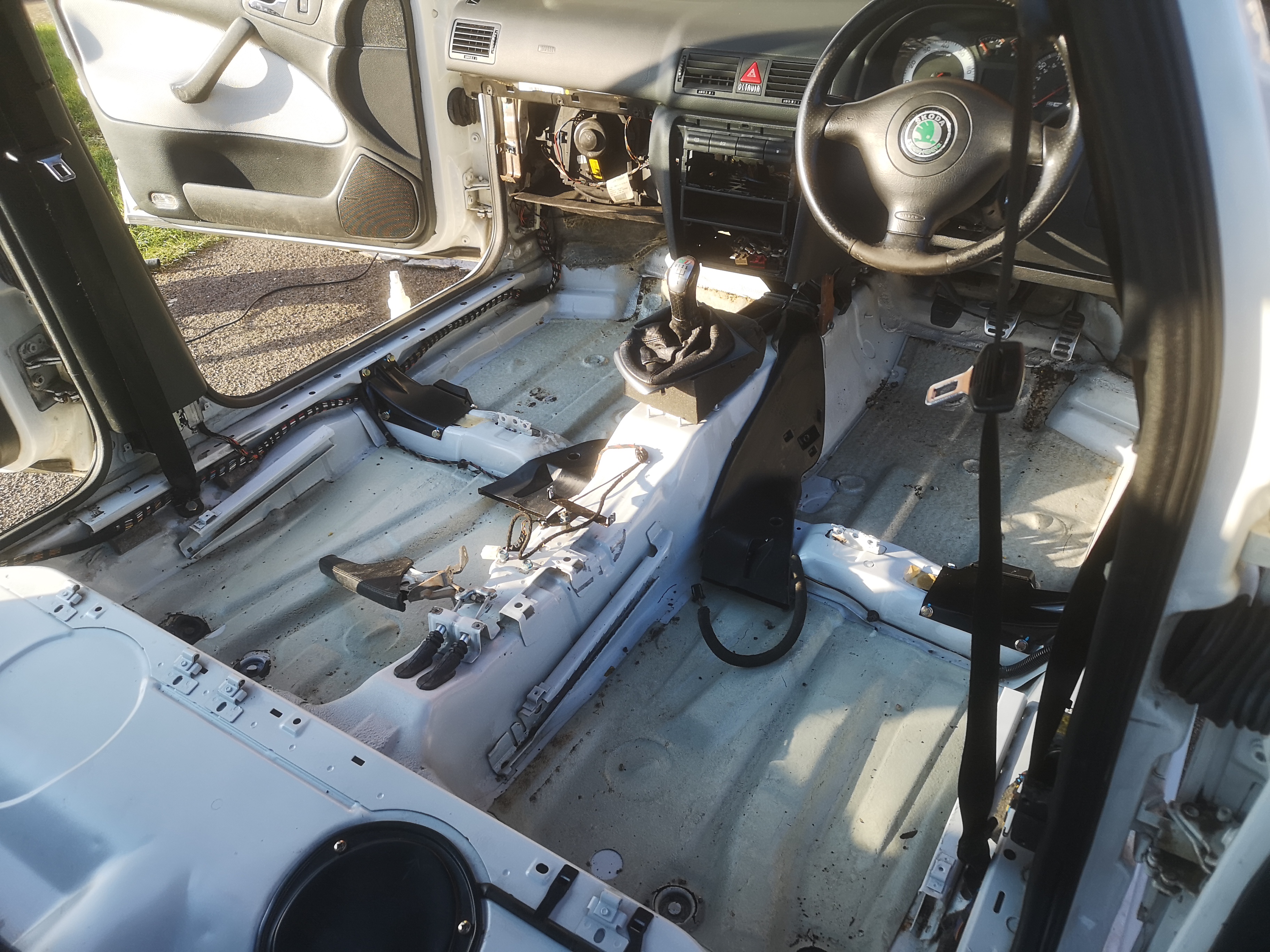

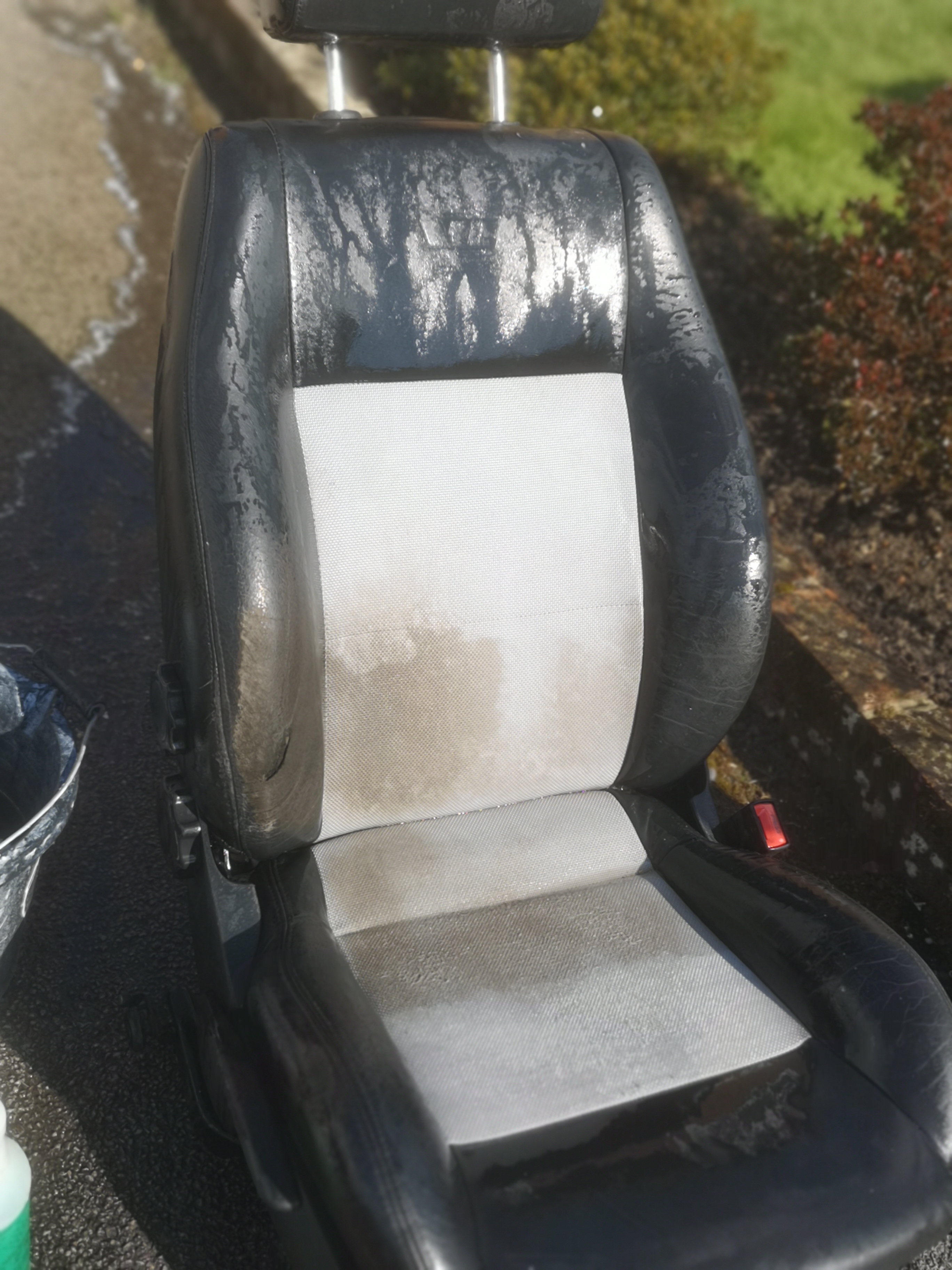

Started the interior decontamination today. Seats out and scrubbed, then removed the carpet and underlay as damp. I will look for replacements so didnt bother cleaning them.

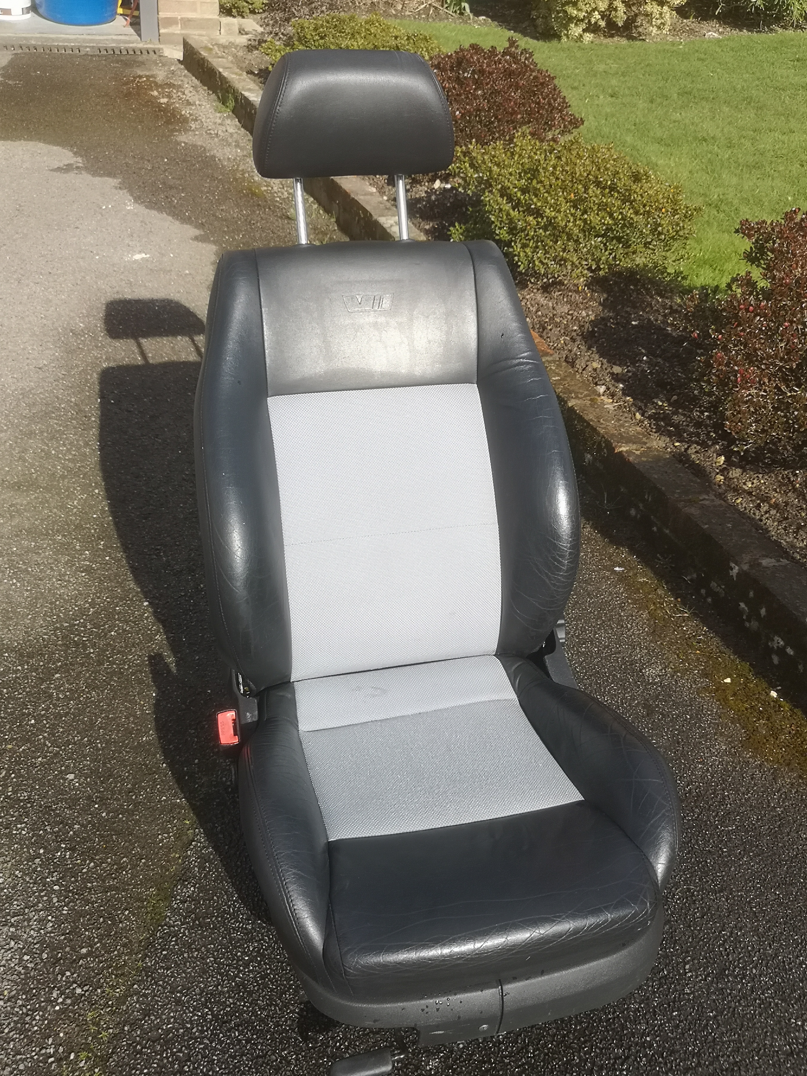

The seats not in great condition, but I will look at getting them repaired later.

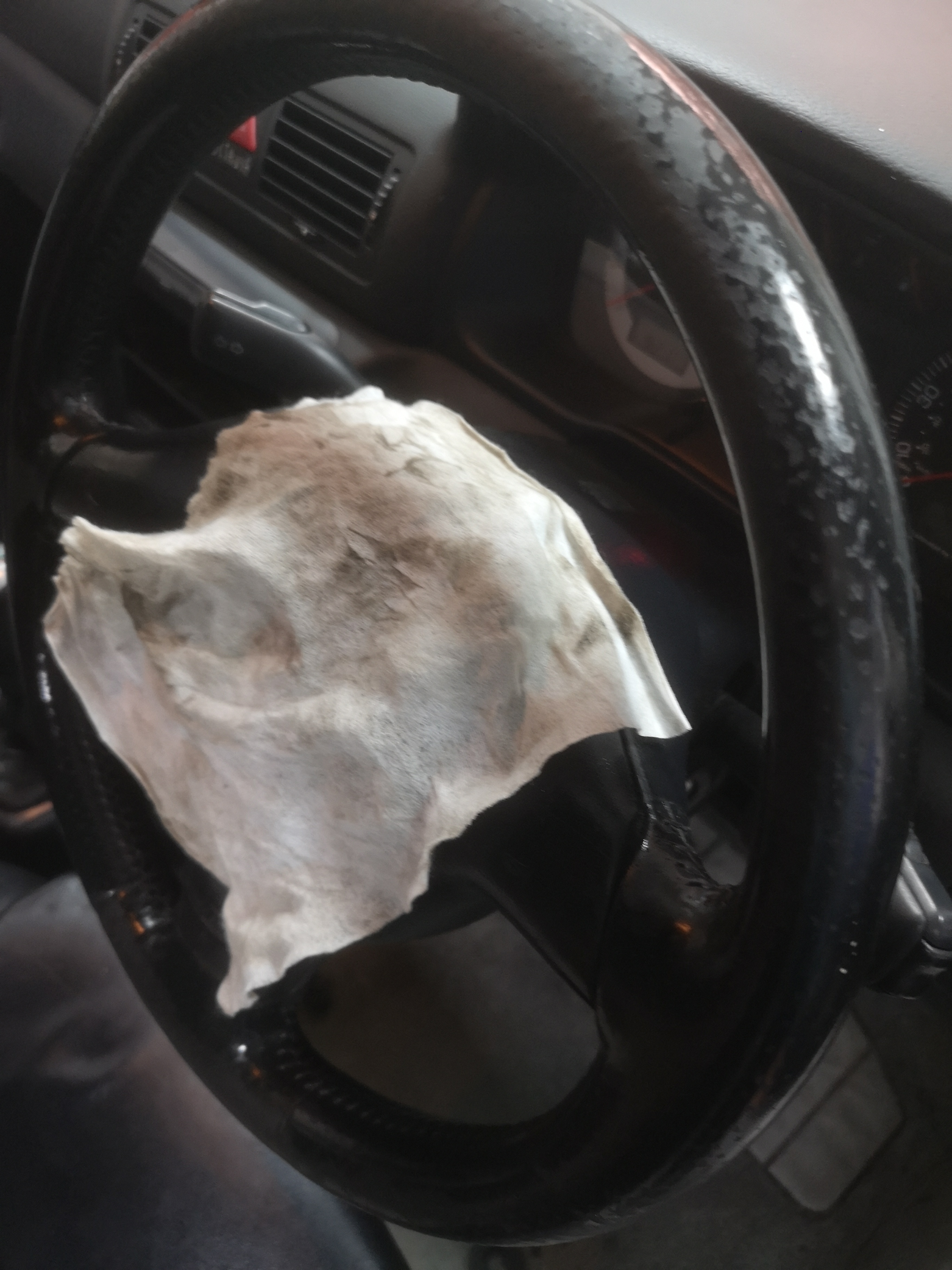

I have a better steering wheel so will swap it, but look at the dirt on the old one 🤮
Some before shots

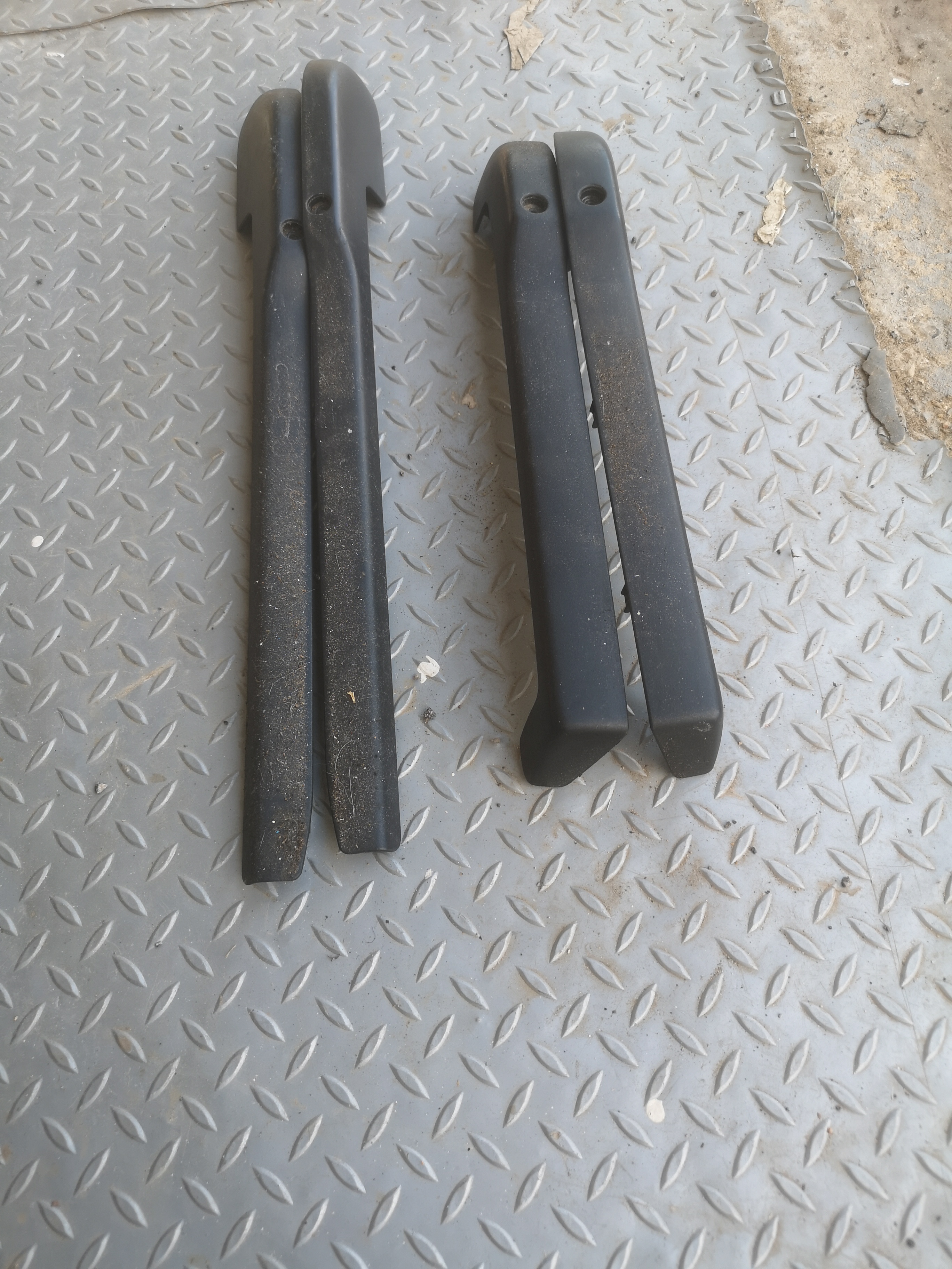

These runner covers give you an idea of the filth.

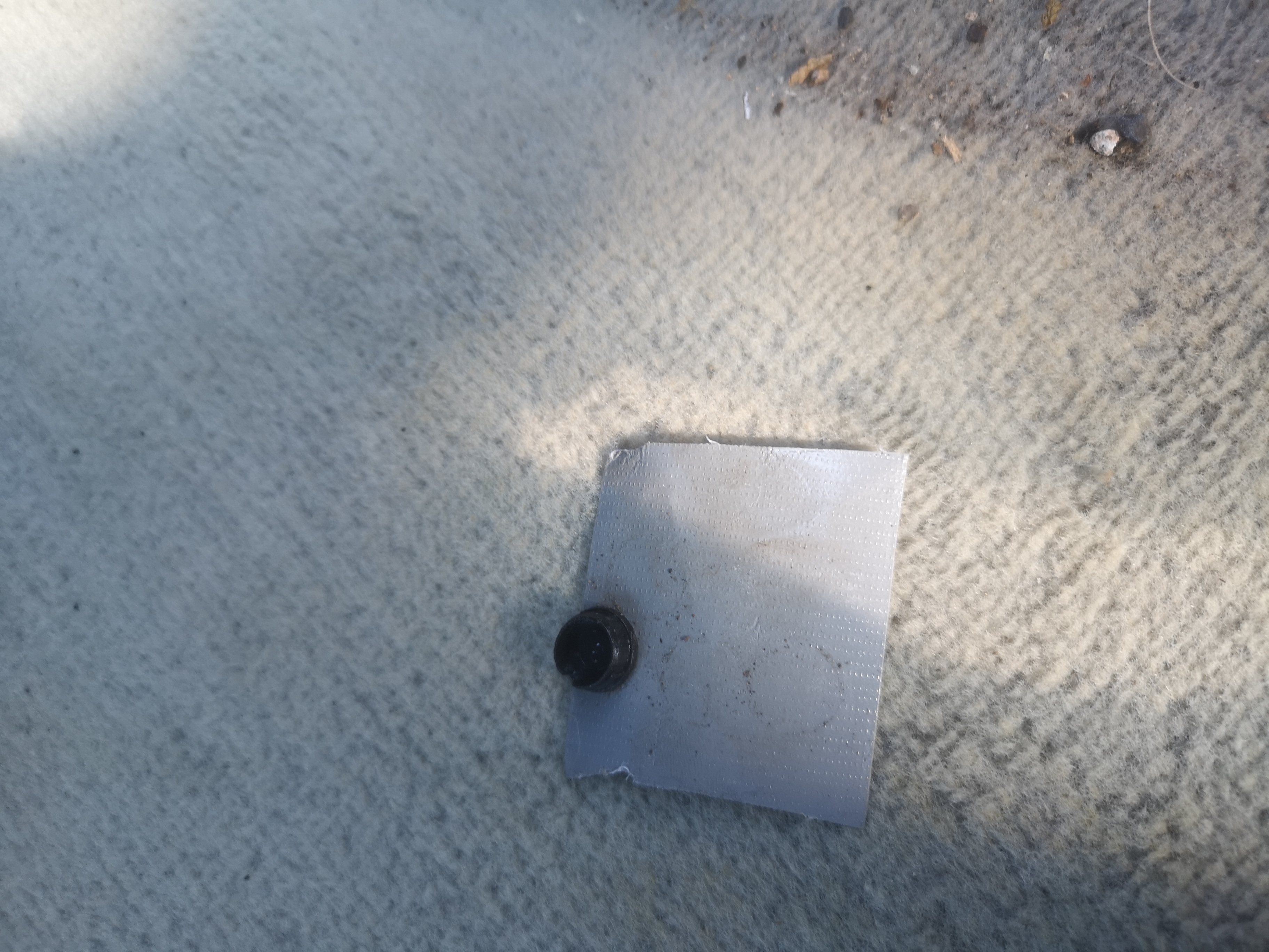

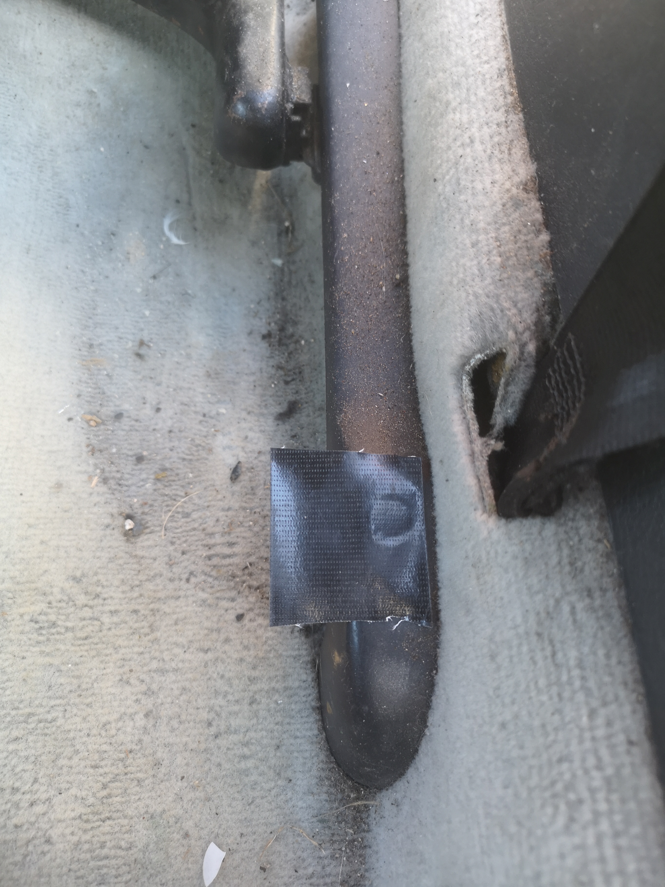

I always use a bit of gaffer tape to remove the plastic bungs over the screws

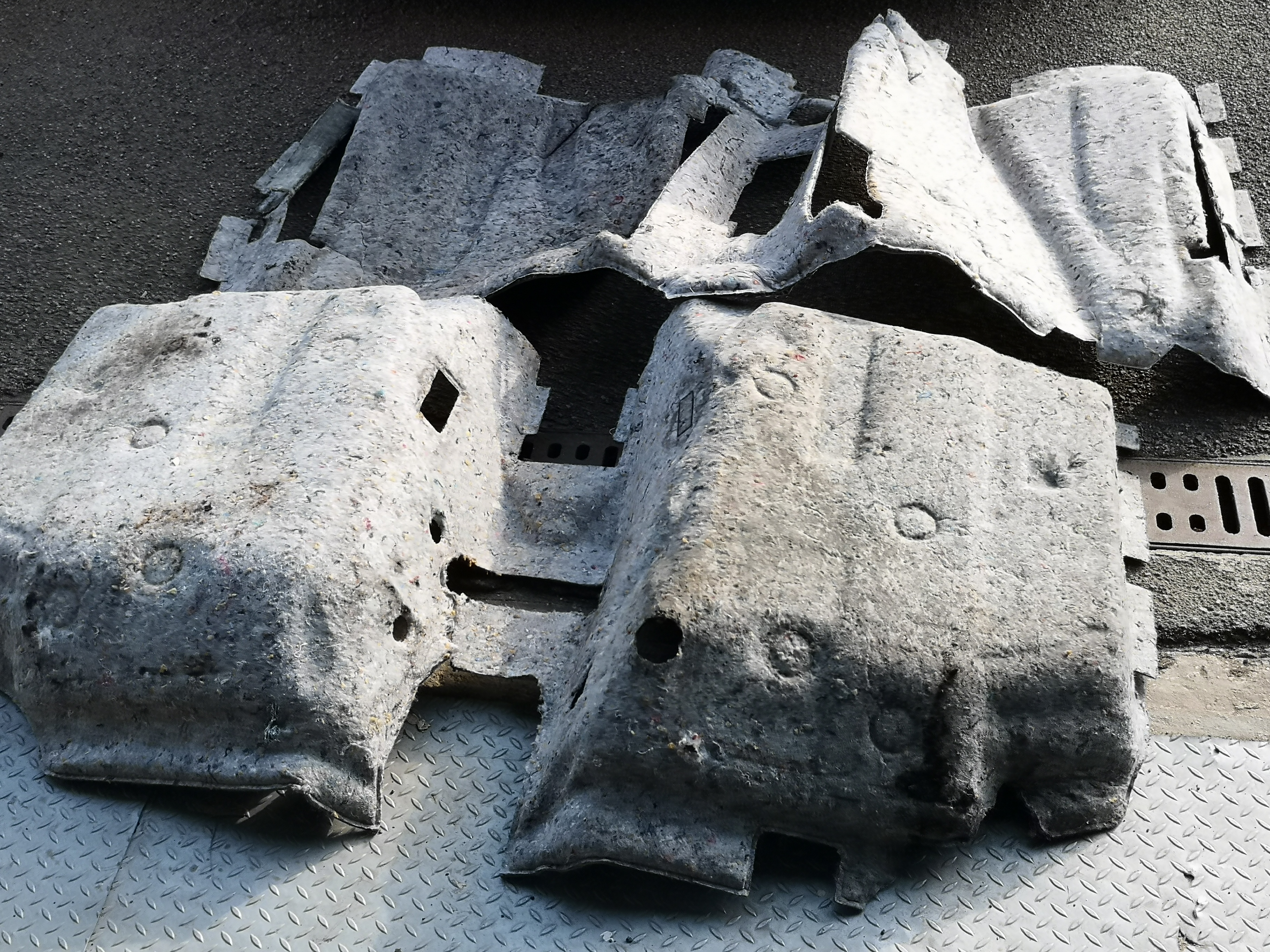

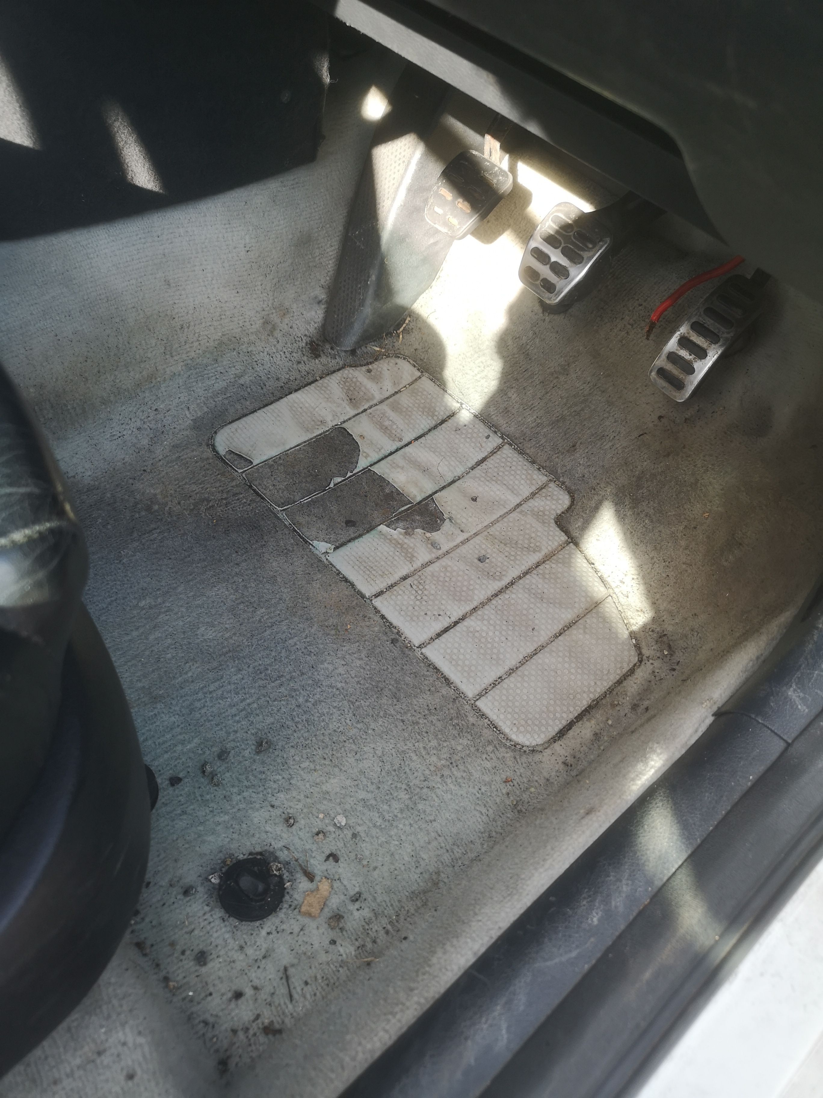

Damp underlay

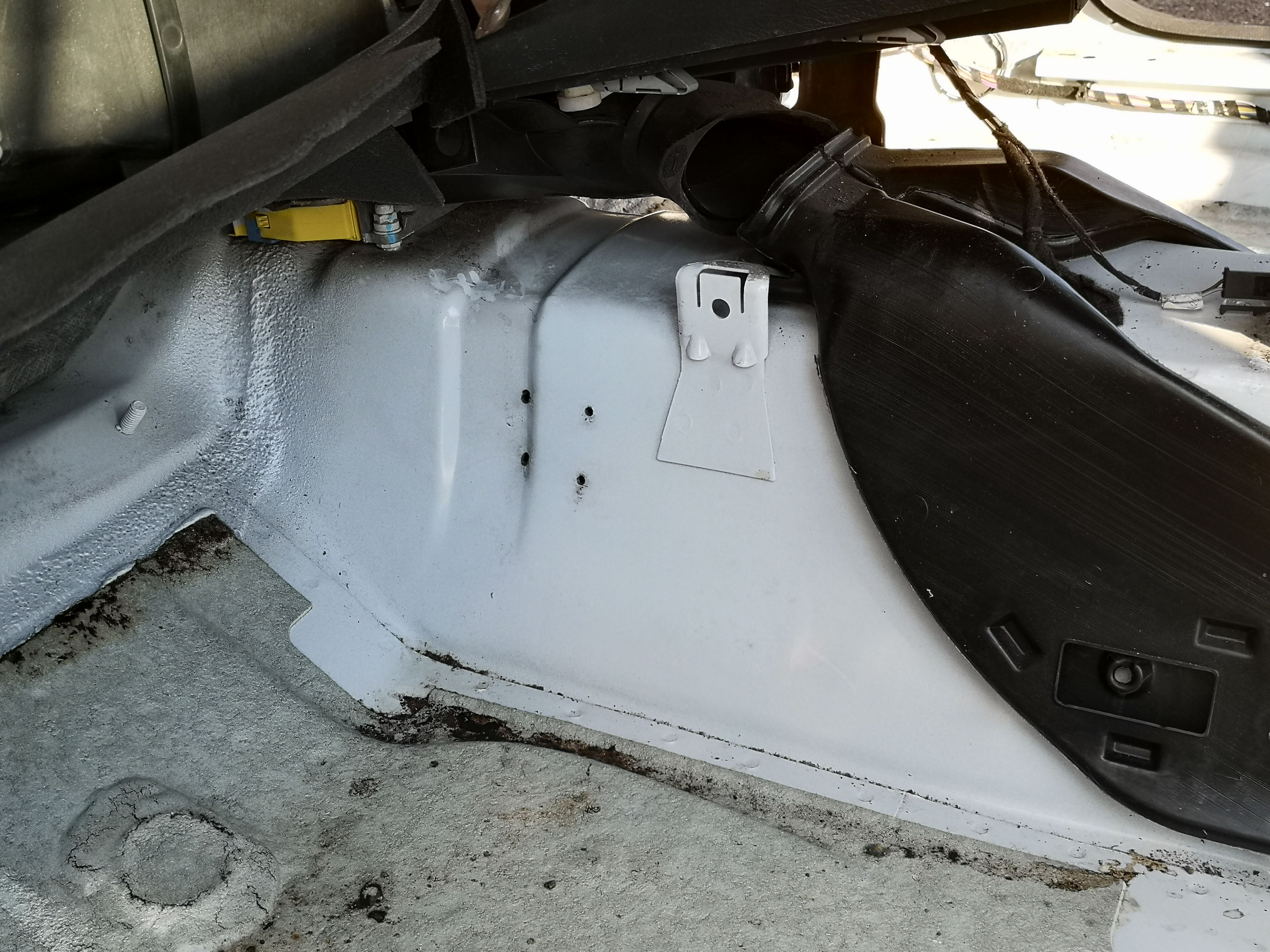

Looking cleaner. Luckily the floors not rusty

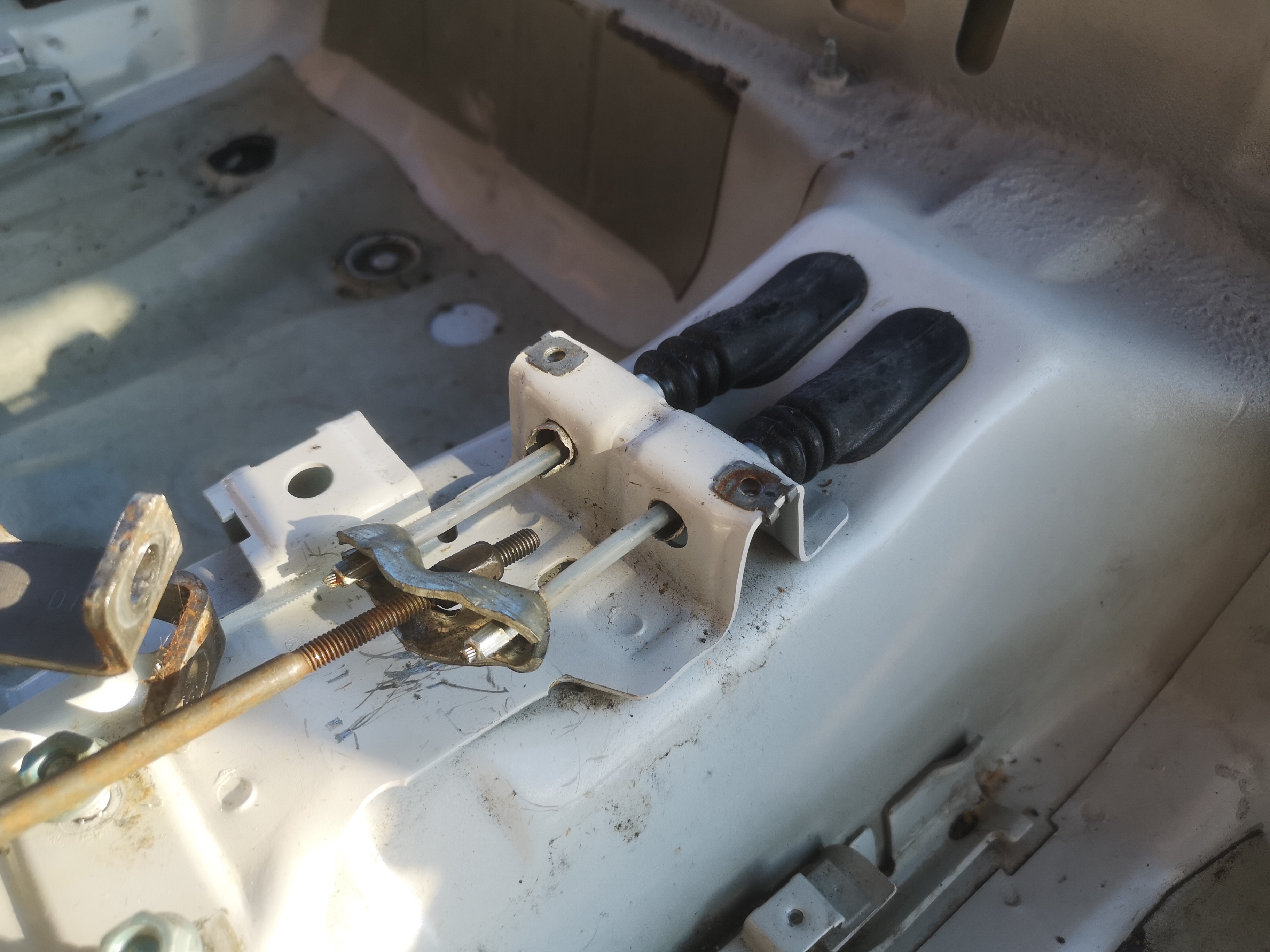

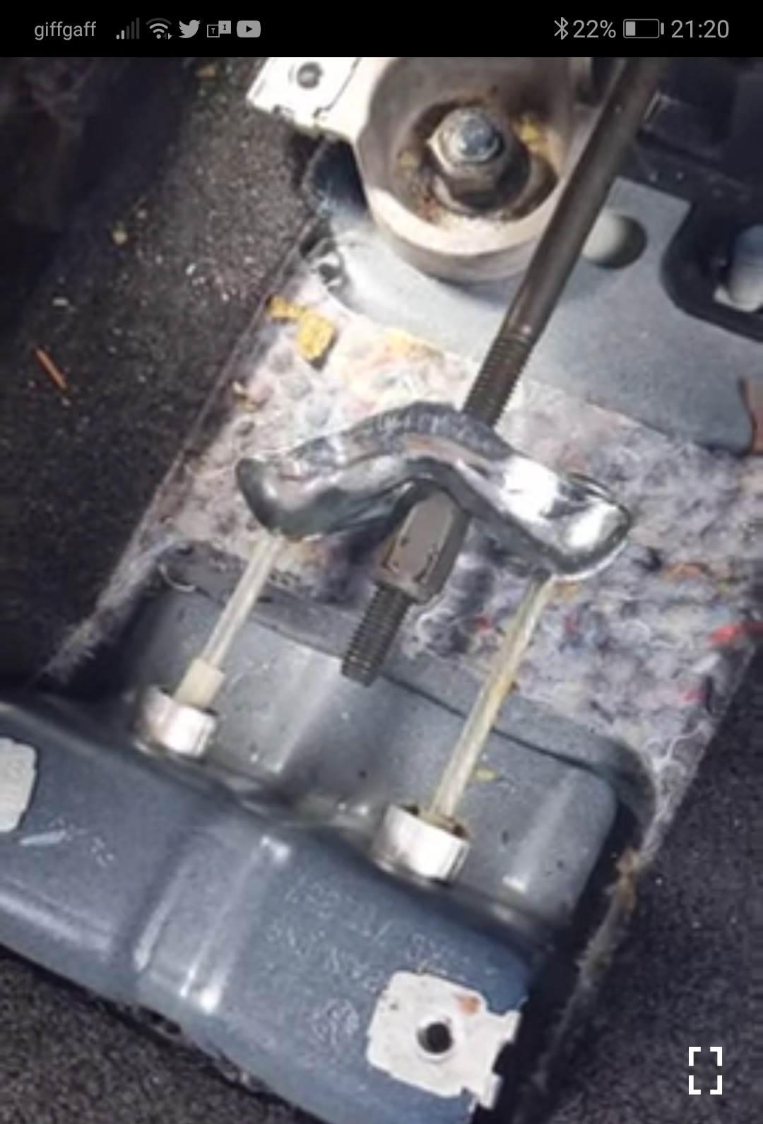

As if I didn't have enough to do I discovered the handbrake cable guides have been butchered, leaving rough edges and snagging the cables.
I'll have to change both guides.
Carpet shot, heal pad worn out, so will source a better example.
Cant believe how heavy the underlay is, it must weight 20kgs

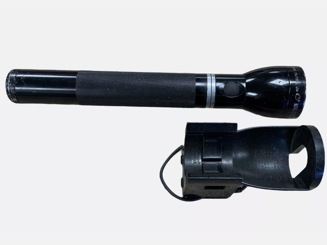

An example of this was a mag light and charger in the passenger footwell. I have found the original mounting point and sourced the correct light and charger.

Just for reference this is what the cable guides should look like

Excellent posts, thank you. The floor of your Octi looks factory fresh, amazing.

That's 10kg of underlay, and 10kg's of filth.
Great thread. The seats clean up really well.

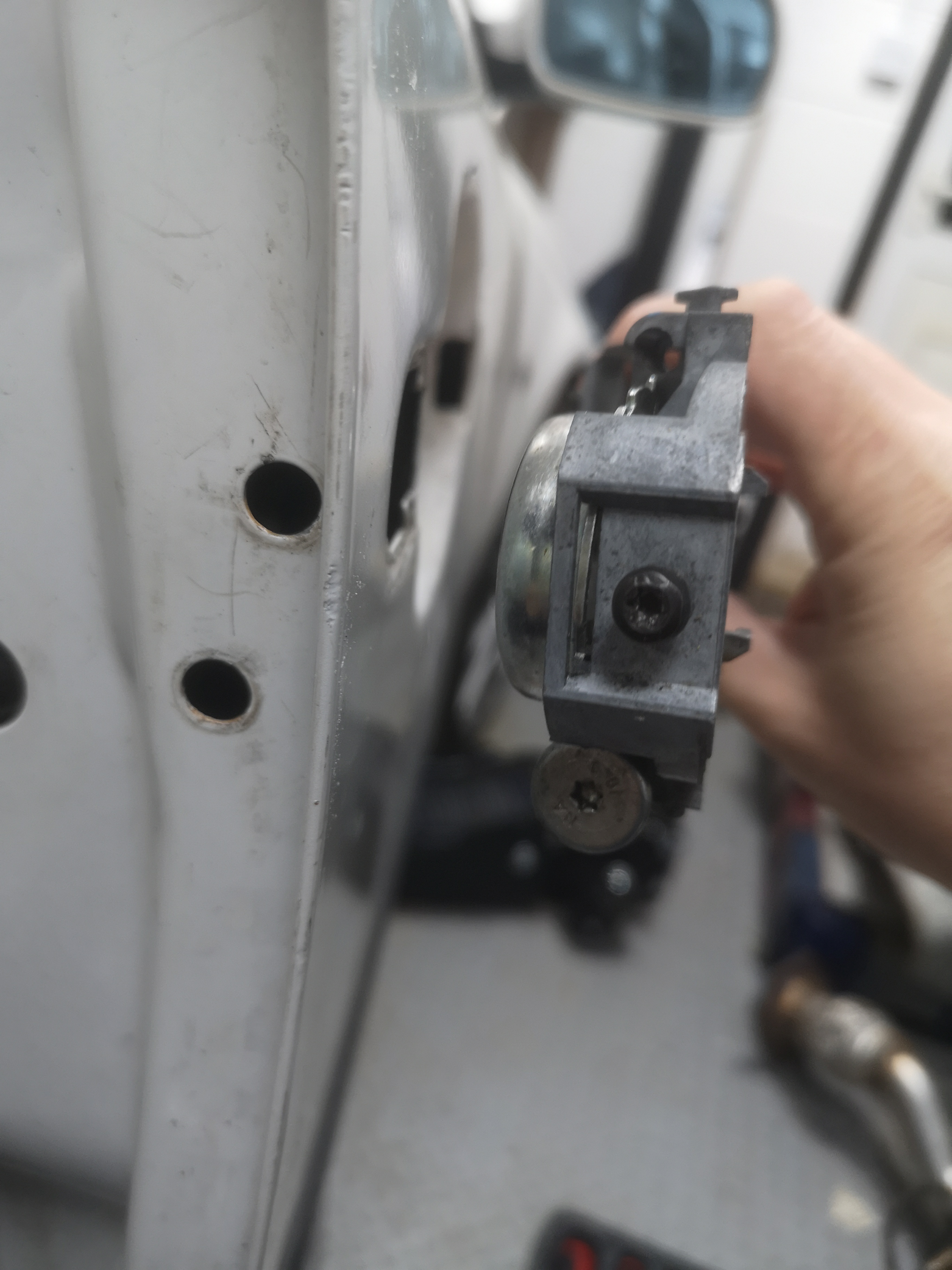

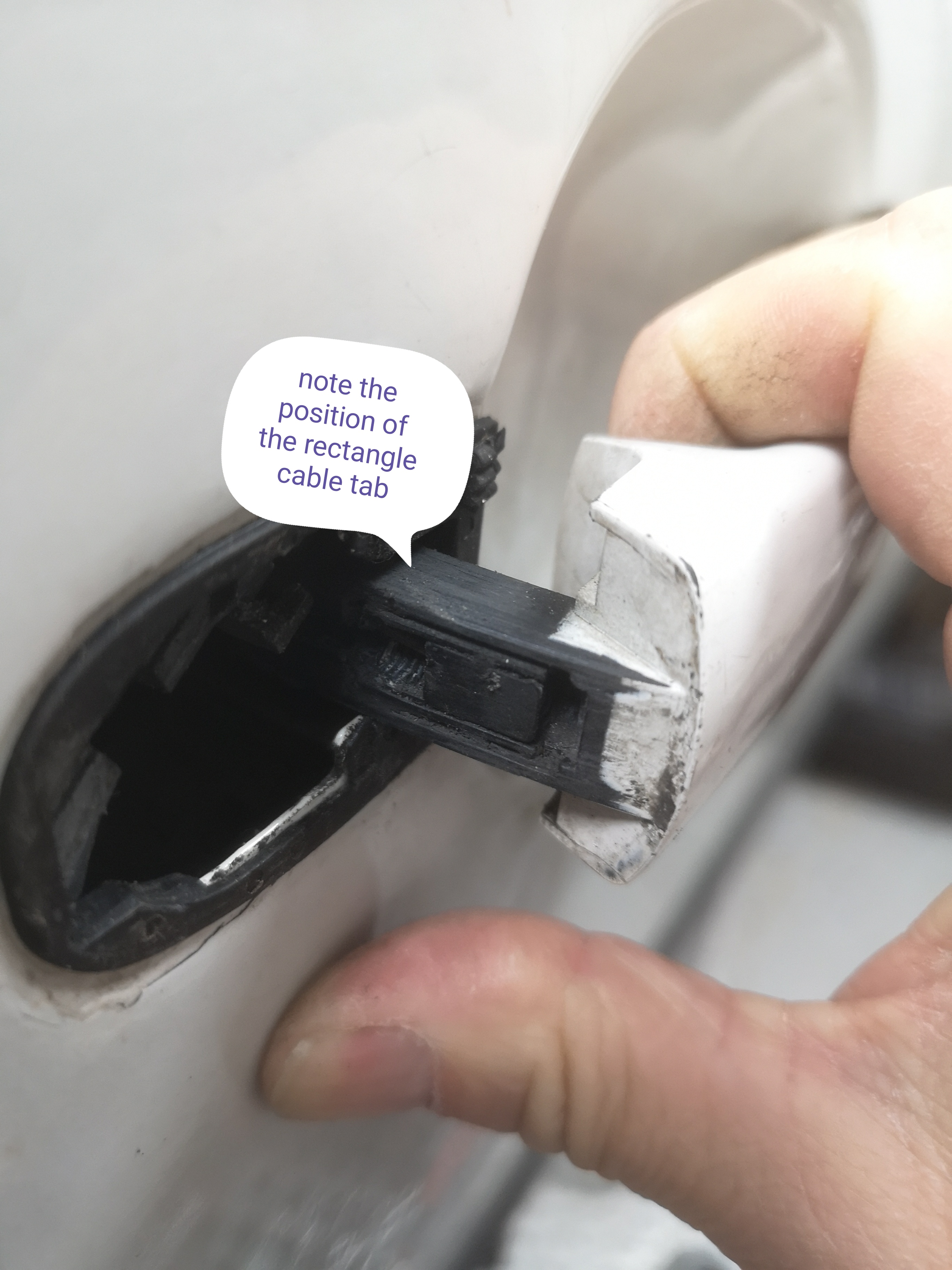

One of the many little jobs to sort on the car was the drivers door handle. Sometimes it wouldn't spring back into the closed position. I decided to take the whole handle mechanism out to investigate.
The door glass has to be removed first so that you can remove the inside part of the handle mechanism.  Next I popped off the two grommets in the side of the door to get to the screws olding in the door lock and retaining ring.  These do not need to be remove completely, just wound back a bit.
With the lock removed pull the handle open and make a note of the cable position and pop it off.
