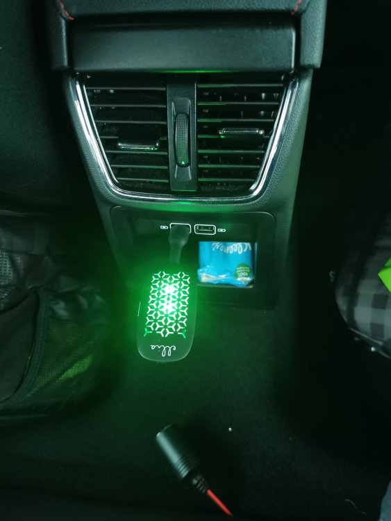

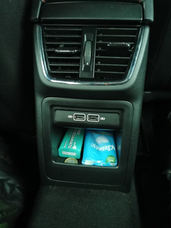

  4. Ive completed this with the above aliexpress part. Seems much better, everything you need for £50 and has a nice storage box instead of an ashtray. Im tempted to swap cables around behind fusebox from 12v socket to rear wiper. This would make 12v sockets switched and rear wiper permanent. Cant think of a better way to get switched 12v sockets as i dont want to have to remember everytime to unplug my devices
  5. Thats what i will be doing this weekend, I've ordered a pack of these piggy back fuses. Would be great to convert the 12v sockets to switched but doesnt seem to be possible

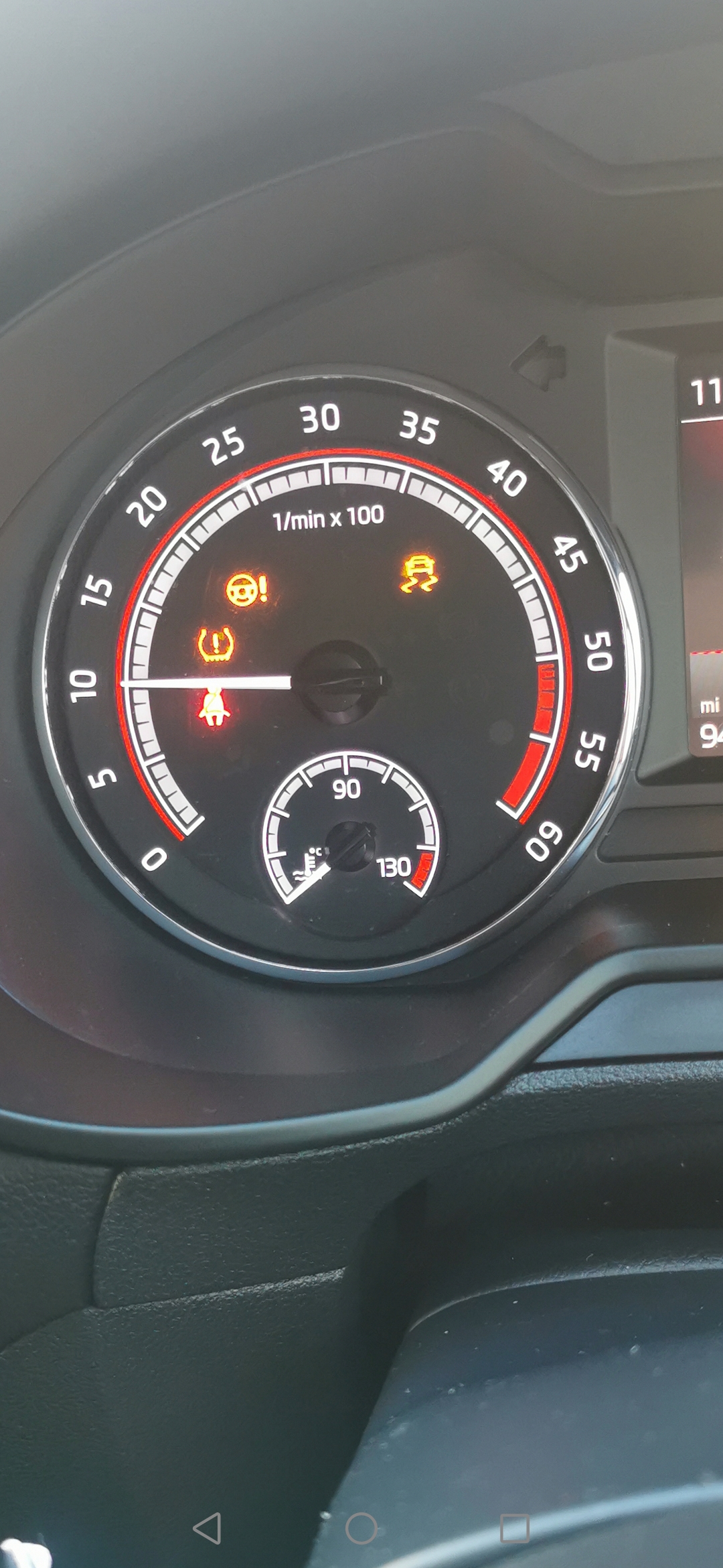

  7. What a morning, spent the last couple of hours wiring in the dealer towbar harness behind fuse box. Definitely something i dont want to do again!! All went well apart from snapping the shroud surrounding the fusebox connector. I still havent figured out the workings around it. Is it possible to order a new one or should it be ok? Anyway i have lights on my bike rack so its working But ive been presented with several warnings Manoeuvre braking error Start stop error ESC error Tyre pressure error Park pilot error Im waiting on my vcds scanner coming so will coding it fix these issues or is it a combination of the battery being disconnected and no coding being done. Any thoughts would be greatly appreciated
  8. I realise canbus can react negatively to changes being made but surely changing a device from permanent to switch isnt changing voltage levels, Its just stopping the device being active after engine switches off
  9. I would prefer to convert my 12v sockets to switched, is this not possible. I would of thought just a matter of connecting the 12v socket cable to an unused switched fuse??
  10. Im hoping to change the boot 12v power socket to switched. I want it to come on only when ignition is on. Im going to check fuse box this weekend but is it just a matter of swapping the cable behind fuse 40 and connecting it to a fuse that is unused and ignition fed. Im thinking fuse 48 for blind spot monitoring. This doesn't seem to be a feature on my 2018 octavia.
  11. Ive just been reading this. Cant believe the 12v sockets are permanent, cant think of a good reason for this. Will have to get a hardwire kit for the dashcam i think. Does anyone know if you can change the 12v sockets to switched. I have top drop the fusebox this weekend in order to wire in my towbar cable
  12. I installed a dash cam in my 2018 octavia today, ive ran an extension from the boot 12v socket to my glovebox then ran charger to glovebox. When i turn off my car the dash cam is still running. Surely the 12v sockets are switched feeds, maybe if i leave it it will power off. I was at work and didnt want to take the chance

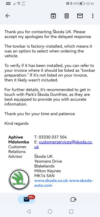

  19. Ive ordered an oris detachable from PF Jones along with the dealer specific wiring. My car doesnt have towbar prep, ive also ordered a hex scanner to program it myself
  20. Ive ordered an oris detachable from PJ Jones along with the dealer specific wiring. My car doesnt have towbar prep, ive also ordered a hex scanner to program it myself

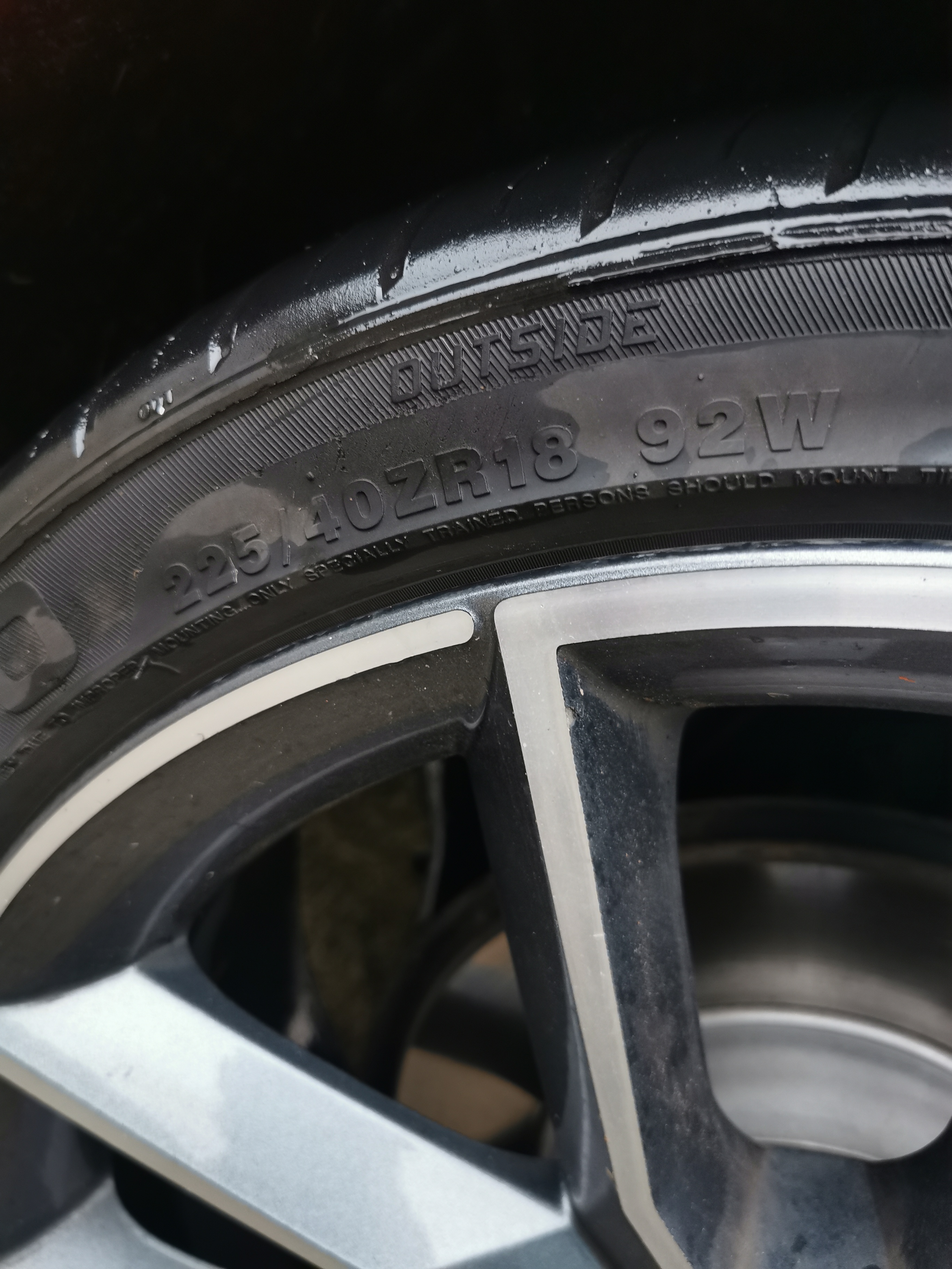

  24. Will be getting new tyres on my octavia this week sometime. Since ive only recently bought the car i want to make sure im getting the right size as i know you can use slightly different spec etc
  25. No my code is 1D0 so no trailer wiring prep Im ready to order a detachable Oris towbar from PF Jones, i want to order the specific wiring but does that i mean i need extra wiring to go back to passenger fuse box?
