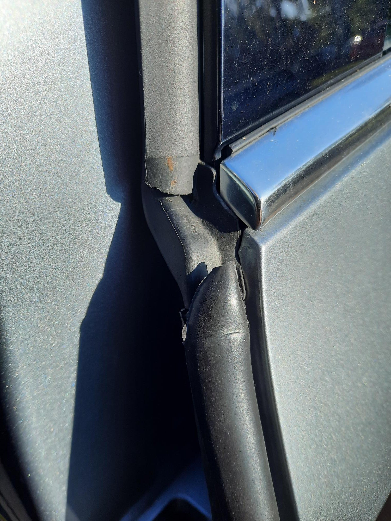

  7. Hi I hope you don't mind these questions: 1. Did you find that you had to fit these an inch or so down from the very top of the door (there's a bit of rubber at the top which gets in the way. See picture)? Or did you cut the top of the strip so that it flapped over the top of the other rubber trim (and glue down onto it)? 2. Did you have to cut the trim short at the bottom to shut the door (the gap gets very tight at the very bottom)? Any advice appreciated. I'll then go for it, i.e. cut the trim to size (no going back when I do, hence the questions and trepidation :-)). Many thanks.

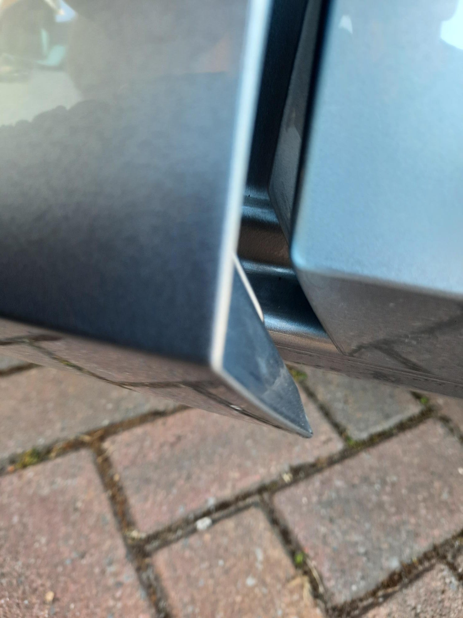

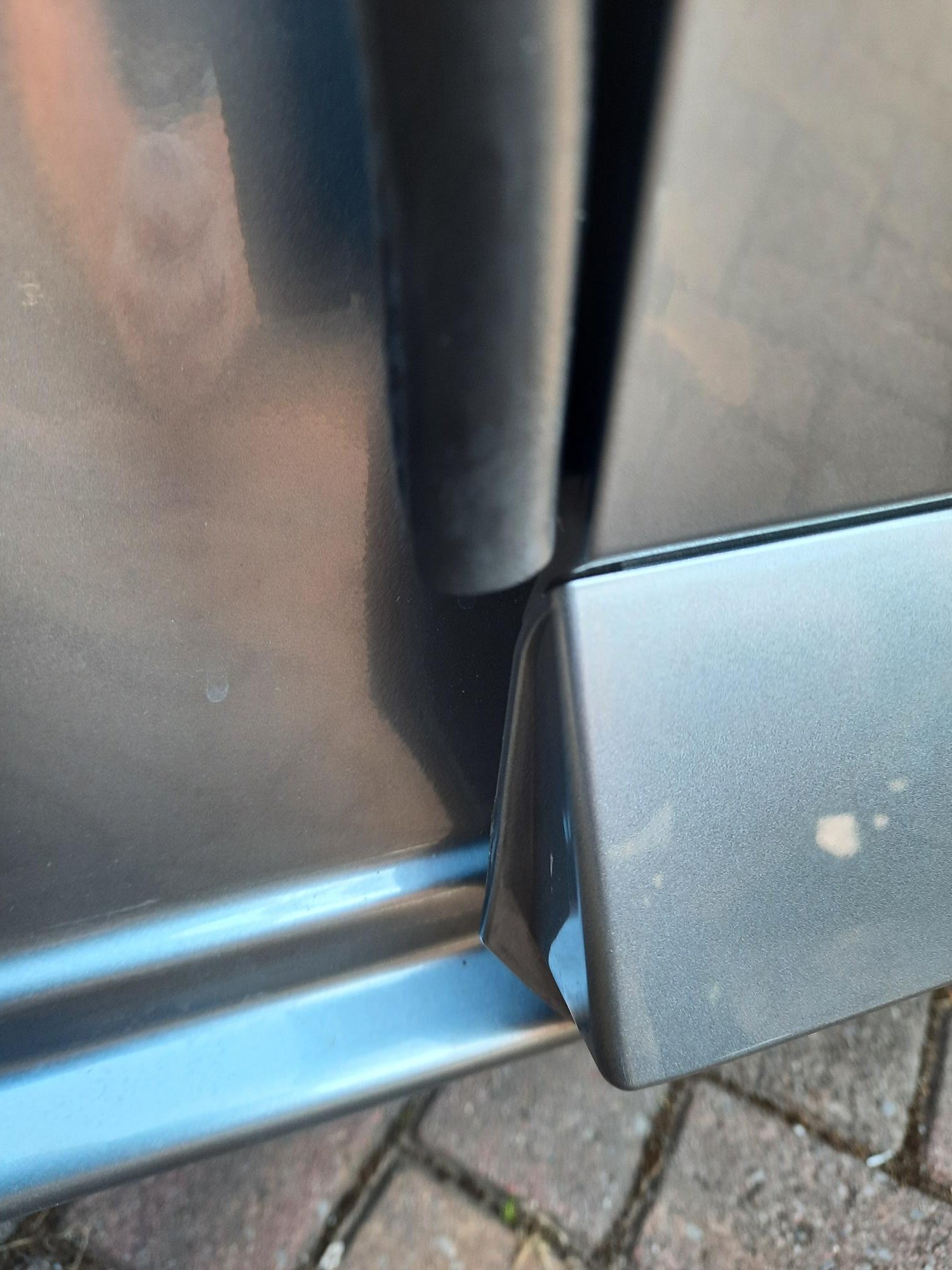

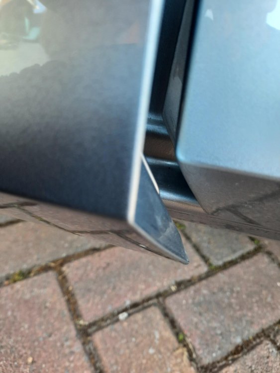

  11. Hi Does anyone know if an additional rubber trim attached between the front and rear doors (along the edge of the rear door. See picture) to seal the gap would help reduce road/wind noise entering the cabin? I've noticed that luxury cars seem to fill this gap with rubber - maybe for this reason as well as keeping the inside of the doors clean. Unfortunately I can only seem to find universal rubber seals but I'm not sure if they will fit. Wondering if anyone has found any that fit that they would recommend please. Thanks.
