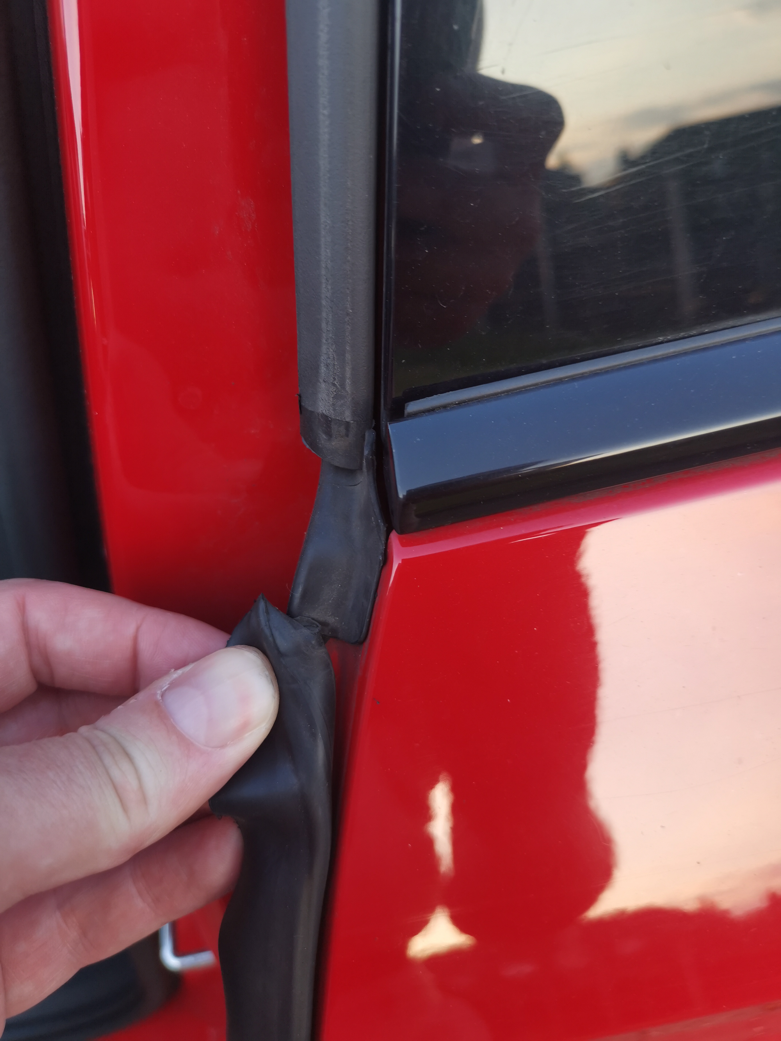

Hi
I hope you don't mind these questions:
1. Did you find that you had to fit these an inch or so down from the very top of the door (there's a bit of rubber at the top which gets in the way. See picture)? Or did you cut the top of the strip so that it flapped over the top of the other rubber trim (and glue down onto it)?
2. Did you have to cut the trim short at the bottom to shut the door (the gap gets very tight at the very bottom)?
Any advice appreciated. I'll then go for it, i.e. cut the trim to size (no going back when I do, hence the questions and trepidation :-)).
Many thanks.
No worries with the questions.
I went to a slight overlap like you did there at the top as in my pic
The bottom doesn't really stay in place where I have it as the door pushes it off.
But it stays fine just above the sportline door trims there where your pic shows.
It would probably be best if it went right to the bottom but it won't stay.

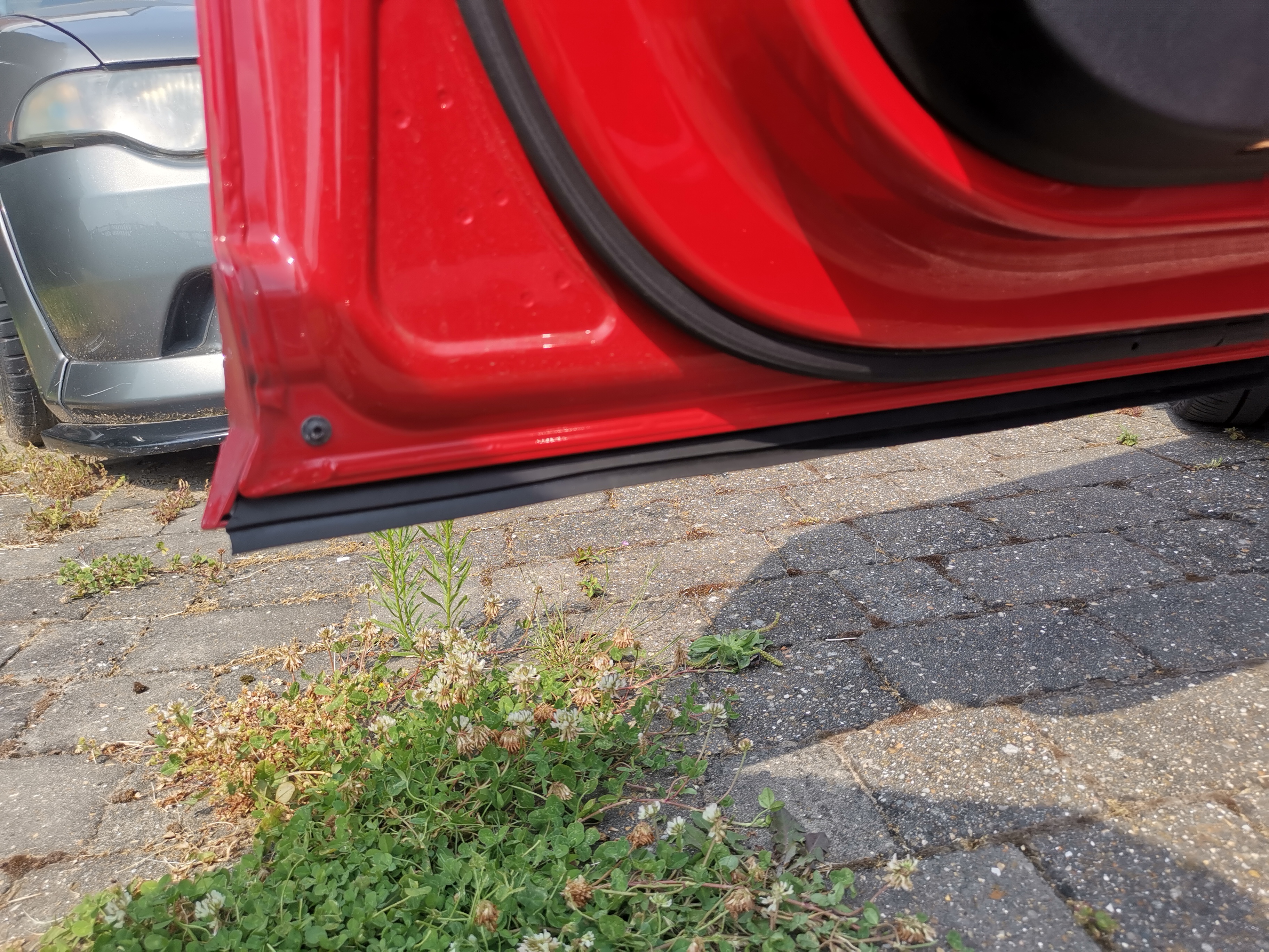

Just added a "z" profile seal to each front door leading edge and lower edge from the inside.
Wether this will do anything remains to be seen/heard.
I didn't have enough left do do the lower portions of the rear doors.

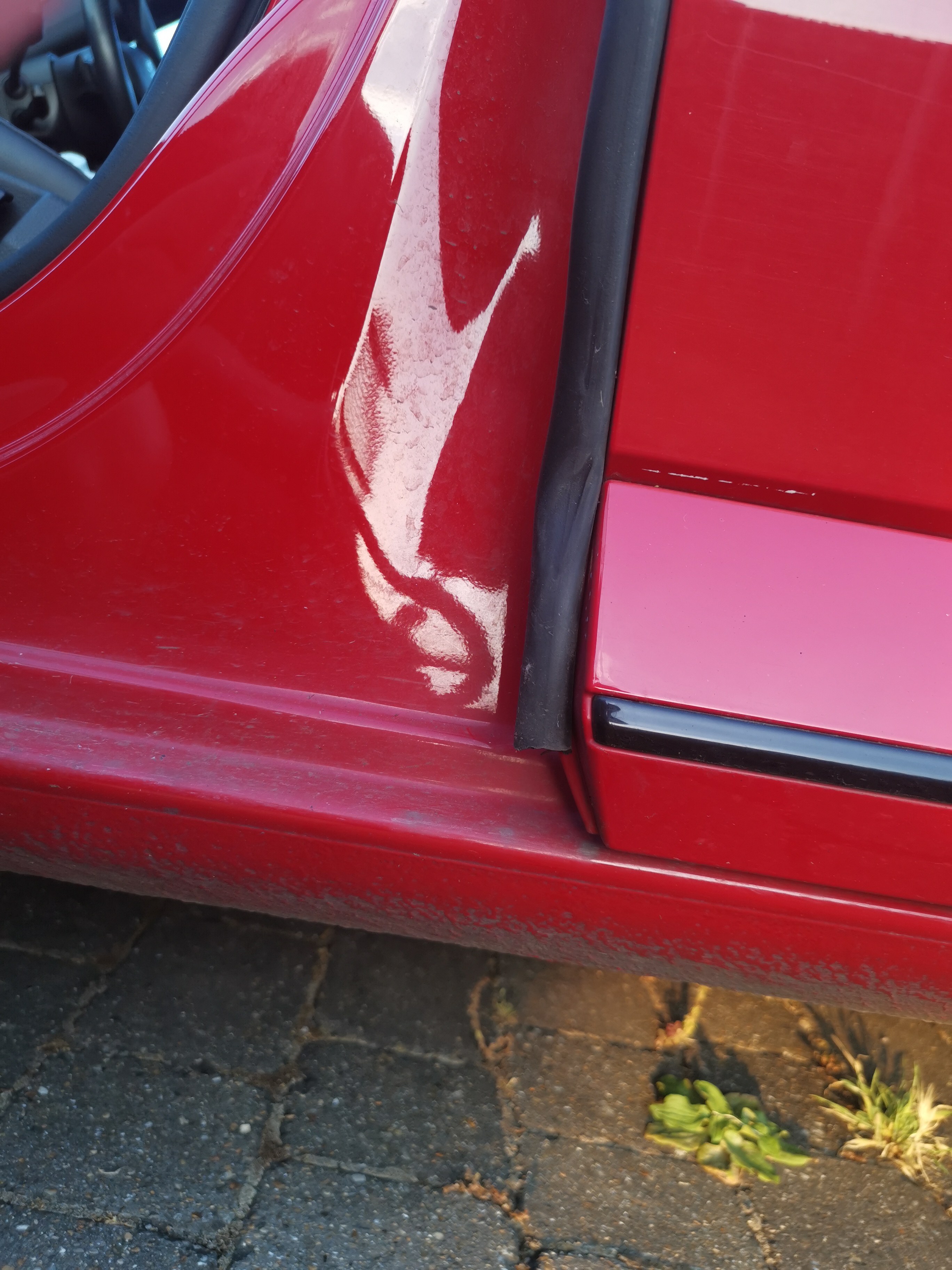

Finally had some time to fit these things, that were laying around since weeks ... must take phots next time, it became dark quick and they did not look very good ...
I used the "ali" 'z' profile on leading edge of both front doors, and also on woman-mobile (CT200h). Good trick is in this cold weather to warm them up with a heat gun or similar (carefully! is not needed to "cook" the rubber!) to soften a bit the adhesive.
After a couple days of use, seem to hold well. I am not so much targeting noise reduction as I am targeting "muck reduction", but will see, have not gone out on the highway to check.

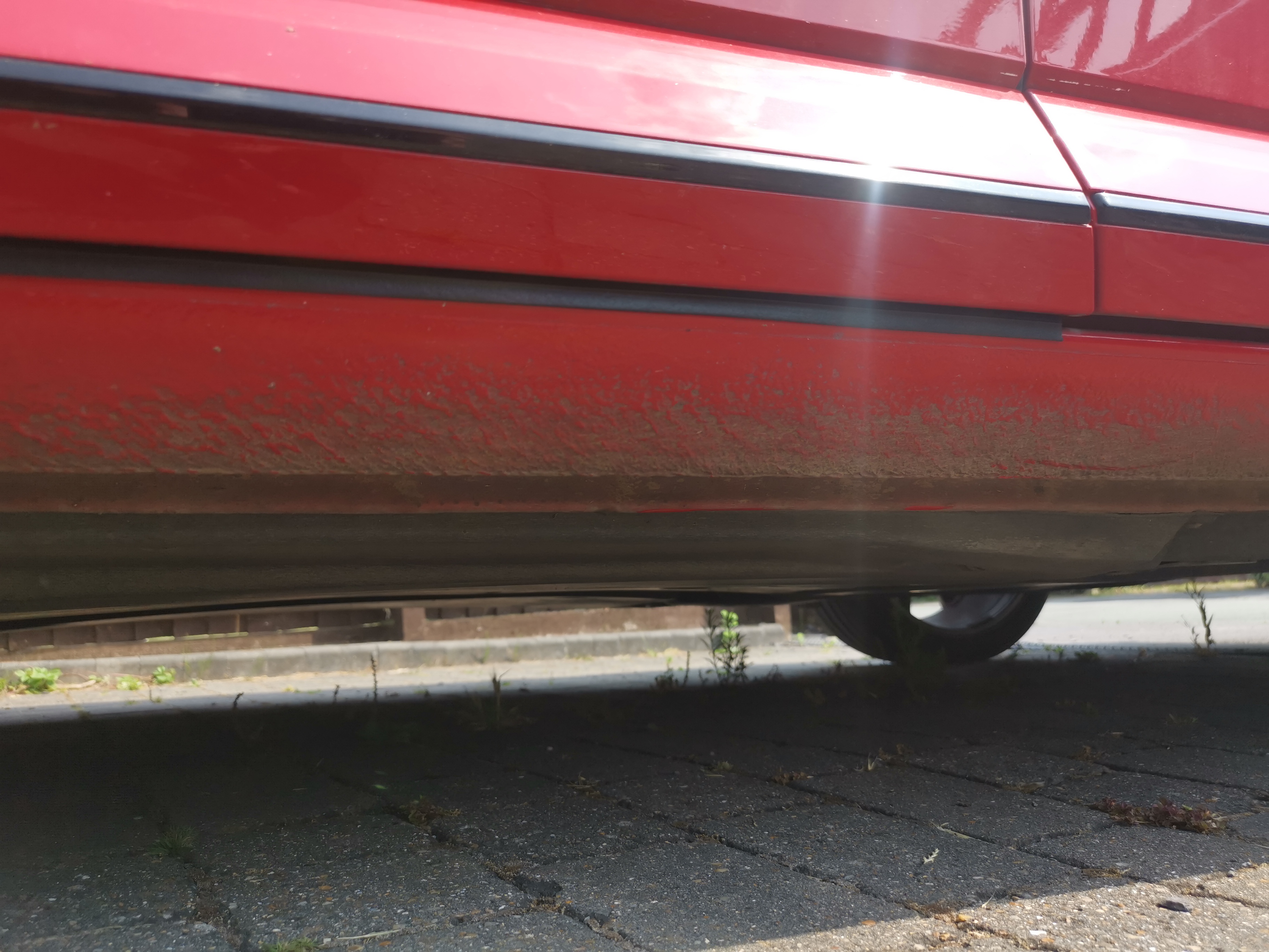

I tried to use the remaining 'z' profile but I am not really keen in fitting them to the bttom of the doors, I do not like the result on Calskil's car above. Tried in different places, but there is nowhere else to put them but on the leading edge of front doors really. At 1 euro per car, a bit less than 2m ... good I say.
I will try next the "sloping D" from Martini and see, this exactly to keep clean the sills.

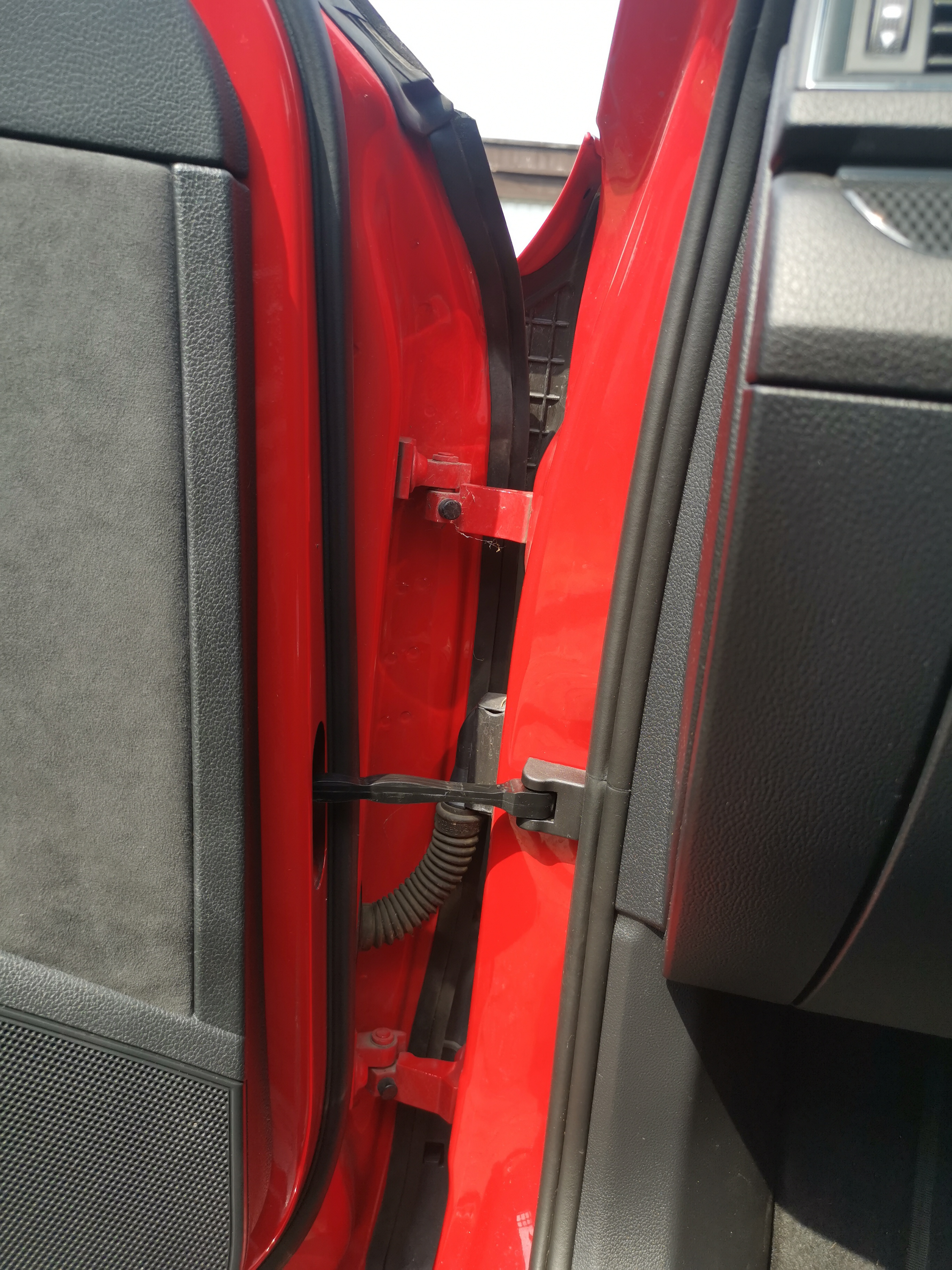

In between the doors I used these
https://www.aliexpress.com/item/1005007437544971.html?spm=a2g0o.productlist.main.4.7b23YDC4YDC4qE&aem_p4p_detail=202510282354586620434343926620000396726&algo_pvid=fb0d42a2-391c-452e-b597-31eab4724403&algo_exp_id=fb0d42a2-391c-452e-b597-31eab4724403-3&pdp_ext_f=%7B%22order%22%3A%226%22%2C%22eval%22%3A%221%22%2C%22fromPage%22%3A%22search%22%7D&pdp_npi=6%40dis%21EUR%2131.83%2115.87%21%21%2136.21%2118.05%21%402103129017617208984936252ebfe2%2112000040754026618%21sea%21SI%210%21ABX%211%210%21n_tag%3A-29910%3Bd%3A9c01a61%3Bm03_new_user%3A-29895%3BpisId%3A5000000190286789&curPageLogUid=X0ehZxL2Ym00&utparam-url=scene%3Asearch%7Cquery_from%3A%7Cx_object_id%3A1005007437544971%7C_p_origin_prod%3A&search_p4p_id=202510282354586620434343926620000396726_1
instead of the ones suggested, I believe this is a firmer grip and larger edge for sealing. No issues whatsoever with door closing, and no "pull" (when you see the door edging out). The CT200h had already this originally from the factory!
