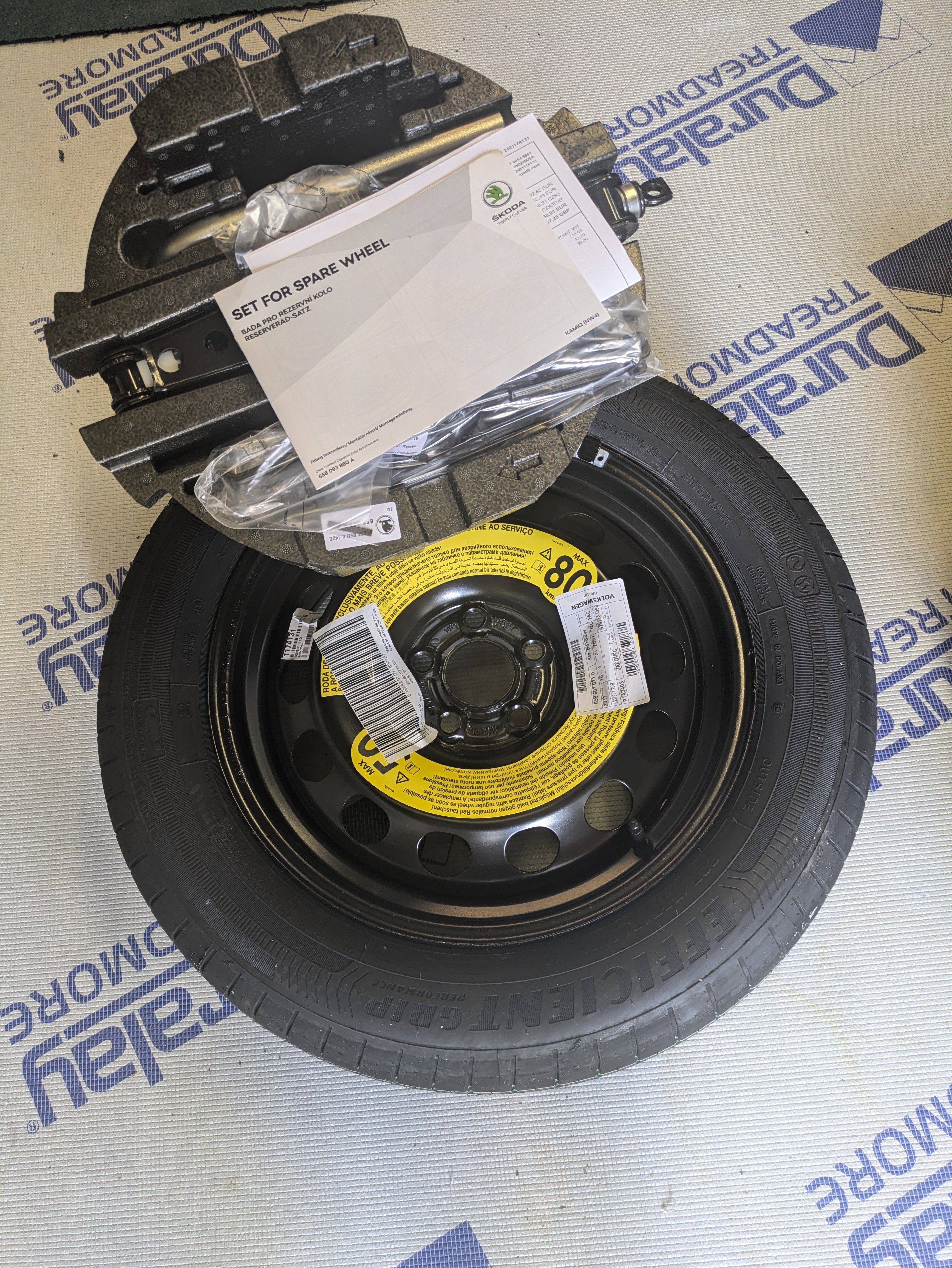

  4. Shipped Monday from Czech arrived today. Can't fault it. Fit perfectly (as you'd expect of course)
  5. Great!. That's all too much for my simple brain. I'll live with the Skoda listed option. Hopefully it'll never be used👍

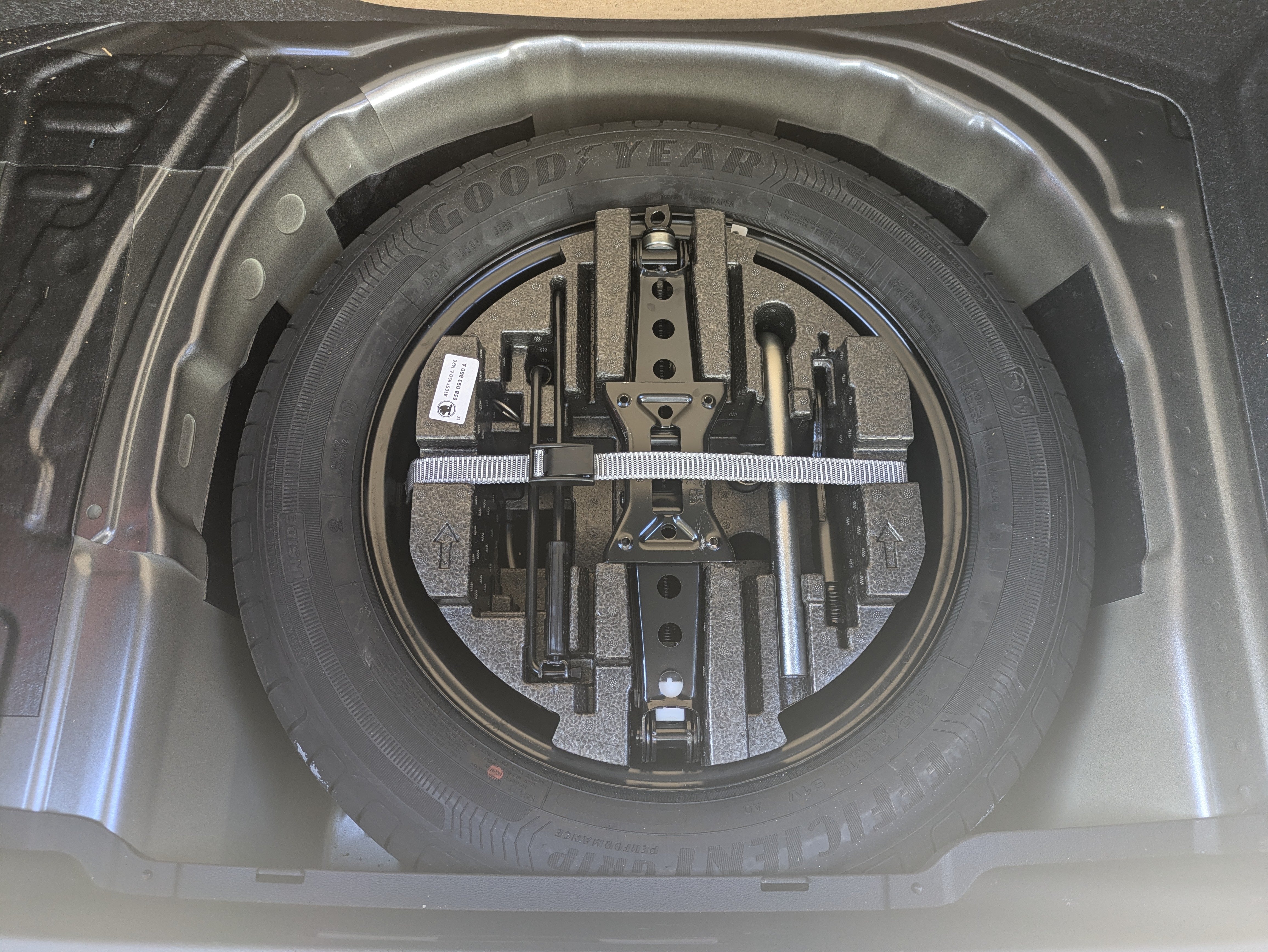

  6. Just ordered the spare wheel and wheel kit from Skoda Parts (Czech). Total cost 231 Euros (£196) delivered by Fedex in 5 -7 days. Best price a UK dealer could do was £220 and that was giving 10% off. 2 others were £260 (ish). They would have to order it and I'd have had to collect. None of the dealers seemed at all interested in competing. Used the (Czech) outfit for a set of mud flaps previously. Great service.
  7. FWIW... Mines an October 23 model MC and looks similar. They get such little use as most of the weight transfers to the front. I've taken to pulling the handbrake on when slowing down every so often as it cleans then up a treat.
