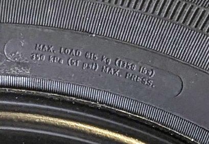

By the way, what pressure should be maintained in such a “dokatka”?
Maintain the spare at a high pressure when stored maybe 60 psi, and if you have to fit the spare then you can let some air out.  Easy to have a tyre pressure gauge in the car even if you have no means of inflating a tyre.
It turns out you should read the inscriptions on the wheels. Here I found a specific answer to my question. I will follow the manufacturer's recommendations.
Taking into account that the width of the installed wheels and spare parts are the same, we will limit ourselves to a pressure of 2.5 bar.
