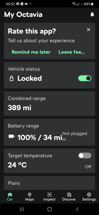

PHEV Climate control won't remember OFF state after unlock and restart
If you are registered and therefore assigned as primary user then I don't think any other account/person could also have access. Sorry if that's not the answer but was worth a try.
Possibly linked to the remote access app or settings from previous owner? You might be turning the HVAC off on exit but the setting then revert to whatever is/was previously set? Are you logged in with My Skoda app for your vehicle?
