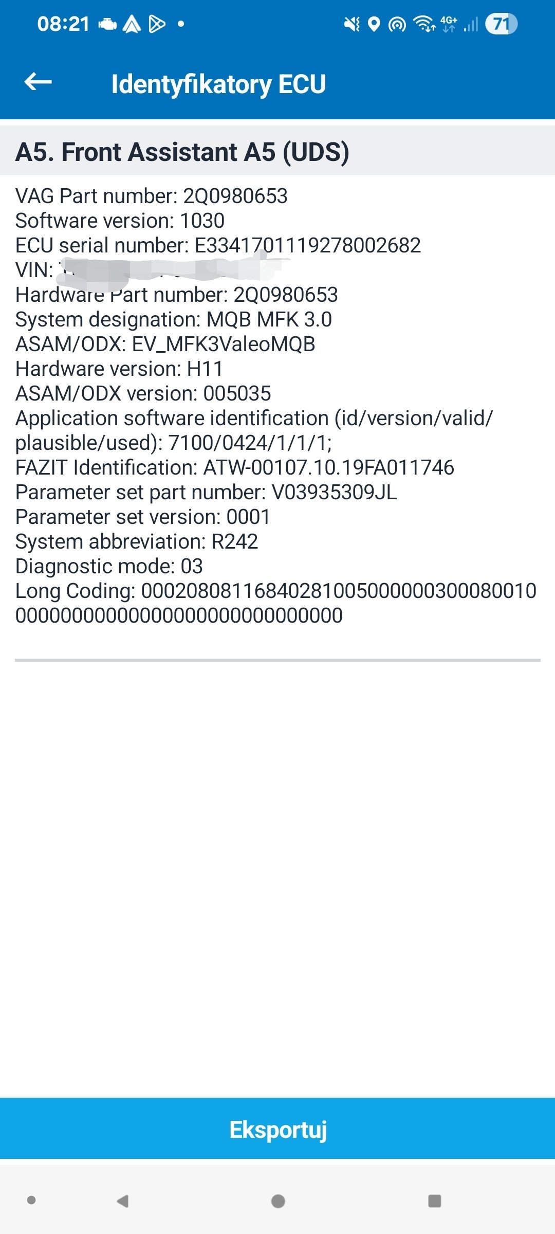

Is there any chance that someone with same car, same camera A5 and software with working lane assist share full long coding so I can compare and see what is not working? Due to the car being facelift and car scanner limitation I can only see numerical values in long coding, no adaptation are a ailable to be seen. My details: Superb FL (2019-2023) A5 camera 2Q0980653 Software 1030 Something is missing as lane assist is present but error "not currently available" shown and adaptive lane guidance is not available to select but vibration on steering wheel can be selected. Many thanks!

Ok, tried other additional coding for lane assist and adaptive lane assist but no luck, still don't work. I backed off all changes and revert car to it's previous state. I will have to try obd11 if find one unless someone will direct me in right direction with car scanner. A5 Camera details: Camera: 2Q0980653 System: MQB MFK 3.0 Software: 1030 Parameter set: V03935309JL It is annoying as I was looking for being able to code lane assist π Cheers

Hi guys. I tried to code lane assist for my 2019 SUPERB FL using Icar pro Vgate and car scanner pro. Lane assist is showing on dashboard and in the options but it doesn't work. The icon is yellow, car displays message that it is not currently available. What did I miss... A5 camera is 2Q0980653. Any help would be appreciated. Many thanks! Maybe there is someone with Obd11 in Shrewsbury area wilkingvto help if car scanner can't perform this coding?
