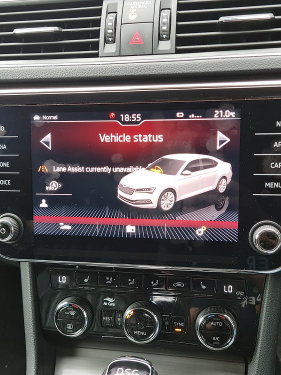

Hi guys. I tried to code lane assist for my 2019 SUPERB FL using Icar pro Vgate and car scanner pro. Lane assist is showing on dashboard and in the options but it doesn't work. The icon is yellow, car displays message that it is not currently available. What did I miss... A5 camera is 2Q0980653. Any help would be appreciated. Many thanks!

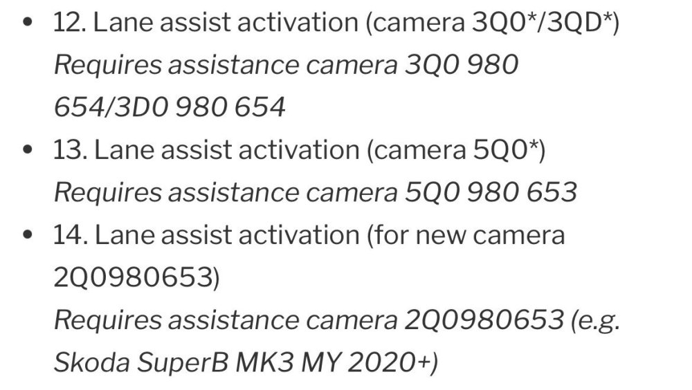

Are you certain that’s the part number of your camera? And did you definitely use the correct activation coding? There are different ones depending on camera hardware.
Yes, I checked in ECU identifiers and other activate coding would not work or is unavailable Screenshot_20260617_080322_Gallery.jpgI'm sure coding is OK as it enabled lane assist but adaptive lane guidance is missing and probably need power steering coding. I'll have a look today.. It's almost there...

Everything else works fine, ACC, front assist, blind spot, rear traffic. Car is washed and took it on motorway few times... Still not working. It's there but somethung missing. I will ha e a look today if there is additional codo g for adaptive lane assist. I will update soon👍
Ok, tried other additional coding for lane assist and adaptive lane assist but no luck, still don't work.
I backed off all changes and revert car to it's previous state. I will have to try obd11 if find one unless someone will direct me in right direction with car scanner.

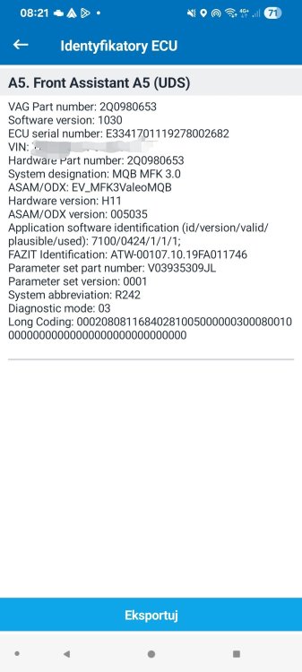

A5 Camera details:
Camera: 2Q0980653
System: MQB MFK 3.0
Software: 1030
Parameter set: V03935309JL
It is annoying as I was looking for being able to code lane assist 🙁
Cheers

A5 Camera details:
Camera: 2Q0980653
System: MQB MFK 3.0
Software: 1030
Cheers

There is long coding number there for A5 unit. Also someone with similar to mine problems mentioned A5 camera software update from 1300 to 1302 fixed the issue as Binx1310 mentioned.
I have a choice now and hopefully you more experience colleagues could advise:
  • Enter long coding in A5 unit and see if it work
  • Find the file for software update/get it from Skoda 😬
  • Forget it and try Obd11...
  • Forget it altogether and accept defeat (not an option 😂)
Just to clear it - do I just change that long code value in long coding in A5 menu in Car Scanner? That's it?
Many thanks, hopefully I will get somwhere with this lane assist 😂
