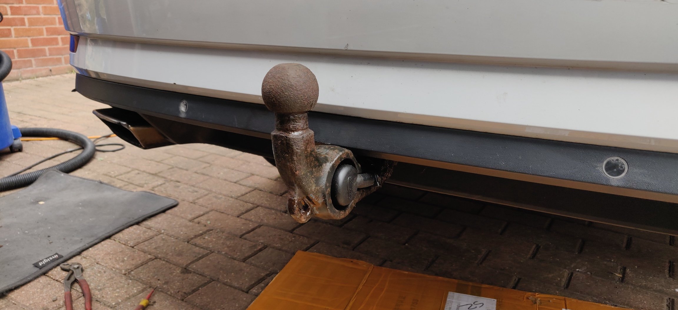

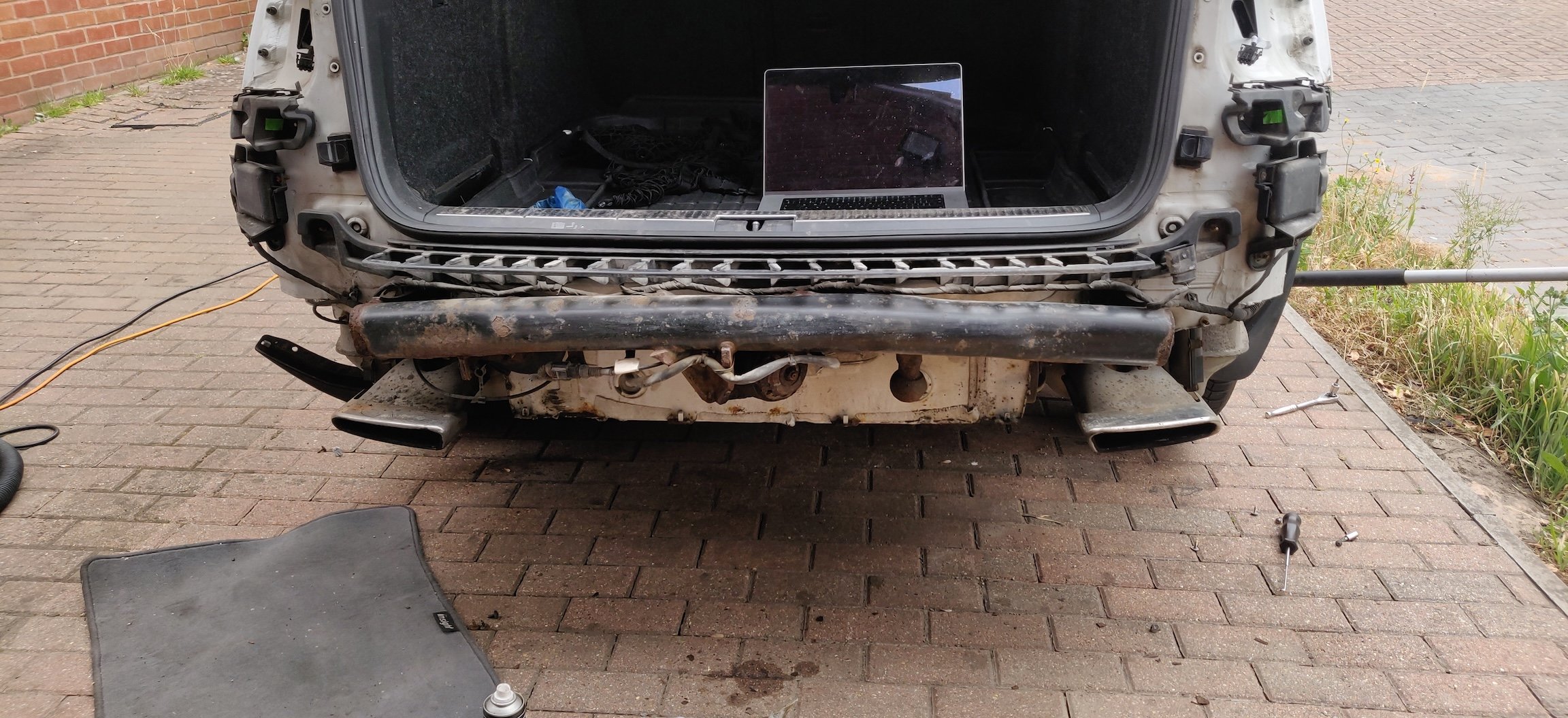

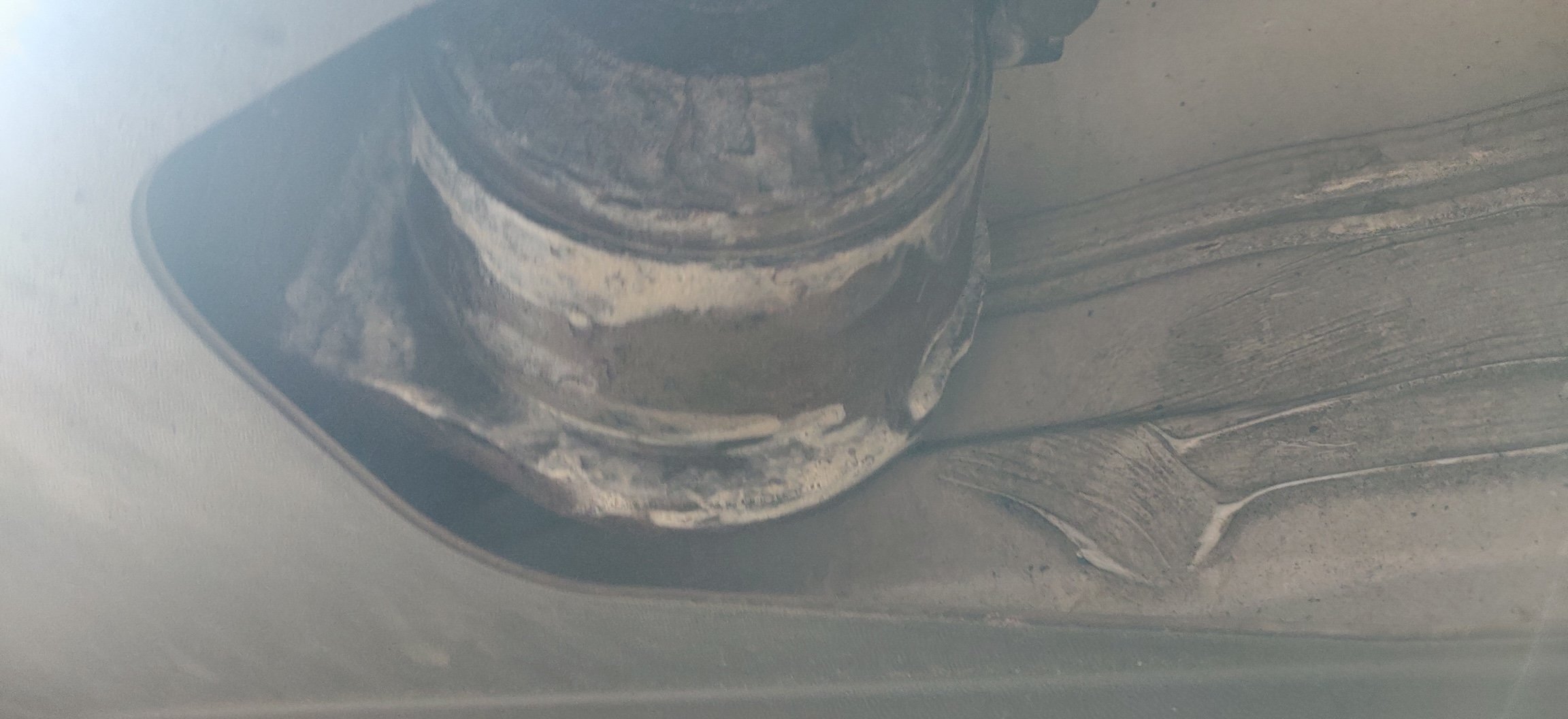

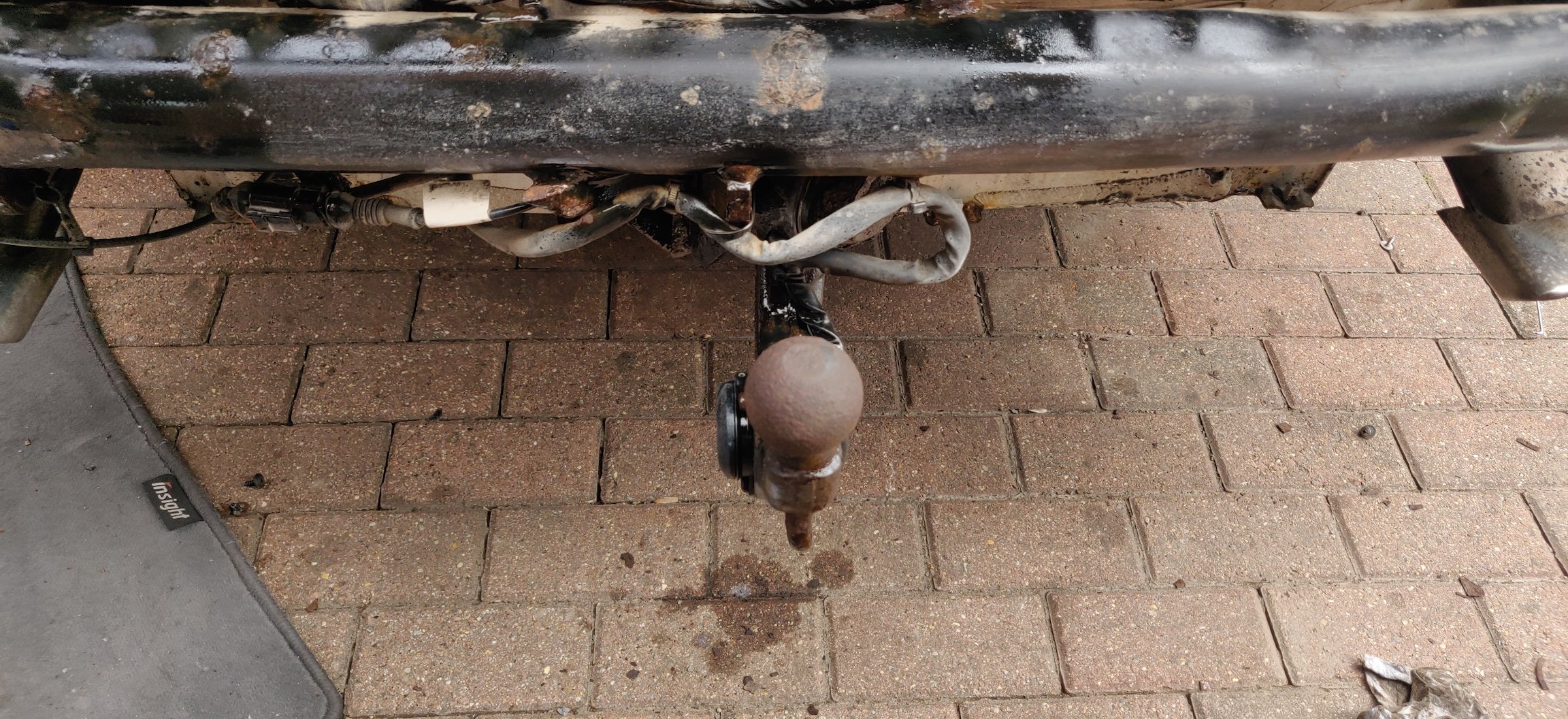

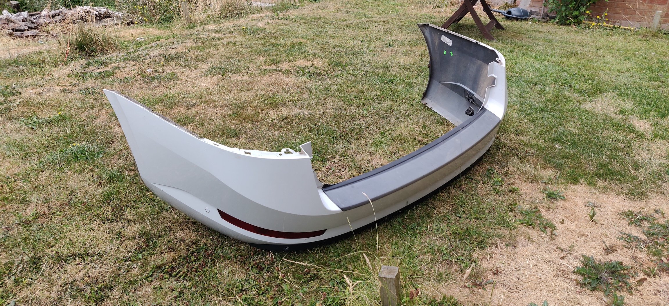

Factory fitted electric towbar is not releasing after a long time not using

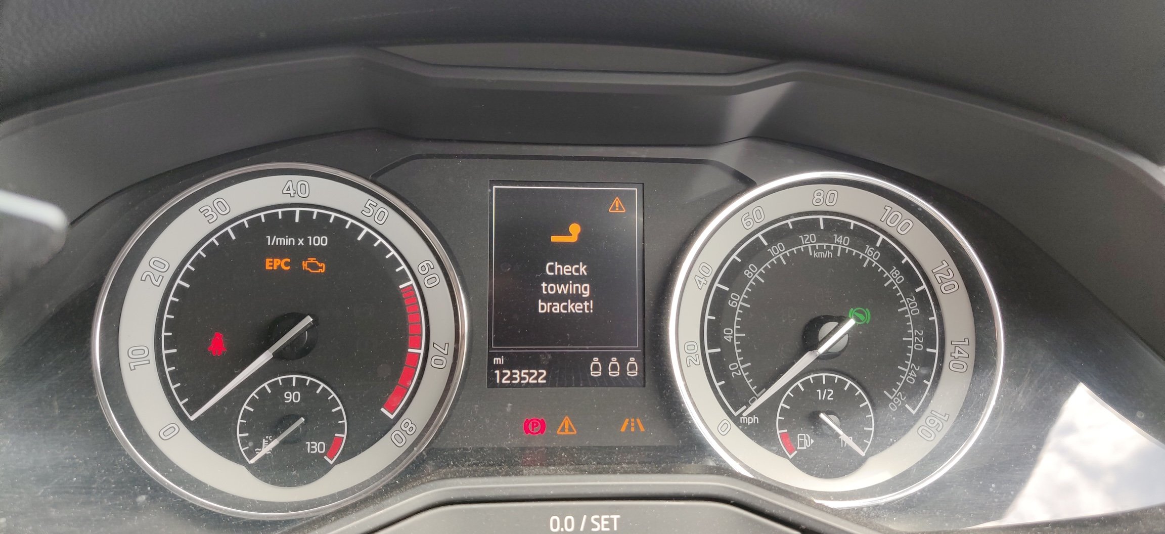

Oh yes, in my case I resorted to removing the rear bumper and not-so-gentle whacks with a dead blow hammer downwards which started getting it free. Any hammer bar a lump hammer would probably do it. You'd only need to do this if really unlucky I reckon. I used PlusGas which probably is akin to mentioned ATF and diesel mix, something to start fizzing through whatever is getting it stuck initially. My particular car has quite legendary amounts of rust, bit with a lot of other order cars I deal with, PlusGas has been very useful. Mine still firms up though so will probably be applying grease and wiggling it every few days until its a lot smoother, but I can at least get my hand in there and pull it down now if its not falling by itself, whereas before it wasn't moving at all.

So spent the weekend sorting a service. Oil change, haldex and brake fluid. Normally the air filter would be sorted as well but that was done earlier via the R600. Only the cabin filter left, which I forgot to order so will sort that out once its arrived. I did encounter a snag once I started test driving though: Now, this car has one of those fancy towing hooks where you pull a lever type thing in the boot and I guess in real life it then can be pulled out. But it's always been stuck, and up until now, the light on that lever was always green when the lever was returned. This time it was flashing red. Not sure why, maybe I bumped it loose in the gap in the bumper or something? Given its a Sunday with nothing else particular planned, decided to just see if there was anything I can do: So off with the bumper. It was only at this stage that I thought "oh probably should have took more pics", but hey ho! There's some plastic covers that need a hook type tool to pull off to access some bolts for the rear lights. Those can then be undone and the rear lights removed. This reveals some plastic tabs that the bumper hooks onto. I'm wondering whether the rear lights probably need removing at all, as it only makes that step easier to undo those tabs. The main screws are about 6 along the bottom of the bumper, and three in the wheel arch with two going through the rear mudflaps, and one above it. There is also a screw on each side tucked behind the wheel arch at the top of the front of the rear bumper. This is one of those where maybe a Youtube video search would be easier than lots of pics. Once disconnected the rear parking sensors: I'm presented with the towing bar front and centre, in all its rusty glory. To be honest, not terrible compared to the other horrors seen over the years. So essentially, I just improvised from this point. I pulled the lever in the boot a few times to gauge if anything with the cables were at fault, but everything seemed to be ok, based on feeling around the cables for movement. So I went and took some plusgas and started spraying it at bits that look like moving parts. In the pic above, you can just about see in the centre the main gubbins, and that appears to have a rotating element. Essentially, I then took a dead blow hammer and just started to whack the towing ball bit a few times, upwards and then downwards. After then stopping for a drink and a break to let the plus gas soak in a bit more, a few more taps started to make the towing ball move ever so slightly. So eventually, it started to not only move a few more millimetres, but I was able to then start wiggling. I think I managed to unseize it: So a random unexpected victory, and the light on the lever goes green. I then proceed to use the lever and move in the closed and open position, and seeing where it was rotating. Tried to wipe off as much of the plus gas as possible and just went to town with white lithium grease: So this is what it look likes now, as I forgot to take closeups with the bumper off. So yeah: Reverse steps to get the bumper back on, and the towing gubbins are now available! I guess I'll give it a wiggle every now and then and spray some grease wherever I can. I reckon in retrospect one could probably try this without removing the bumper, although it makes whacking the towing ball downwards a little difficult, which is what made the difference. I've bought VW 504/507 in bulk a few months back in anticipation of price rises, with it also being compatible with the other cars I look after, so I won't add that into the cost, roughly £85 per 20l. However, the Haldex oil was £23.99 for a litre (I ended up using about 650ml), £6.99 for some washers for the drain and fill plugs, and £8.16 for o-rings for the pump, as I also removed it and gave it a clean, but I think you can probably get away with doing that every 4 years than 2 years. The brake fluid was £9.42 for a litre. I also added some 6mm spacers for the rear wheels to match the 6mm on front, so that was £22.99. Oh, the wife also wanted tinted windows, so a lady came over and added those to the rear doors and windscreen, which came to £115 as part of doing my brother-in-law's car. He was doing the reverse, removing tints from rear doors! Maintenance: £3444.04 (+£71.55) Upgrades: £5496.47 (+£137.99) Miscellaneous: £827.47

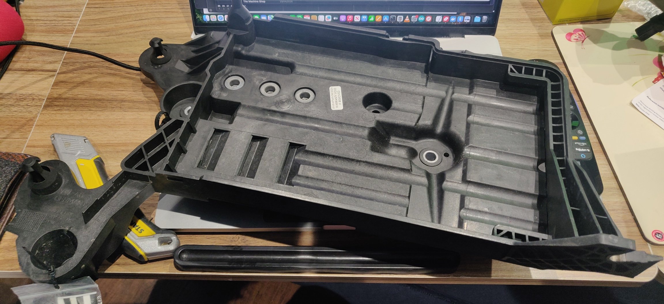

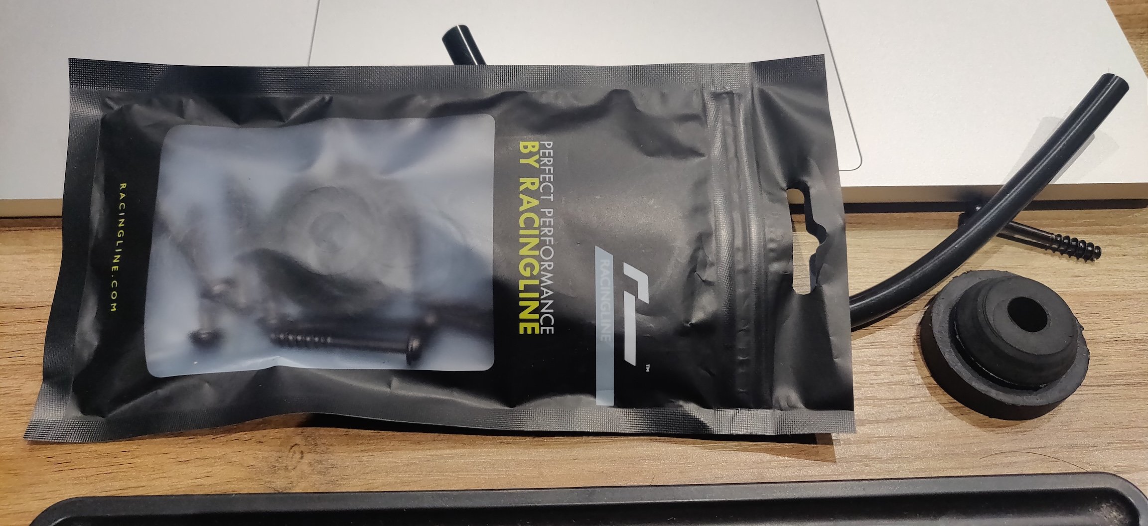

Woke up early (mainly because I'm getting old) and given the weather wasn't too bad, got cracking on: So removed the R600 pretty much, in order to get the rubber grommets installed: Didn't know the orientation but some thinking and a double check on a Youtube video confirmed it. The video also mentioned that hole in the middle might be related to the OEM's drain tube bit, so decided to also transfer that over. Then it was the battery tray. None of it turned out to be as much of a faff as I thought it would be. So negative then positive terminals off, then wiggled the cover off, and then the 13mm bolt for the strap keeping the battery down. Then pull the battery to the front and hoist it off: Then got a metal trim clip tool to pry the harness off of the tray, two bits along the front: Then it's a 10mm nut at the rear: Then three 10mm bolts, two in the tray, and one off to the front right, which needs a tiny bit more dexterity or longer extensions due to the wiring in the way: Once all out, the old tray can be wiggled and eventually come free: The nut on the rear has a weird rubber bit that sticks out, I guess some random additional vibration dampening, nothing more wiggling wouldn't sort out. Took the opportunity to give the area a wipe and spray of XCP, whilst the area was easy to get to. Then it's the reverse to wiggle the new tray in: Had to use some force and wiggling to get the bolt holes to align up, but got there eventually. The three bolts and nuts were tightened to 9Nm as per the workshop manual. Hoisted the battery in, pushed it back so it slides under a lip on the rear of the battery tray, before putting the bracket and bolt in, to 15Nm: Slide the battery cover over and on, then greased the battery terminals, and tightened to 6Nm: That's that, the whirring and buzzing of the car coming back to life should be audible. So now its the R600 intake again: Like last time, some wiggling to get it into place, but this time, pushing it into the plastic bits on the replacement battery tray. Should go in without much bother and won't be going anywhere. The filter is then on, clamp tightened up, and the new screws that came with the replacement grommets are used to tighten the top cover down: Gave it a spritz of rubber and vinyl care and wiped down. I'll probably do an oil change in the next couple of weeks, but that's not really post worthy. Fingers crossed, the front subframe is the next big job and that'll be nearer the end of summer. Maintenance: £3372.49 Upgrades: £5358.48 Miscellaneous: £827.47

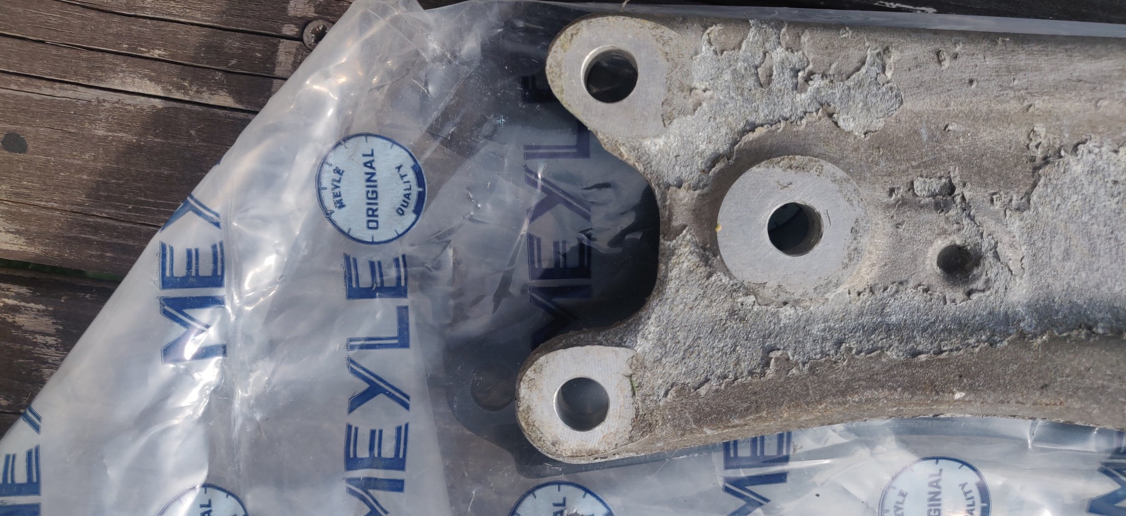

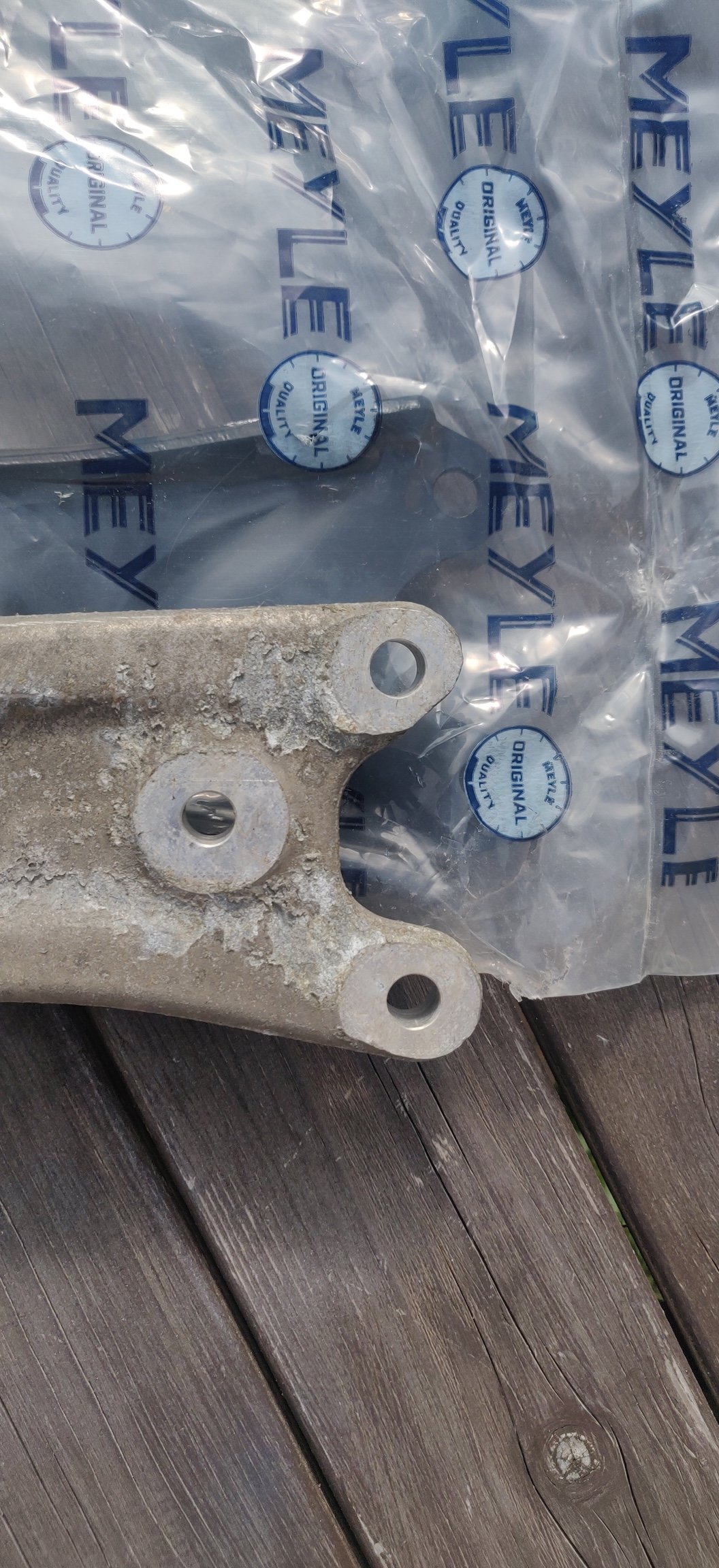

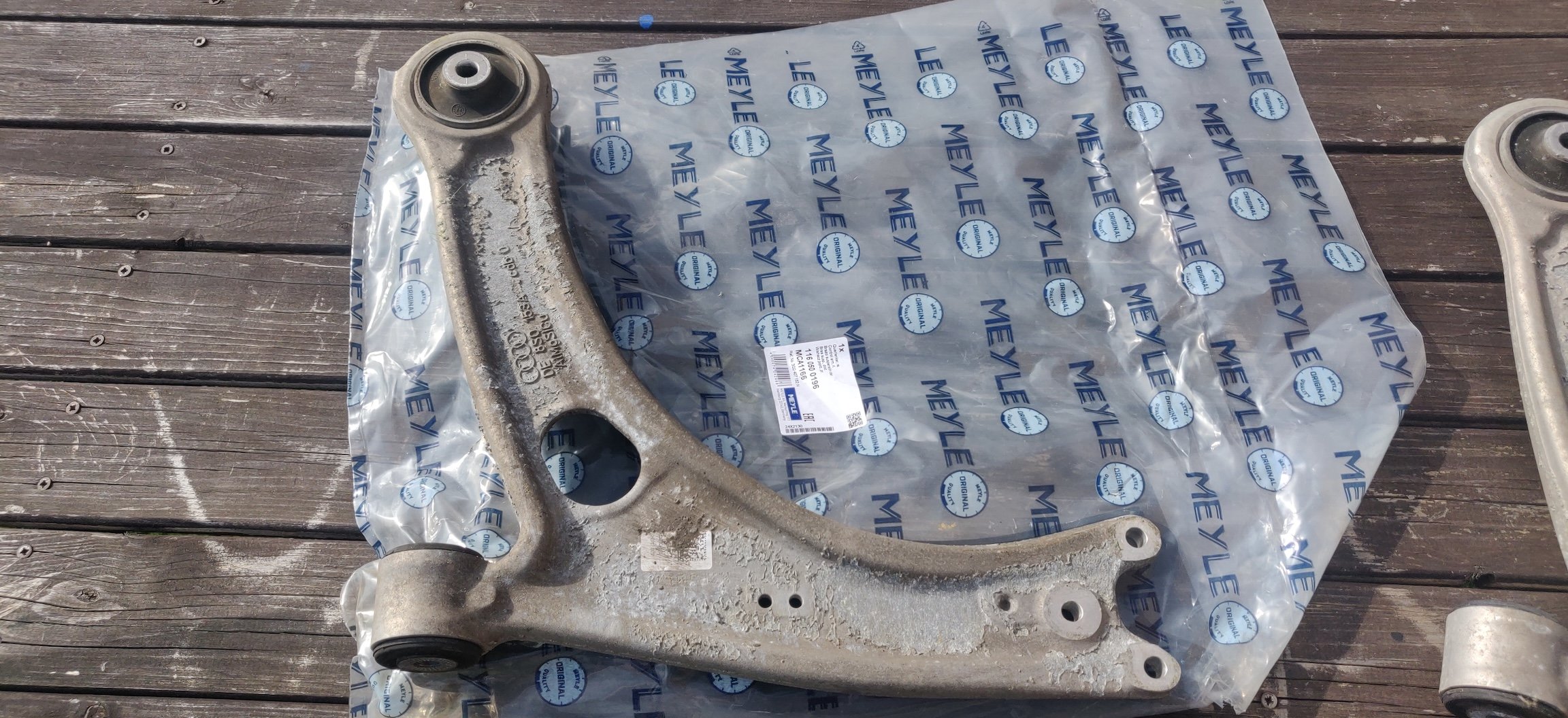

Reason I've been reluctant with aluminium lower arms: Above is a pic of the aluminium arms that came with the subframe, and some Meyle replacement arms: They essentially look about a centimetre short? Hence not wanting to bother, as almost all aluminium arms of some sort are for the S3 or Golf and such, so probably a narrower track? Happy to be corrected if Passat/Arteon/Superb variants exist. Regardless, the Meyle arms were from eBay, bought about a year ago for £69.54. Now for something different. From the R600 install, went online to look for replacement missing bits, and found them: The part number turns out to be VWR120004, and was from Progressive Parts for £20.35 with delivery. If I knew the part number, could have probably shopped around I guess. However, this was ordered on Thursday evening, so for it to arrive Saturday morning isn't too bad to be honest! What was a real surprise was: The battery tray! This was ordered from eBay in the same Thursday evening, with some shopping around and a discount coupon getting it to £16.96. Arrived around mid afternoon, very impressed all round! Technically not the cheapest on eBay, but honestly, it looks brand new, or is certainly VERY clean! Wife actually has the car for the weekend, so can't do anything until she's back. I suspect a fiddly job of disconnecting and wiggling wiring harnesses and whatnot to replace this tray and the subsequent fettling of the R600 bits to get the rubber grommets on and all sorted. Maintenance: £3372.49 (+£86.50) Upgrades: £5358.48 (+£20.35) Miscellaneous: £827.47

So, after work, took the opportunity to do something that's been on the back burner for ages: I think it's the first engine performance mod! A RacingLine R600 air intake! Alongside other bits such as: Turbo inlet pipe, and additional bits like a replacement pipe to go underneath the new air box bit. These bits were bought absolutely ages ago, circa March 2024, and have been lying around since. The R600 main bits were £502.93. The turbo inlet pipe was £74.99 and the coolant pipe was £42.94. So the first step is to start removing the original air filter box and inlet. Two screws, and the front should wiggle away: Then used a flat head screwdriver to loosen and pop out the vacuum line from the air box: Then my Knipex pliers to get the clamp off of the air intake pipe: Once the pipe is loosed from the air intake box, the air filter box itself can be removed, as its some rubber grommets over plastic bits: Popped out with effort, and unfortunately: Looks like I got too hamfisted and ripped out one of the plastic bits with the rubber! Guess a new battery tray required... So those bits out so far: Next is to replace the coolant hose with the replacement designed to go under the R600 box. Lots of Youtube videos show coolant going everywhere, and to be honest, I did the same. Got towels and whatnot underneath and just removed and replaced as quick as possible: Got messy so no pics for the other side. Wiped excess and some parts cleaner before the next bit. So dry fitted the bottom part of the R600 box: Just some wiggling really, but noticed the instructions mention attaching rubber grommets to the box before installing them: Sadly, the packaging didn't have any! Plus with the broken plastic bit in the battery tray, kinda stuck for now. I expect rattling until this is sorted I guess. So carrying on, time to remove the air intake from the filter to the turbo inlet pipe: Standard hose clamp, so a 7mm to loosen, and then wiggling to free that pipe: So next is the turbo inlet pipe. There's a hose that needs to be removed, via squeezing and popping it off. Then also a T30 torx bit keeping the pipe in place. Once removed (carefully lest that torx bolt drops into the abyss!), initial attempts to pull the pipe off wasn't fruitful. Turns out it needs some rotating before it pops out: The new one is the reverse. I put a light smear of engine oil on the o-rings that the new RacingLine pipe had, then pushed in and rotated into place: Then carefully put that torx bolt back into place. I tightened it to 12Nm as its an M6 bolt, not sure what the actual figure needed is. On the home straight now. The R600 kit came with a new pipe, so slotted that in alongside the filter itself: Just some wiggling but it eventually all aligns up. Orientation of the pipes and stuff was probably made simple by just looking for the RacingLine logo and making sure that points upwards! Not forgetting the vacuum line: That's pretty much it, on with the top cover: Tighten up all the hoses and bits and that's that: Noticed also that the R600 box didn't have any screws, so decided for now to just take a few from the OEM air filter box and attached them to the R600 box. Will need to source rubber grommets for the R600 box and screws if available. The spoils: So will need to find somewhere for these OEM bits to go, but that's that! Haven't really driven it in anger yet, I'd imagine there probably won't be any major difference really. Am hoping this becomes useful once a remap is involved! Bit annoying that some of the bits were missing, but some Googling has shown replacements are available, so I'll order those, and probably a battery tray as well, so technically some of this will need disassembling once those have arrived. Maintenance: £3285.99 Upgrades: £5338.13 (+£620.86) Miscellaneous: £827.47

A valid question, and unfortunately, could be the case! I'll be doing an oil change on the thing in the near future, and I think whilst I'm down there, I'll try and see if it looks like it'll fit. It had the original lower control arms on there, and they didn't look wonky. Aluminium ones as well, but they're a bit shorter than the ones for the Superb, so will have to use steel ones. Worse case scenario would be the current subframe goes back on I guess...
