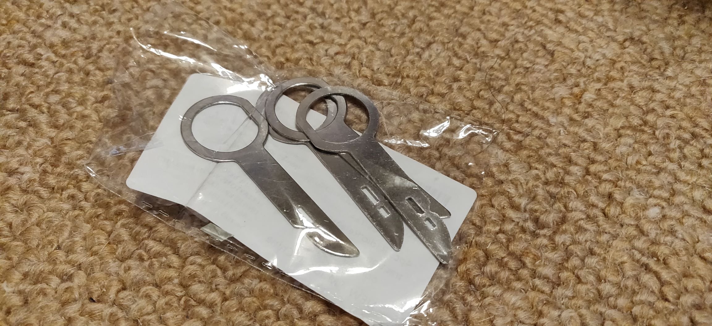

Note that you can get the head unit upgraded to the later model (2017) larger screen, that's certainly an upgrade that I've enjoyed on mine (see my build log for more info).
Yup, intend to replace anything oily, DSG and Haldex etc.
I've actually started eBay surfing regarding the MIB 2.5 and 9.2 inch screen as that'll then lead to the Virtual Cockpit and so on!

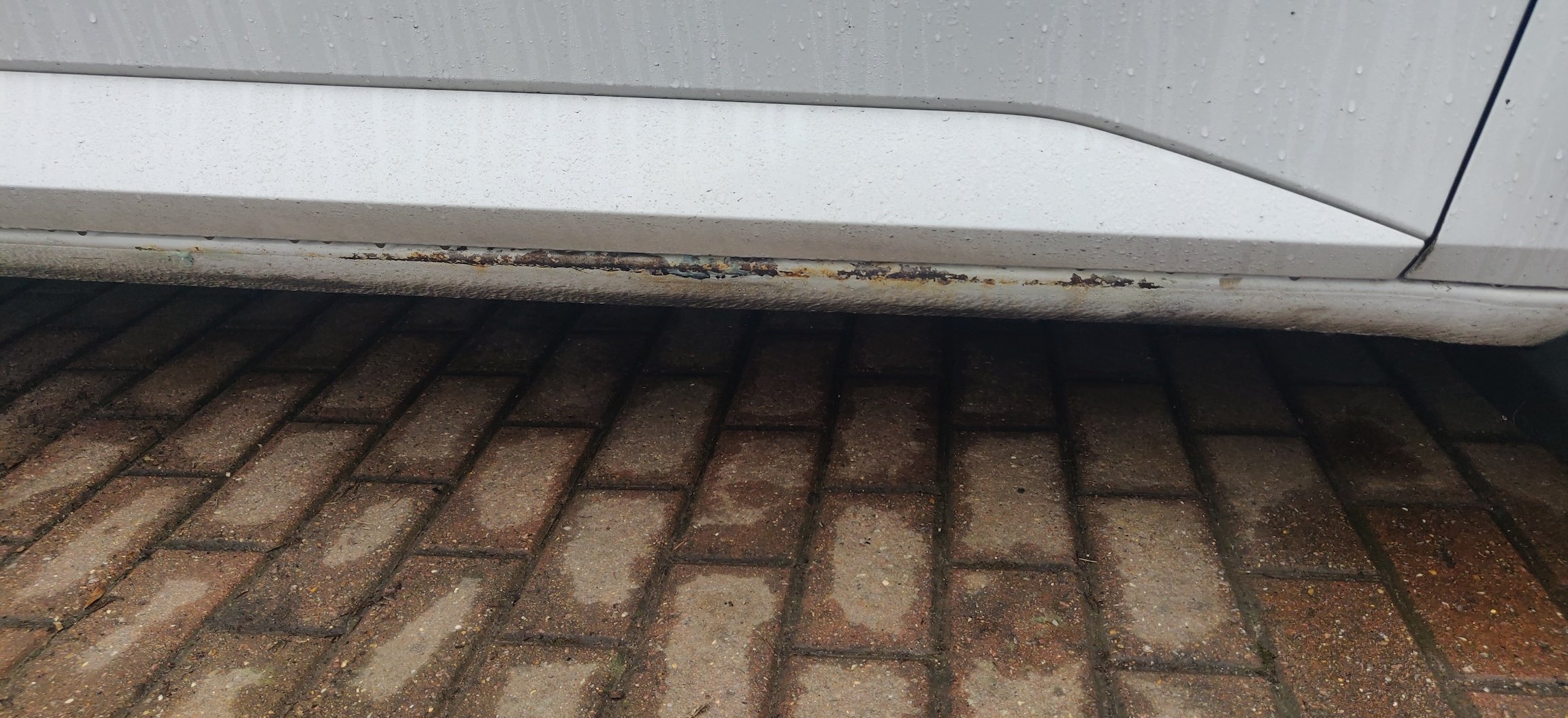

There is a strange amount of rust along the sills of the car, I'll remain optimistic that this surface stuff and due to its life spent around Aberdeenshire.

Some rust appeared along the sills after a prolonged encounter with a snow drift. I did treat it with rust inhibitor and repaint it, but maybe it’s come back. Definitely just surface rust though. A bit poor for a modern car!

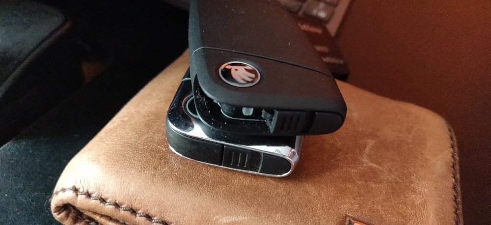

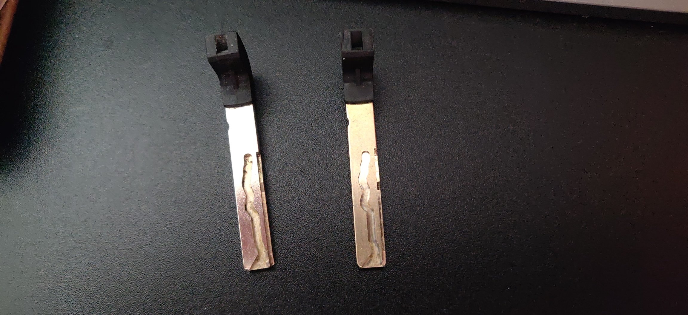

I've noticed this:

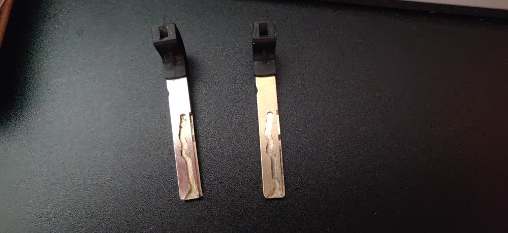

So missing one of those emergency key bits in the spare fob. @nicknorman if this lying around anywhere (also, the umbrella...) then DM me and I'll see if I can sort out postage costs?
In the meanwhile, took some photos and sent it to a guy on eBay:
Will it work? Probably not, I imagine its quite difficult to cut keys based on a few photos, but it fits in the fob and it'll do for now. £12.50

Unfortunately I got a bit eager with the pressure washer:
Existing rust probably loosened the paint so even more has lifted off. I think it at least tells me its all surface rust. I've dabbled a layer of corrosion block grease which I use for the Lotus, whilst I probably plan to just give a quick blow over with some rattle cans once the weather gets better, and before I take it to a proper body shop.

Regarding the key fob I have virtually never used that key, it has always sat in a box in the living room. Just checked it, no emergency key there. I am fairly sure it wasn't there when I got the car. On the other hand, in 7 years and 102,000 miles I never had to use the emergency key. Also I am fairly sure that you get 3 keys with an L&K, I certainly did with the new one. But when I got that car at 6 months old they definitely only gave me 2 keys.
Umbrella - I kept it for the other side as you only get one with a new car. Tough!

As to the paintwork, that is quite annoying because I spent hours sanding, treating with rust converter, spraying primer, spraying the base coat and spraying the top coat. Looks like I shouldn't have bothered! I guess the rust converter was rubbish. But yes it is just surface rust and it all appeared suddenly after i had driven through a snowdrift.
Personally I never use a pressure washer on the car, I always just used a hose and a soft brush thing with soap dispenser. IMO pressure washers are not good for the moving gubbins as it can get water into bearings etc. I never used snow foam either, but interestingly in conversation with the manager at the showroom where I bought the new car, he volunteered that I should not use snow foam because it is very alkali and makes the chrome bits around the doors corrode, which is not covered by warranty.
I found myself forced to use the pressure washer as my normal hose gun had a split (probably some overnight freezing temperatures and water left in the hose), so didn't have anything to wash with otherwise! Rest of the car is fine though, but I'll be gentler next time.
Had a similar experience with a Tesla at less than 3 years old where the sill paint flaked off leaving primer underneath, so that was amusing. Not sure why I didn't learn my lesson.

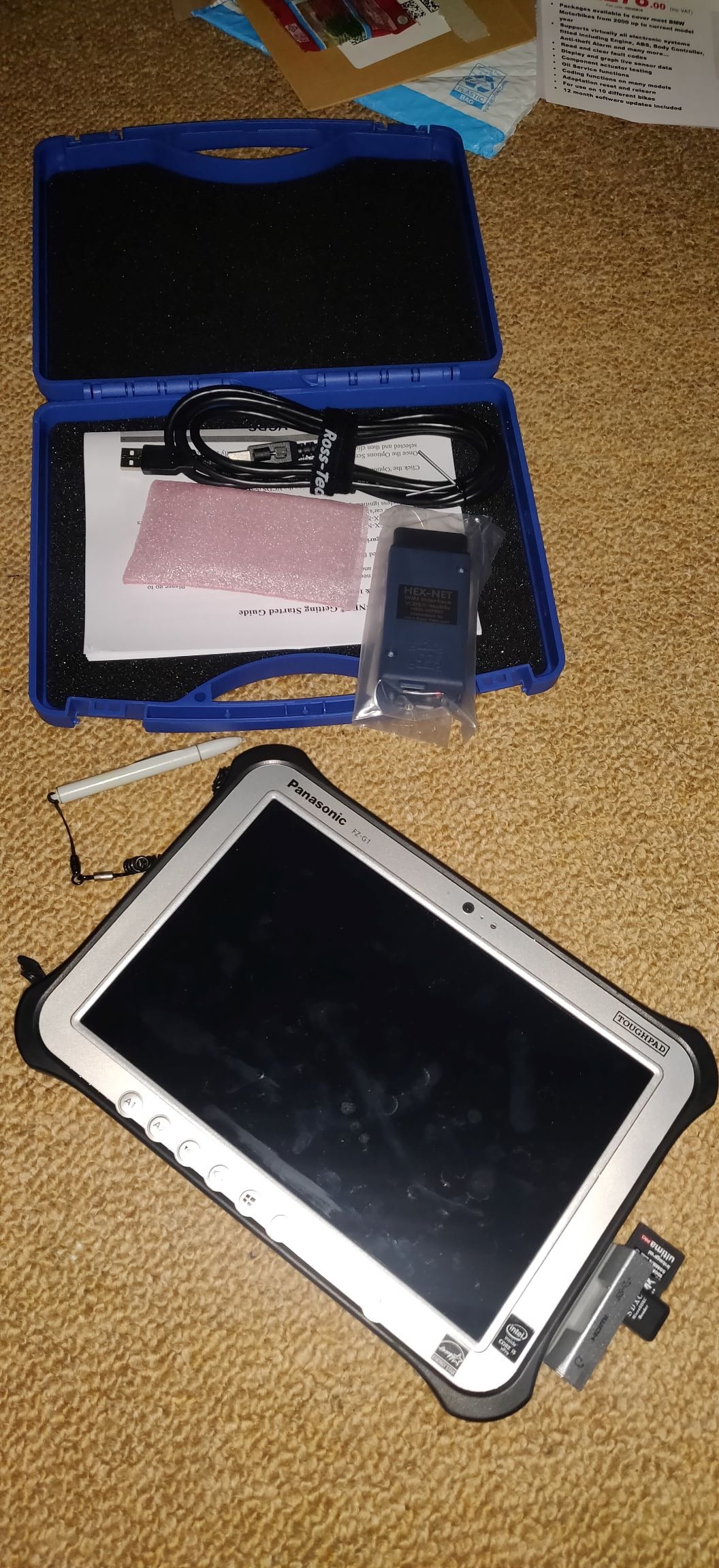

So these arrived today:
A second hand Panasonic Toughbook (£154.95) from eBay something rugged that probably makes sense when underneath a car (and especially as my previous Surface Pro has a smashed display).
I probably a clone of an older Hex+Can somewhere, but I reckon the amount of hassle and effort to get that working probably outweighs the outset for a proper one. In for a penny...
Decided to go with the wifi and bluetooth capable Hex Net from Gendan (£430.00) so that the USB cable isn't needed, could be more convenient, as I imagine situations where I may need to bleed an ABS pump and just take the laptop with me as go around the car, etc. Either that or it stops me from tripping over the cable like an idiot.
It's the 10 VIN example, and I suppose if I get to a point where I can charge people for its use, then I could upgrade to unlimited and put them all in as business expenses.
I'll probably spend a bit of this evening but most likely the weekend running through it and probably getting a massive list of codes or whatever the correct nomenclature is before I start doing something more potentially destructive.

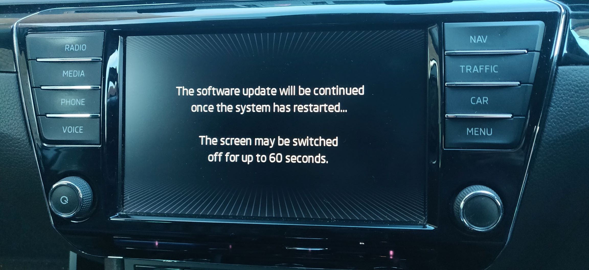

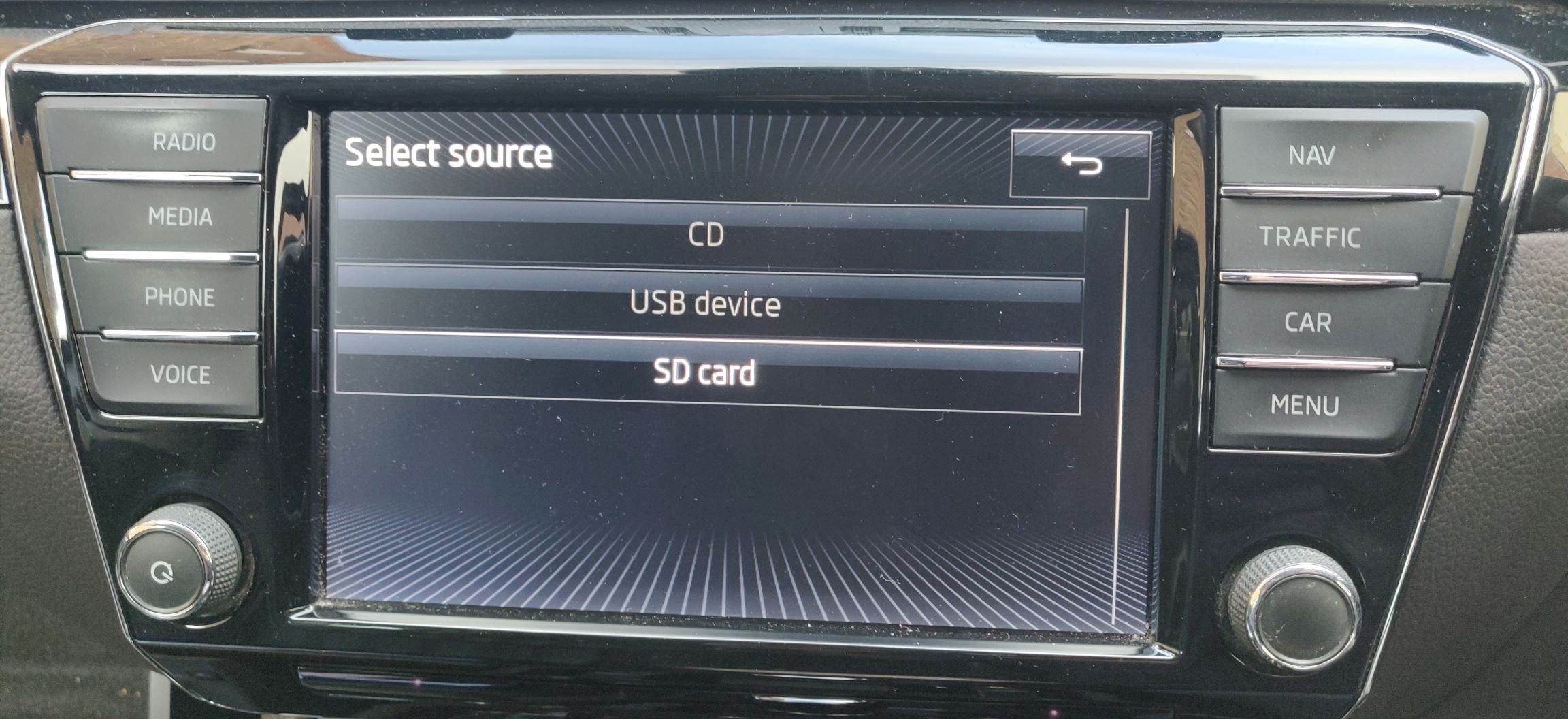

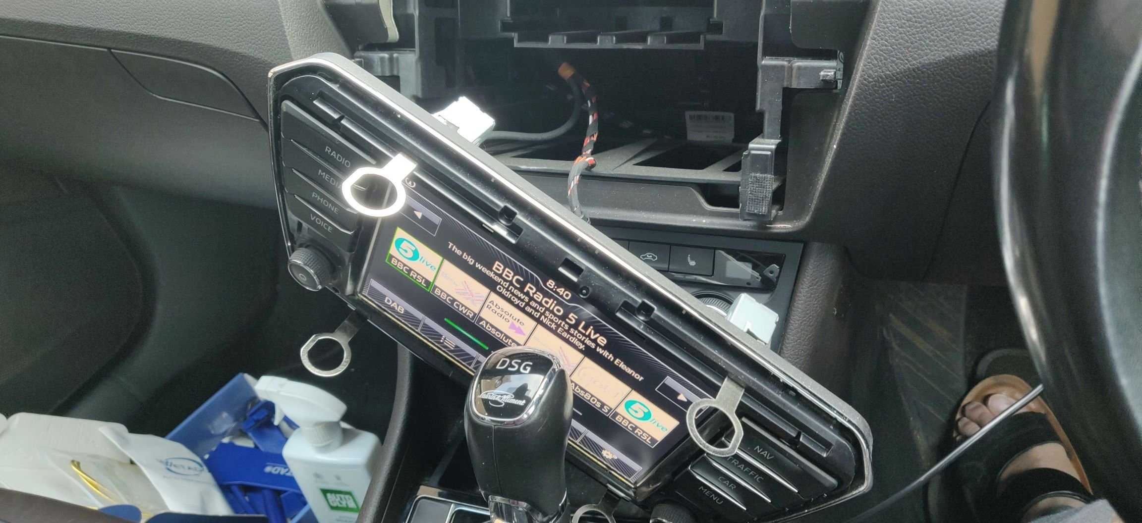

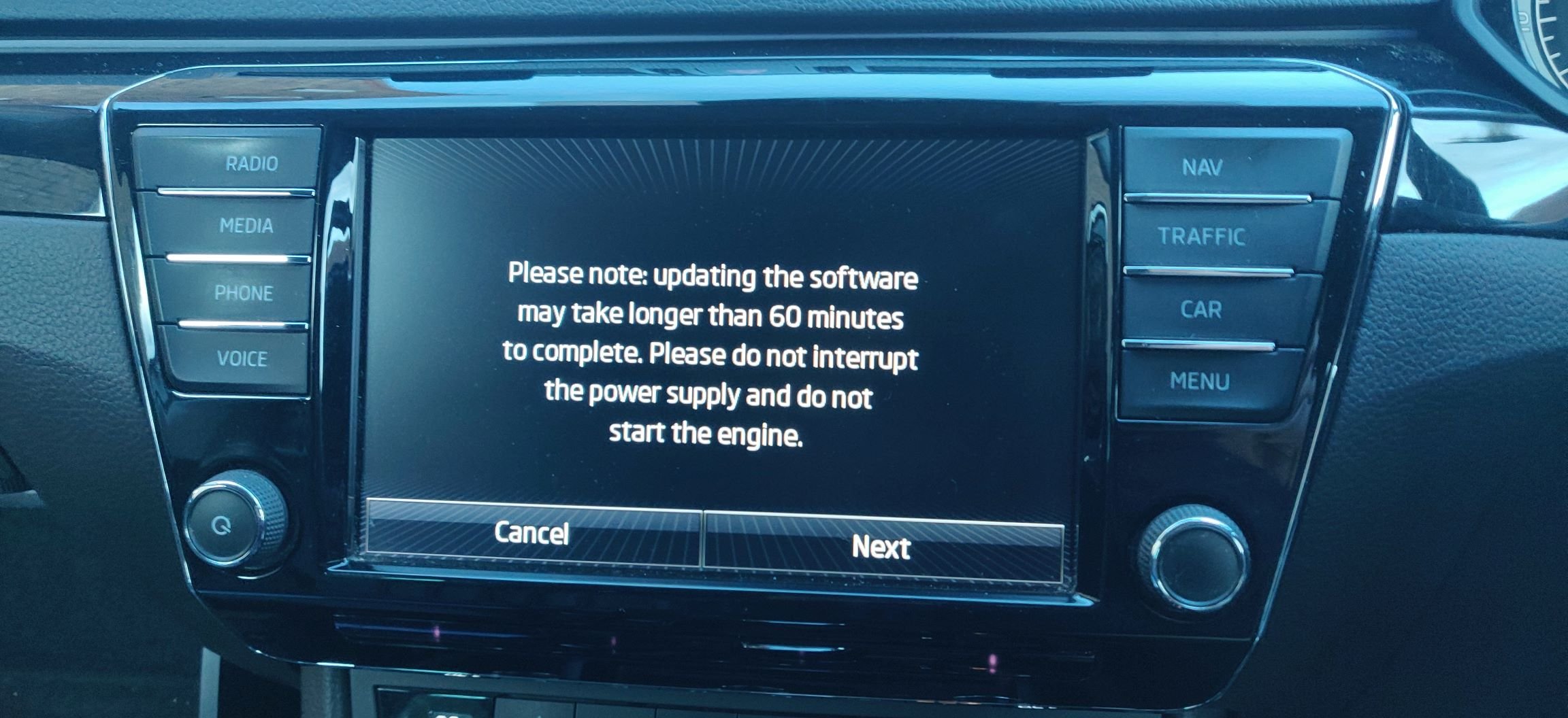

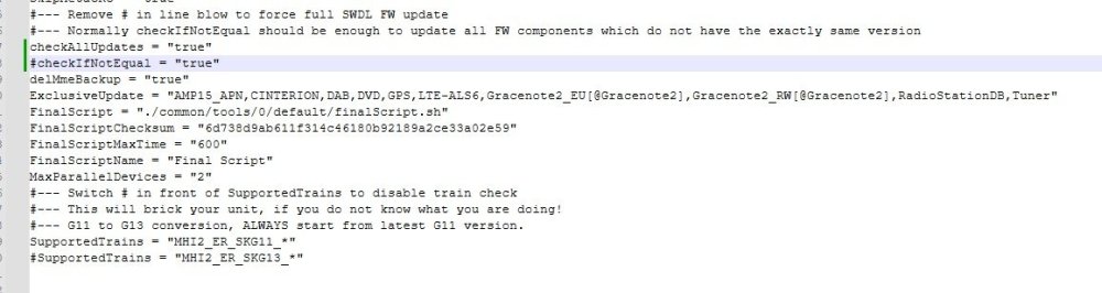

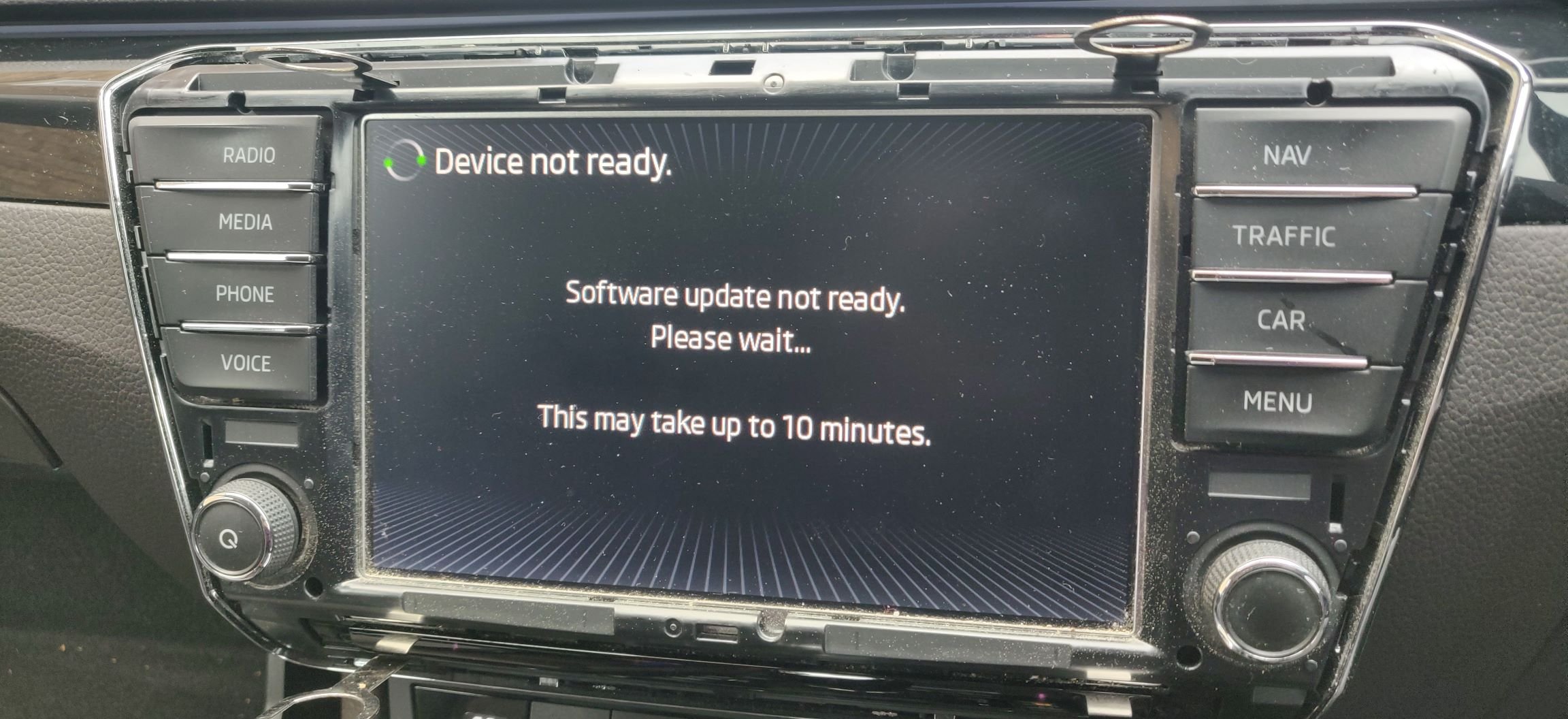

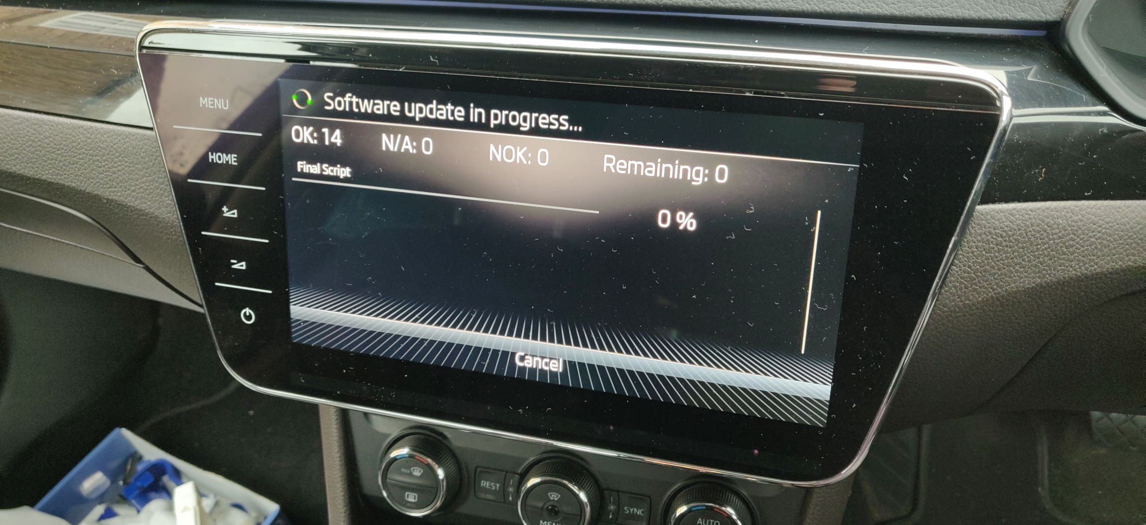

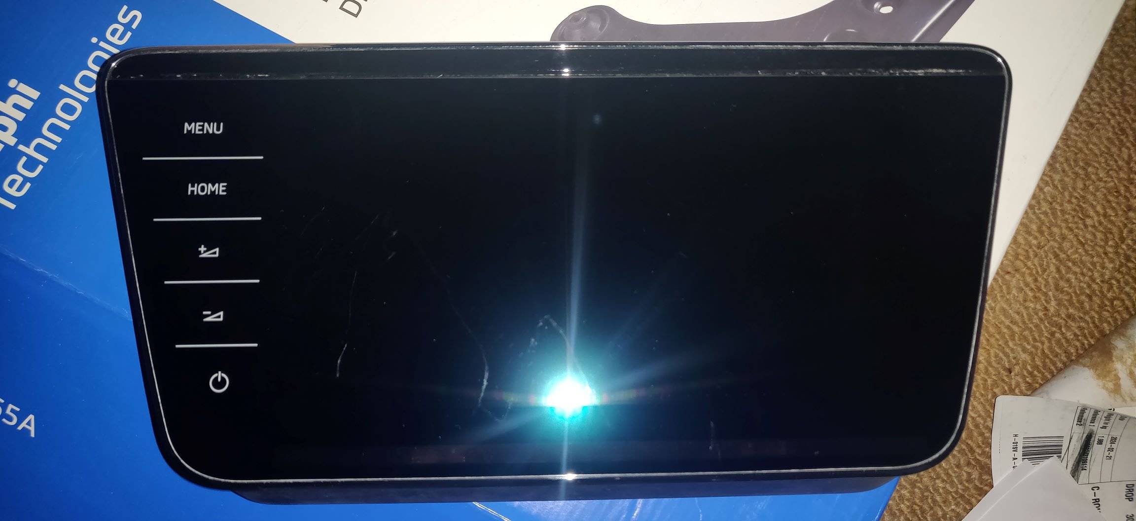

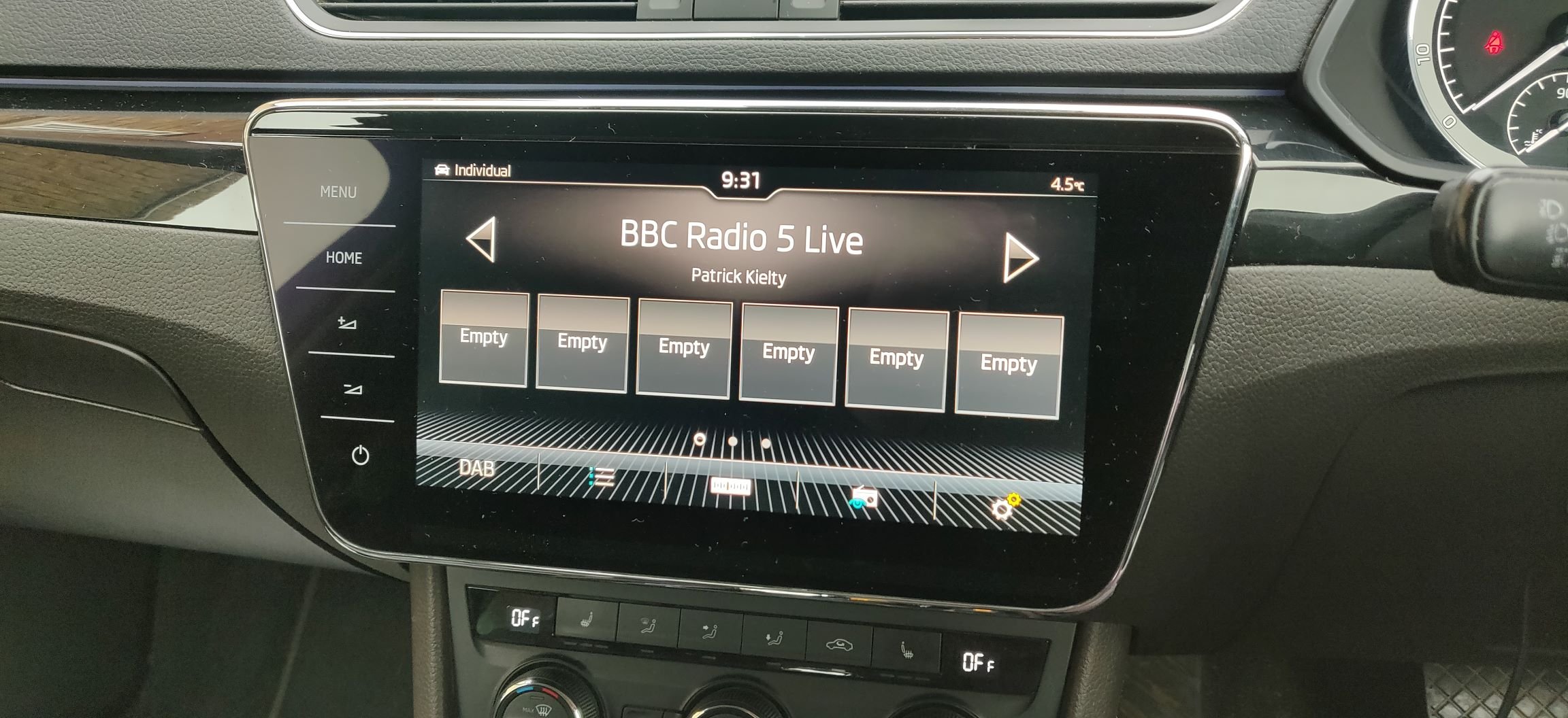

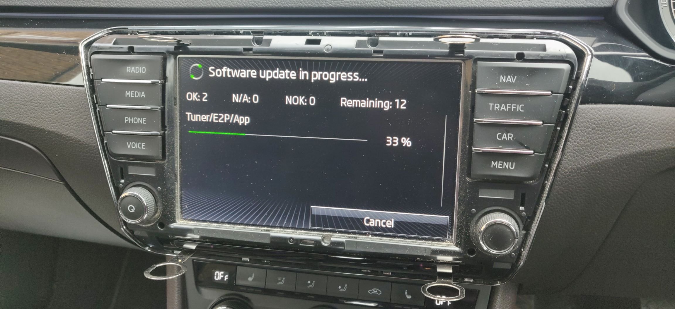

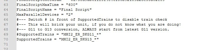

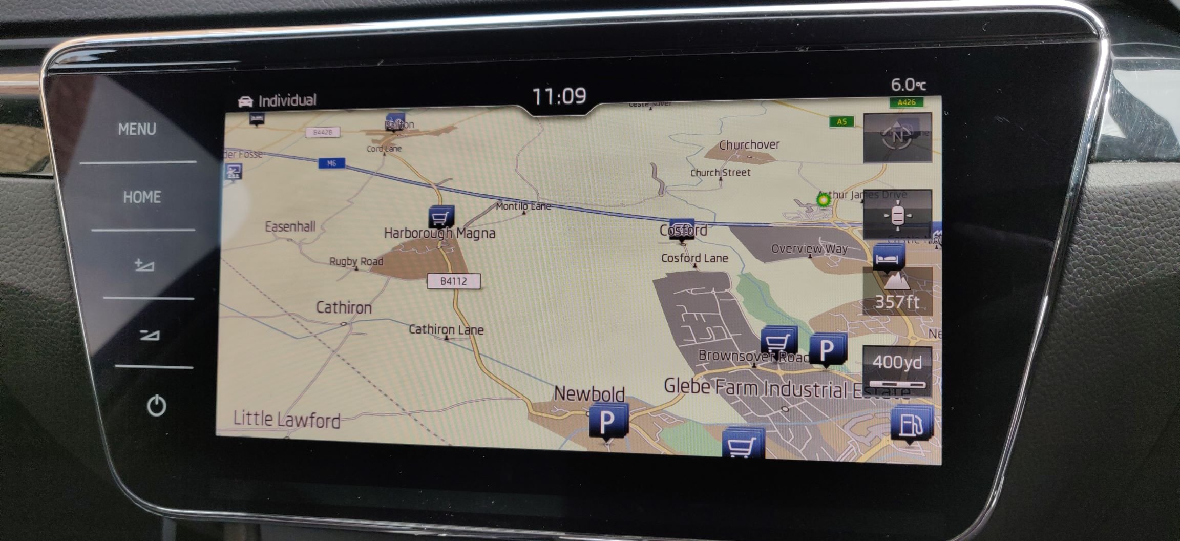

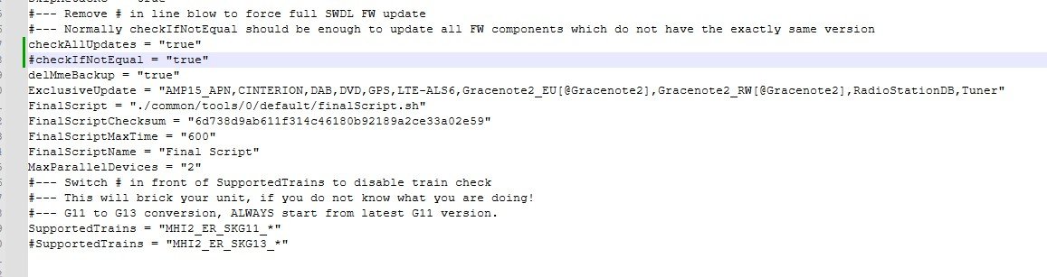

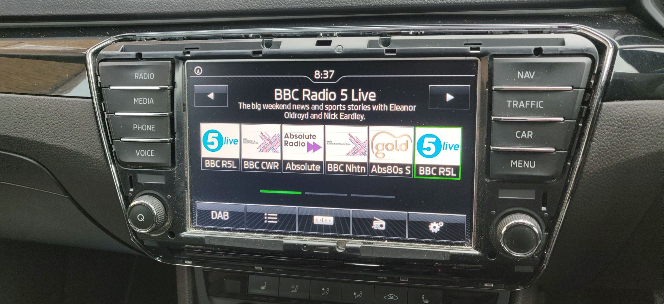

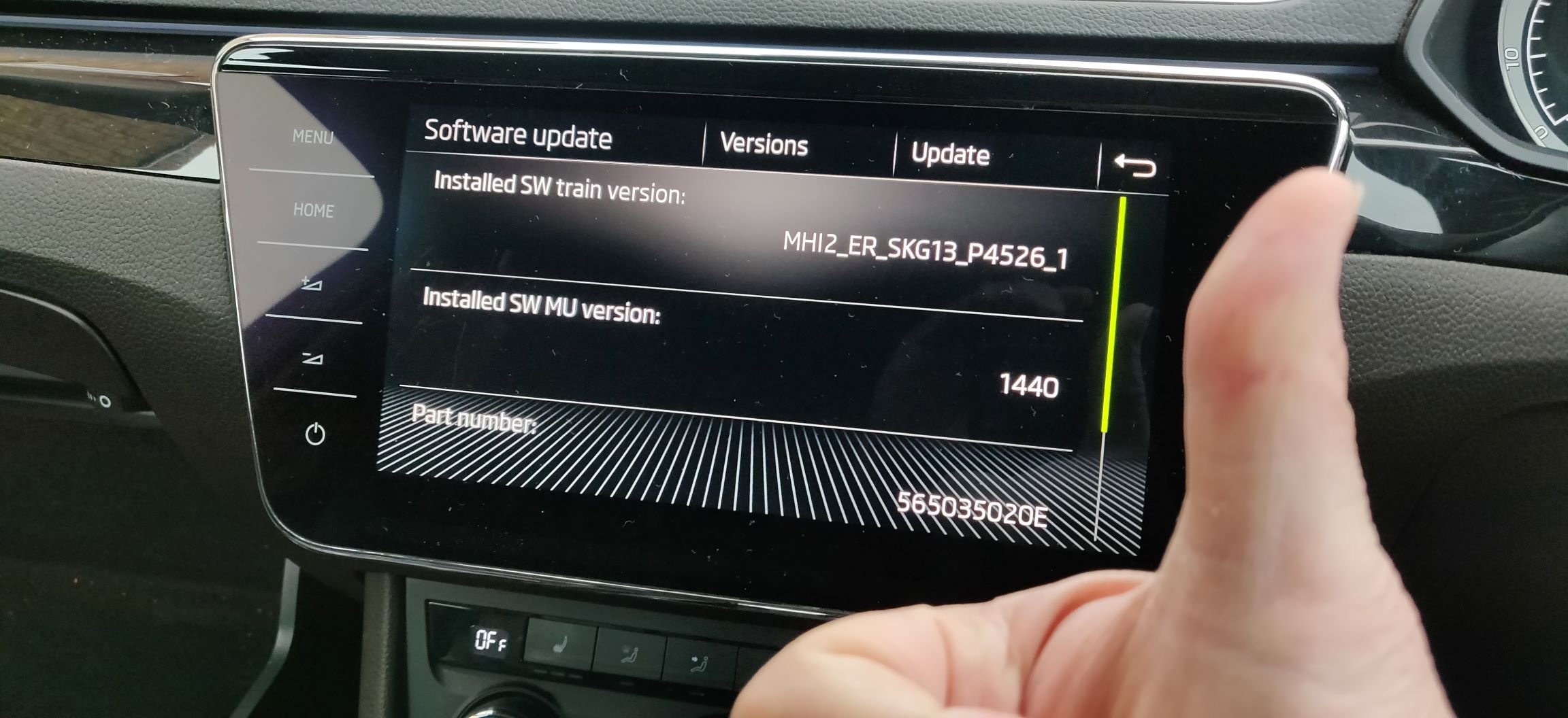

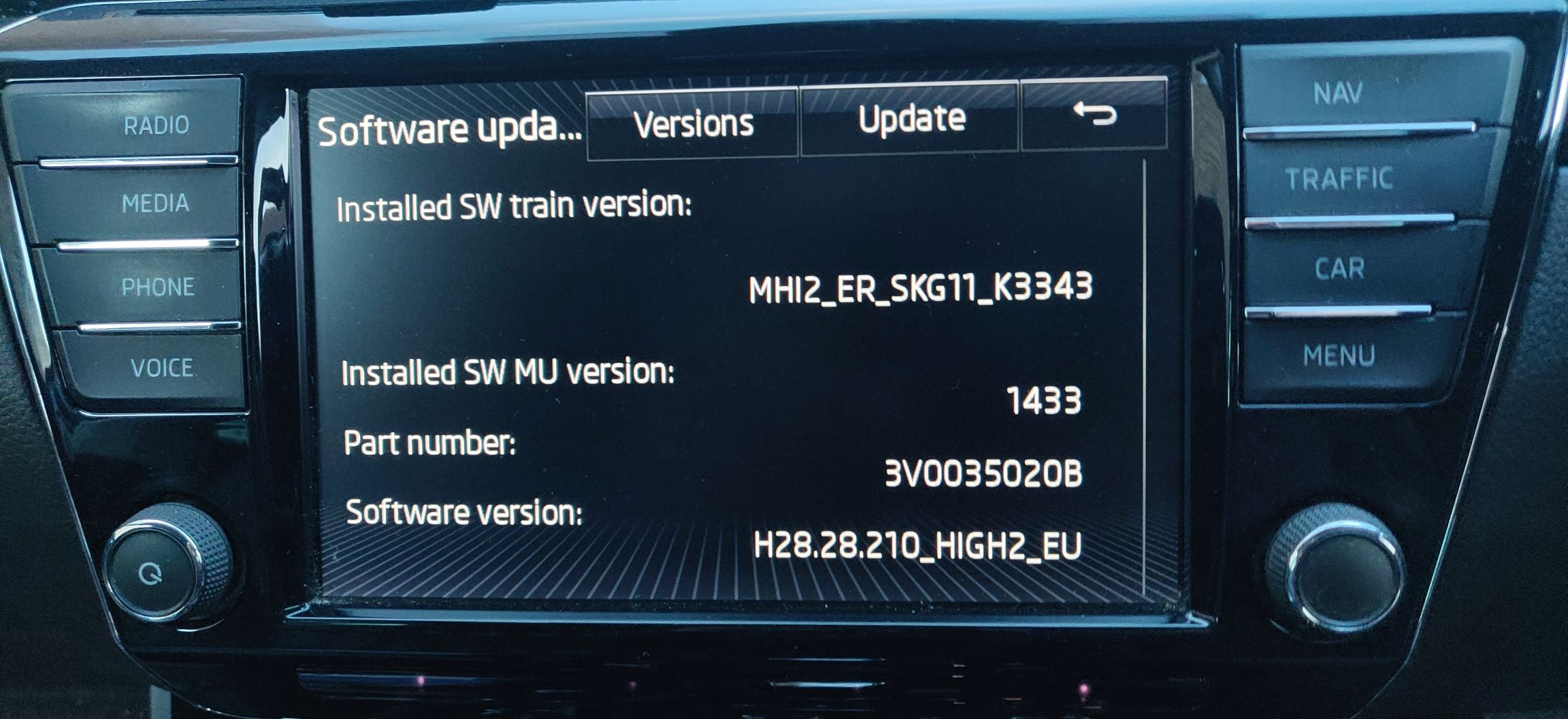

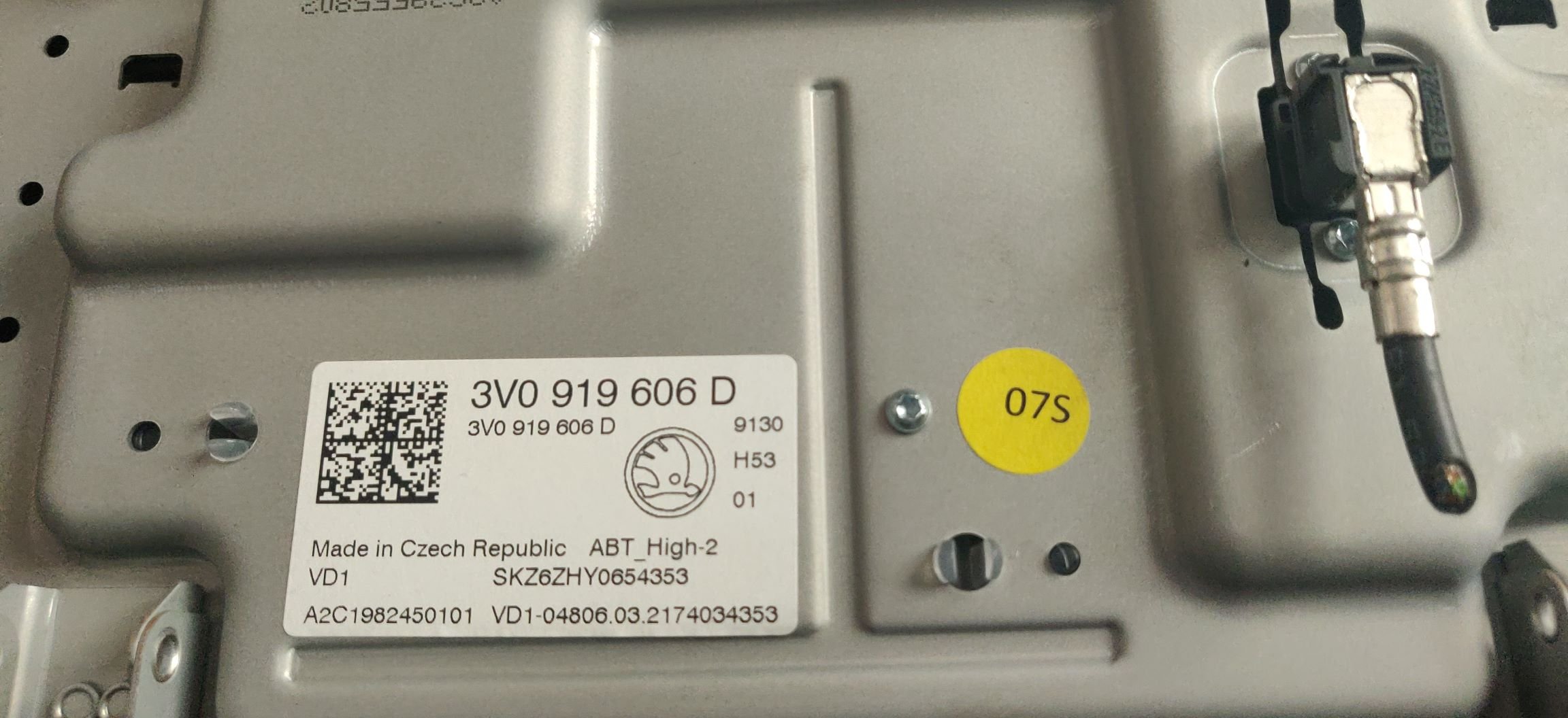

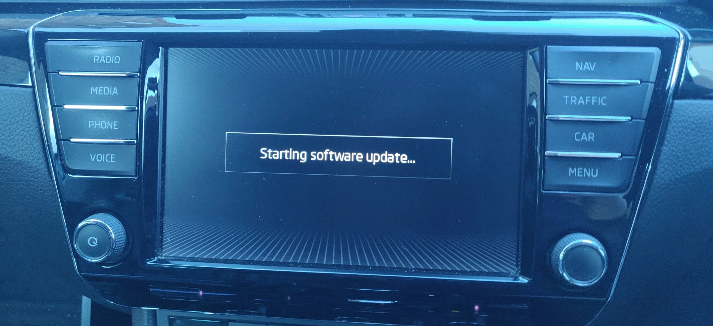

As has been inferred in earlier posts, it looks like it is possible to upgrade an MIB 2 setup to a MIB 2.5, and after reading, re-reading, and re-reading again, I've decided to set this weekend out to give this a go:
https://github.com/harman-f/MHI2_MIB2_AIO_FW_Update_Template/wiki/G11-to-G13-conversion
So this "All-In-One" firmware apparently has the ability to convert what it describes as G11 (MIB 2) to G13 (MIB 2.5).
There's probably all manner of pitfalls that I'm naive to. The absolute worse case scenario that I can foresee is that I brick the head unit completely, at which I can then cry to @pab567 whilst throwing money his way either to fix it or replace.
Best case scenario though, is that the only requirement is a replacement display. I don't know if the display has Component Protection, or if its just a display for the head unit and nothing more.
One of the first things the above page outlines is to update to the latest G11 FW 1st!

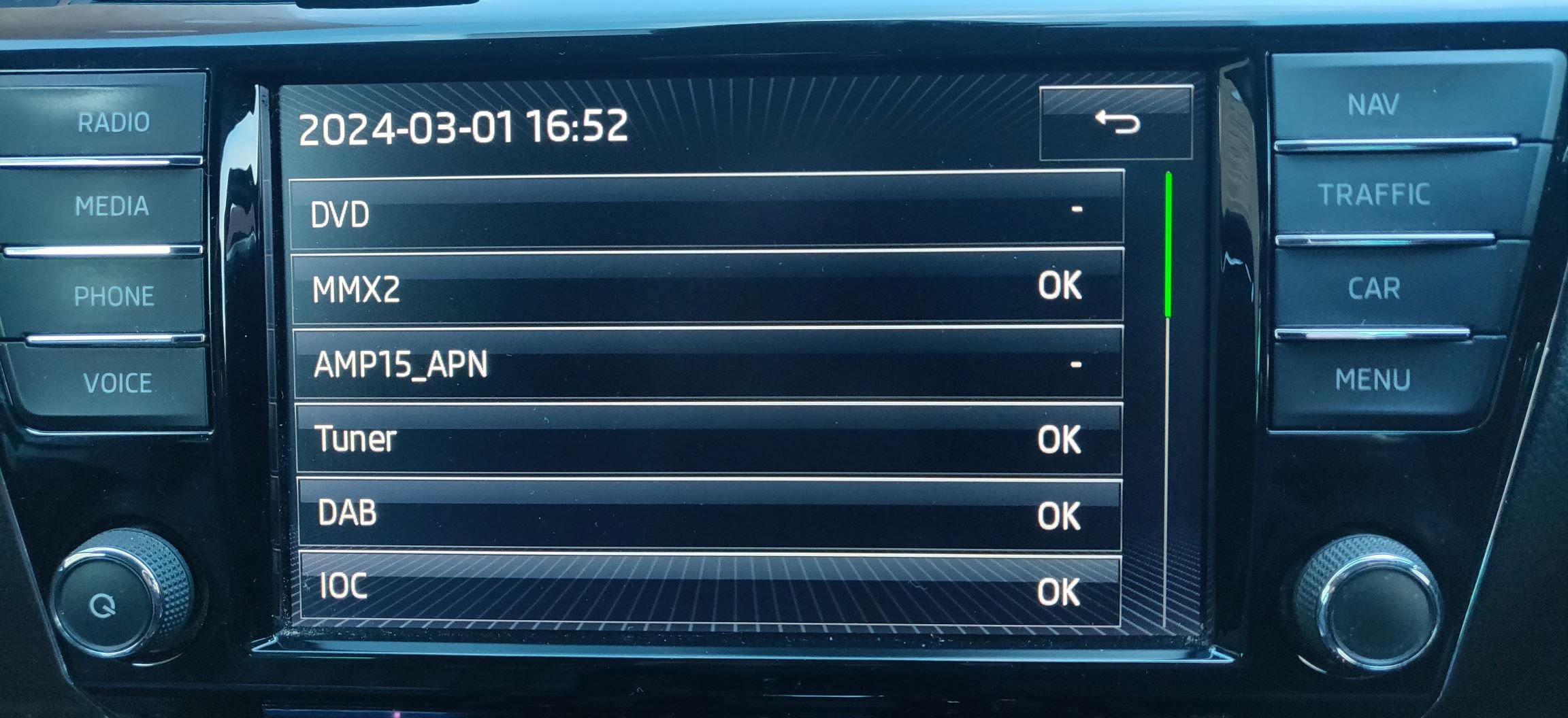

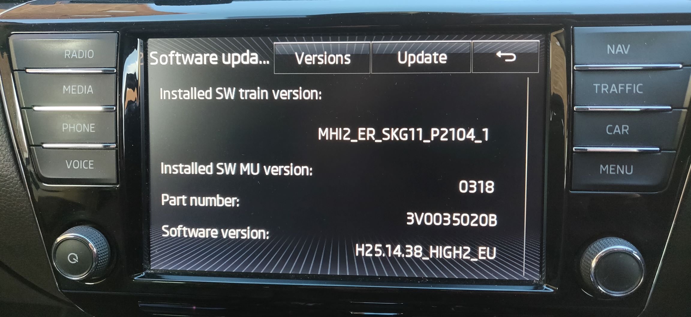

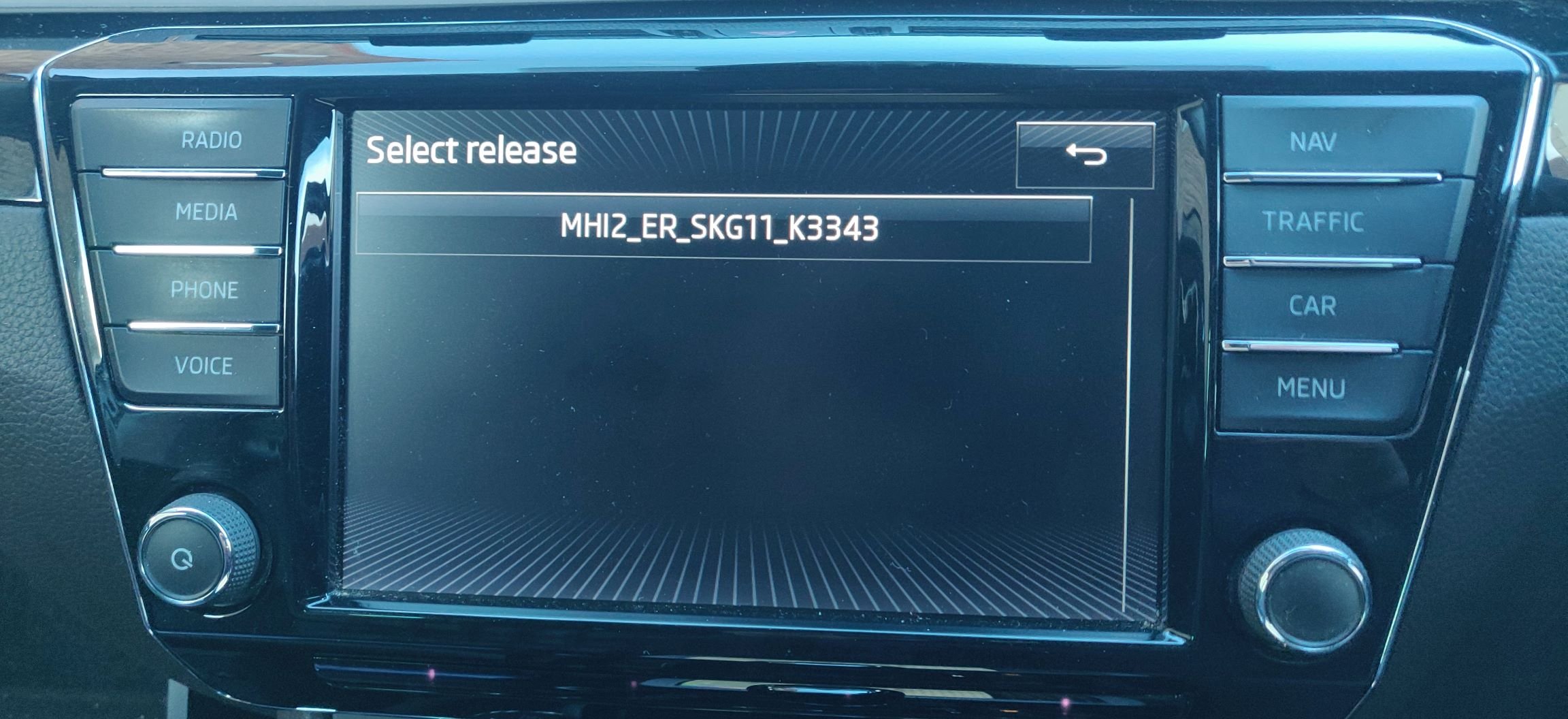

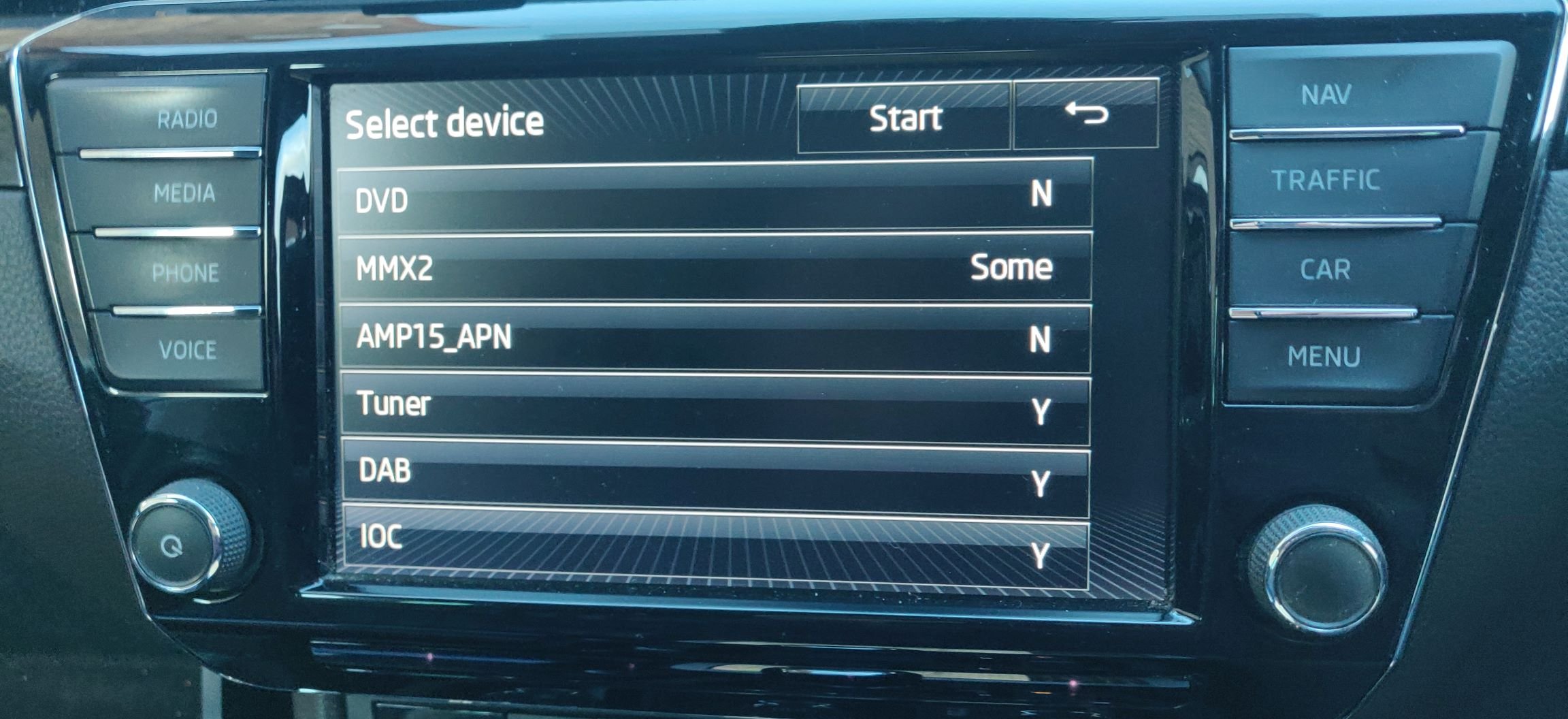

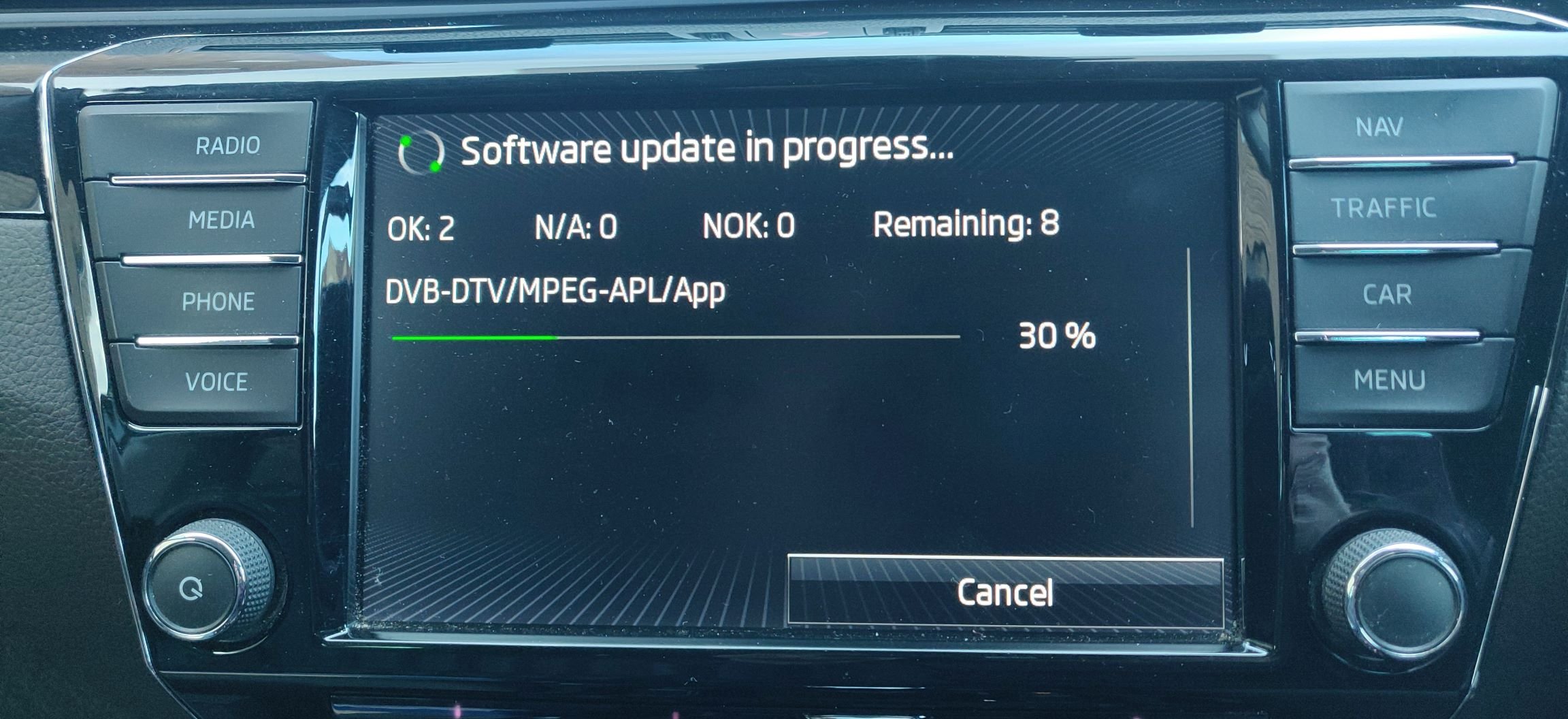

So, holding down the menu button on the display and some menu rummaging reveals:
The currently installed "train" is MHI2_ER_SKG11_P2104_1 and the logs suggest some previous updates in the past.
There's a neat website, https://mib-helper.com/ which can take this "train" and provide a bit more information.
So here's an excerpt from the above site:
Quote
1. Firmware details:
Generation and tier: MIB2 High
Region: Europe & Rest of the World
Brand: Skoda
Version: 8-inch display
Trade Name: Skoda Columbus
Firmware version: P2104 (MU: 0318)
Firmware type: Production
Hardware vendor: Harman or Aisin (target market dependent)
2. Latest available firmware updates:
Latest official firmware update: MHI2_ER_SKG11_K3343 (MU: 1433, details).
Latest possible firmware update: MHI2_ER_SKG11_K3343 (MU: 1433, details).

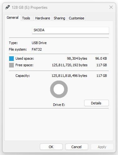

All the guides and advice around the internet suggests a FAT32 full size SD card, which is a bit annoying as I have mountains of microSD cards, with their respective adapters.
With firmware and updates though, probably best not too much with fire, although having said that, I still acquired a 128GB full fat SD card (£10.99 from Amazon), which made the additional requirement of FAT32 need a few more hoops.
Normally, Windows gets a bit awkward with sizes greater than 32GB and will use exFAT by default. Internet suggests several tools for the purpose, but Rufus https://rufus.ie/en/ appeared successful.
Rufus appears to do a quick format, so only a few moments and it looks good:

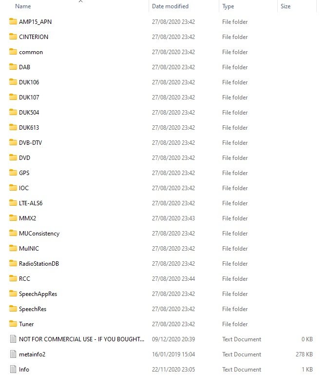

It's then a case of copying over the contents of MHI2_ER_SKG11_K3343_MU1433.7z over to the SD card. I would suggest to download the 7zip app via https://www.7-zip.org/ as its much faster than Windows' 7zip archive handling.
So the SD card should look something like:
That should be it for this stage of the process. So pop the SD card over to the car, stick the ignition on, wait for the system to boot up and pop the SD card in.
Before I forget, as per firmware updates on anything, always a good idea to keep things plugged in:
I have a few of these because owning several cars means that a few will be dormant at a time, and it's always good to keep things topped up. I don't know if firmware update processes can happen with an engine running, but that's a possible alternative.
So, I think because this is a normal firmware update, it should be a case of accessing the menu via holding the button again, and finding the option to update:
Then with any luck, it'll scour the SD card and find it:
Confirm things and then wait.
Hopefully, it reboots a few times:
Then everything should be as per normal. Returning back to that menu and double checking:
The update should be complete!
I will now need to mentally prepare myself for the big update. This arrived yesterday:
With the G11 to G13 conversion page outlining only 9.2" screens work and for Superbs, it is 3V0 919 606 D:
So hopefully all present all correct. £315 from eBay. Noticed some scratches on the screen, but I'm hopelessly optimistic that it'll not be visible when the display is on.
Also acquired some removal tools, (£3.49 from Amazon):

So the first order of business was to take the 128GB SD Card I used for the previous update and gave it a quick format with Rufus, followed by copying over the G13 AIO firmware.
The contents contains instructions to perform the G11 to G13 conversion, so I followed them to the letter, changing properties on the metainfo2 file from:
To:
So a couple of flags to disable version checking and what "train" the update supports. I note that for the Skoda ones, it has a wildcard MHI_ER_SKG11_* so I suppose anyone with a bit more bravery could try it with any version of the G11 "train", but I wouldn't recommend that at all.
It also mentions in the website guide to rename the _Swdlautorun.txt file to remove the underscore prefix, which should then mean the card insertion is enough to kick start the update process.
So a few deep breaths...

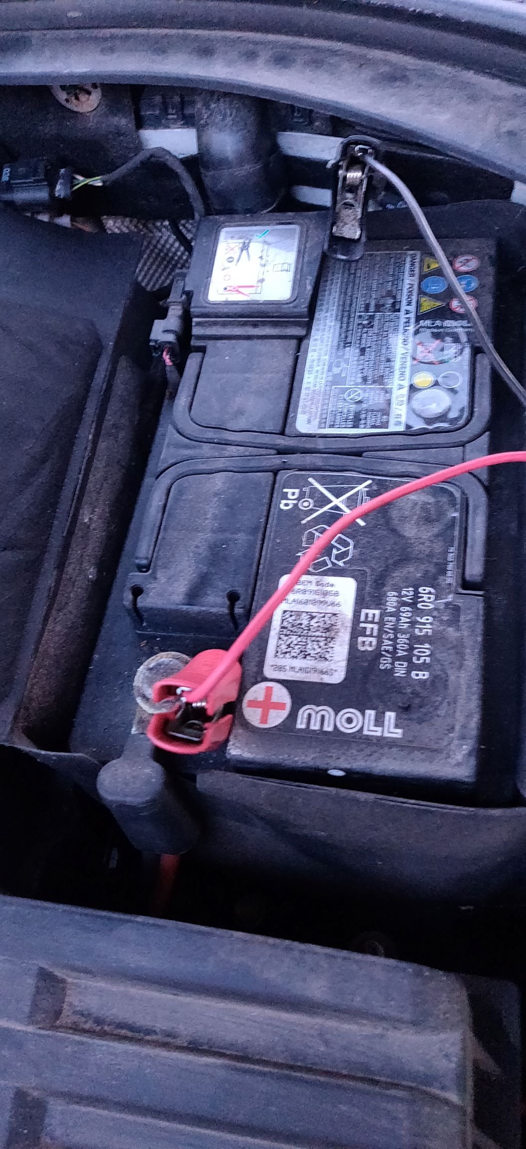

But before that, made sure the battery charger is in place and keeping the battery topped up (it was left on overnight, so I think it'll be good).

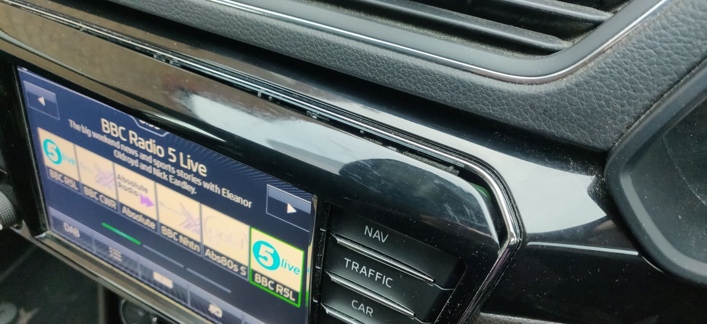

Firstly, for this particular display, remove the trim around the display:
I used fingers at first to get some purchase then a standard trim removal tool to slide around the rest, and it pops out:
This reveals the slots for the insertion of the keys, so inserting the keys and with a bit of wiggling in my case, it should come free:
I left the display hanging slightly, so that once the update reboots and then expects the newer screen, I can then swap them over with just the two cables to change.

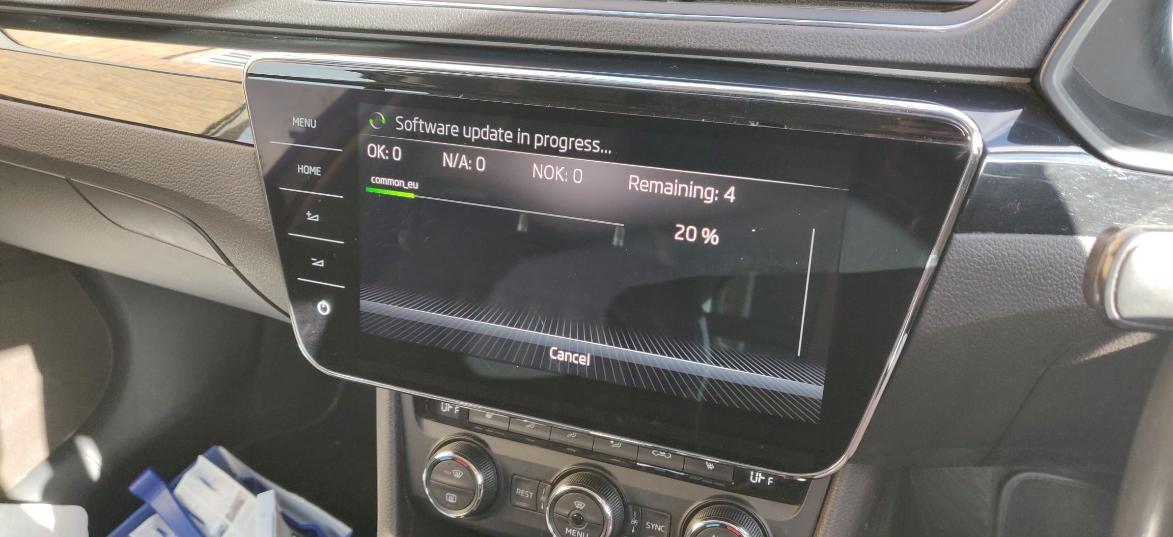

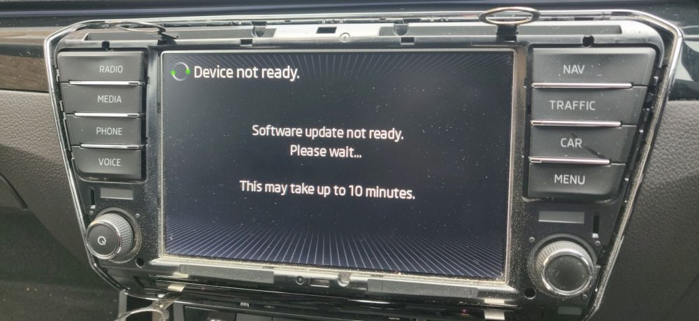

I few more deep breaths, and the SD card is now inserted into the head unit, with the display immediately detecting the card and showing the same messages as yesterday with the normal firmware update procedure:
These photos are almost the same as yesterday:

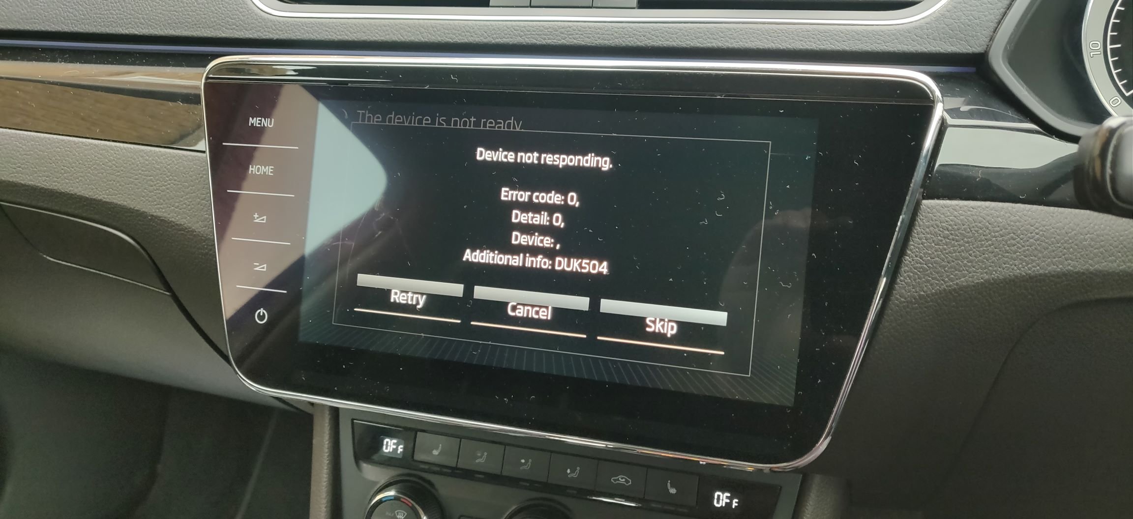

However, once it rebooted, the display remained black, but I could hear what presumably was the head unit fan (or at least some fan around the glovebox), so decided this was the moment that the head unit was now only going to work with the new display.
So pull the old display out enough to get my fingers onto the connectors, and luckily they all came out without much drama. Inserting the connectors into the new display then revealed:
Did a little first bump as the display is on and working!
I then got a warning message, one which the guide explicitly mentions:
It stresses to just press skip, as cancelling could be a disaster! So once skipped, it pretty much finished:
Checking the version by holding down the home button:
Success!
It took pretty much the same time as yesterdays firmware update, so around 35-40 minutes.
Next step is to reinstall the maps, which I've decided to do with the SD card reformatted again, but this time to exFAT just to feed my curiosity.
The install process is then the same as a standard firmware update, going via the service menu to search for updates:
The install for this took longer primarily because of the huge size of the maps I presume. Took the opportunity to give the car a quick once over with a vacuum. It will need a few more goes by the looks of it, but it is what it is.
After a few more restarts:
Maps are on.
I also added POIs via another update, this time, via a microSD card with an adapter. This also worked, so the general advice of using a good normal sized SD card is more a wise precaution, if for whatever reason you don't want to spend the £8 or so for one.

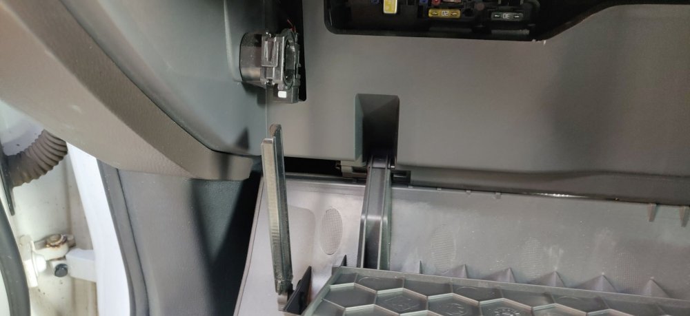

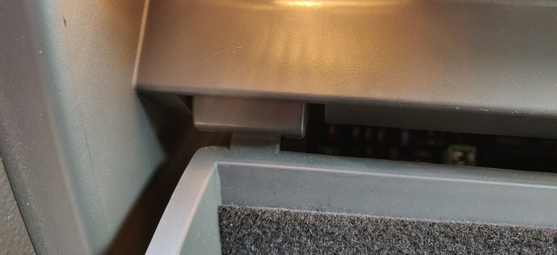

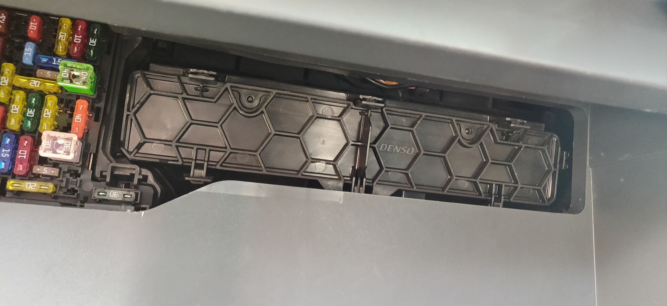

Decided before I fire this off, to remove the cabin filter. I'll be replacing it as part of the complete service overhaul that I'll be doing, and given the car isn't going anyway, I surmised it'll be fine to leave it out. Don't want this thing essentially being trapped by the cabin filter.
Fairly typical job, where the glovebox needs removing, or at least here, just dropping down. There's a couple of rubber buffers:
Which fantastically just need pushing up on each side and the glovebox starts coming free. I'm easily impressed maybe?
The glovebox catch then comes away with a tiny bit of effort:

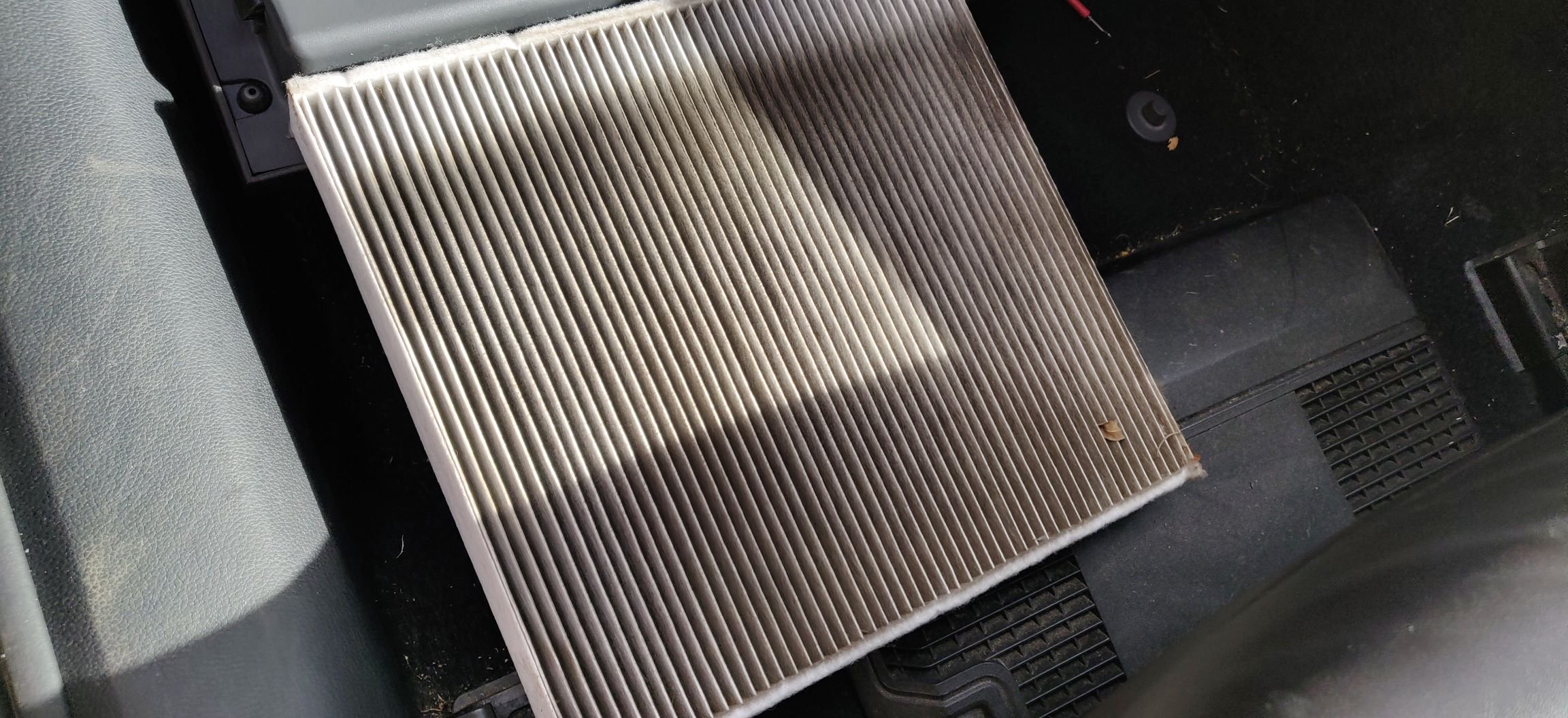

To reveal the cabin filter housing:
There's three plastic tabs at the top, middle and bottom, and they just need a bit of convincing downwards to come free of their tabs and it then slightly angles away and comes free.
The cabin filter looks better than some of the horrors I've seen:
Probably a couple of years by the looks of it.

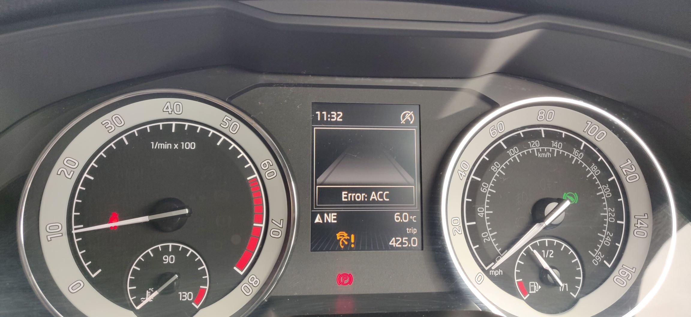

I've noticed this on the dash, and looks like the cruise control buttons are showing:
Maybe something with the firmware update, could be something needed coding, or the fact that car hasn't moved since all this, I'll swot up around the forums to find out.
