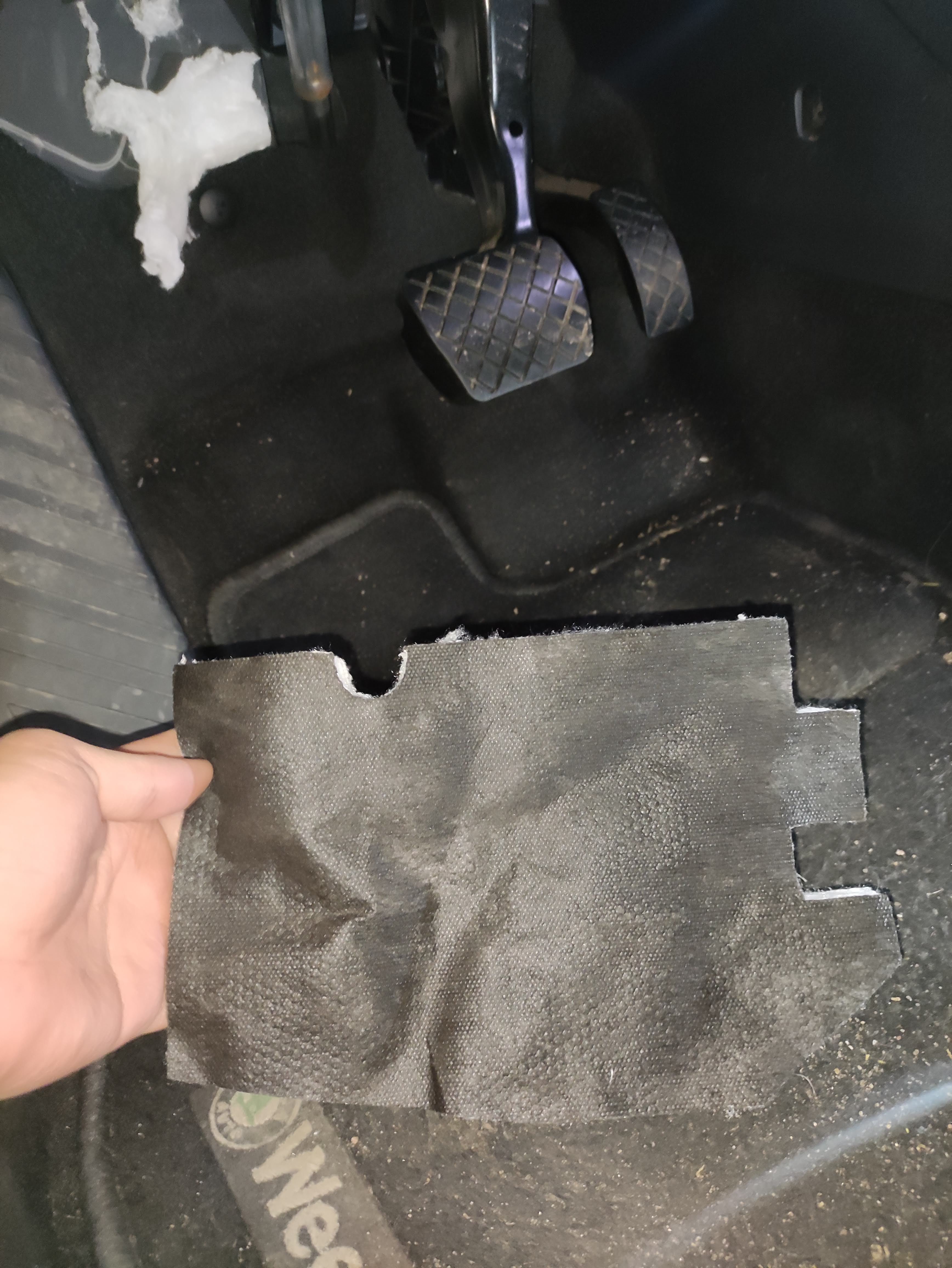

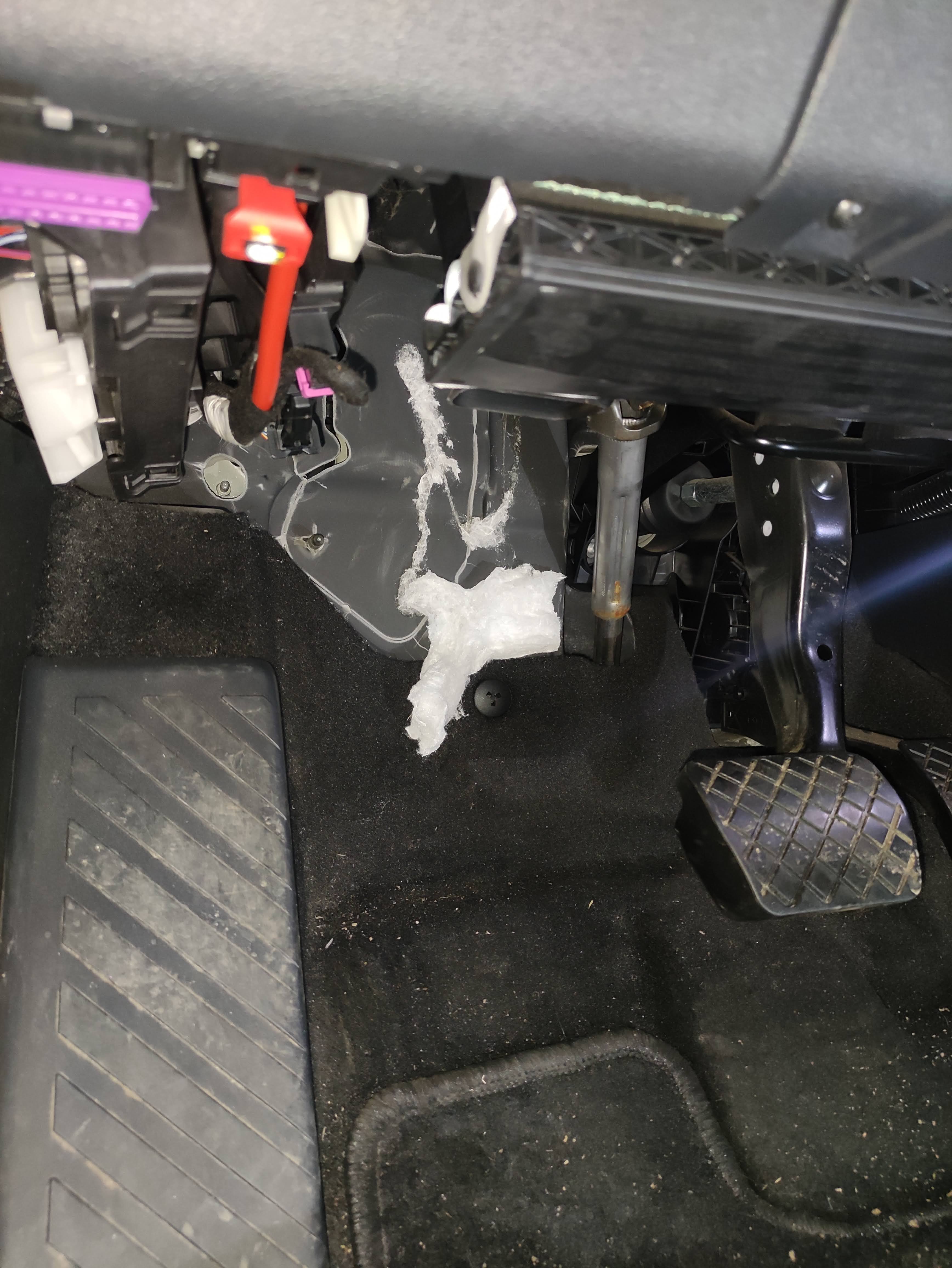

  11. Correct, it's' supposed to be that way'. To be honest - I'm a bit sceptical about wiring being uncovered and open like that, just as you are, but that's a very quick answer that I received. Would be great if anyone else could chip in, maybe it's just us - two 2nd owners - that are unlucky.
  12. Thanks for sharing, and no - there is no part number visible on it. And another quick update from my side - had the car serviced at the dealership and asked specifically about this, their short comment was that "they won't fix it and and won't bother ordering any replacement cover unless I demand it ofc" and recommended simply cleaning it out i.e. ripping rest of the stuff off and forgeting about it. It is not an issue. So there's that.

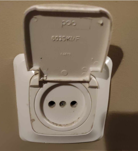

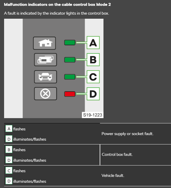

  13. As an alternative - can somebody perhaps snap a photo of that area and what it looks like in your octavia?

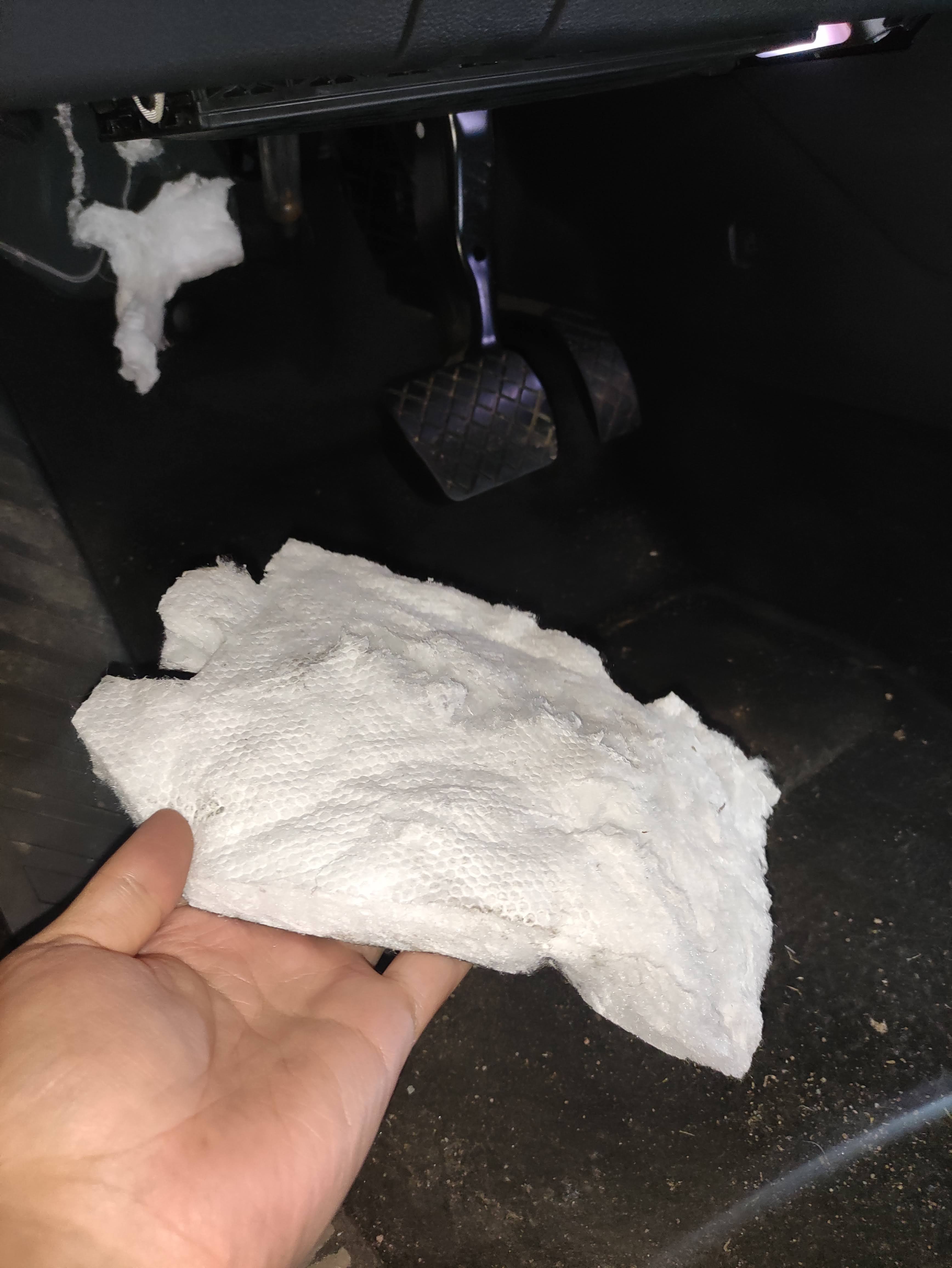

  14. Hey, just noticed this wool type of pad (see photos) that has come off in the driver's footwell, kinda above and behind the pedals. Should I be at all worried? What is it for? Seems like some sort of padding/cover, but it has come completely off even tearing in places. Anyone knows what's it called so I could order a replacement? On top of that - the fuses / wiring seems on the left side is uncovered - is that normal?
