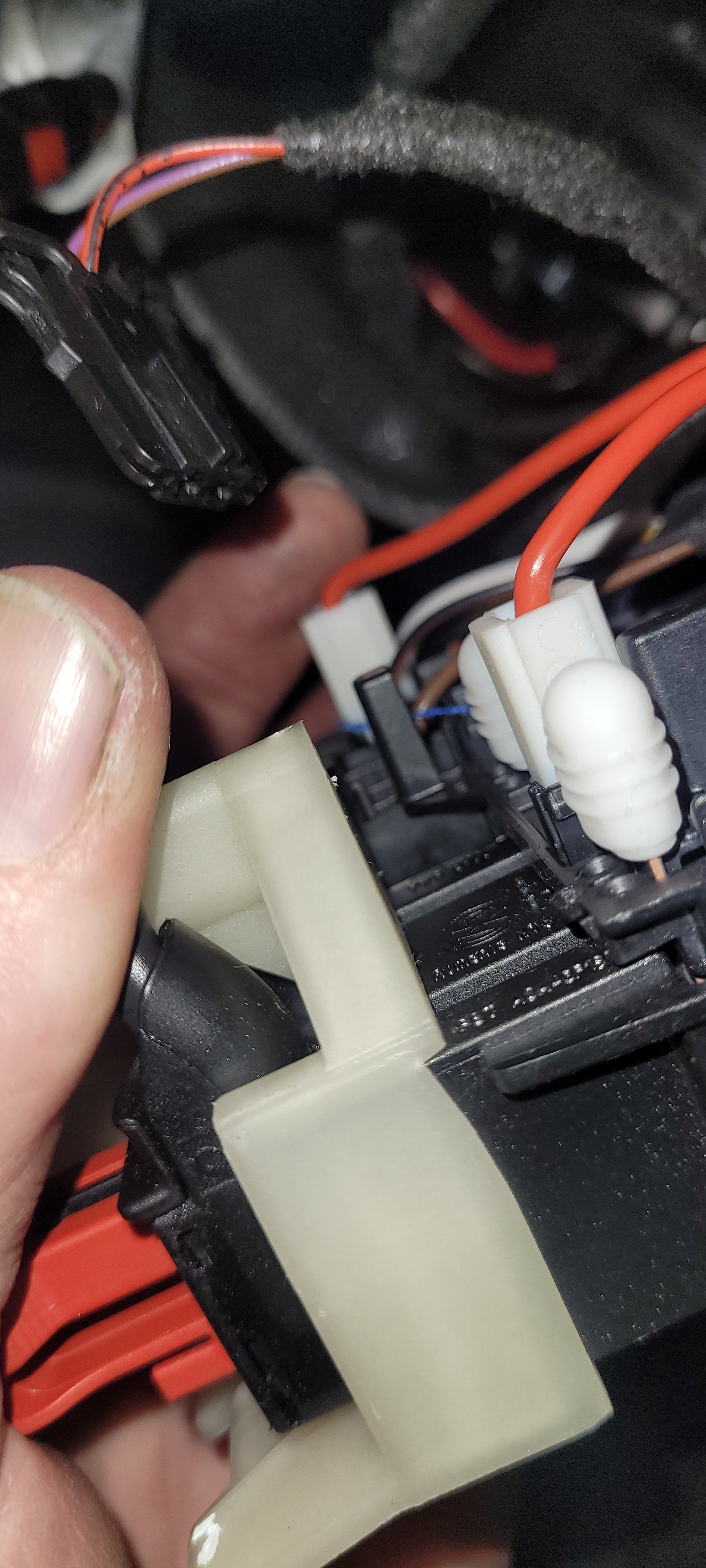

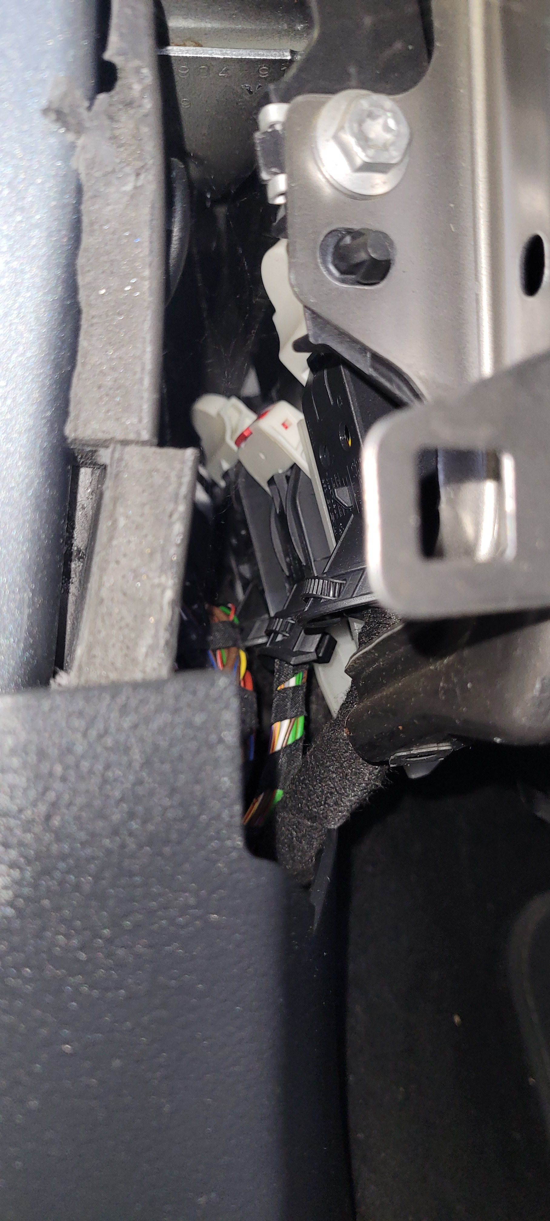

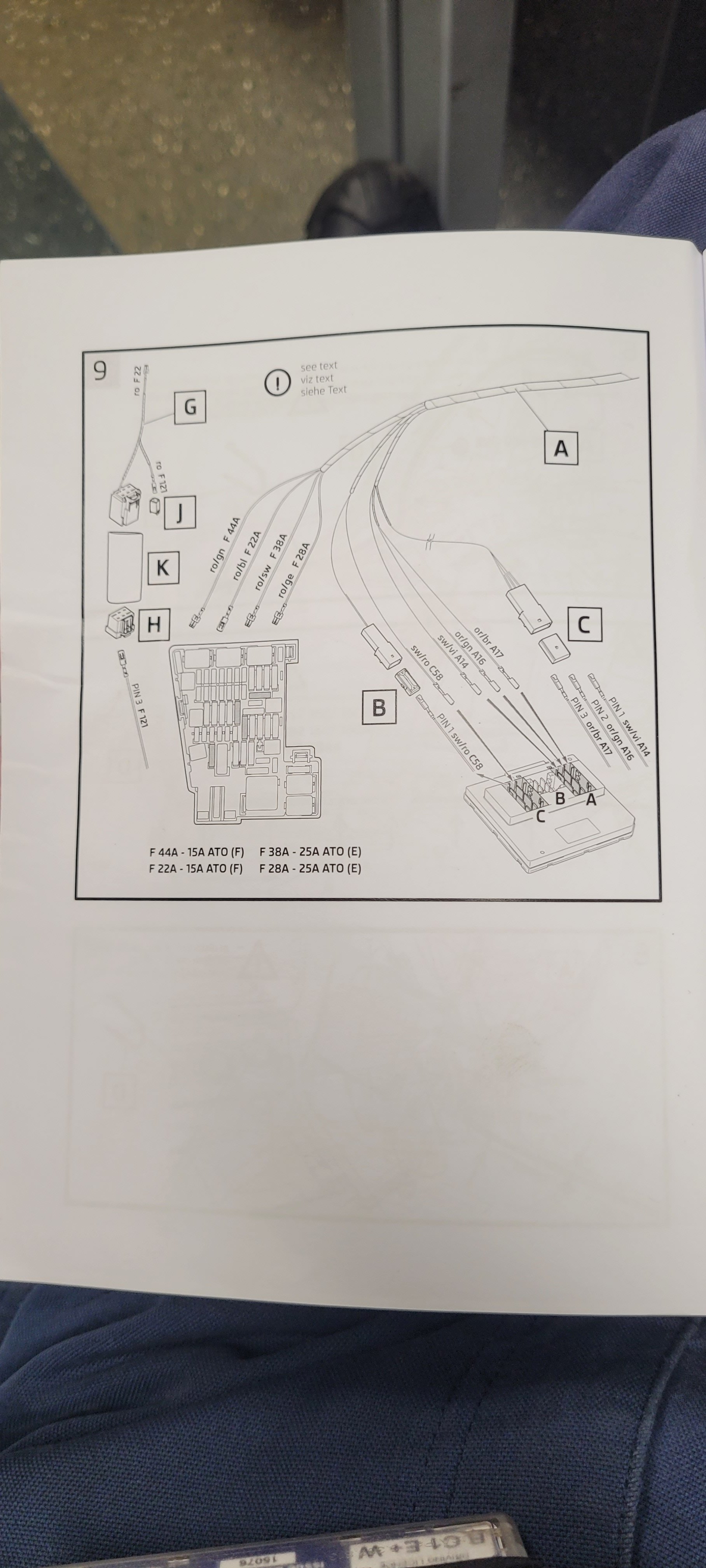

  13. Hi All My name is Fionn, located in Ireland, Meath, Navan, and a New member to the forum today. I have been hiding in the background for a long time but now need to Pick the collective brains of the group if that’s ok. I have just purchased a 2019 Mk3 Superb hatch 2L D 190ps auto (Ex UK reg BT69XFM ), having bent my 170 Kombi in the ice last month. I have purchased and fitted an OEM Swivel Towbar (3V0092160D) and module and am now in the process of installing the harness (3V0055204C) that runs from the rear to the fuse board as it didn’t come with trailer prep. I am just wondering if anybody can help with the connections to the BCM and fuse box, or if there is a link to a thread where this has been discussed before. I have searched but can’t seem to find the specifics. I have watched a YouTube post on a mk 2 Kombi that shows how to connect in but the layout is totally different to the Mk3 My Queries are, for a start. When connecting at the front.. 1) How do you insert the connections into the fuse box? Do you have to release a lock to allow them slot in 2) The instructions show the removal of a power cable from “pin 3 F121” and re route through a splitter to allow power run to fuse F22. Can any body show where pin 121 is on the back of the fuse box. There appears to be 2 possibilities but not sure. 3) Are the connectors to the BCM the same construction as the MK 2 , I.E. can you disconnect and split to remove the pins and reassemble. BCM appears to be well hidden and is there an easy way to do this. Any Techs that I have spoken to have fitted to cars with tow bar prep and not carried out the front connections so they are as much in the dark as I. I may look into getting a Main dealer or good Auto elec to connect and program ( if I can Find one or if anybody has suggestions in my area) if it becomes too much of an ordeal but decided to try here first. I would like to have it fitted properly and not splice into wires so am fussy about getting it done right. Ill try post photos of the digging I have done so far but not sure if I am allowed yet. Thanks in advance for all/any input and advice. Also, if I have posted in the wrong section etc please let me know. Thanks Fionn
