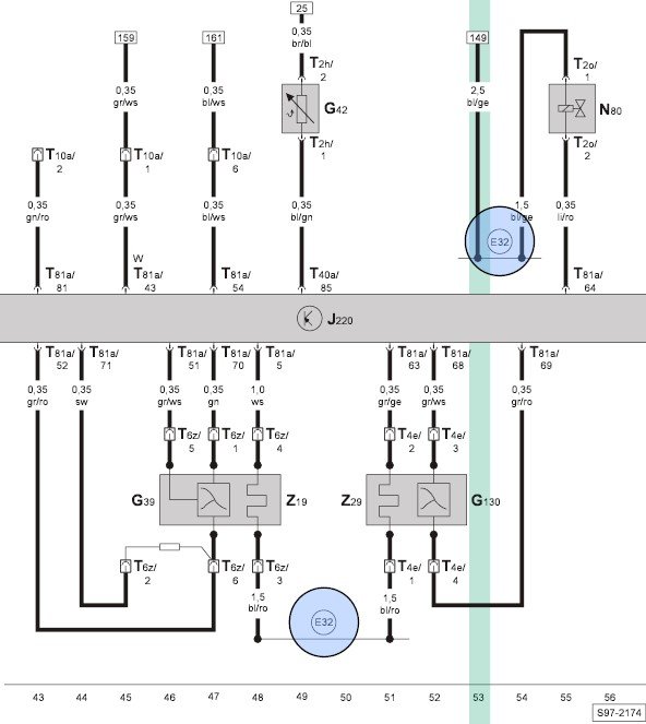

One of the lambda sensors heaters is the most likely reason, Z19 or Z29
Edited by Crasher
Ok, will check it thanks,
Do you have some schema to find where they're connect to unplug them for example could be the one on top of the engine not under the car :)

Unplug the one that's easiest to find the connector for, probably nearest engine.
So today I layed under the car and checked the cables for the lambda sensor, covered the good ones with insulation tape and the rest two as well separately. The best solution might be to cut off the cable and re-solder it, but anyway it fixed my problem. Despite the fact that it was a little struggle, connecting disconnecting I also cleaned some cable plugs with contact cleaner in the meantime.
