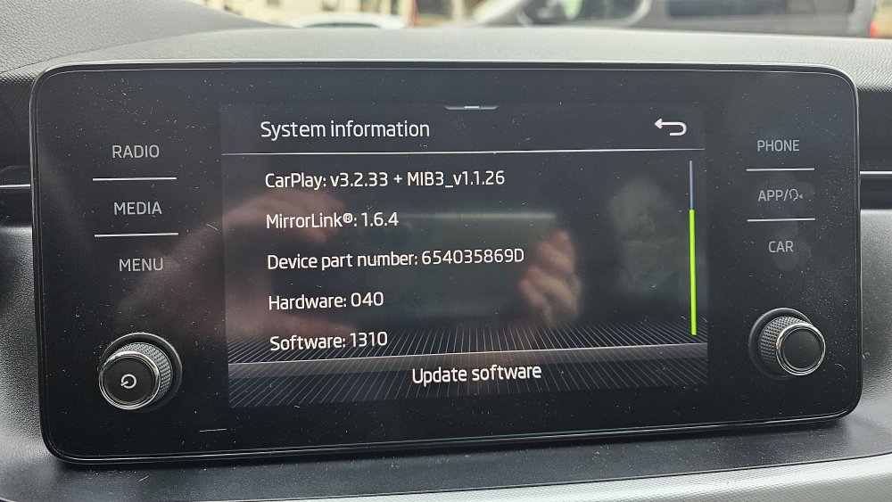

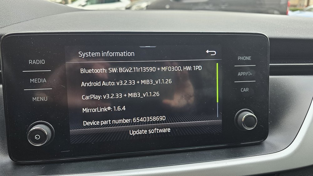

  4. On my 2021 Scala with standard cruise control I have the same issue to a point. The cruise control symbol, normally white turns yellow when I first start the car without even trying to us the cruise control. The switch on the indicator stalk is still switched on though. It seems to be when my phone connects to hthe Bolero system. I can sometimes get it to work by switching the system off, then switching the engine off, opening the door and closing it again, starting the car again and presto, fixed. It happens more often than not so very annoying. If anyone has any ideas it would be much appreciated. The software I updated recently to the 1798 version. Cheers
  5. An update on this is that I managed to update the software to 1798 hoping that would change the cruise control issue but to no avail. Any ideas people???? I need help. It is so frustrating.
  6. Hey there. I have a 2021 Scoda with Bolero infotainment system and I was able to do an update to 1798 using this file MEN3_EU_SK370_P3225L_1798. Everything seems to work although I still have an issue that sometimes when my s23ultra connects it disables the cruise control. I was hoping the update would fix this, but unfortunately no. If the cruise control shows the yellow Cruise Control unavailable icon on the dash I sometimes can change that by teurning of the engine and starting it again and not touching anything on the Bolero regarding Android Auto. Not sure why this is.

  8. I have a 2021 scala with bolero system and a Samsung s23 ultra. I can connect to Android auto but many times when it does, the cruise control (not adaptive) becomes unavailable. Sometimes if I'm still connected and turn car off and on again or turn the system of and on, the cruise control becomes available. I haven't figured out exactly what fixes it. And above much appreciated.
  9. I too need an update for my bolero system.
