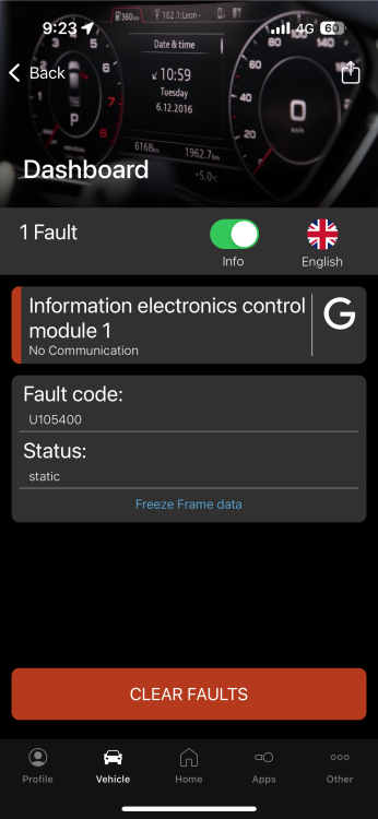

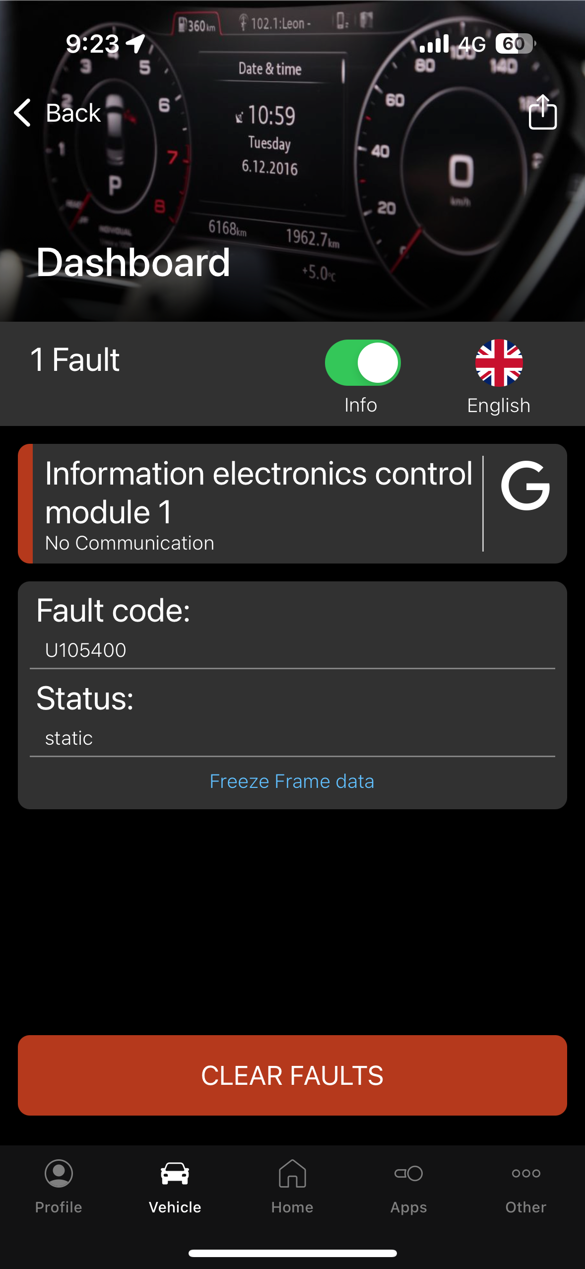

  7. Posted this in the 1985 firmware thread but figure it may not be related to the update, so starting a new thread here. Since I have updated firmware to 1985, the dashboard unit keeps throwing an U105400 error when interrogated by OBDEleven. Unlike in the past, I simply could not clear the error (with or without bonnet open and with or without engine running -- which worked in the past). The error would seem to be cleared but it would come back right away. Does it mean that I have a permanent error code now? What does this error even mean? This is a frequent error code I saw all the time in all sort of modules but I was able to clear it without issue in the past. Does it warrant a workshop visit?? The car seems to be ok though. Does anyone know if reset the control unit or unlocking SFD with OBDEleven would help clear the code? I have the OBDEleven device only without any plan so to use reset function or SFD unlock I will need to pay for a subscription. I loathe having to pay for a subscription just to clear an error code, but then the code bugs me... Thanks
  8. Since I have updated to 1985, dashboard unit keeps throwing up a communication error (when checked with OBDEleven). It does not seem to affect function but is nonetheless annoying. I tried clearing the error but it just came right back. I cleared all errors before updating the firmware, so I presume it is not a hardware issue. Does any one know what this error mean and whether it can be cleared permanently?

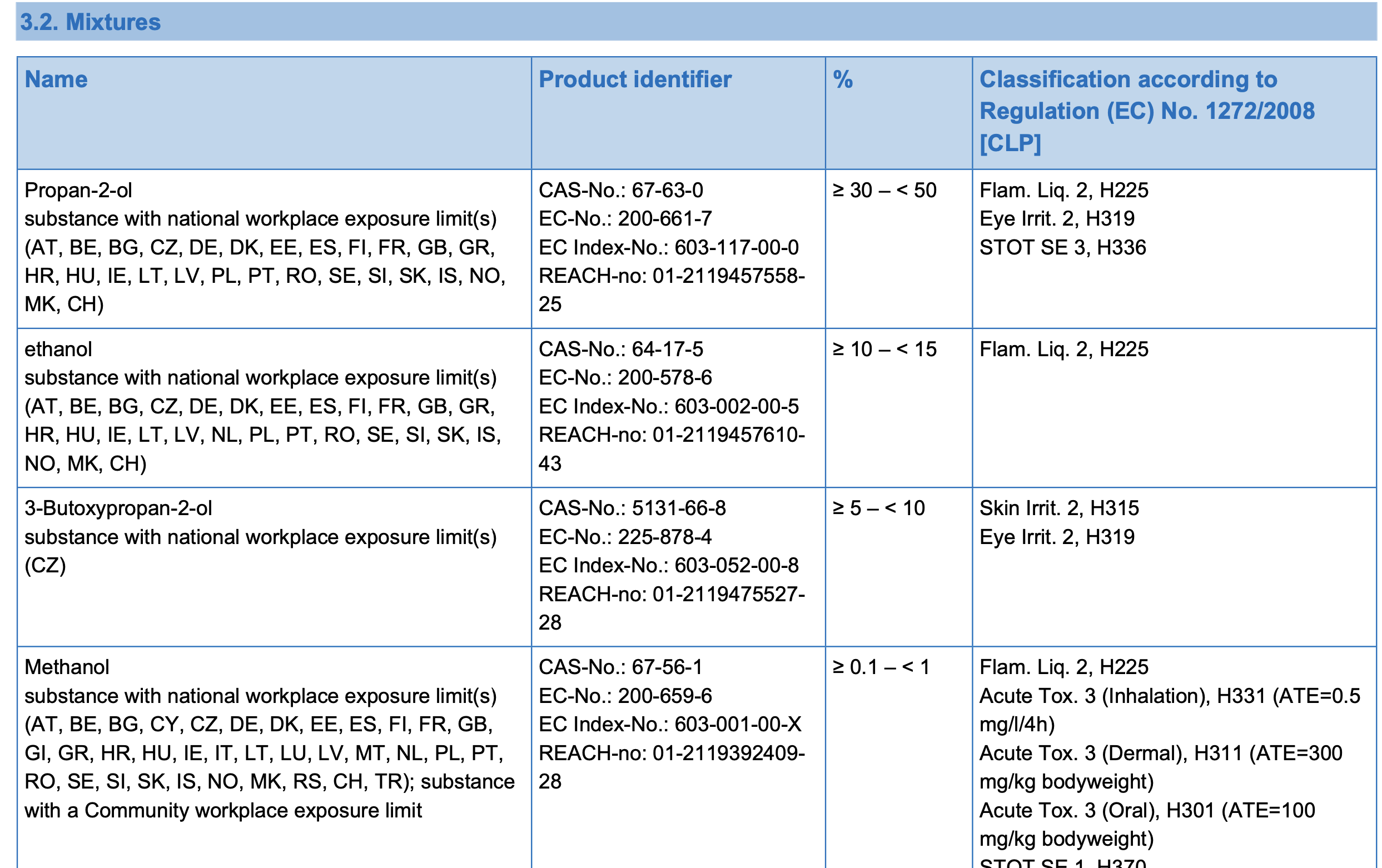

  13. Just another datapoint, this is from the data sheet of Autoglym Screenwash. It does contain 45-75% alcohol of various types. So if I find the VW washers too expensive may be I can switch to Autoglym
  14. The table is lifted from the Material safety data sheet, supposedly a legal document so I guess it can be trusted. Anyway I have splashed out and bought a bottle of the "tears of angel". Lets see how long it will last. If it keeps getting depleted too quickly, may be I will then switch to cheaper third party ones but "spike" them with some isopropyl alcohol to increase the alcohol concentration.
