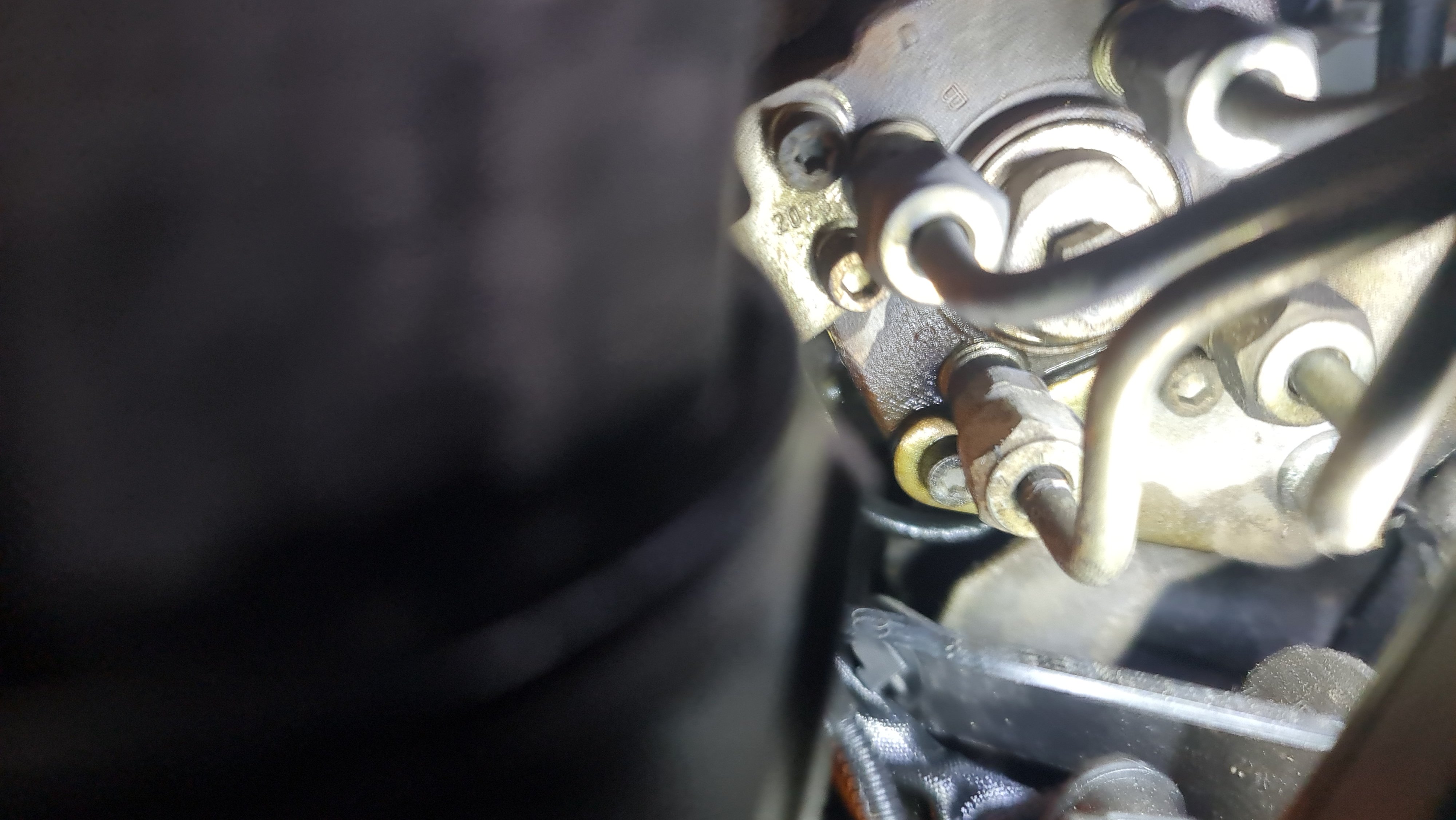

  8. Greetings all I have a slow drip from my fuel pump. It looks like it's from the big round bit in the middle of the distribution side, how bad is that to take out, service or replace o-rings etc? Hope you all have a good weekend. Milo
