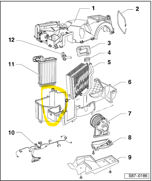

Thanks for that detailed document - I have plugged in my ODBC and found no error codes in relation to the heater system. My theory I think is the correct one - i.e. that the foam covering on the flaps has disintegrated and is not directing the air through the heater matrix  (as highlighted, below);

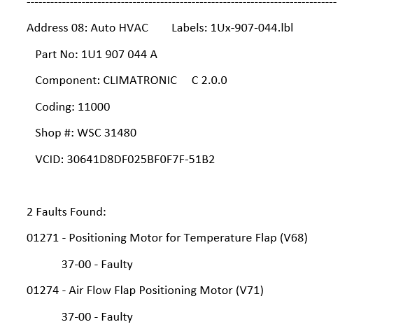

This is the read out from VCDS when I had problems with the flap motor on my car.
The codes are specific to VAG cars.

The ringed item is the flap. The foam seals on these are quite narrow and if they fail they will not cause a lack of heat.
Fundamentally the air is not flowing through the heater matrix which means the flaps are not moving.
I am not convinced you are using a suitable diagnostic code reader to find the errors.
The effort of dismantle the heater unit is huge. You need to find someone with VCDS to check for codes. Also when the servo motors are replaced VCDS will initialise them to have them correctly set up.
The servo motors are mounted on the outside of the heater unit, they are not easy to get to, but are less work than splitting the heater unit.

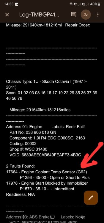

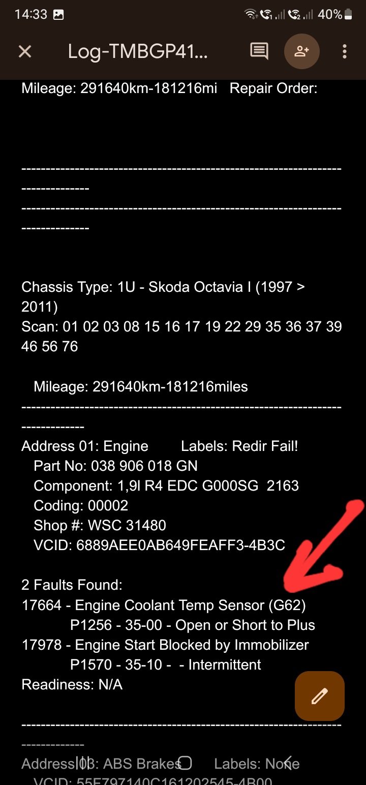

Hi all
I have the same issue but would this be relevant from the vcds print out?
