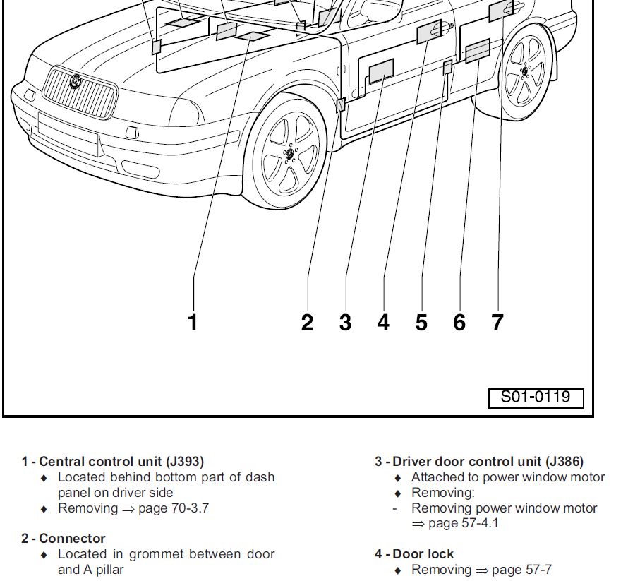

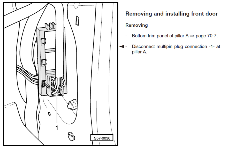

Peel back the grommet and look for connector. Image from Skoda manual.

As indicated in the diagram the connectors are not directly inside the pressing.

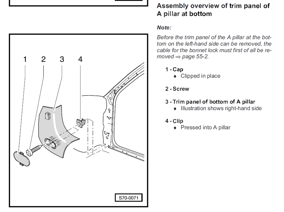

You have to remove the footwell trim panel to access the connector.
The connector is 150mm below the grommet on the body. It is indicated in the first image I posted. For rear doors it is down by the seat belt reel.
Brilliant that is much clearer thank you.

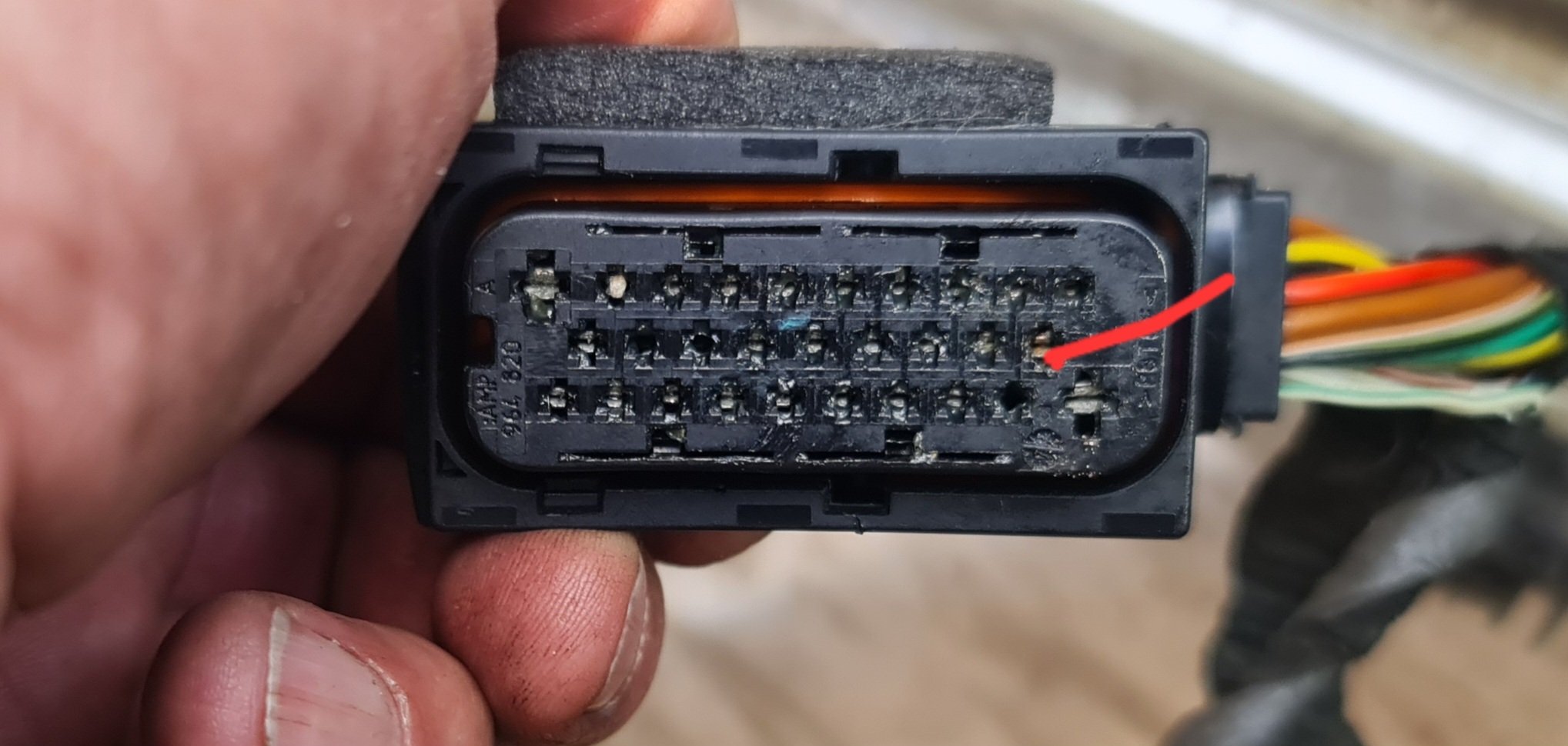

So I have found a wire with no connection continuity to the plug. Red with a yellow stripe, connects to the pin at the end of the red line. Anyone know what it is? 20240518_174308.thumb.jpg.83232ba3f3e653030ca92df555fec60b.jpg
