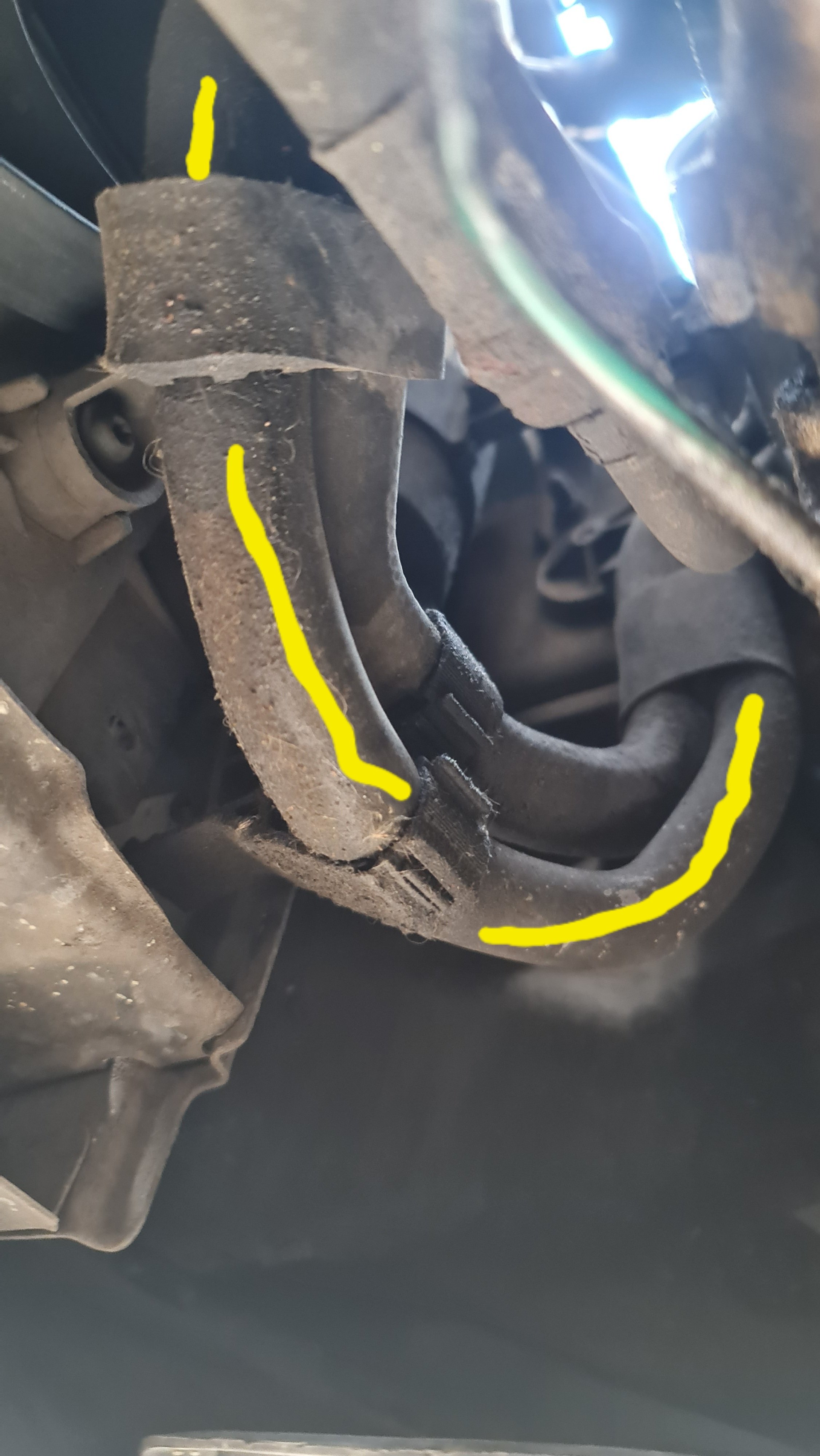

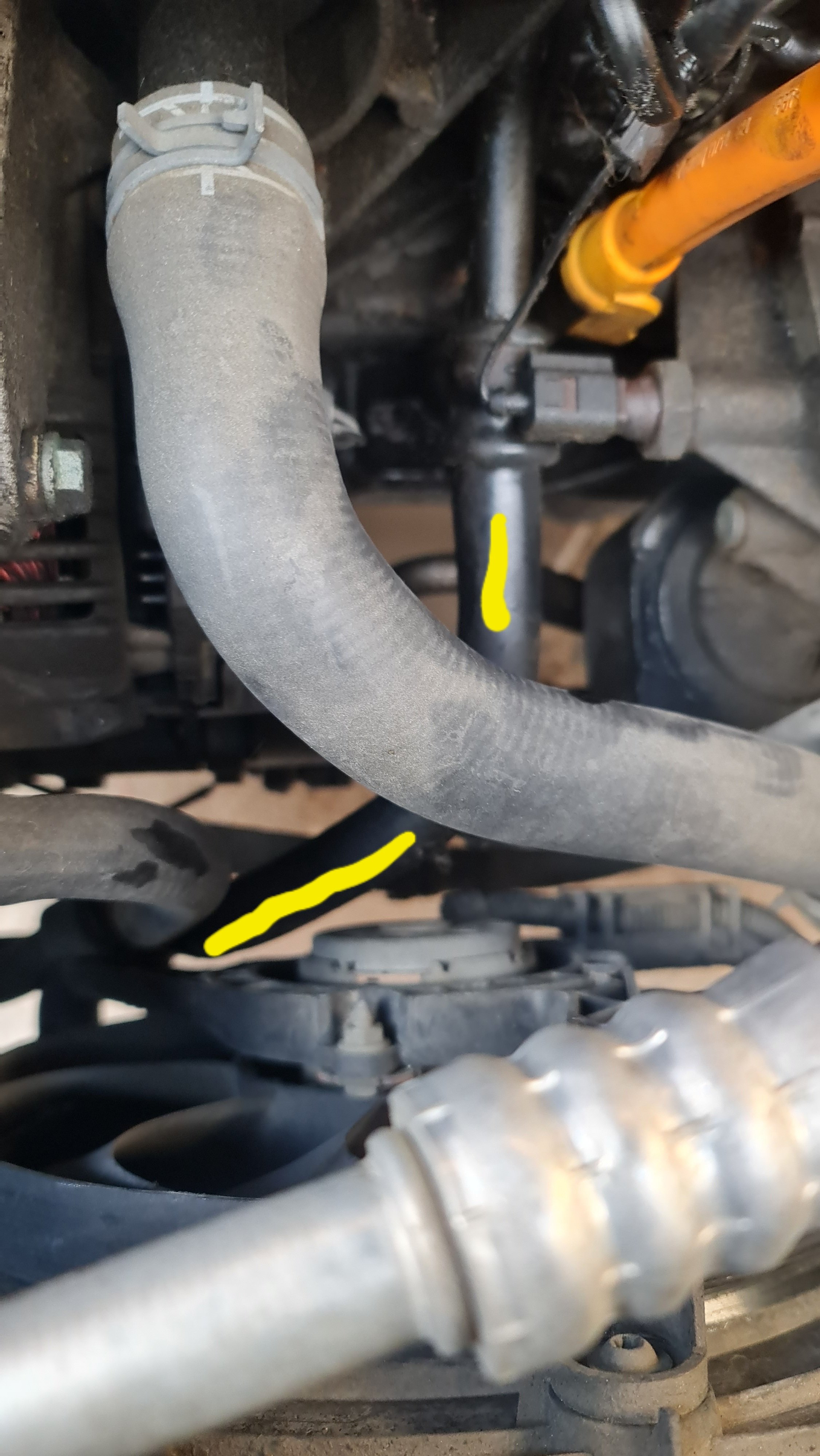

Next issue on the French MOT is a coolant leak which I have found but need a part number for the replacement pipe, hoping somebody can help with either a diagram or a link, it's the pipe that loops underneath marked in yellow in the two pics.

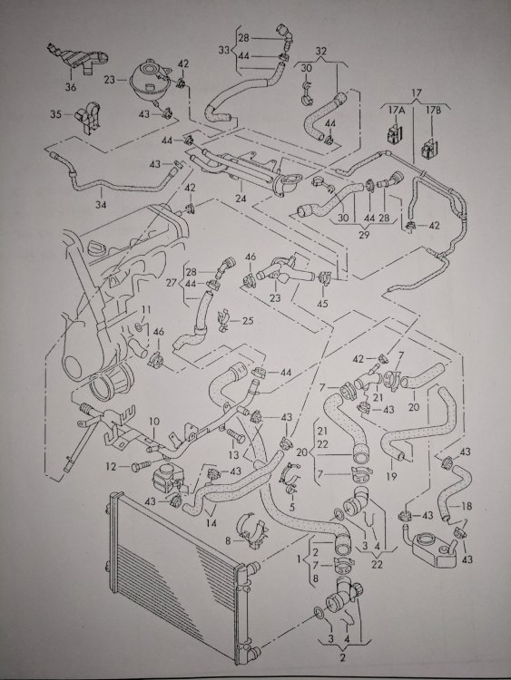

So with a bit more research I think it's number 34 on this diagram from a different thread on the forum. I am basing that on it going into the bottom of the expansion tank and then hooking onto a metallic pipe on the other end. How do I translate this into a part number? There is one stamped on it but every site I go on tells me it's not compatible with my car??
Thank you I have tracked it down and ordered it. I found the isometric randomly on the internet so didn't have the parts list attached. Thank you!
Well despite it being supposedly for the right engine and the right pipe it was not. Way too big in diameter. So as there is a part number on it for the pipe itself rather than the Skoda part number what do you all think of just ordering a length of that pipe and replacing it with that, obviously making sure it's properly routed?
