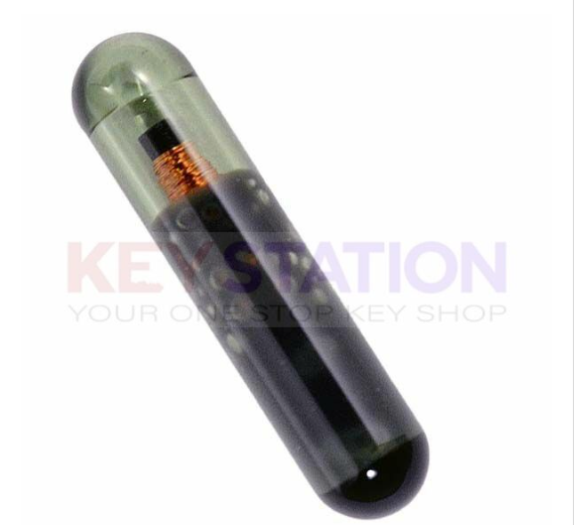

  7. You can still silence the alarm with a non-working fob because the small chip inside the fob continuously gives off a signal which the receiver in the ignition switch will recognise (even if the fob battery is completely flat) and once this 'handshake' has been completed the alarm will silence once the ignition is switched on and the car will also then be able to start. The little chip inside the battery needs no external power source. When you look inside a remote you can see the chip, it's just a small black ceramic thing glued in place with no wires. Although you can buy these chips cheaply (less than £5) it is useless unless it is programmed to your car which these days means a live connection over the internet to Skoda.
