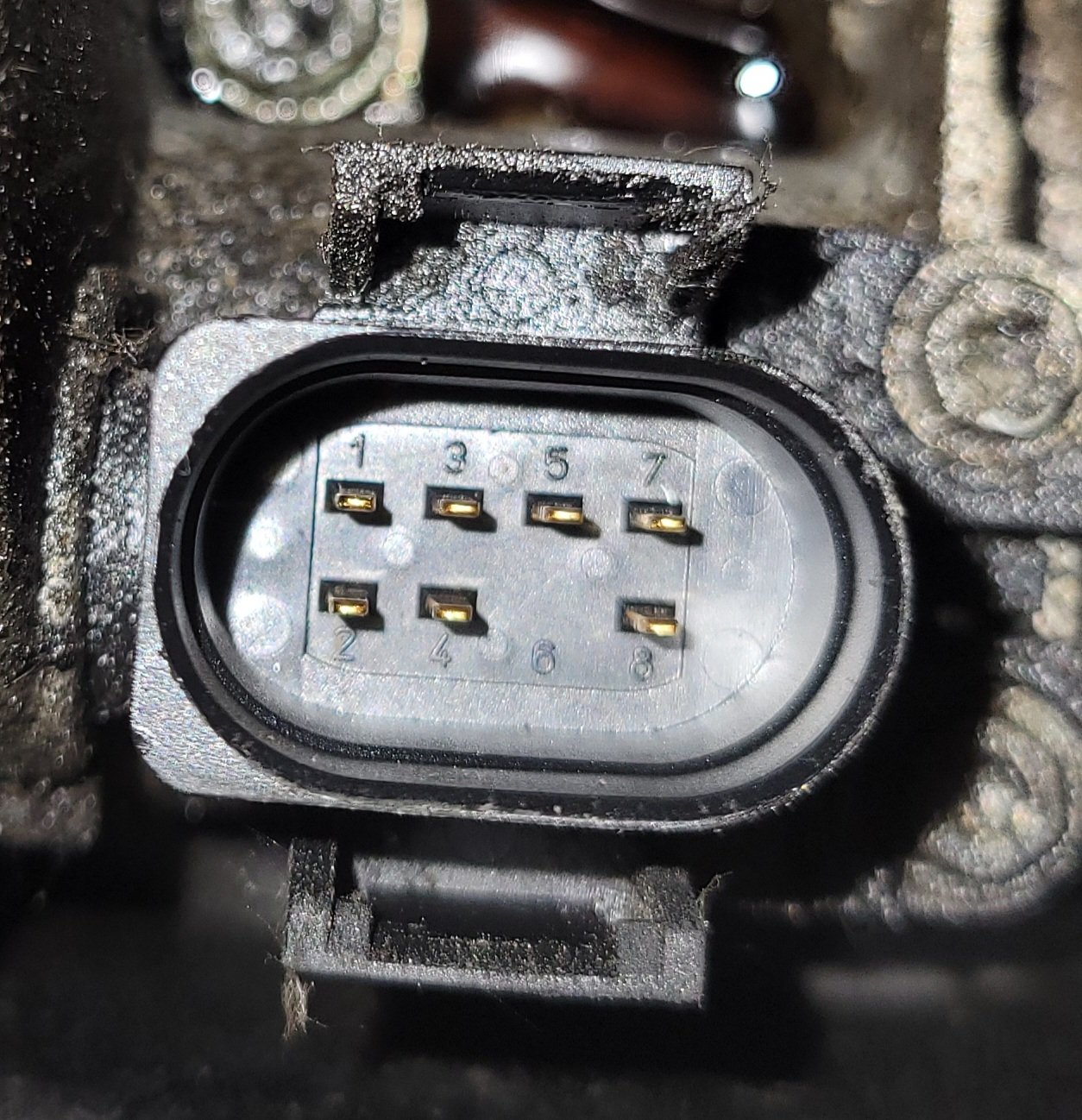

  15. Hello all, I have been doing a lot of reading of old posts. I have an issue of 'rev hang' where the revs do not drop once I release the accelerator pedal. I also have strange revs at idle where it can sit at 1k or 1.5k or even 2k sometimes, until I turn the engine off and on again and it seems to reset back to its normal at around 0.8k. At first I thought it was perhaps a vacuum leek but I have smoke tested and found none. Today I used a multimeter on the TPS pins to read the resistance between pin 1 and pin 2 whilst moving the throttle body and found near 0 ohms in every position. This suggests to me that the sensor now is telling the ECU that the throttle is idling all of the time. Is my interpretation correct? Is it time for a new throttle body? In which case, does anyone have any recommendations for a replacement for 030 133 064 D? Thank you
