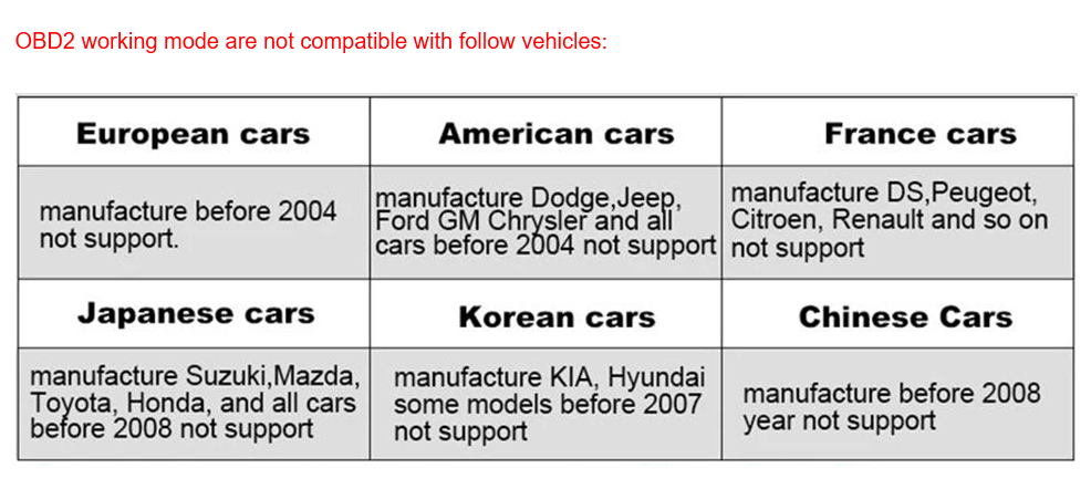

Some modern OBDII scanners they don't support the Felicia's ISO14230 (KWP2000) protocol which uses for communication between ECU,sensors and OBD socket.
You need a VAG-COM scanning.

We have plain OBD or OBD I and not OBD II so VAG-COM works fine with out port, some OBD II scanner devices not always.
OBD11 is a scanner tool but has not those fancy applications that OBD II has.
https://obdeleven.com/skoda
In the past i have found and posted this:
So forget the OBD II (also known as OBD 2).
