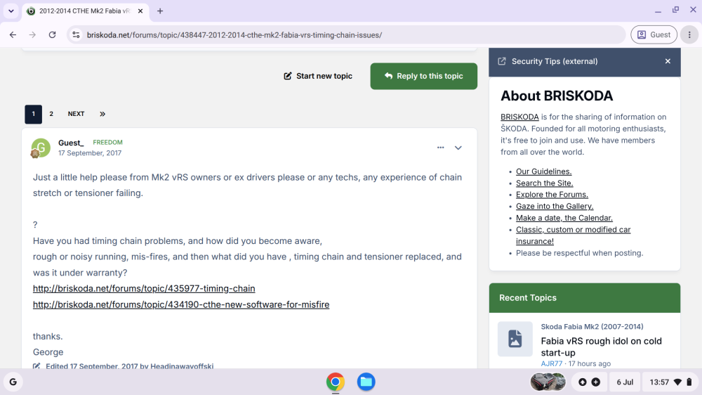

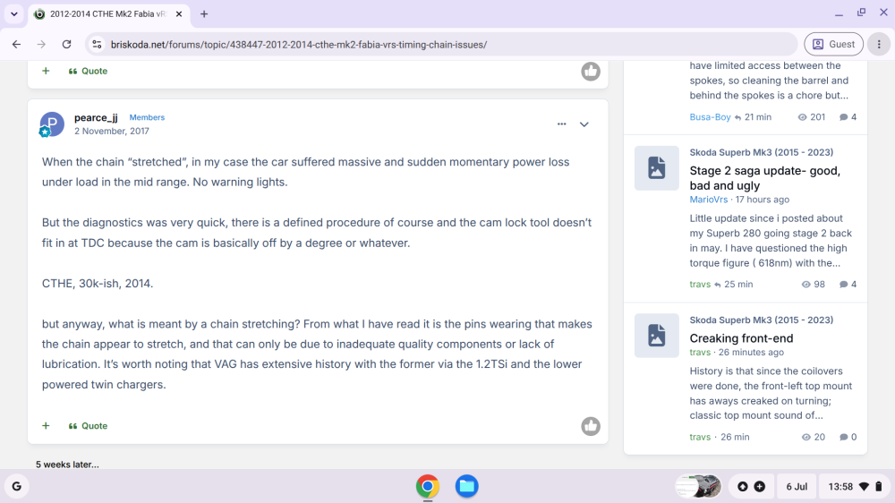

Re the Timing chain. There were issues with CTHE with mow miles as much as 8 years ago and there is a TPI. so just because low miles now means nothing................ This was my post in 2017 so 9 years ago & done because i was getting PM,s from members not wanting to post themselves & asking advice. So i looked for responses from other members. I knew the issue was serious for some.

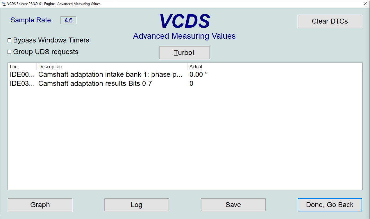

I got some VCDS data for the cam belt and injectors.
I think the cam reading is ok and the blet hasn't stretched.

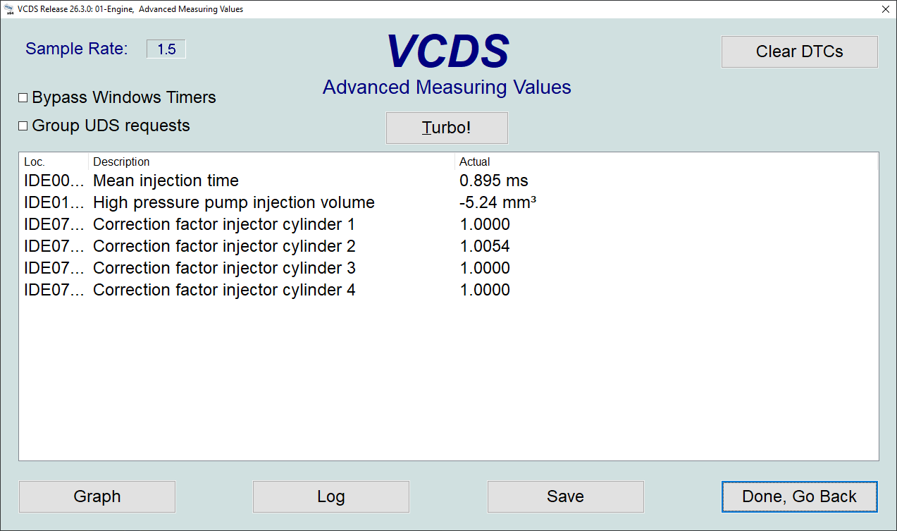

Not sure if this is relevant for injectors but this is from a warm start.
There were slight fluctuation on the reading where each injector value one would dip under 1.0.
