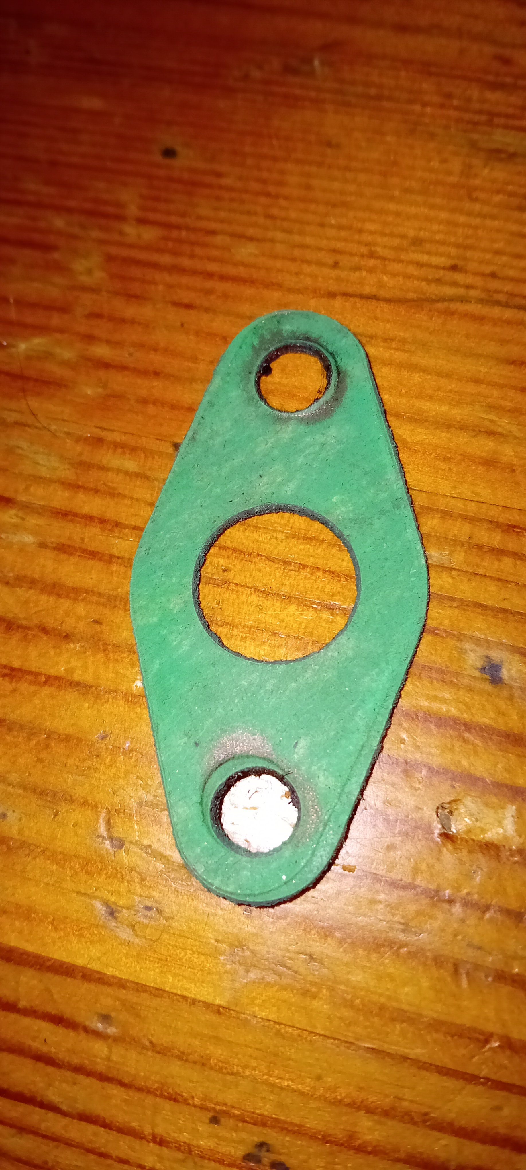

  1. Yes it looks the same, my is rubbish gasket. what you suggested me to get? Garret any link? thanka
  2. I took the gasket off; it looks bad already. It feels like a rubber gasket. I see it did not seal properly, with a line on the side. it is too small for my oil return feed pipe.
  3. Blimey I bought the turbo £435 trade swap my old turbo £100 off. It must be the gasket. Which is better? metal or hard material? eBay UKTurbocharger Return Oil Feed Pipe Gasket Seal - Audi VW S...(Beetle 1C, 1Y, 9C [1998-2010] Engine Code(s): AXR, BSW, ALH, ATD, BEW. Our manufacturer compatibilities are a guide only. If you need to find out your engine code we can do this for you). A3 8P [2003 eBay UKElring Turbocharger Return Oil Outlet Seal 028145757 | e...Elring Turbocharger Return Oil Outlet Seal For Audi 058145757CNewBrand new stock from an authorised Elring supplierO/E genuine specDirect replacementFully guaranteedPlease use compatibility guide or m
  4. I used paper gasket from eBay Partsmotion. The reconditioned is from Turbo Rebuilt Ltd. They fitted new turbine etc, cleaned exhaust manifold.
  5. My Octavia 2009 BKD 140BHP 2009, I have fitted a new, reconditioned turbo. A few hours later found oil drips on the floor. Here are pictures. The above is no leaking, I am not sure if the new gasket on the return oil is useless? I hope it isn't the turbo leaking from inside, it would be a nightmare to take it off again. Hope to get the answer soon.
