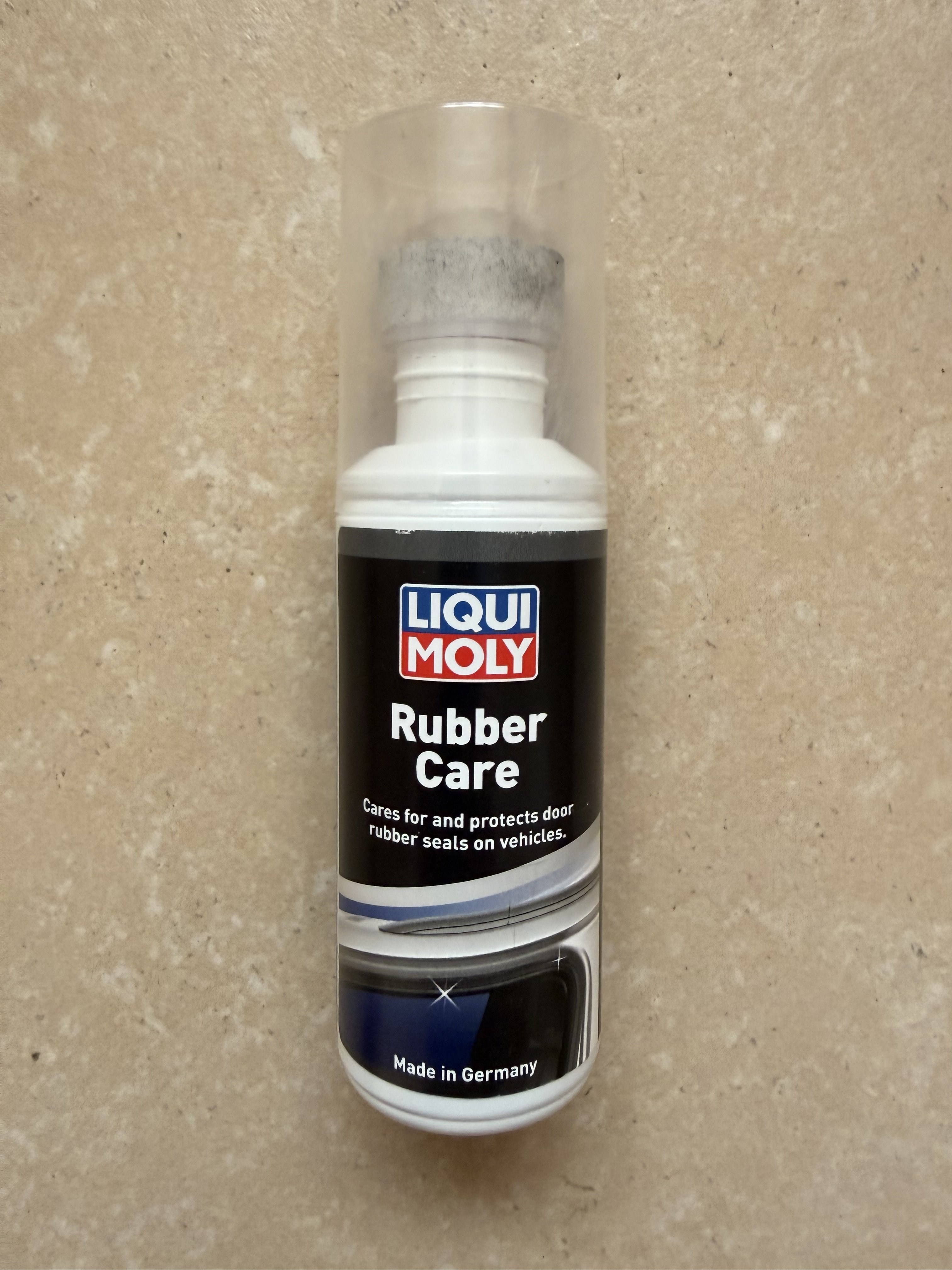

  17. Hmmm... it might be! One thing that was suggested to me is to open the window a tiny bit.... not enough that you can see its open, but just enough to allow a tiny gap between the top of the window and the window frame. If you do that and it helps, it's probably the seals. To be honest, the stuff only cost about £3, so it has to be worth a go ... I was in the same situation as you... the creaking noise was really frustrating, but this has cured it totally.

  23. Since I had the car, every time I drove it, it has had what my wife called a rattling from the doors. I always characterised it as a creak. As the car is otherwise so quiet (especially when on battery at slow speed) it was quite noticable. After trying to narrow it down, I found a video on YouTube that described the issue exactly (but on a Lexus) - https://youtu.be/BoYCCckQdQs?si=Q549W00RwkRYLK9o The guy in the video recommended applying a product to each of the door seals and claimed it pretty much cured the issue. The product he recommended was about £15, so I opted for the cheaper version at £3.82 - https://amzn.eu/d/9bGPMFX It has worked brilliantly, and now my quiet car has become an almost silent car. If you have an annoying creak from your doors, give this stuff a try. I was very impressed.
