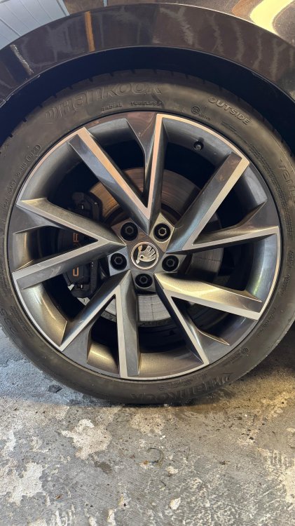

  4. THEDUTCHBOYS changed their profile photo
