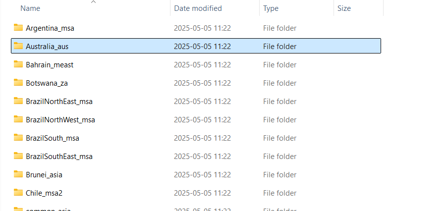

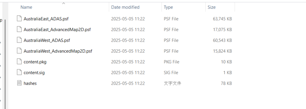

Dear Sir,
should I copy the .PSF file into the root file as below step ?
enter
click
click
click
Click
Click
Copy all files and put them on root file.
Then, I can update..
Am I correct ?
Best regards,
Kam Pang

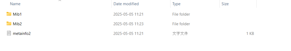

Almost correct
You need to unzip the map update zip, you’ll then see the 2 folders and one file, copy the 2 folders and one file directly onto sd card
@kampang - u need to have 2 folders and 1 file in the root of the Sd-card :-
  • Mib1 (folder)
  • Mib2 (folder)
  • metainfo (file)
Don't go copying stuff from individual folders.

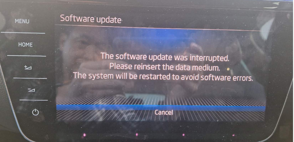

Dear ,
Yes. My car can read my SD card finally. Thank you. I can update the map. However, the update process is not successful. During the update, below screen prompted out.
How should I reinsert the data medium?
Anyway, I will download zip file and unzip the file and try again..
Best regards,
Joseph
