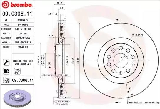

How to: Big break upgrade 340x30 mm
Looks good on the final product 👍🏼

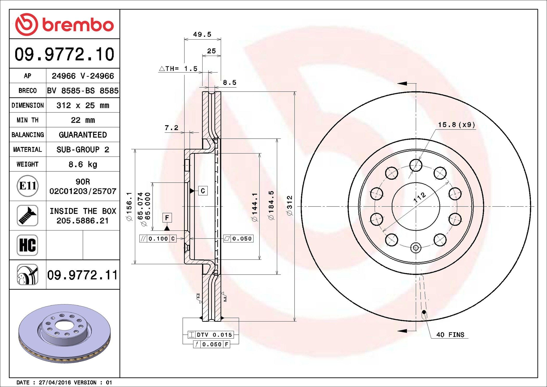

The Superb 280 AWD has 340mm front brakes and 312mm rear. As I understand it, all other Superbs (all FWD and the diesel AWD) have 312mm front discs and 300mm rear. Are you sure yours are 288mm? That seems to be Octavia or Mk2 Superbs from a quick google search.
Also, as donor cars go, the Golf Gti performance pack has 340mm. The standard gti has 312mm. The Golf R has 340mm. As will the gti clubsport.

The 220 Superb FWD uses 312mm ventilated front discs and 300mm solid rear discs.
The 280 Superb AWD uses 340mm ventilated front discs and 310mm vented rear discs.
