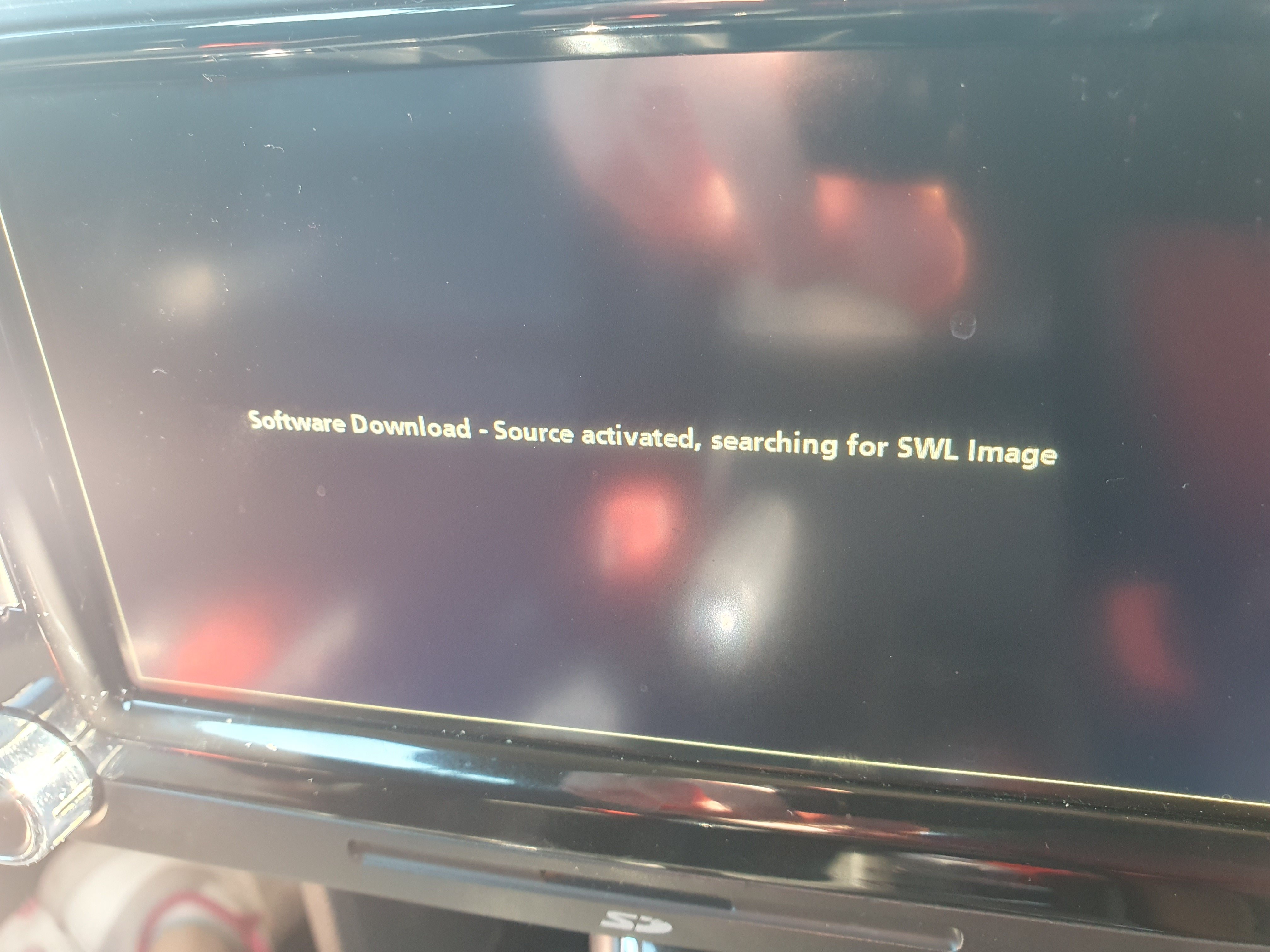

Got the update done, all went well. Thanks @pab567 As I had read, updating the software has wiped the maps and now asks to insert maps DVD. I believe the last version is v17? I went online and checked a couple of sat nav stores who list the DVD but their last reviews were about 10yrs ago so I am wary. Can anyone recommend a trusted current supplier of the DVD? Many thanks.

Great, last question, does ignition need to be on or car running?

Thank you so much, I'll get my son on to it Are there any instructions on how to install this?

Hi folks, New member here. I have tried searching but am just getting confused. This message has appeared on my Columbus screen. " software download-source activated, searching for SWL image" No buttons are working and today I have a flat battery🙈 My question is if I can get the correct software update DVD will this fix the problem? I have read about files and burning them to DVD but I'm afraid this is beyond me. Any help appreciate

Hi folks, New member here. I have tried searching but am just getting confused. This message has appeared on my Columbus screen. " software download-source activated, searching for SWL image" No buttons are working and today I have a flat battery🙈 My question is if I can get the correct software update DVD will this fix the problem? I have read about files and burning them to DVD but I'm afraid this is beyond me. Any help appreciated.
