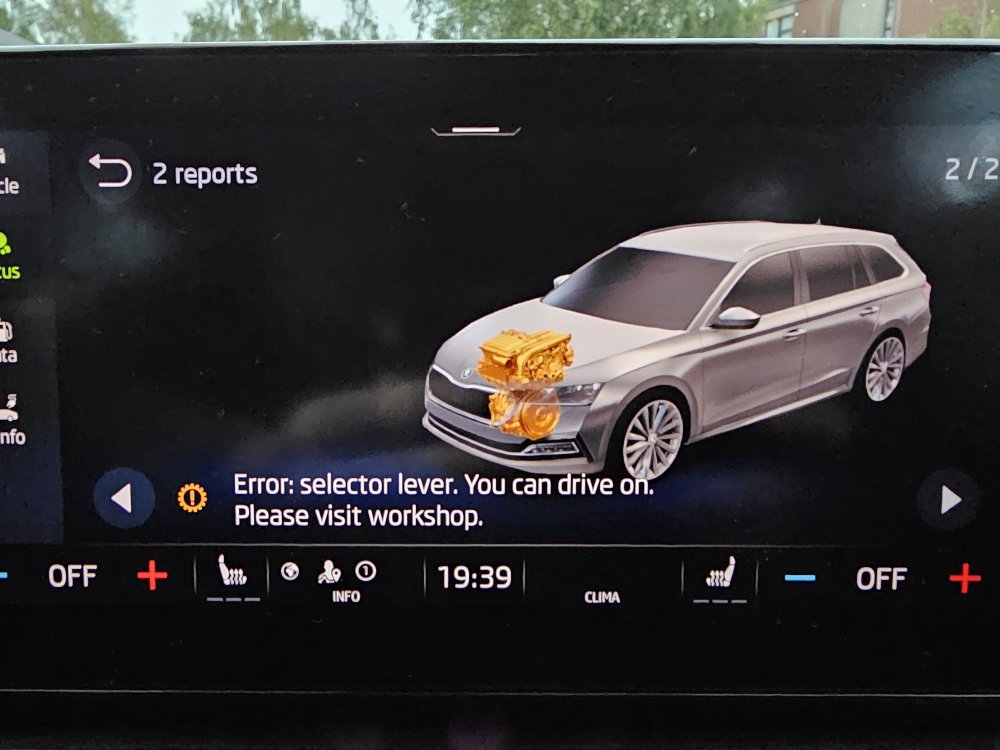

Error: selector lever...
I think everyone's do. At least, mine does it when I switch on the engine and when I switch off the engine, even in P position.
