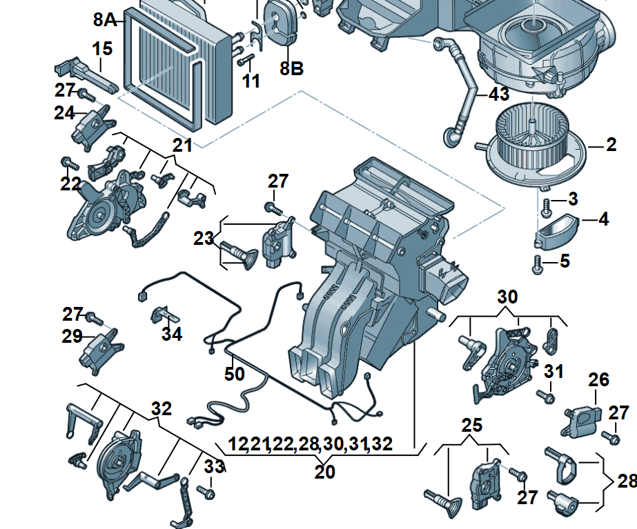

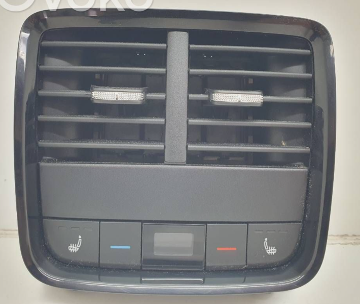

  8. It is possible to update 2 zone AC to 3 zone adding rear panel ? Looking on wiring diagrams looks not so complex, also some retrofit harnesses and mats are available on aliexpress.

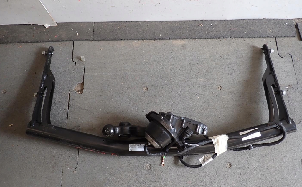

  9. Since no finding any advice if D can be swapped do C I decided to proceed with C (Finally I found brand new with price 150eur) . How about ODIS activation? I found same activation code TOWAB for electric version that work with online session with SVM+DSS (car have SFD1). If someone has experience with that way and can confirm it will work, please let me know:)

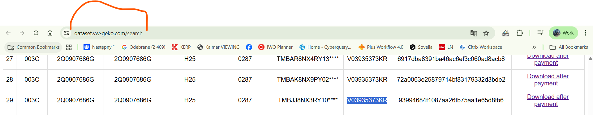

  10. I have estate after retrofit with exactly the same module - I have dataset V03935373KR. After retrofit working perfectly You can download from side (30 eur/file) unfortunately ☹️or search in VCtool (for somone who have subscription it is better price )

  12. That I also consider, but I wondering why with cheaper price I can get new one instead of used. Basically this is why I raised this topic. C version is almost not available as new one. or price is almost double in small shops :) https://www.cars-equipment.com/en/shop/bcm-central-electric-gateway-sensors-2/oem-5h2907383d-towing-control-unit-vw/?tpl=product_detail Since this is my own car it will be better to have also new :) maybe someone have experience with downgraded flashing D to C ? Activation I planning via ODIS online first time, that will be also good if someone share experience What I read SVM+DSS online access is needed. Alternatively I have VC tool with dataset file for 069 module + manual coding list
  13. Hi everyone, I ordered electrical tow bar 5E3803881A for Octavia from 03 2024 (before FL) . According to info from original set the control unit should be 5H2907383C but this is not available on good price. I found brand new one 5H2907383D with price 110 eur but I'm not sure if this will fit to my car. Any experience with that ? Should be used as replacement of 5H2907383C ?
